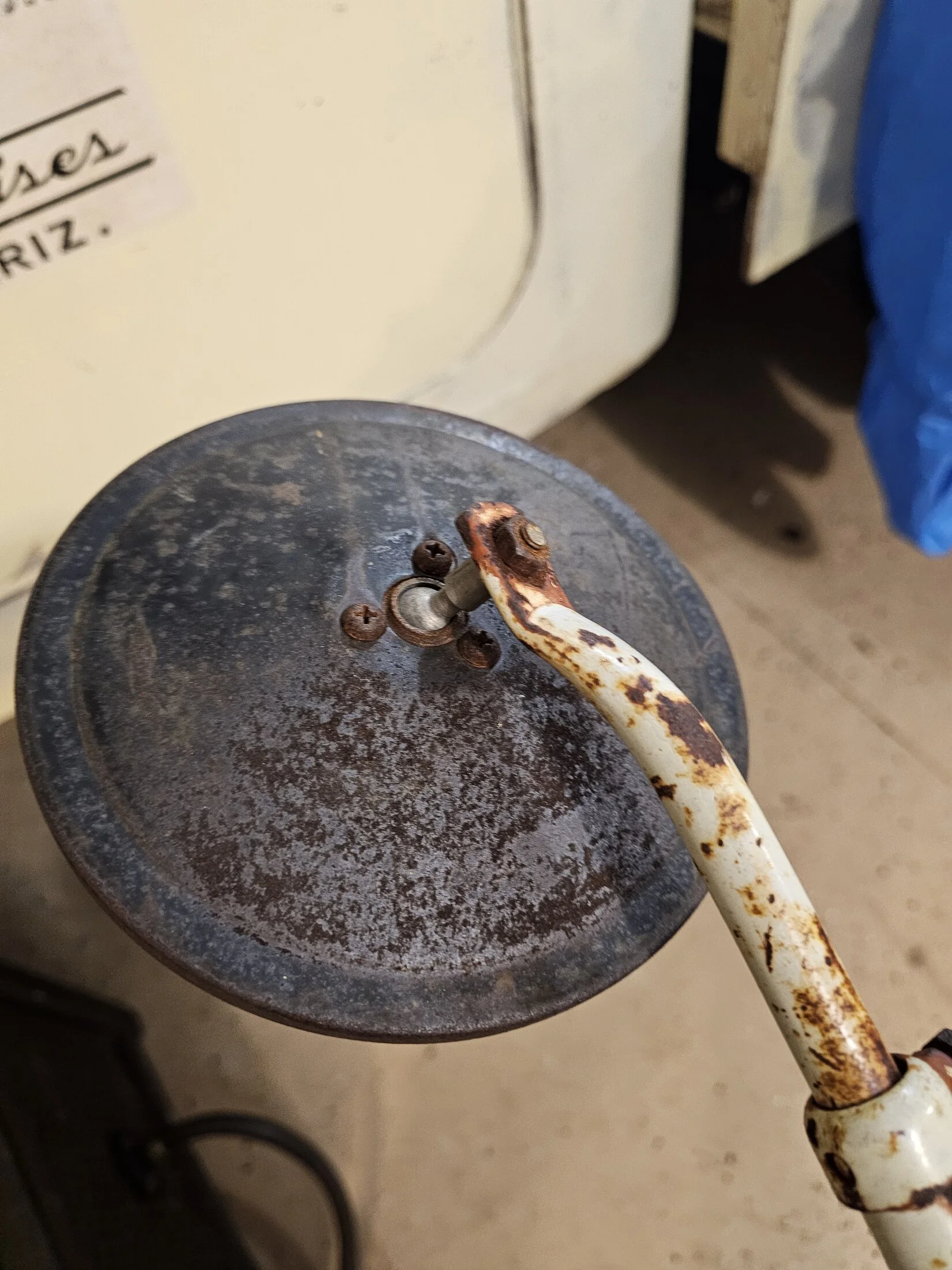

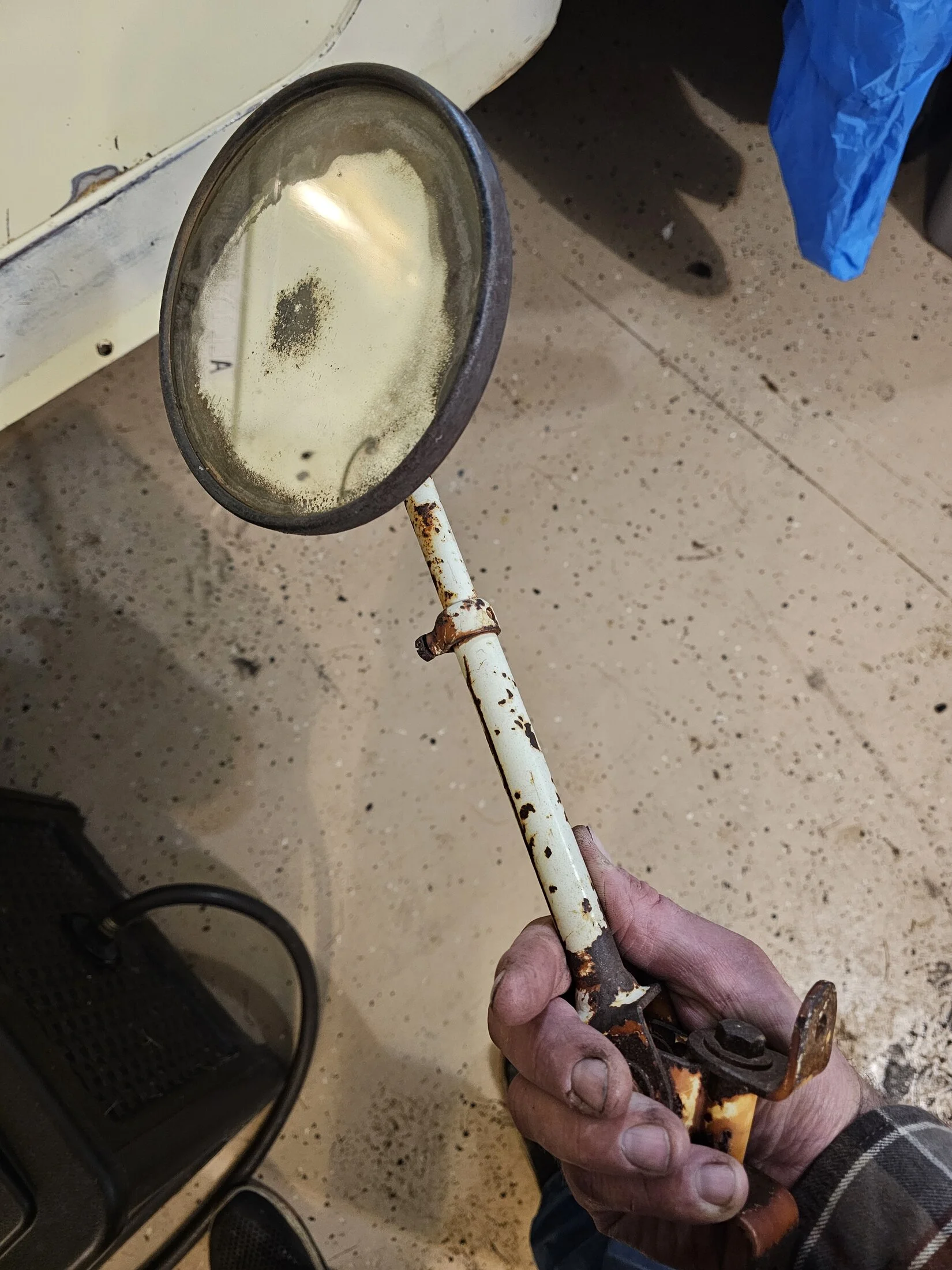

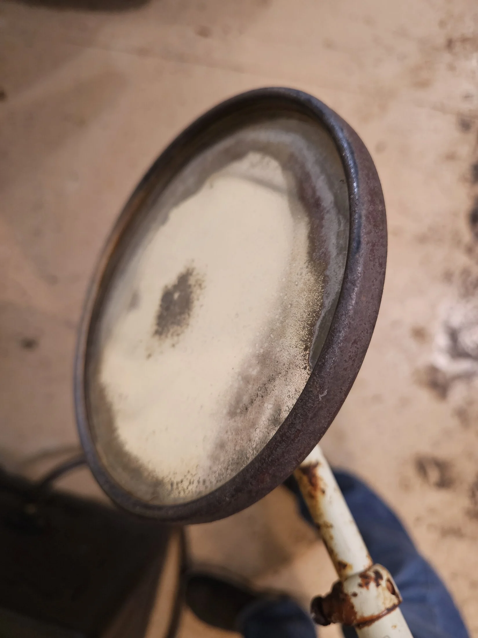

It's been a bit since I have worked on Bell. I have been totally stumped on how I can put a new mirror glass in the factory mirror. There is no way to separate it that I can see. If anyone knows the trick, I would greatly appreciate the help. I would like to scrub the rust off and use the original mirror.
I think I can get the new mirror glass part handled. Just gotta get it out of there
That is the ultra rare large mirror. I have one on my 45
The way I do glass is that I take it to the glass guy.
Well, I have a good friend that is a commercial glass guy.
I hate to admit that I didn't ask him first😂
I really want to use this one vs a replacement
You must use that one.
They can just glue a new piece in
Oh. Yeah. Duh.
Hadn't thought of that. I kept thinking get that one out and replace.
I agree that nothing else looks so right on there.
Thanks for the moment of clarity
Several of that era 40 and 45 rear view mirrors have the same issue with replacing the glass. If it were me I would carefully break out the existing glass in pieces along with any mastic, cut or have cut a new piece of mirror, and attach it as it had originally been, perhaps this time with silicone. Just a thought.
