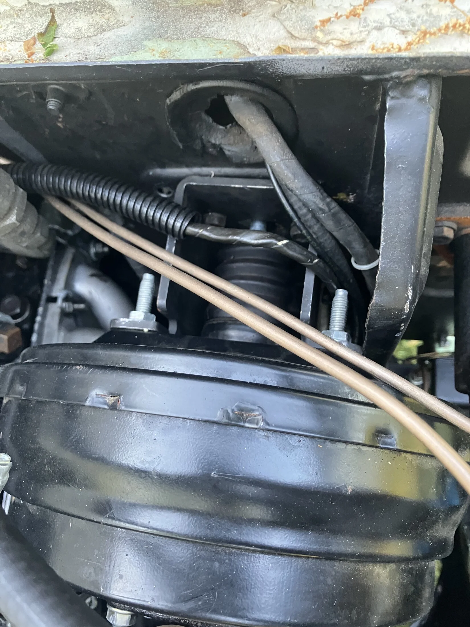

I’d suggest an FJ60 booster and MC.

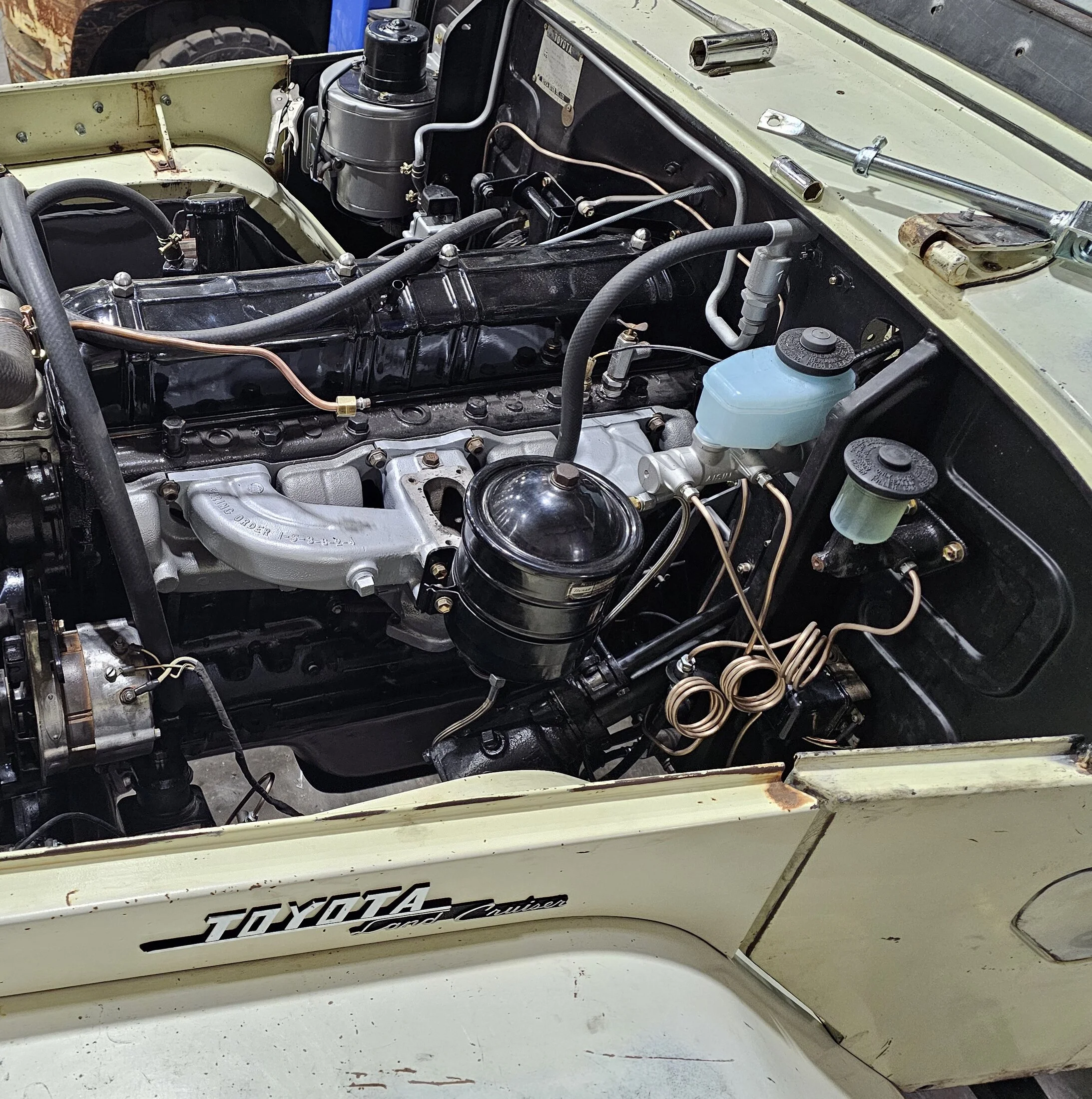

I've been hoping to avoid the booster because I decided to not cut the firewall. Hopefully that wasn't a bad decision.
There is a spacer that is available to keep one from cutting the firewall rib. The only issue is that it places the MC fairly close to the carb.

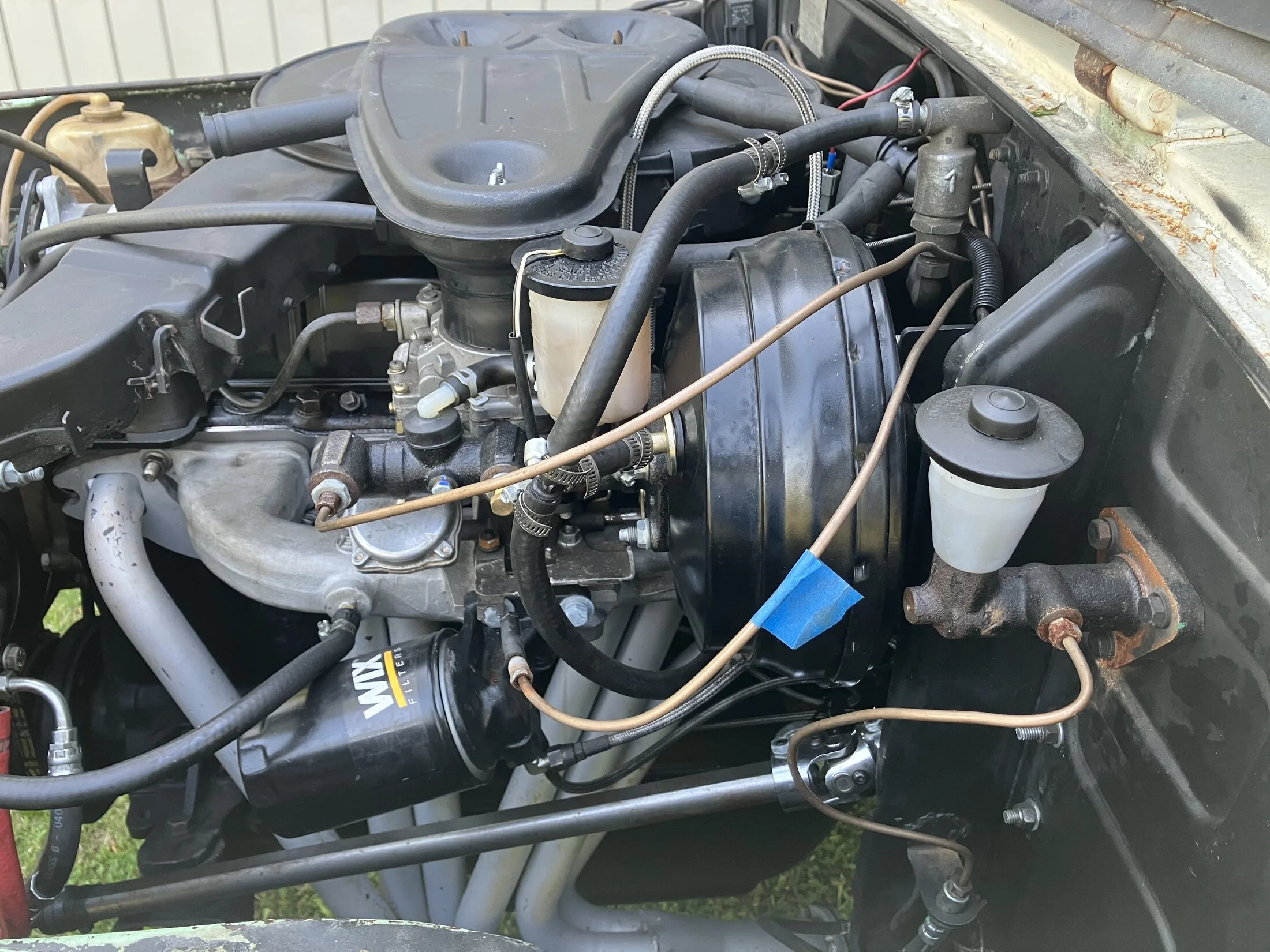

I am at work, but looking at pictures, I think the oil filter canister may kill the ease of doing the booster.
I have a Wilwood adjustable prop valve in there now too

I took a quick look. The oil canister is definitely in the way. That said, it isn't a terrible thing to move it. I like that it is on there. The fact that new filters are available and inexpensive from Mr T is totally cool.

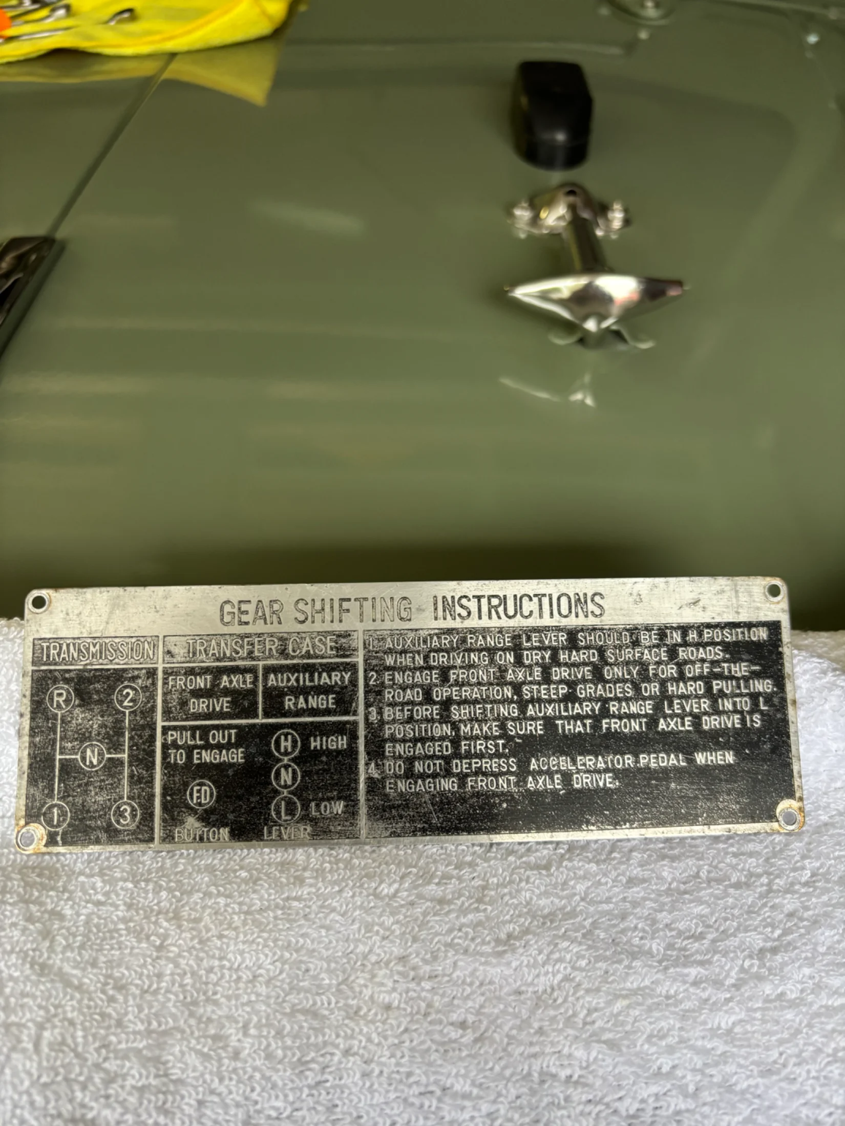

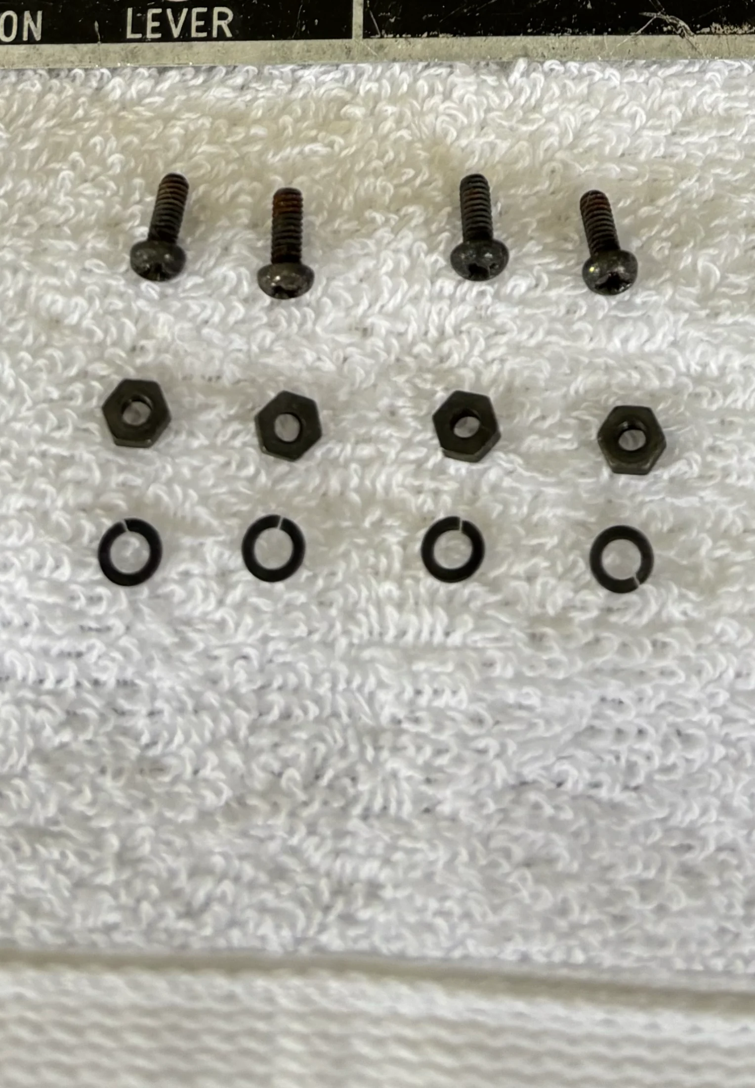

Hi Pat, were you able to find an early shifting instructions plaque for Bell the 45 ? I think I have one in my stash. Let me know…
Mark

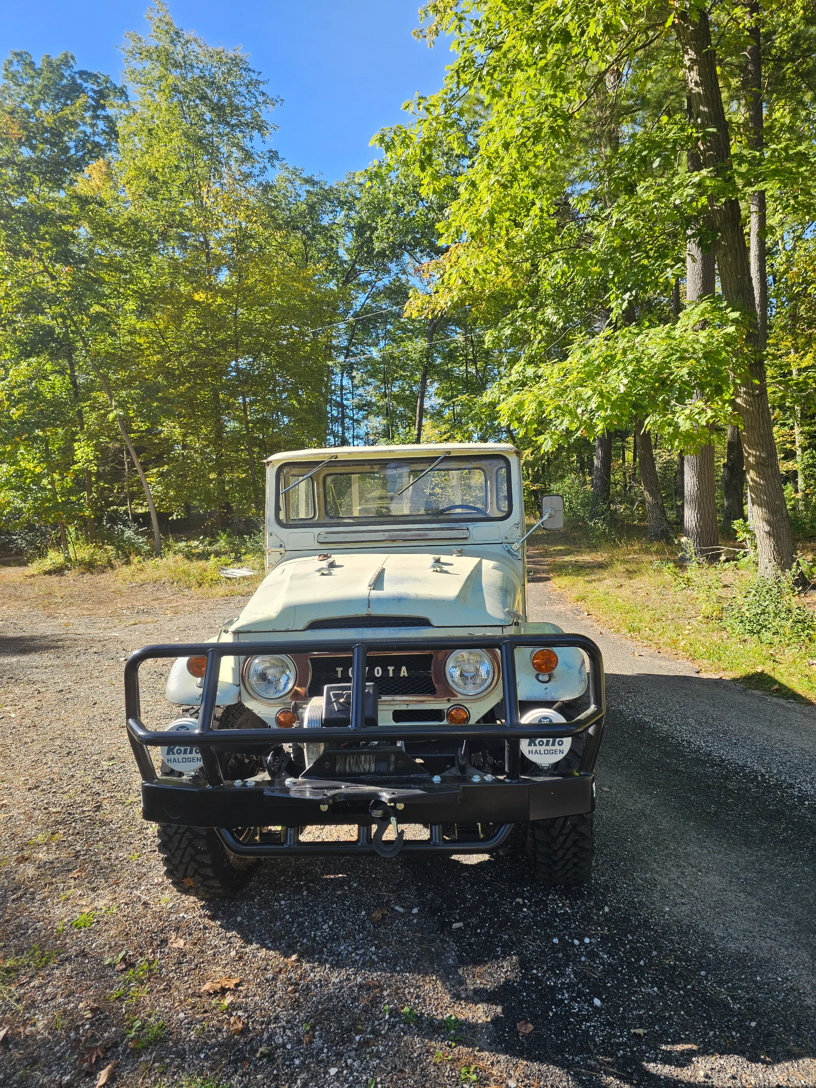

I still haven't finished up the last few things on Bell, and the season is almost over. I need to do the gaskets on the drivers side, the running board on the drivers side, exhaust, and still figure out what to do about tail lights.
I suppose they will be winter projects now. Life and work just got too busy- and other Cruisers breaking down.
I did take him for an open exhaust run to the road and back. One whole mile trip!
I’ll get it out to you. Glad to help.
Big shout out to @cppilot for the gear shifting instructions. He even sent the bolts!
Thank you!
