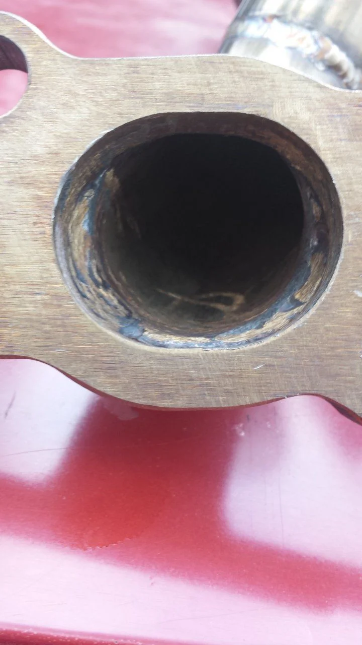

Did some grinding on the flange transition area of the header and smoothed it quite a bit

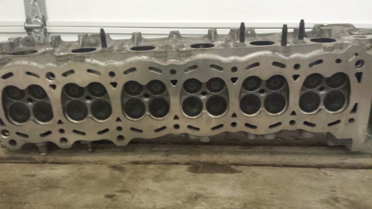

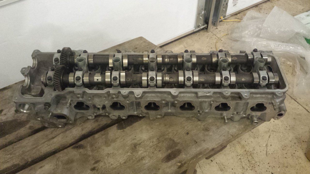

Picked up the cylinder head today too. Looks pretty good, cost $700 to have done

I started down that path on my own. Didn't do as mush as I wanted to because I was leaving the country on a business trip. I was able to debur it all, polish a little bit and I did my lazy blueprinting. It was better than nothing....I think

I was in such a rush to get the head to the machinist I didn't look at the port match (or mismatch) til I got it back. It really could use the clean up, I just wish I had done it before I sent it out. I got worried about the machine shop being busy because it's spring and they got it done in a week. It really would be nice to do it. There is a really big gasket mismatch to the intake side. Is that typical?
Yeah I think it is normal but you can see what drove me nuts. I spent the majority of the time deburring and port matching.

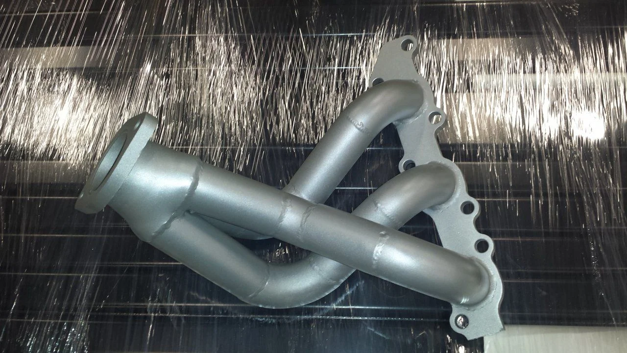

Next up was high temperature powder coating on my CX racing header. I did the silver to try to keep the underhood temp lower. I've had a lot of happy customers with this but all I've done of my own are my snowmobile exhaust systems which works great, so it's time I test it out on my own stuff.
I did the downpipe too but forgot to shoot a picture of it

I Will call them tomorrow for clarification. That header looks sweet but the state of CA has a different opinion.:bang:
