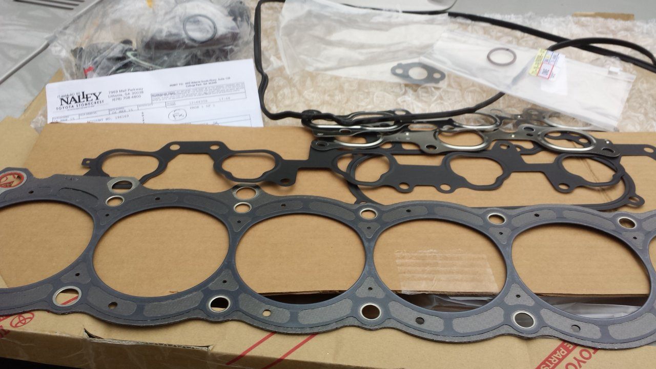

Got my gasket set from Beno, head gasket pm coming soon.
