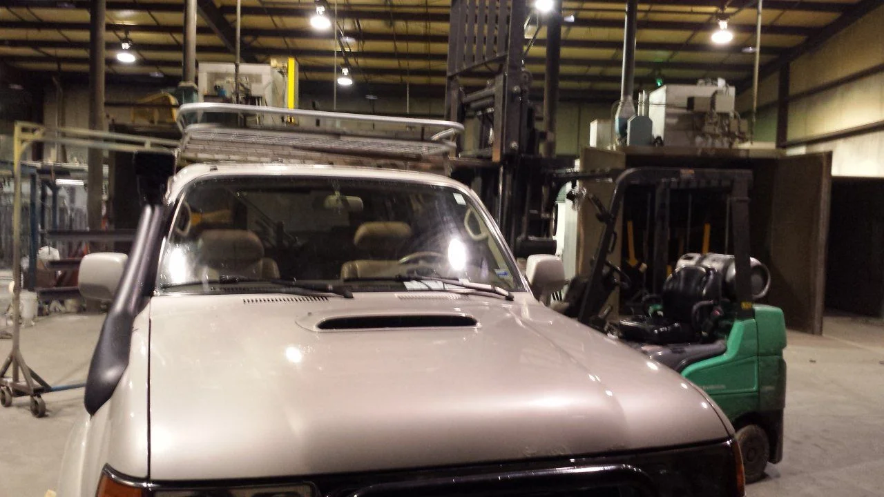

Got some more done on the roof rack. I used 1/2 x 1 1/2 rectangle stock for cross bars. 3x3 mesh for the deck. I decided to make my own gutter mounts so I set it up on the roof and tacked them on. Also roughed out the clamp part.
The clamp is just a 5/16 bolt with the head cut off welded to a piece of 3/4 angle. I ran that through a 7/16 threaded coupler welded on the angle I needed.

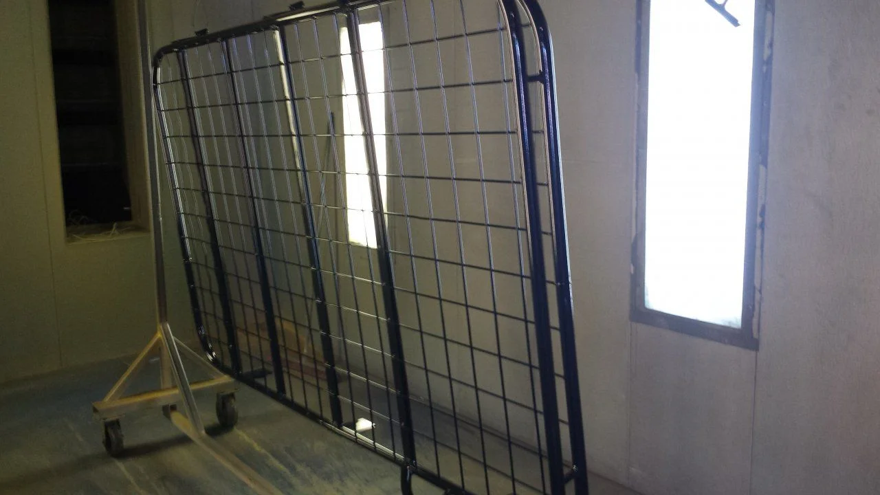

I'll try to get better pictures of the cross bars and mesh tomorrow
3x3 mesh and rectangular cross bars

After sandblasting, first coat of zinc rich epoxy powder
Black metallic with clear next
On the roof and ready
