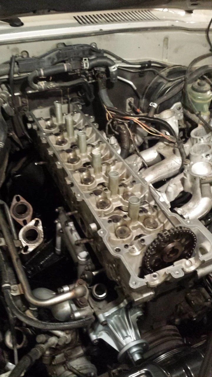

Did some bling for the head gasket job too. Went with bright red and clear for the valve cover. I sanded the red off the script before clear but didn't come out great, might have to paint the script
Found out that I wouldn't get the dowel that is holding up the head install before the weekend and a friend of mine offered to make one so we did that tonight

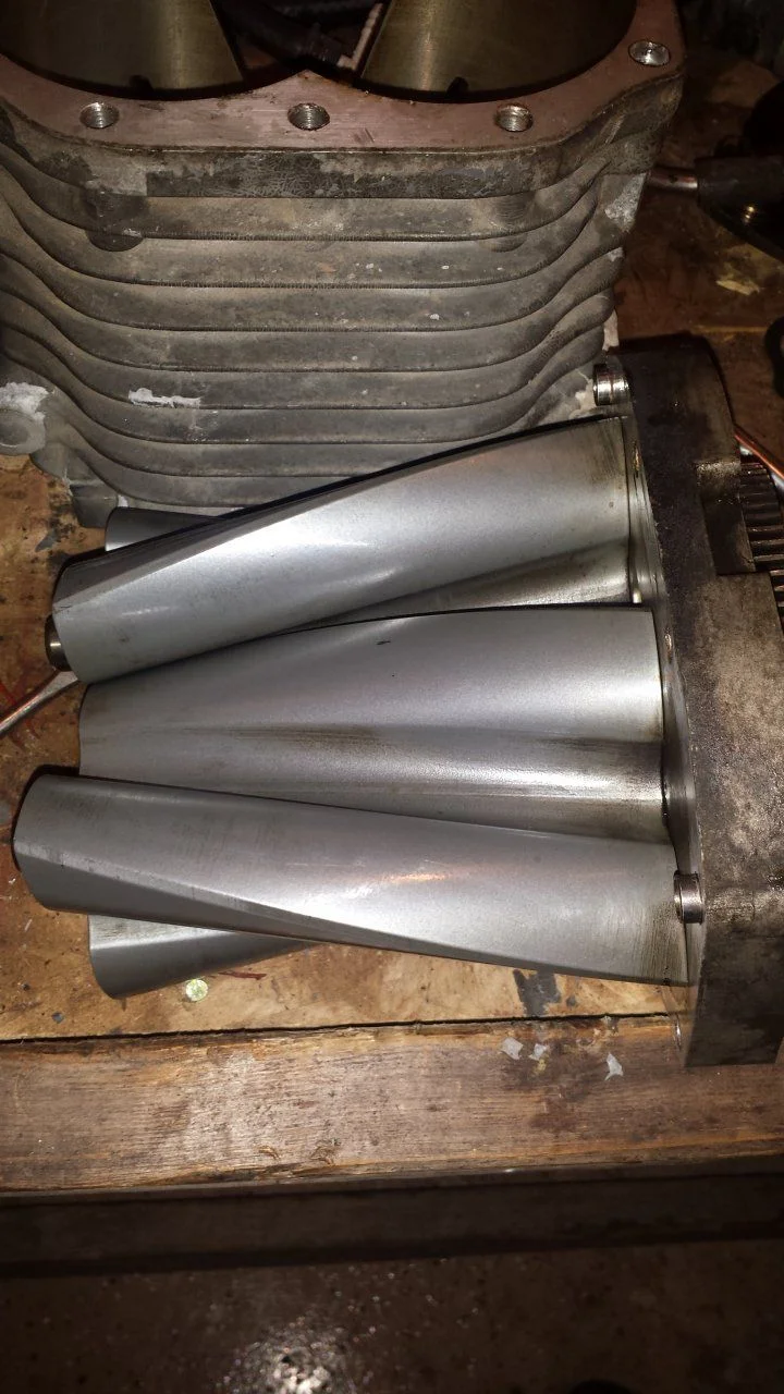

To back up a little, I tore down the supercharger last night. Looks really good, bearings are tight. I'm going to clean it up, re grease and oil and put it back together. Very good chance I may do some porting on it to to help efficiency (cooler temps).

Next big step is the head is back on this morning. Still have to torque and do cams. Hopefully tonight I can make more he
adway

The only thing that I am unsure of is if the newer superchargers are the same. I think the last trd units are Magnussen MP90 units. They look it from the outside. Not sure how bearing replacement is on those. The MP makes the same boost but generates a little less heat. That's why I want to mod my M90, better airflow=cooler. We will see
