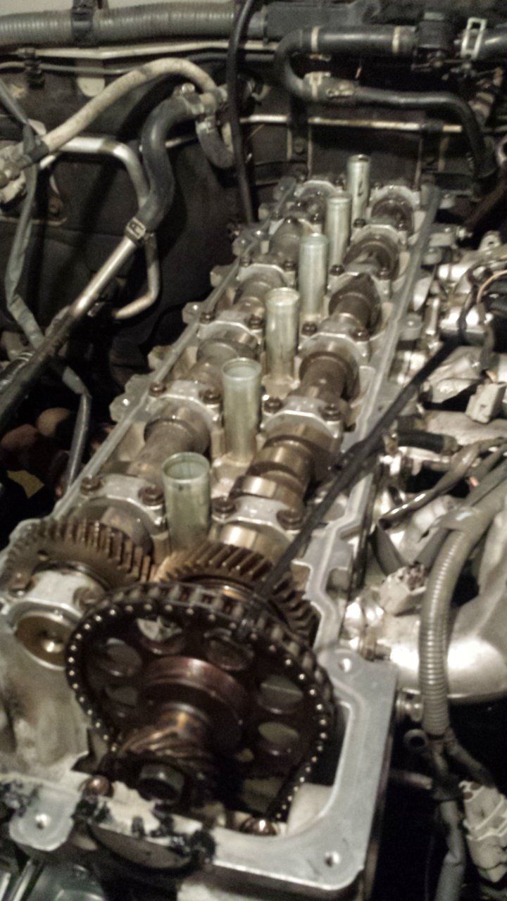

I can't wait to get my 80 back on the trail. I just keep hitting snags. My valve lash was supposed to be set by my machine shop but I've got 5 tight intake valves. Now I'm waiting for shims to come in.
That hole doesn't look like much in the picture but that 4runner is lifted/locked with 255/85 tires and we had to winch it along with a hi lift and a cable to a tree
Got my new shims in this week and finally got a chance to put them in and check clearance. All good on intake and exhaust now

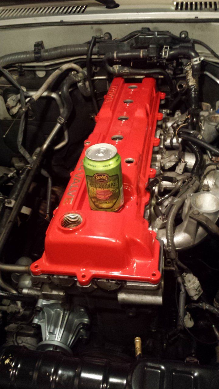

Everything torqued and put on the valve cover with new plug seals and gasket
I got mine in singles. I needed six but I did order two extra just in case I needed the next thinner size. Didn't wind up needing them.
