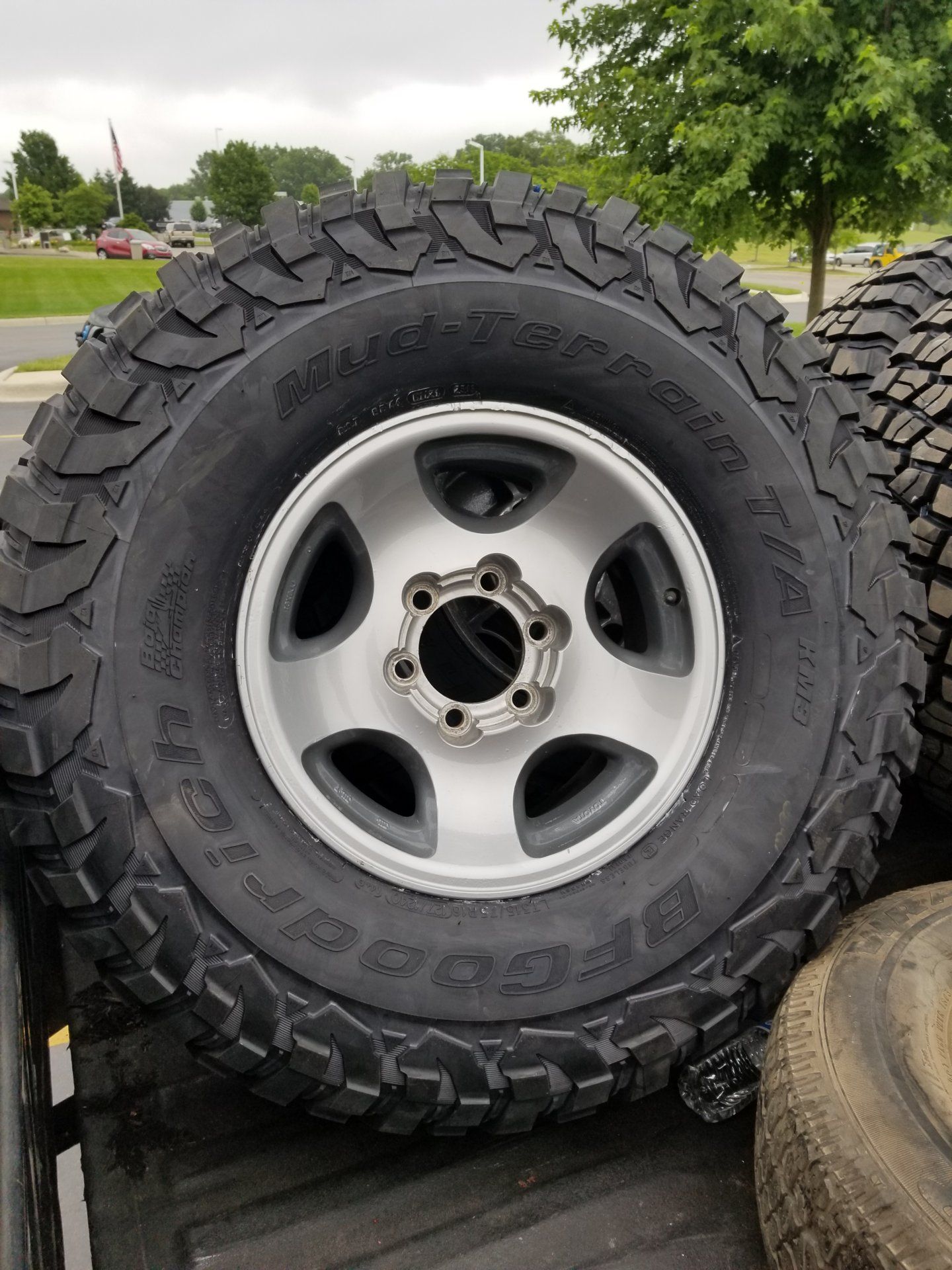

I've been bad about keeping up. I keep finding more stuff. I left the truck sitting on blocks after the supercharger tear out because I wanted to try the new BFG Km3's out. I really like them. They howl a little on the highway but not bad for an MT. Nice response on the highway, great off road. I ran 20 psi in Colorado and I got up "the wall" on Poughkeepsie with little trouble. Probably the hardest thing I've climbed.

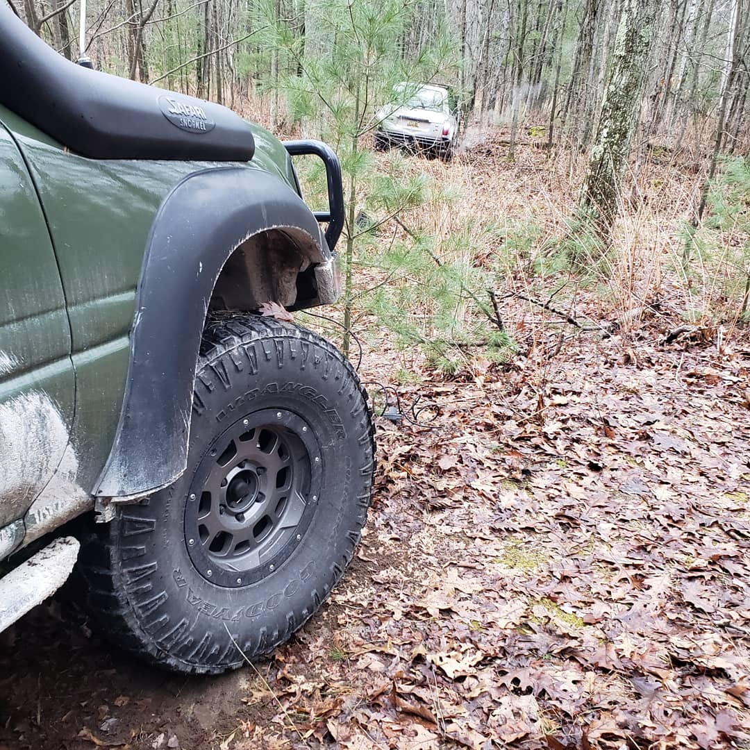

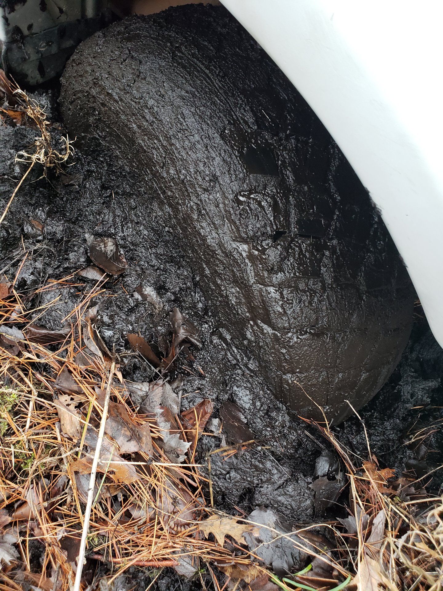

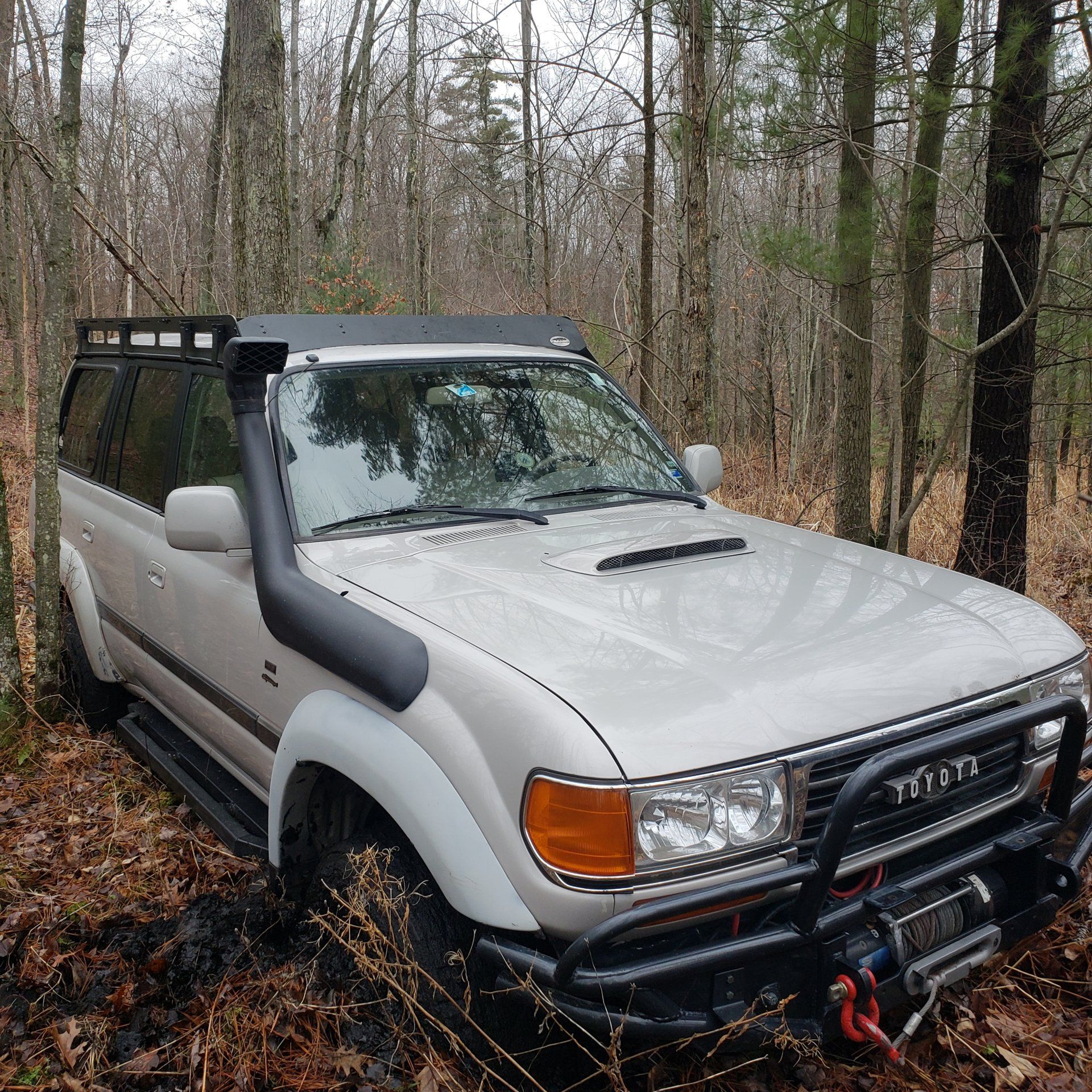

I got cocky the other day and tried to make it down a trail that is only barely passable when it's really frozen(and it isn't). Lockers on and buried. My winch is dead again because the relay box gets moisture in it and fails. I got my daughter to head out and winch me out with her 80. Had it out and tried to rush and went off the side of the trail, back in the muck. More winching. This time I managed to peel the rear flare off.:bang:

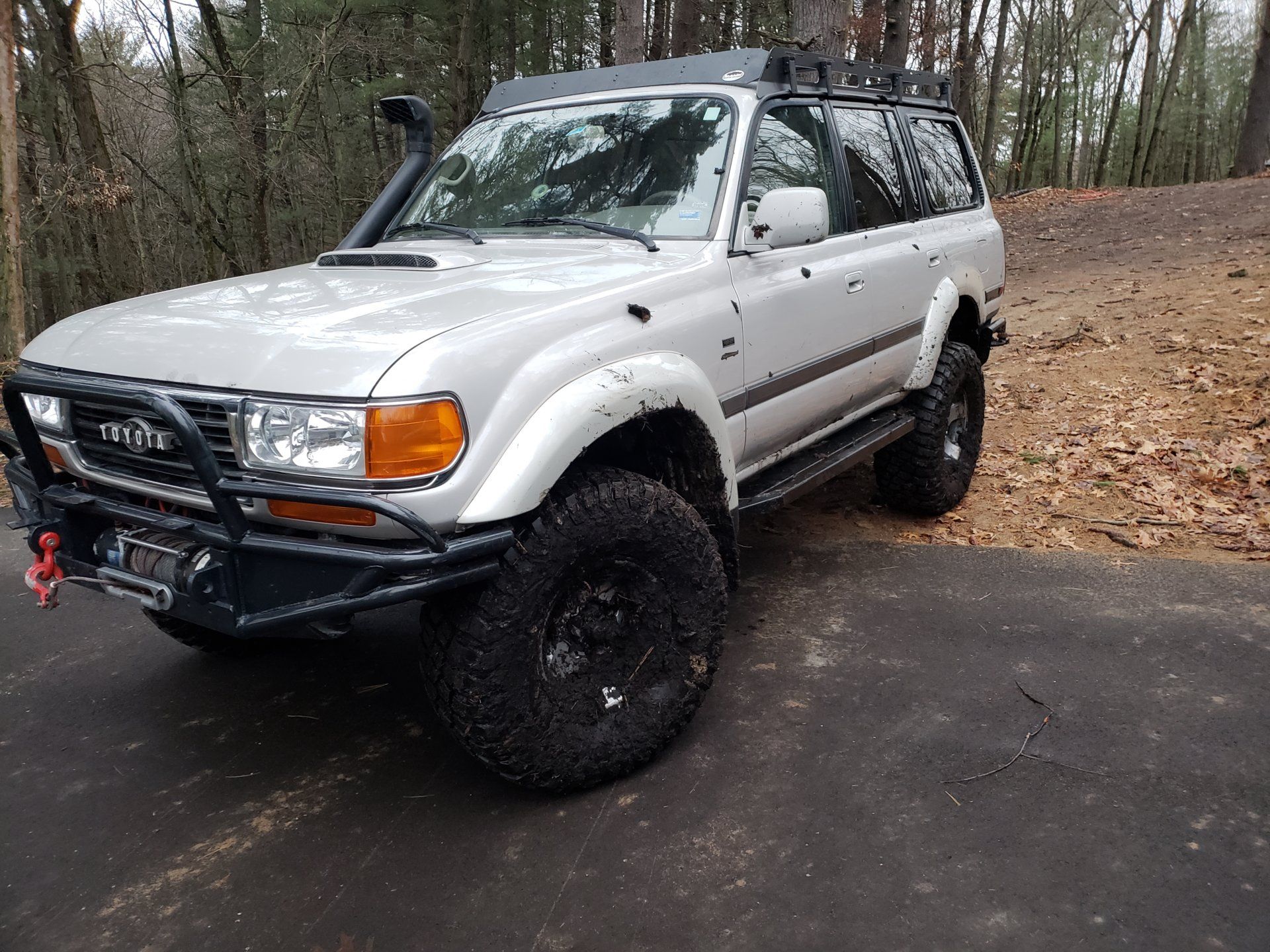

I had been meaning to post up a picture of the truck with the roof rack coated in "evo grey" to match the side trim. The light silver worked with the white wrap but looked wrong with the original Desert Dune color. I'm really glad I went back to original refinished wheels, original paint, and the rack color it has now.

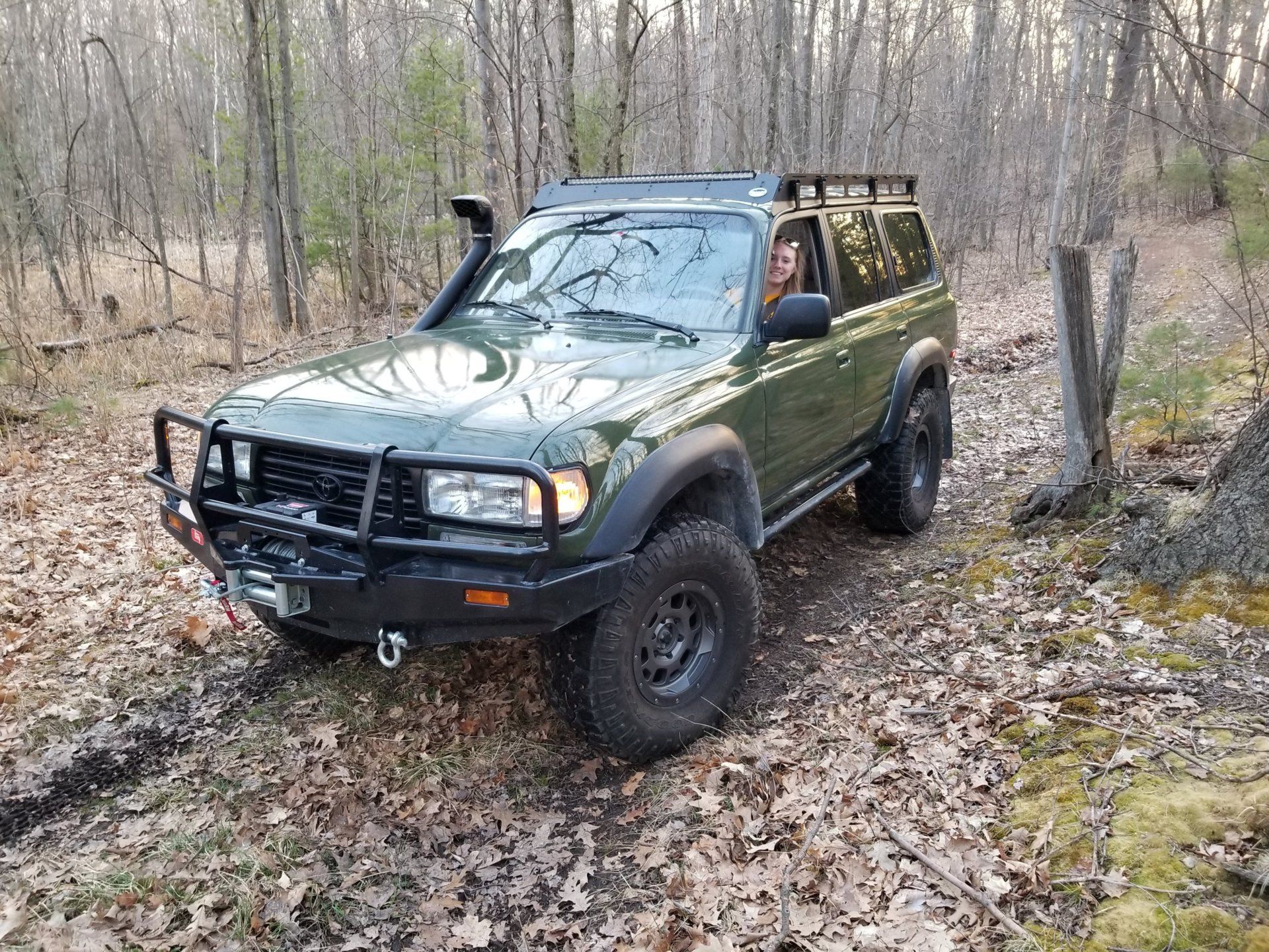

Fun! I like the green on that 80. More pics?
Land Rover green of all colors! I've always liked it and my daughter loved it when we were picking colors. It was a weekend paint job and came out pretty good considering the short time frame to get it done .

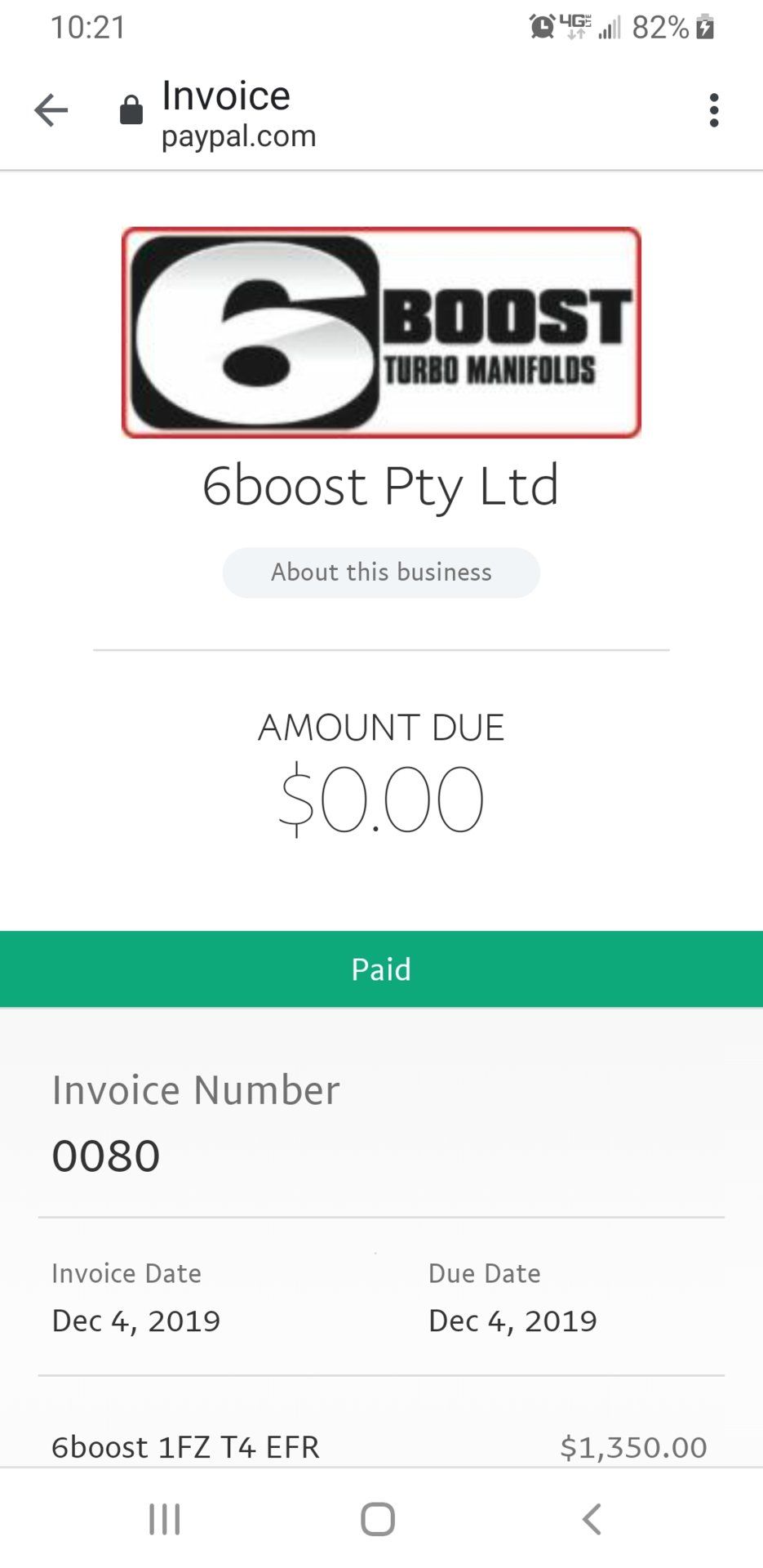

Man, I have neglected this build thread! Time to give it a jump start, sort of. One of the biggest pieces missing to finally building my turbo setup is ordered and is on the slate to be built mid January.
I have gone round and round deciding on making my own manifold or not. No time, and this one will be sweet.
Mine won't need the wastegate port with the 8374 Borg Warner EFR.
