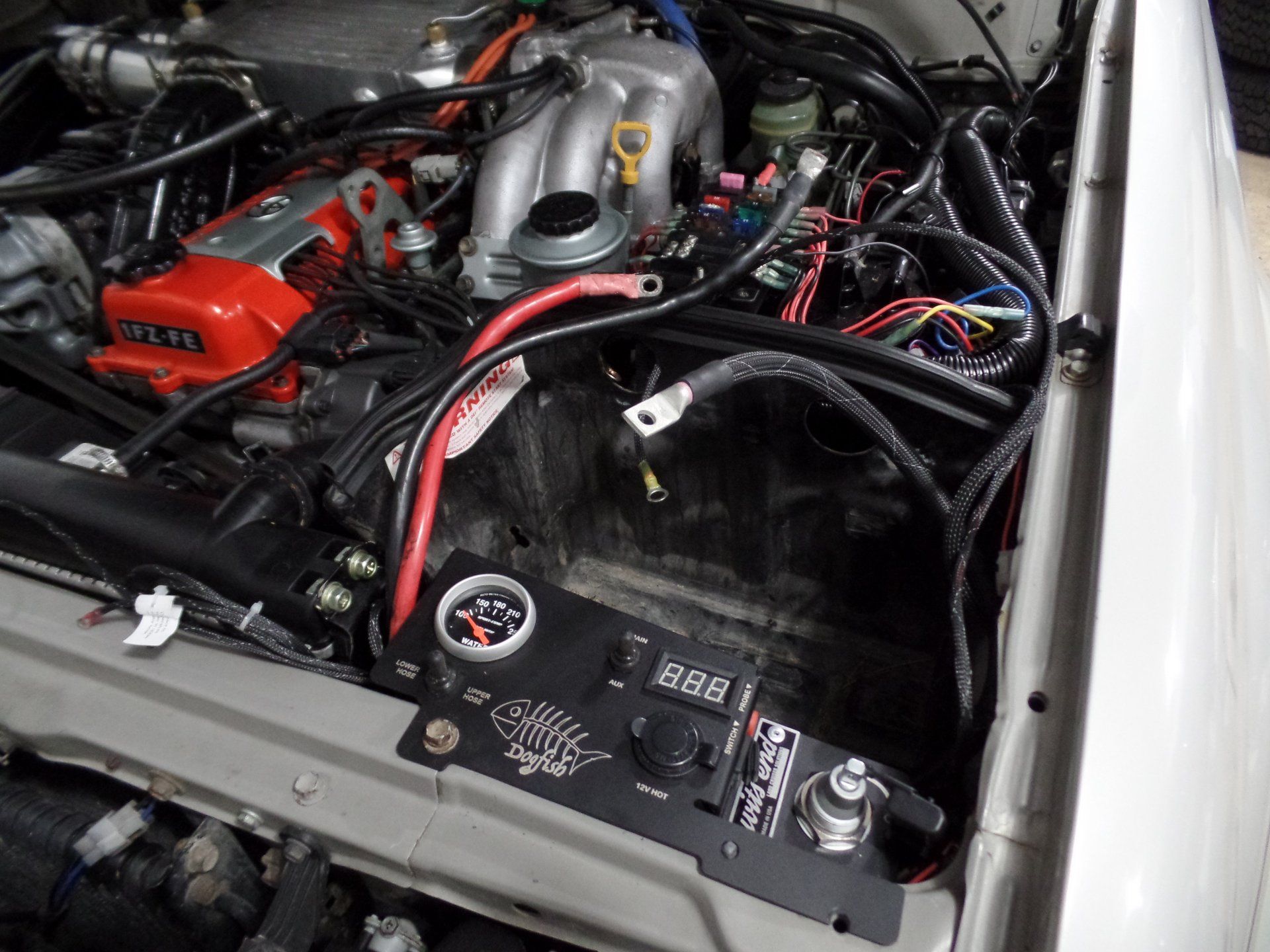

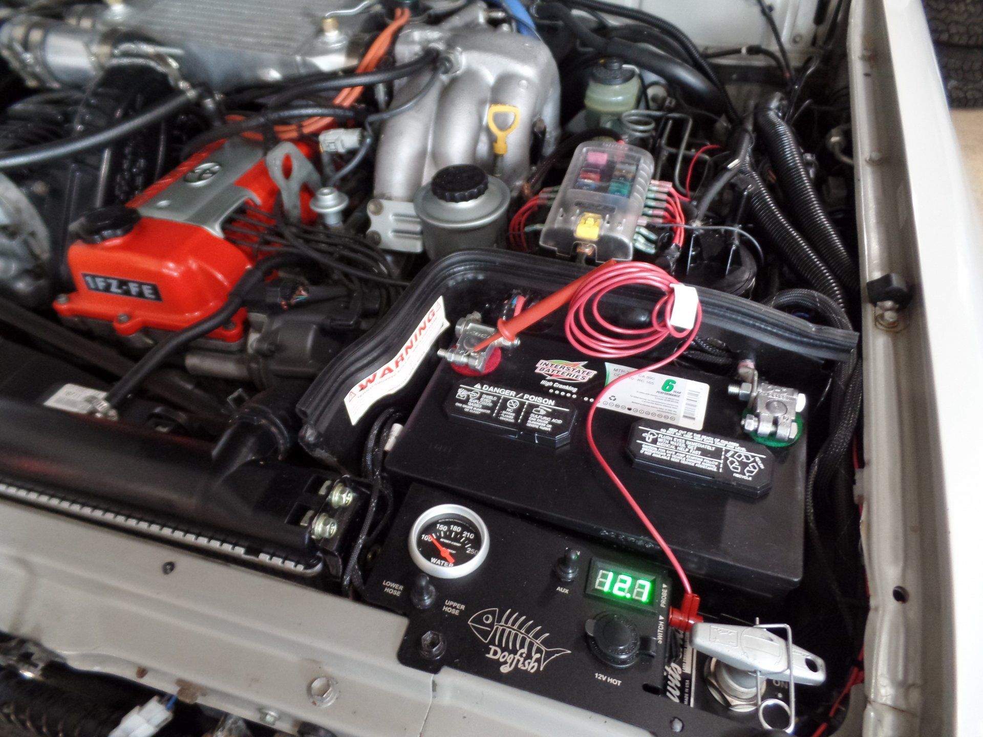

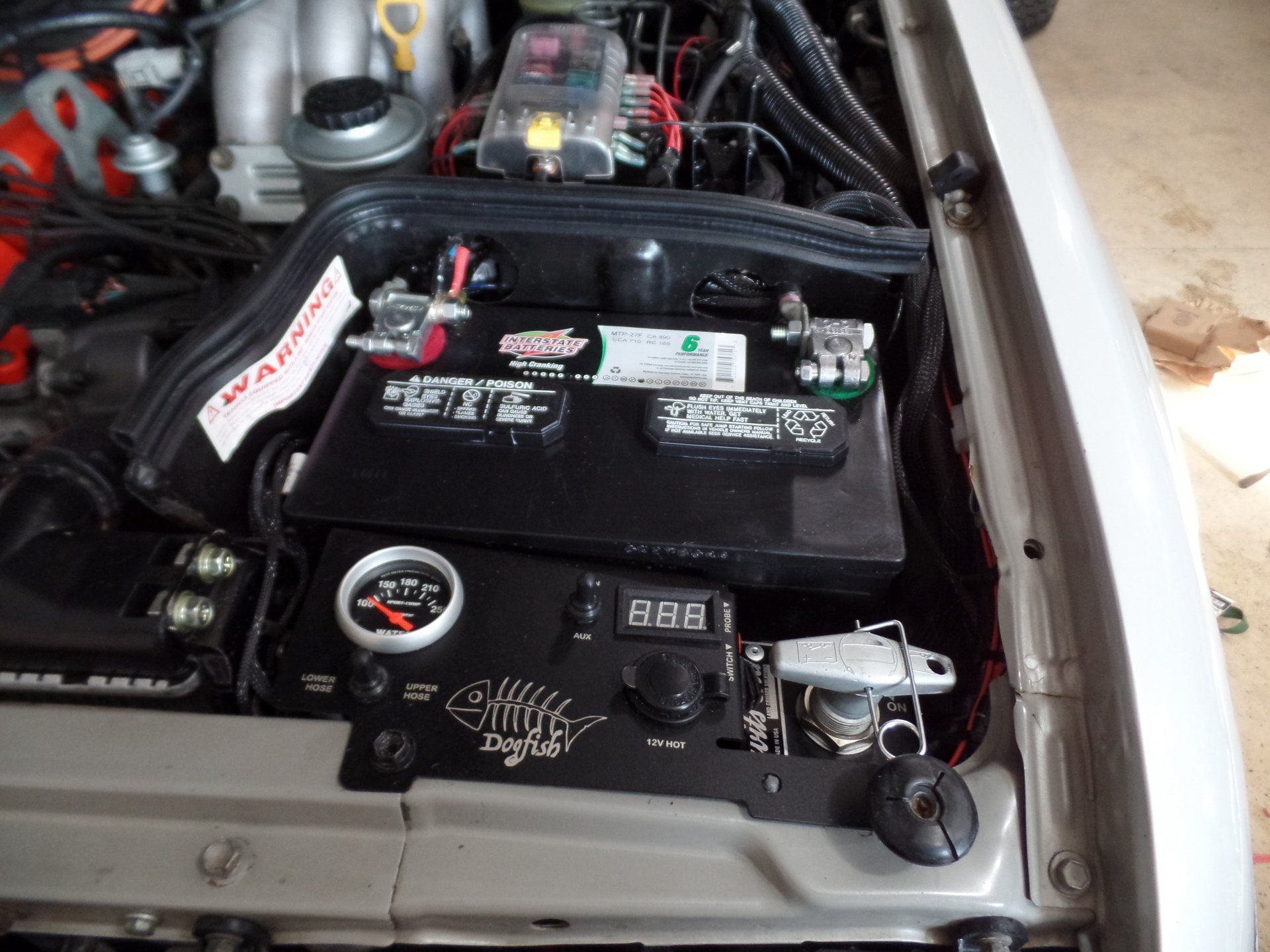

I have had my Wits End battery disconnect in my hands for a few weeks now, and I must say, it is a really nice piece of hardware.
I realized I had to do some work on the battery area while I was doing this install so I found an Interstate Megatron 27f battery locally after striking out at Costco.
I made a strap to go underneath it that I can grap with 2 hooks to get it in and out because it does not have a carry strap and the disconnect makes a super tight fit.
The disconnect comes with new cables which is good because mine were not so good. I also redid the wiring to my blue sea fuse block with braided shielding and heat shrink to match the disconnect wiring.
The install should be easy but I have a lot of stuff cramped in there and those hige cables were tough to move around. I used my chain saw file to mod the fiberglass box so the cables ran better. I also switched to military style clamps, and the large bolt was too big for the fusible link (which is new too) so I had to file that too. I still have to figure out senders for the temp guage and put in an led strip for underhood lighting but the disconnect is very cool. The volt meter is going to be handy too.
The install should be easy but I have a lot of stuff cramped in there and those hige cables were tough to move around. I used my chain saw file to mod the fiberglass box so the cables ran better. I also switched to military style clamps, and the large bolt was too big for the fusible link (which is new too) so I had to file that too. I still have to figure out senders for the temp guage and put in an led strip for underhood lighting but the disconnect is very cool. The volt meter is going to be handy too.View attachment 1424303 View attachment 1424304 View attachment 1424306
Nice attention detail under the hood Dogfish, I like it
Thanks! I still have a lot of going back and organizing to do. I think I remember @jcardona1 talking about doing wiring projects to completion when adding something new or it is a pain to go back to later. That is the exact mistake I have made and have a lot of catching up to do. Don't really want to try out my fire extinguisher (in the Wits End mount) on my bad wiring!
