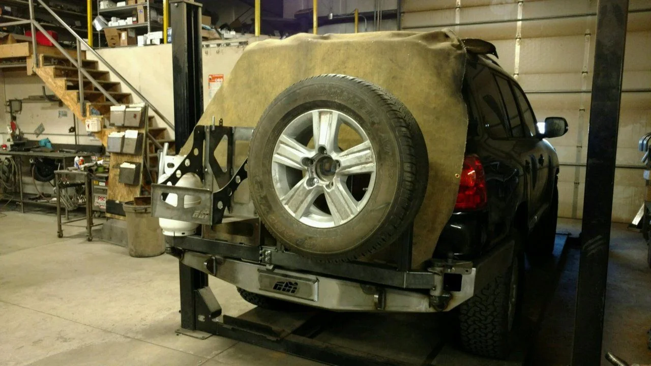

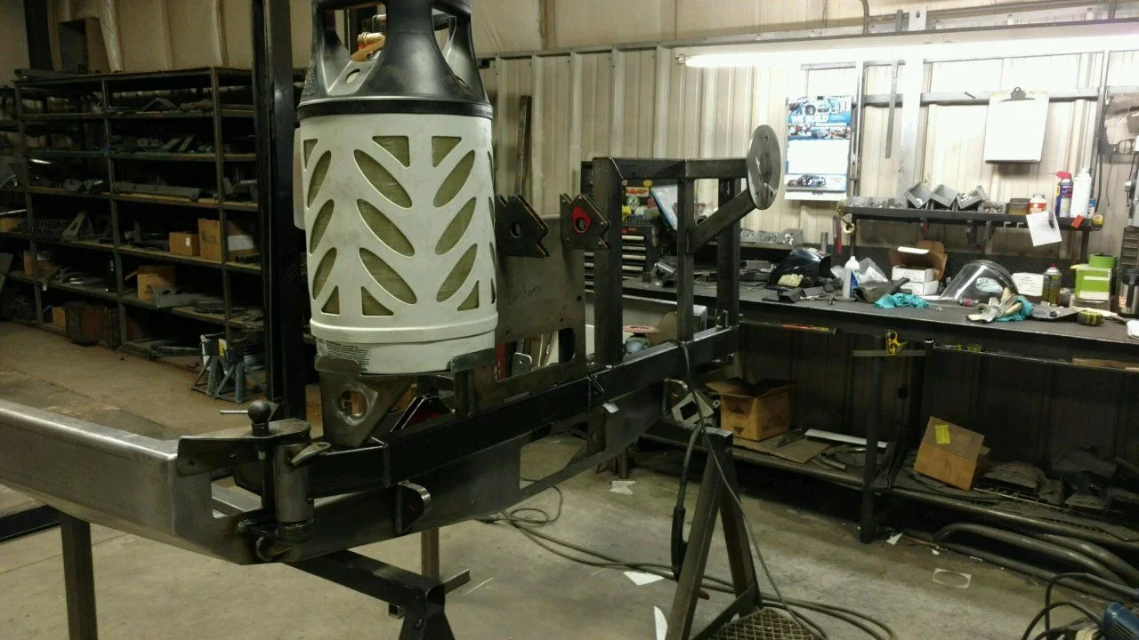

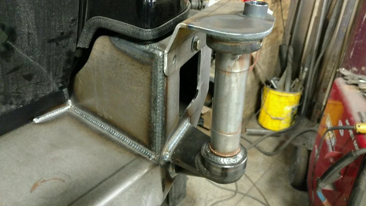

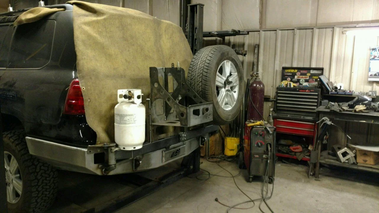

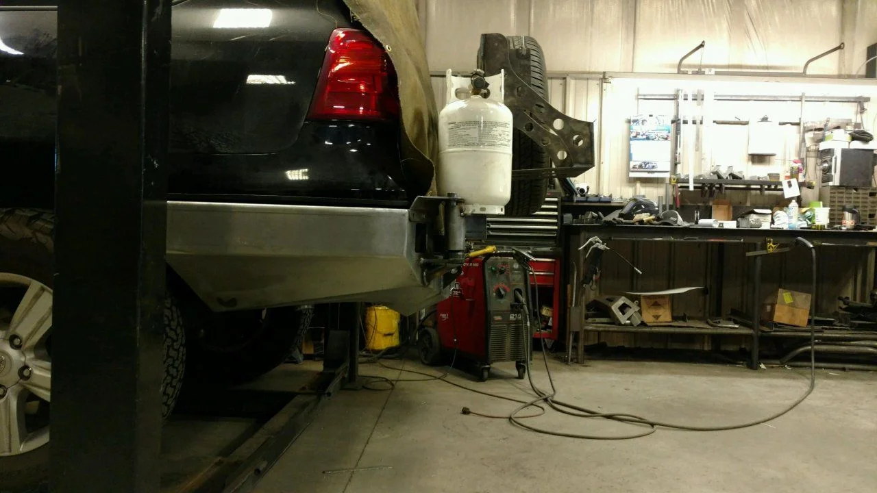

Well we are in the final stretch of the major stuff. We have skid plates cut and ready for fitment, rock slides out to powder, fuel tank ready to be cut and Steve is finishing up on the swing-aways. Here is where we stand today:
Outside pic of the front:

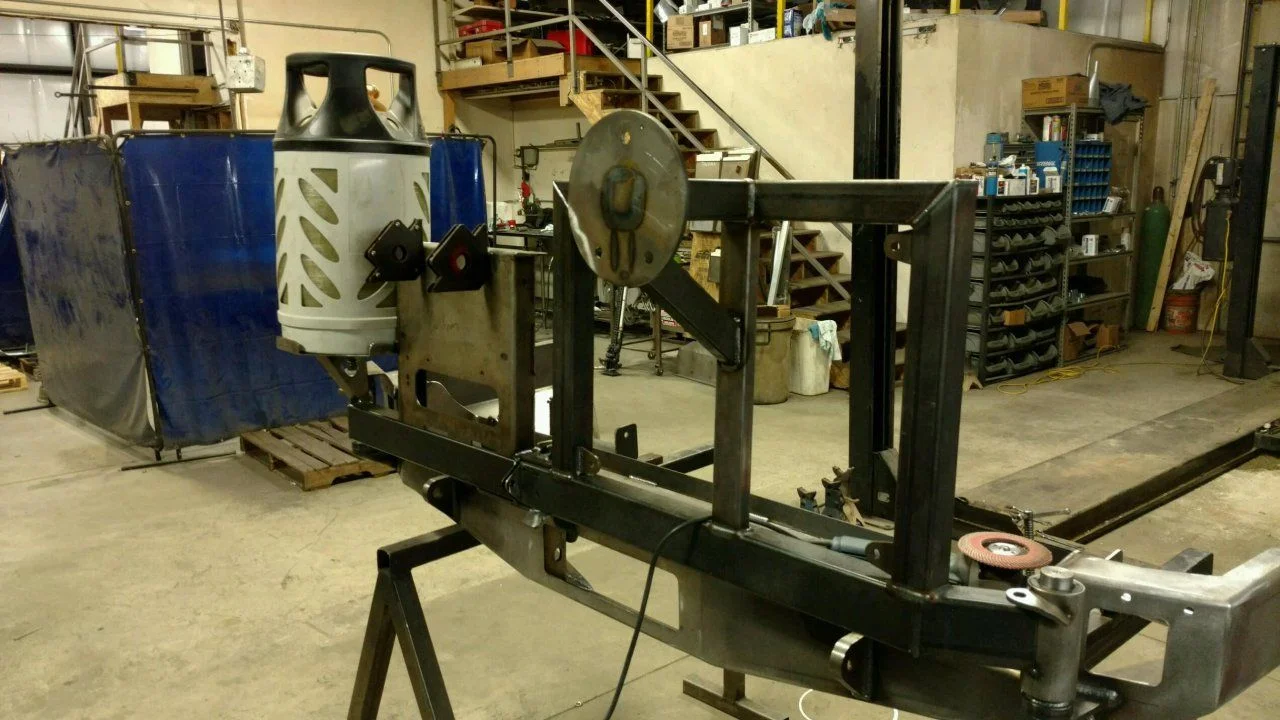

Start on the spindles:

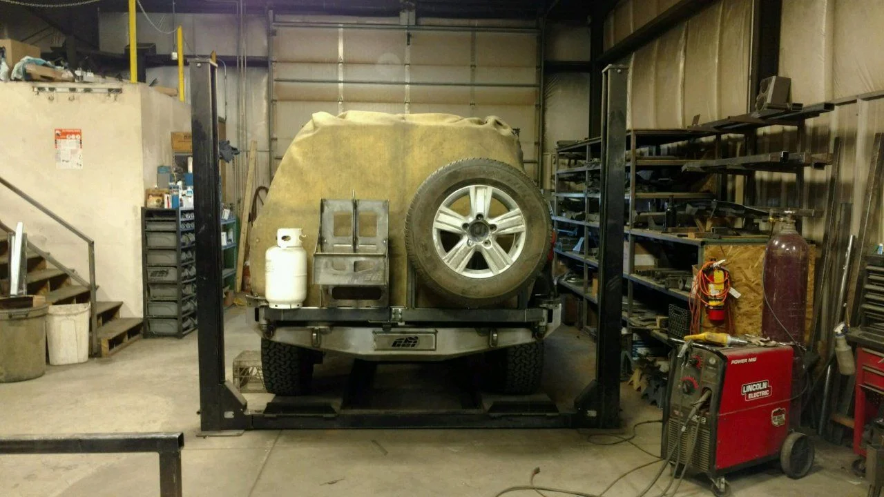

Mock-up:
Damn, man. They are doing a great job. That rear bumper is going to look great!
What are the plans for the tail lights? That tire and tank setup is going to be blocking them pretty good. The recessed cutouts are for rigids, right?
Thanks!! Yes they are blocking the factory lights, we will have oval LED brake/turns right below the swing-aways. Yep, the recessed cutouts are for the D2's.
is the back up camera in stock location going to have an obstructed viewpoint or are you planning on relocating that?
we are replacing the factory BU camera with a new HD one that will be mounted on the swing-away.

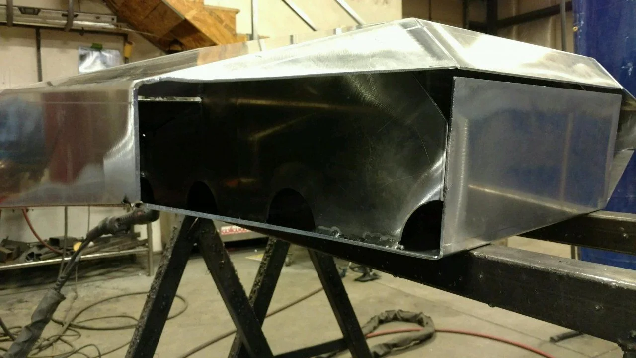

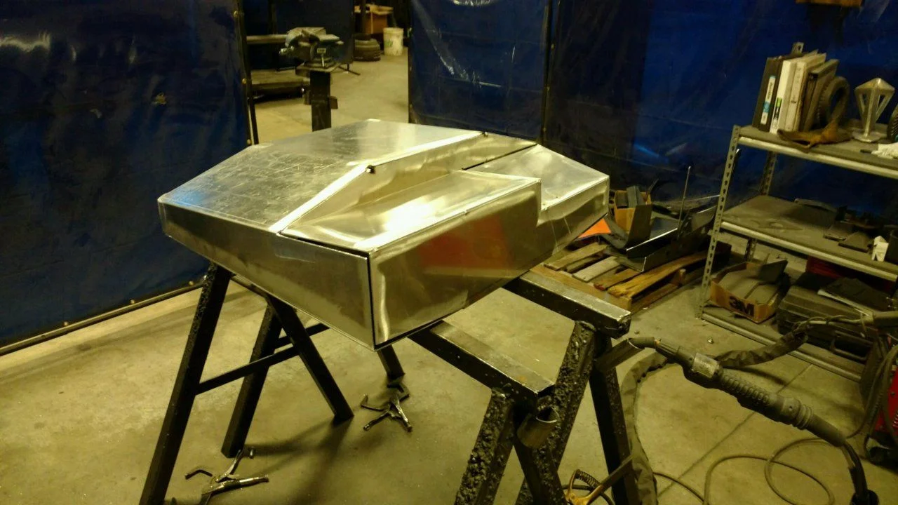

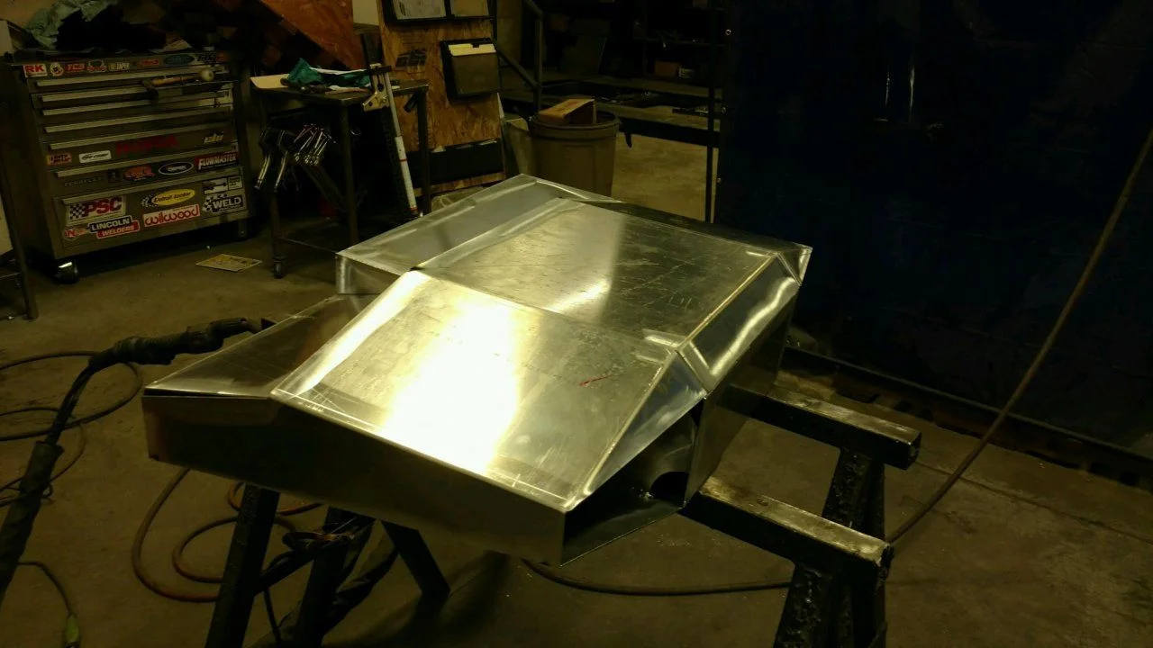

Some pictures of the progress on the swing-aways and the gas tank.
Baffled no less! Very nice tank. So, where is the fill neck for the aux gas tank going? Is it going to be integrated into the rear bumper as well?
Thanks! Yes, beffled is a must! Especially for 28-30 gal. :cool: The tank will be fitted to where the spare used to be, and filler neck for the tank will be integrated into the rear bumper in an inconspicuous area, the transfer 'quick connect' will be located by the factory fill neck. Attach hose, flip switch, transfer fuel, done. :)
