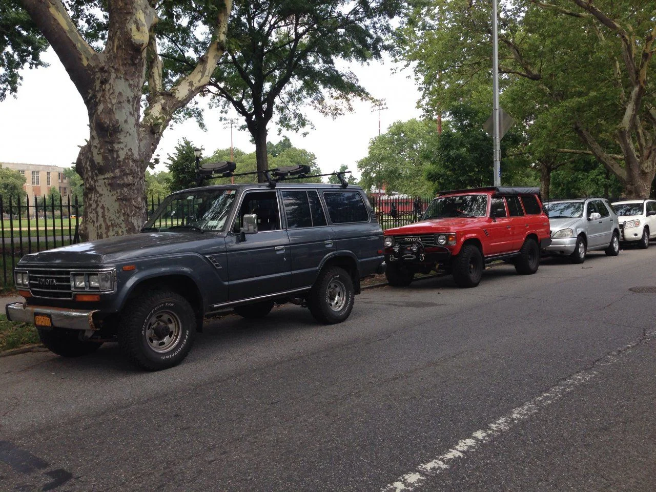

Friend of mine in a very built white FJ Cruiser spotted you today... all the way in GA!
