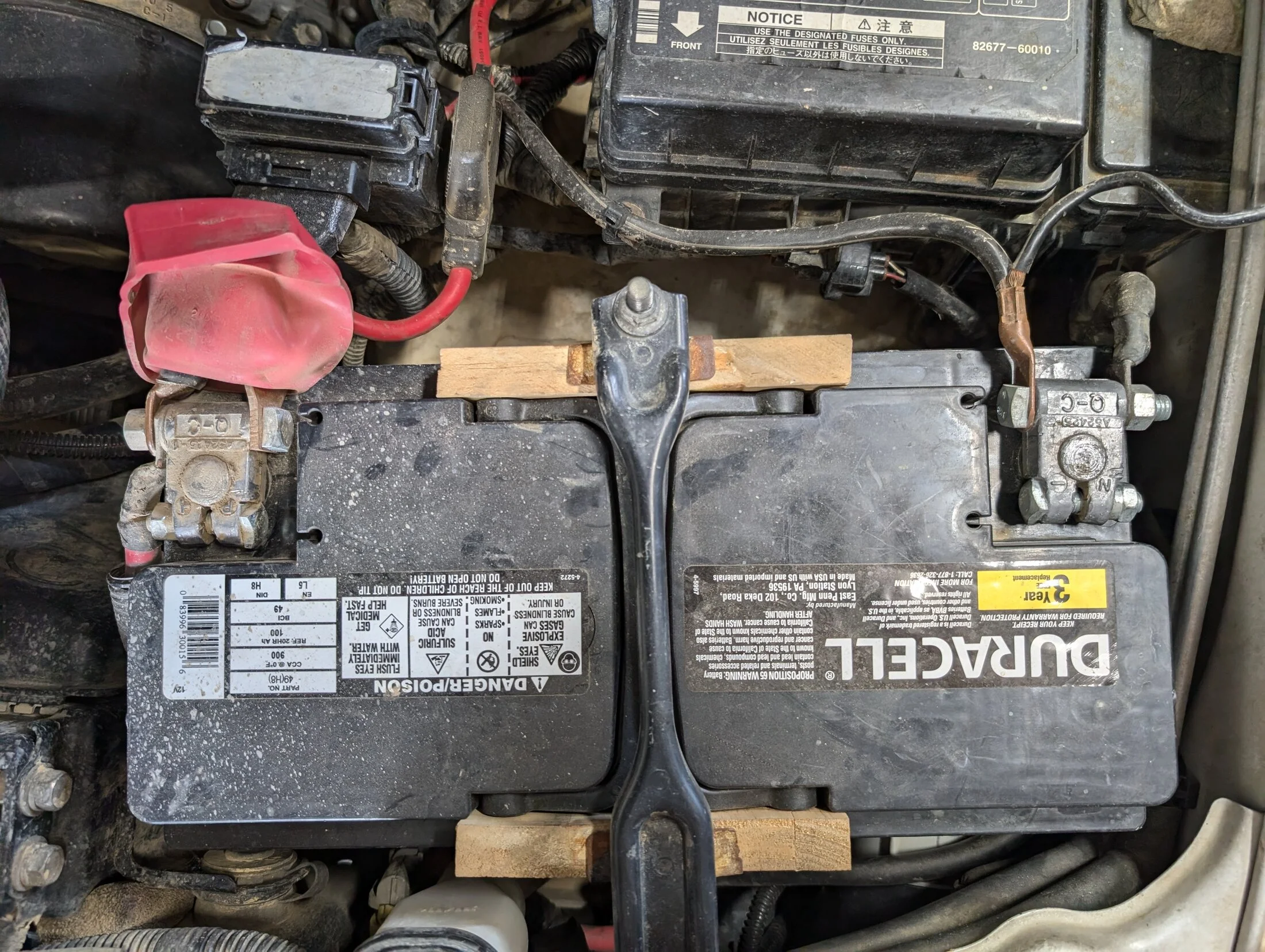

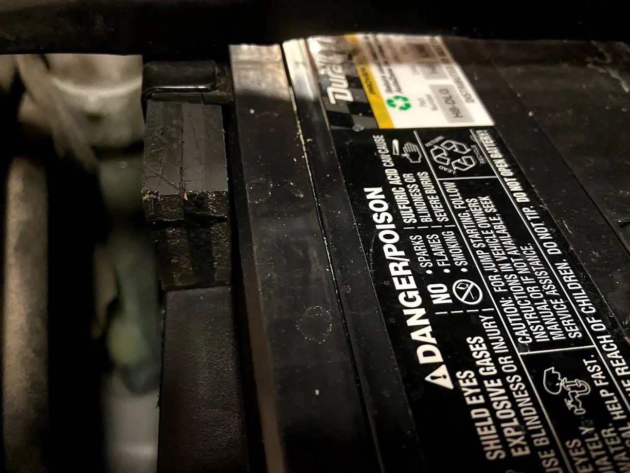

Group 49 FTW!I put in a Duracell group 49 battery ~ made a 3/4" plywood base/spacer with rubber on top to get the top up to stock height.
100 Ah
1105 cranking amps / 900 CCA
185 min reserve capacity
About $160

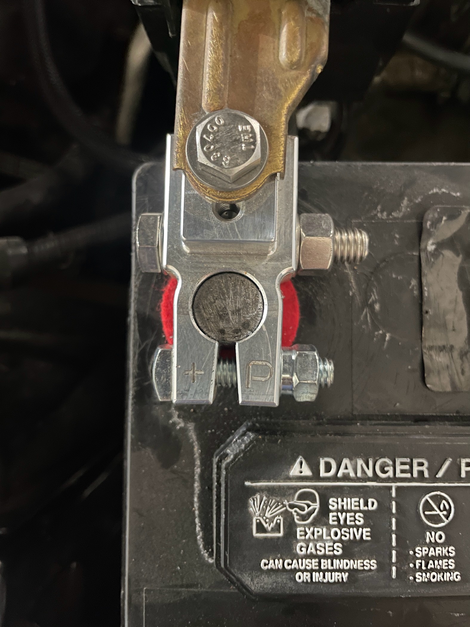

For those running a Group 49 battery, how much space do you have from center of battery terminal to edge of top cap?
I have SDHQ billet battery terminals and they protrude out towards front of vehicle.
Thank you!
Thank you!

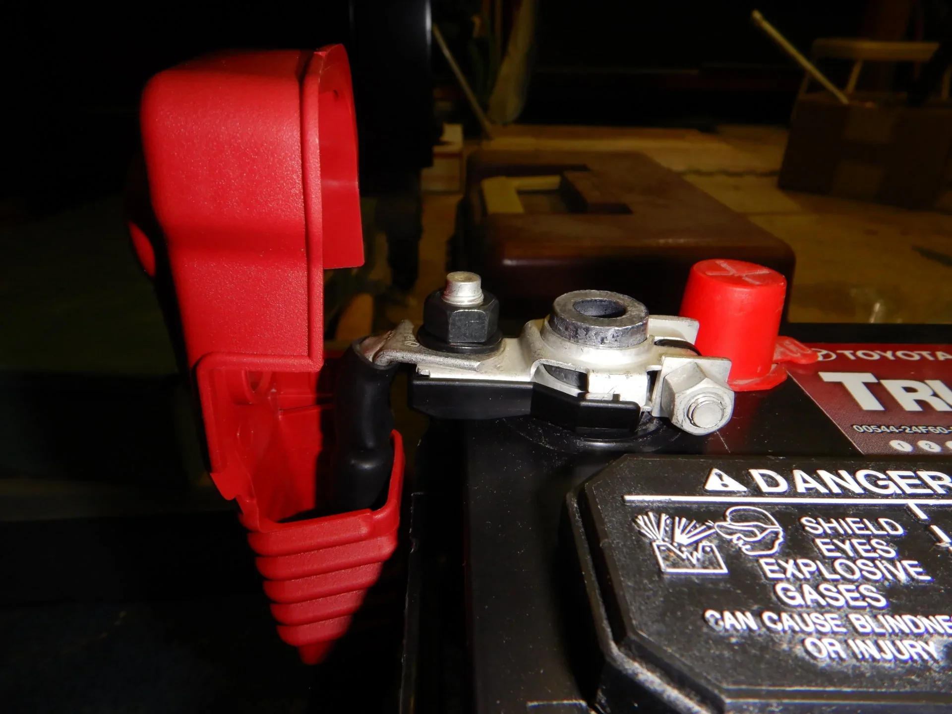

I dont have this setup so I cannot really comment on that. But one thing I see here which may or may not be good is that following - I can see this setup having a see-saw effect. Where the Terminal is being rocked UP like a see-saw "IF" the rear copper end is a lot heavier. Its like a torque effect. So basically make sure this screw on the "P" section is torqued down correctly. Hopefully not crazy tight where it can break the billet.
My group 49 battery is a Duracell from Batteries+
The measurement from the center of the positive post to the edge of the *raised* vent section of the battery top is exactly one inch.
The corners with the posts are essentially inset into the top of the battery - biggest issue would likely be being able to connect them only very straight as in your photo above.

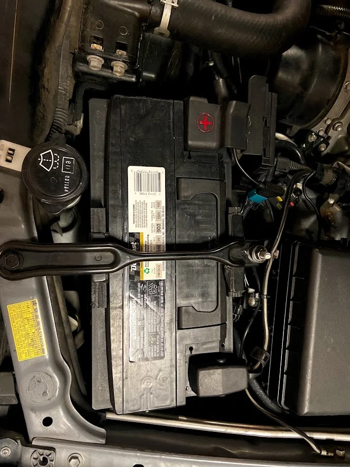

I see some of you using plywood as a spacer to make up for the shorter height of the battery but what does one do if the battery is tall? I was missing the battery hold down bracket and J hook, so ordered them from Bell Lexus. When I went to install, I noticed my Super Start 27RPRM battery is about half an inch taller than stock. Not sure why would the PO/battery shop install incorrect size and get rid of the bracket.
27F is the correct size....I need to compare the dimensions to an OEM battery and see if anything is off. I didn't have a spacer on hand, so just using a longer shoulder bolt to hold the bracket down. There's nothing between the battery and battery tray but I need to look if the tray is pushed up for some reason.You could get a half inch spacer to put under the bracket on the core support side. However, since you are using the correct size replacement battery it should be a perfect fit. I'd make sure there is nothing under the battery tray and i verify it's the correct battery. Could they have pulled the wrong battery off the shelf?
