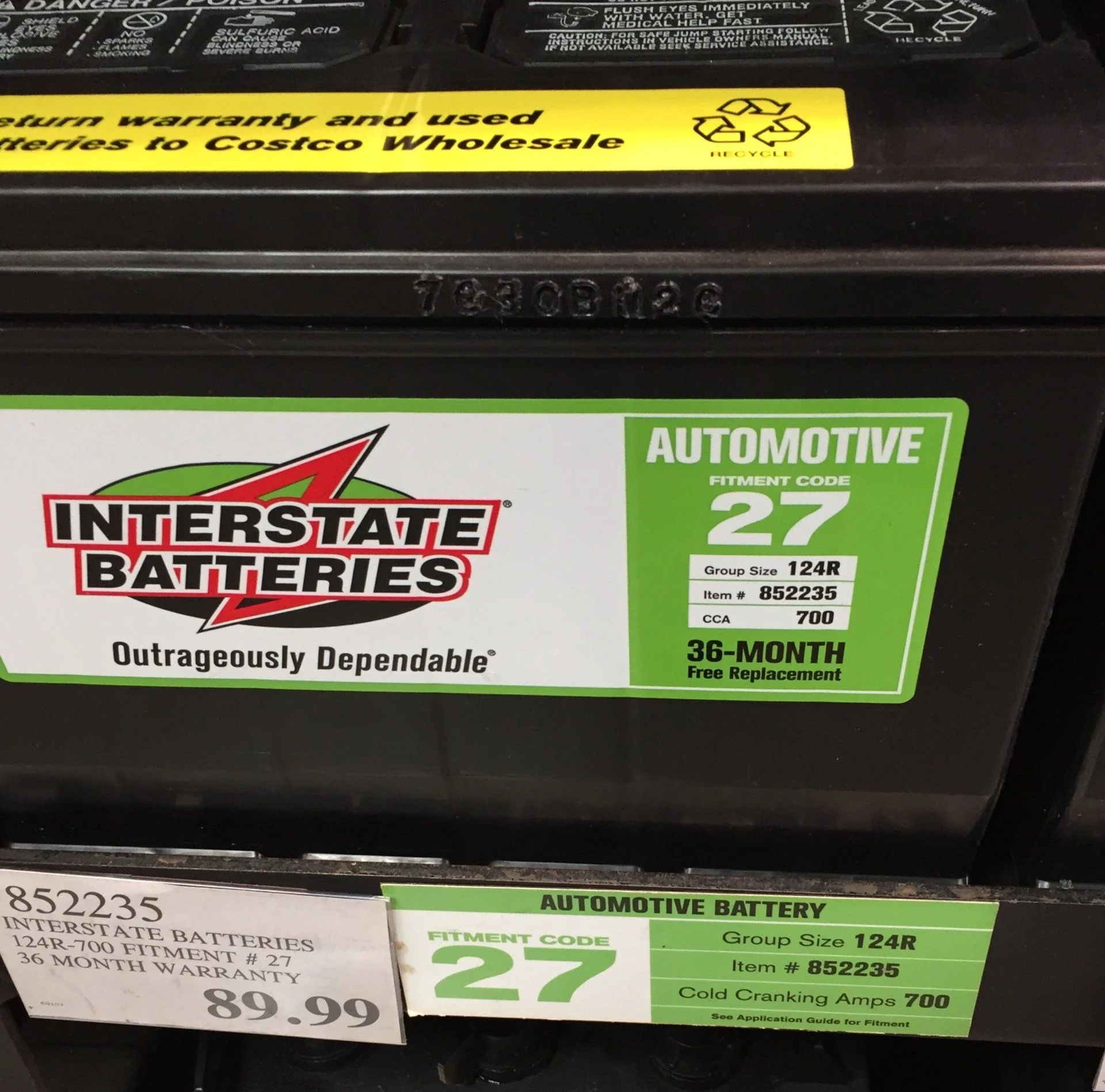

Costco has a interstate 27 battery with 3 year warranty for $89
I’d recommend a 27F battery from Costco. Perfect fit. My costco had to special order, not in stock. Below average cost for above average battery, and a good replacement (not prorated!) warranty. Don’t forget to clean and grease (dialectic preferred, but anything better than nothing) the connectors and terminals.

I went with a Duracell 27F now being stocked at Sam’s Club for under $100 with free install in 15 minutes while I watched from their nice warm waiting area. The rating was a bit higher than the Interstate/Costco at 840 cca/1035 ca. The warranty is 36 months full replacement vs the 42 month that costco had on their non-stock Interstate.

Costco didn’t want to order it for me either, but I pointed it out on their website, and asked why the heck is it on the Costco website if I have no way to get it. They ordered it for me. Took about three or four days. Ask to speak to a manager if necessary.
