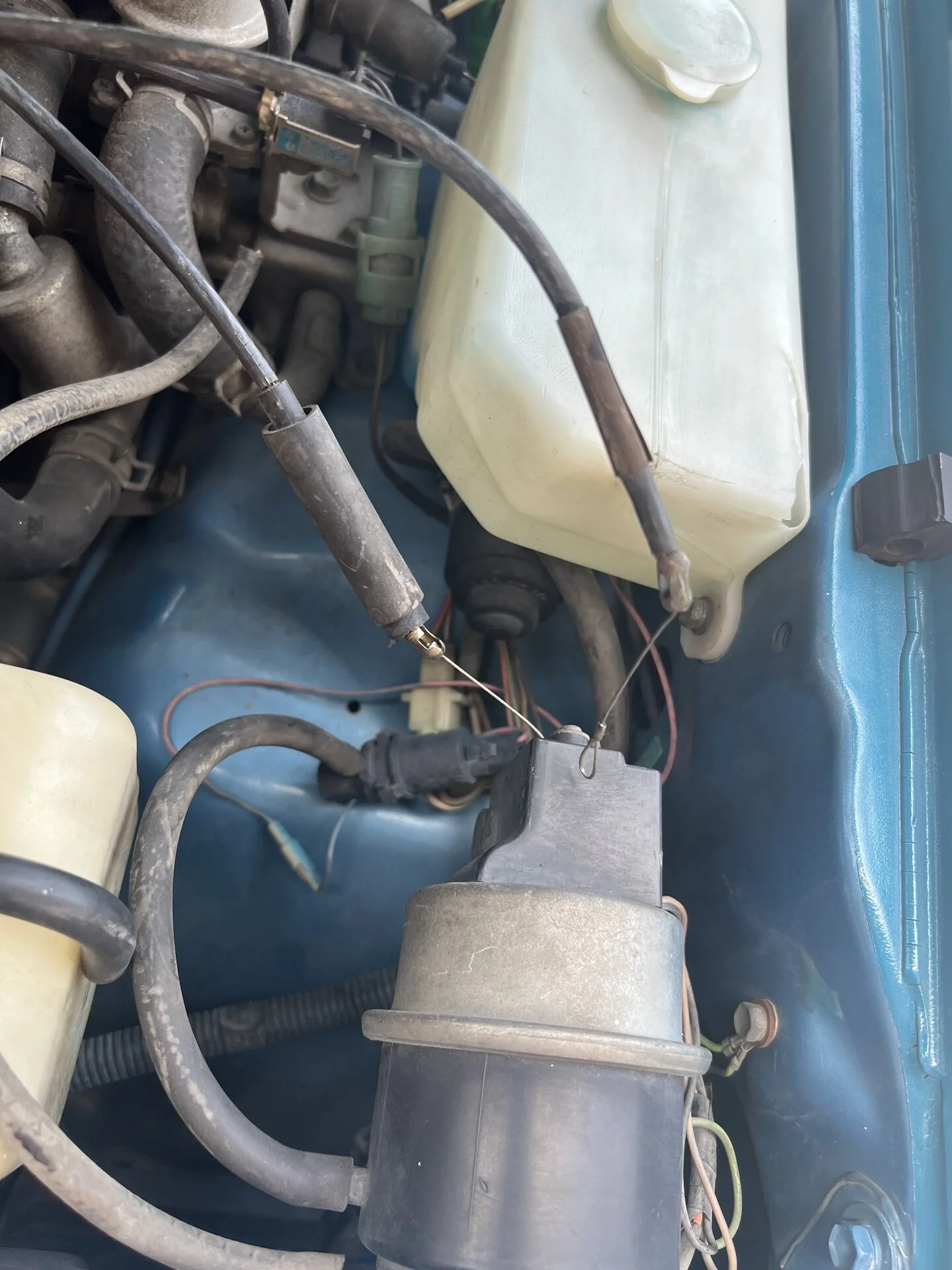

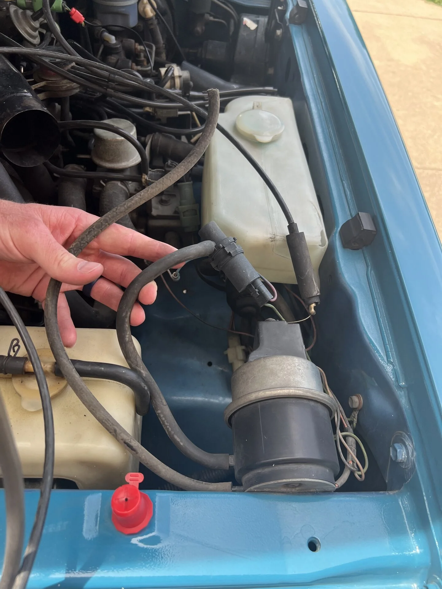

I have one question - for now - What the heck is this thing? It isnt in any diagram or picture that I have been able to find. Any help greatly appreciated. I found it disconnected while replacing vacuum lines last night. Thanks to the posts here about McMaster Carr silicon hoses. good tip.
Cheers!
I agree - looks like aftermarket cruise control. You might have a cable that attaches to the throttle linkage by the carb and electrical wiring running inside to the cab, too.
Mine looked like that and there was a hidden computer control box for it behind the driver’s side kickplate.

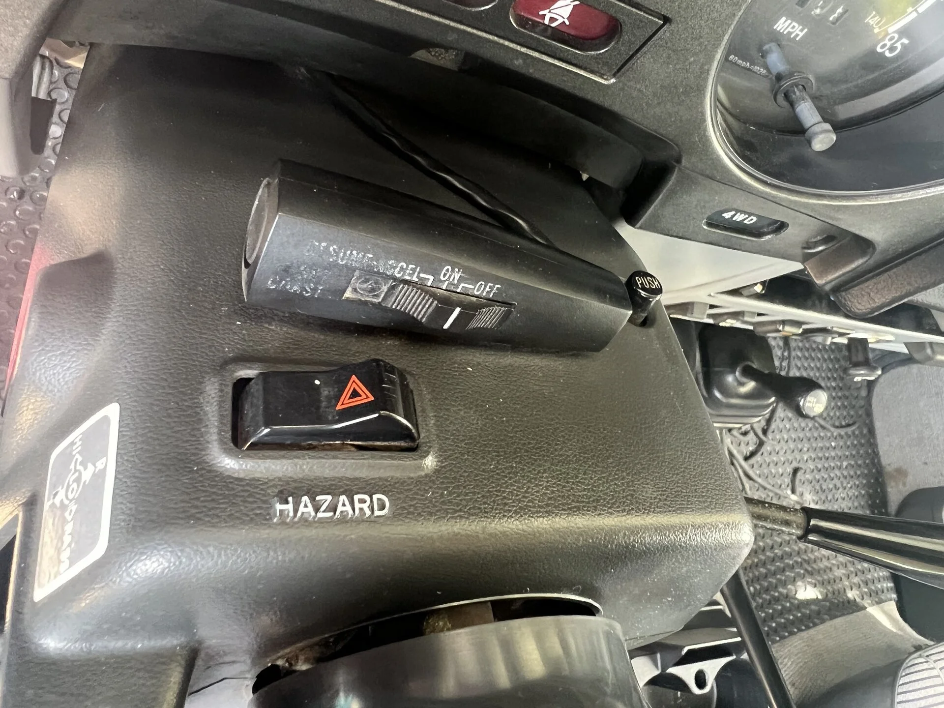

Ah - good call. @tmxmotorsports and @CruiserTrash - there is also a module on the stearing column - the seller mentioned it was cruise control but it didnt work. Here are some more pictures for posterity.

@ax0n now you have to chase down the "brain"/computer part. Hidden under a panel somewhere I bet!
