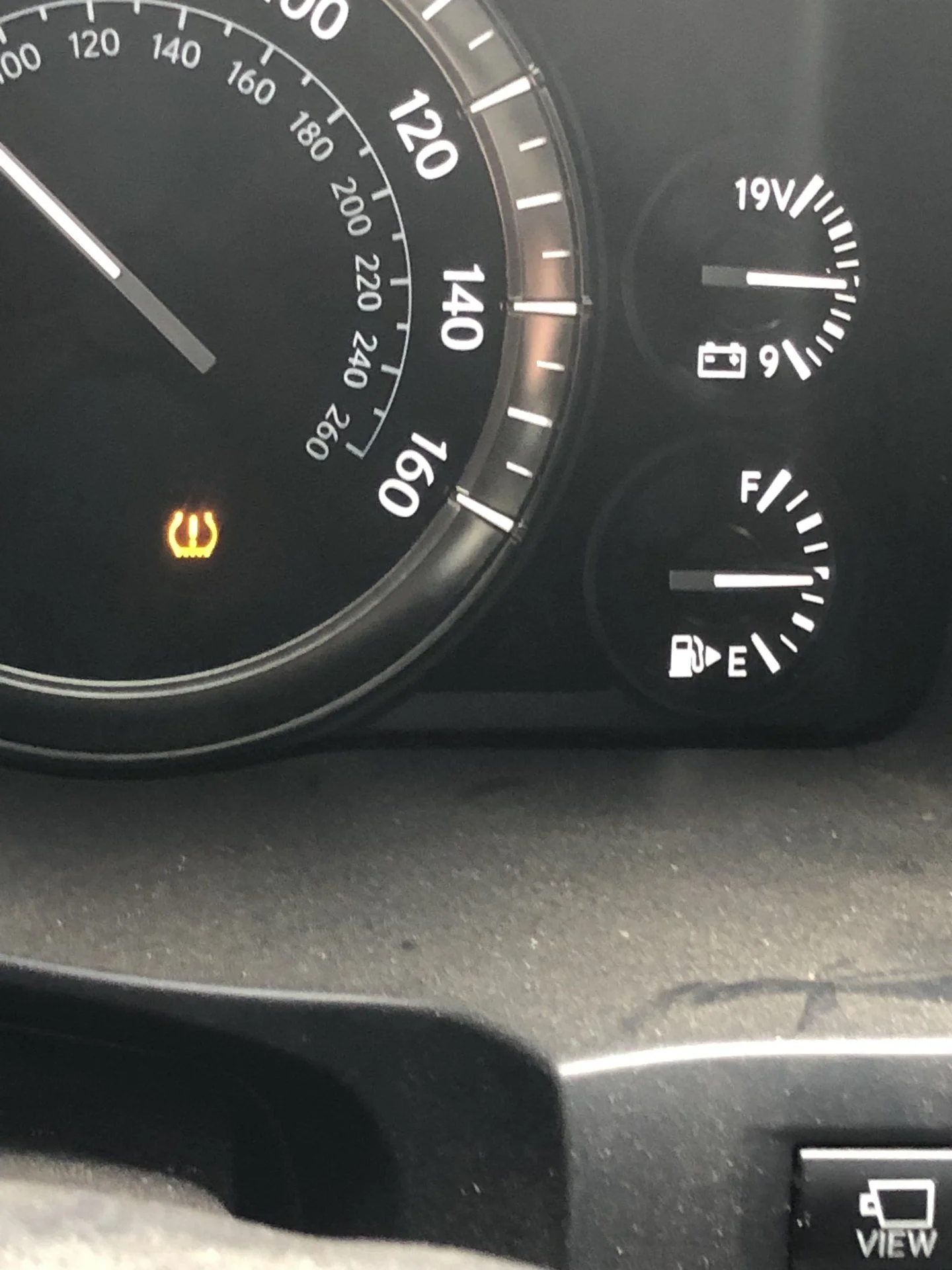

How’s everyone’s transfer rate? I’ve been feeling like mine is incredibly slow, so I measured. It took +30 minutes to do just under half a tank. Does that seem right? FieT pic is 11:20 and second is 11:51
Dies that seem right
@wardharris
^Yes. that's about right. I usually transfer from the aux when my primary is about 1/2 tank. The full 12.5 in my setup takes about 25 minutes so yes, you're in the right ballpark. I personally have no need for more transfer speed.
