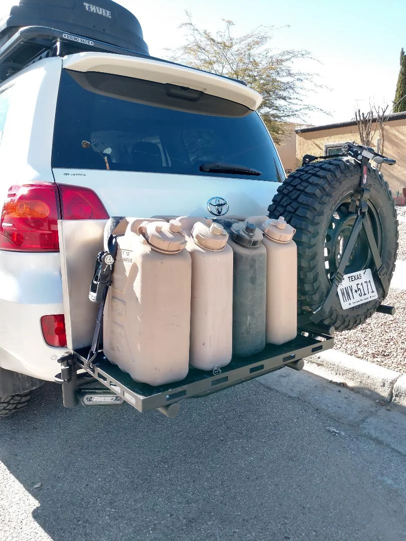

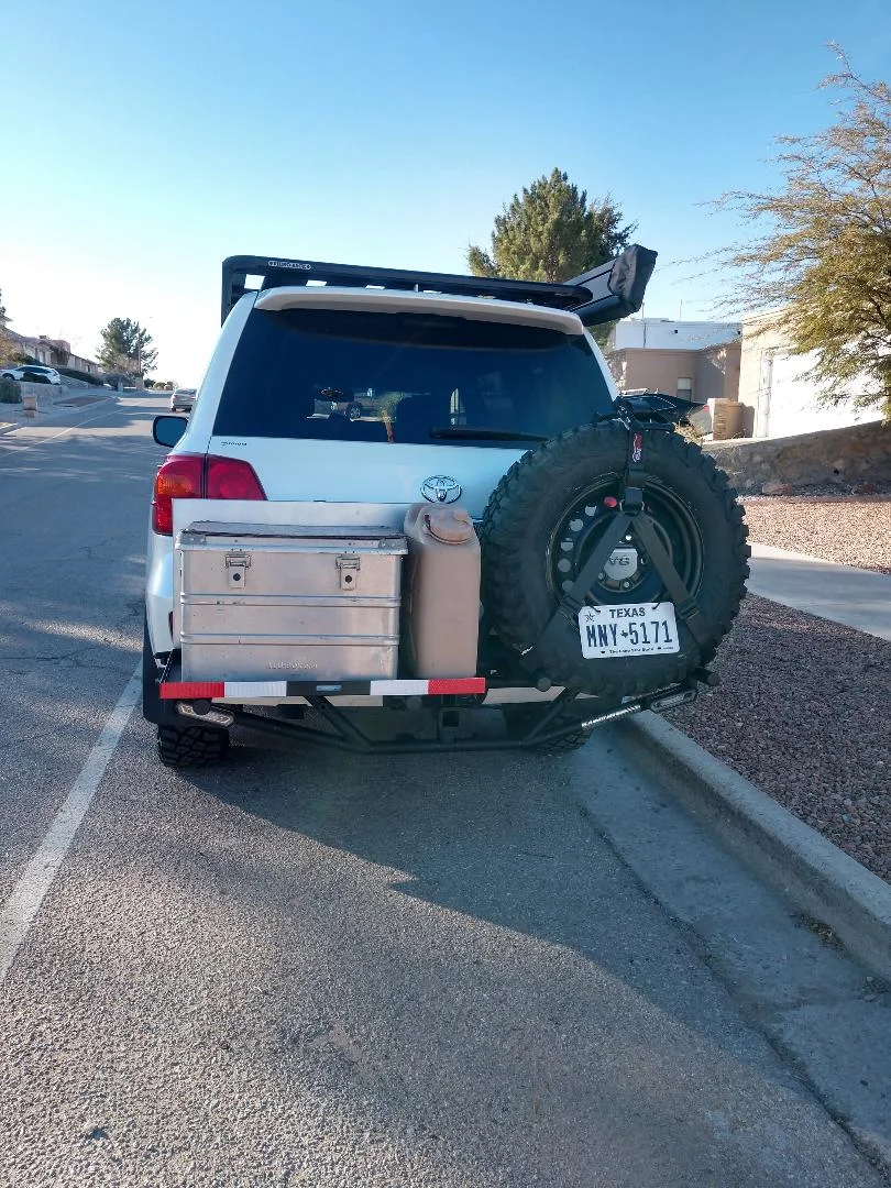

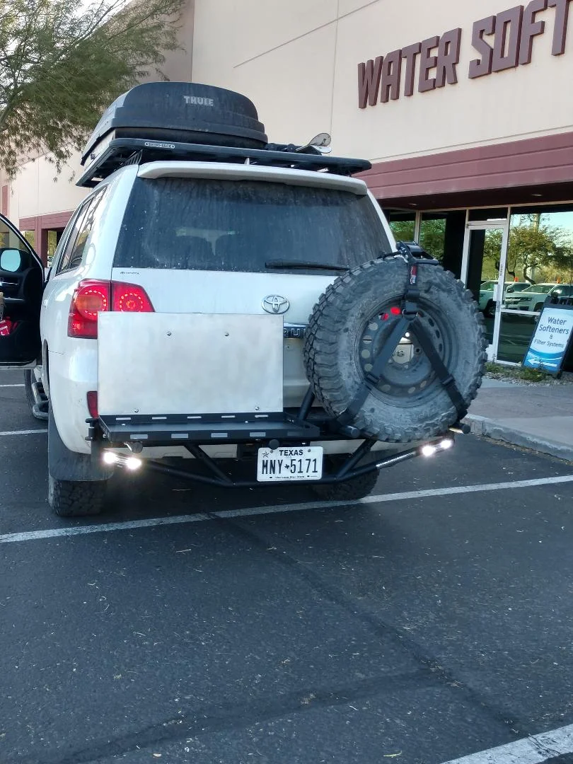

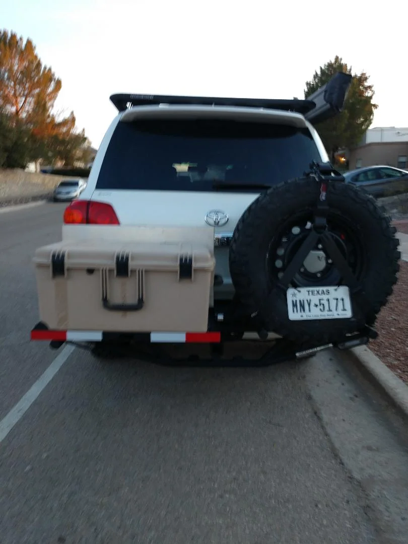

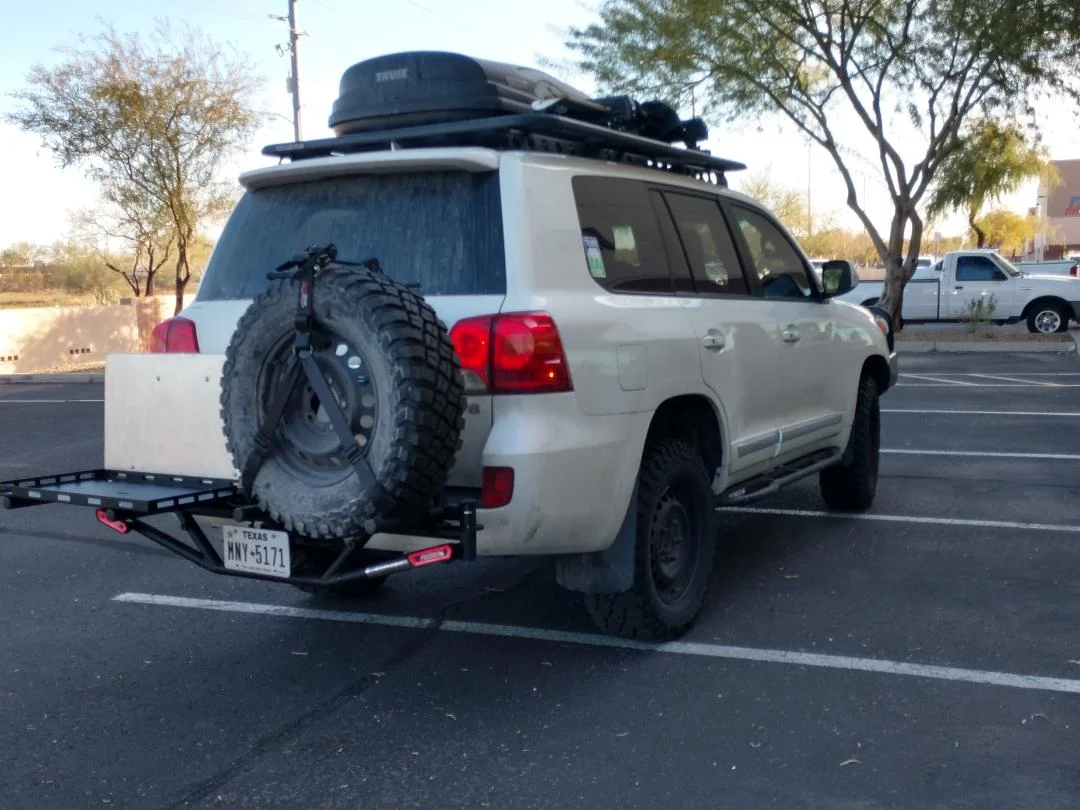

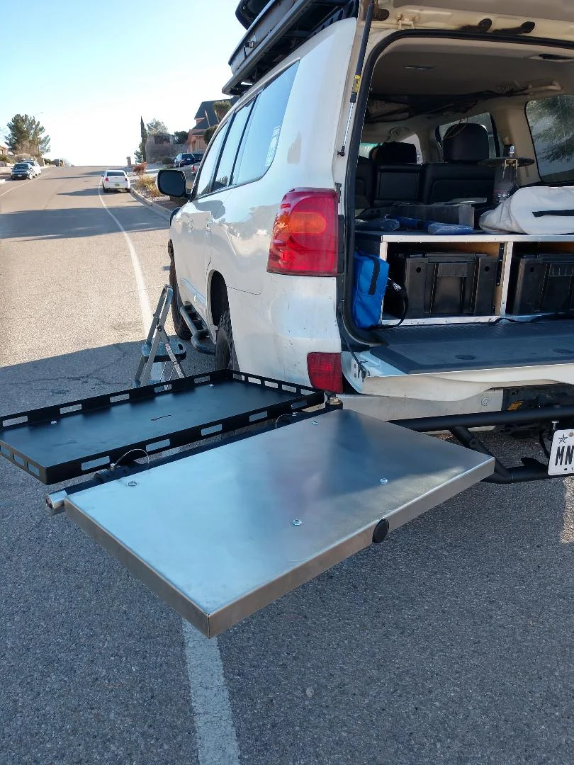

I picked up a Westcott designs hitch mounted tire carrier. Jeff Westcott personally supervised the fitting of the carrier and explained how it worked.
The carrier is strong and rattle free. The D/S tray can be removed and a second spare tire can be fitted . There are mounting points for three Rotopax.

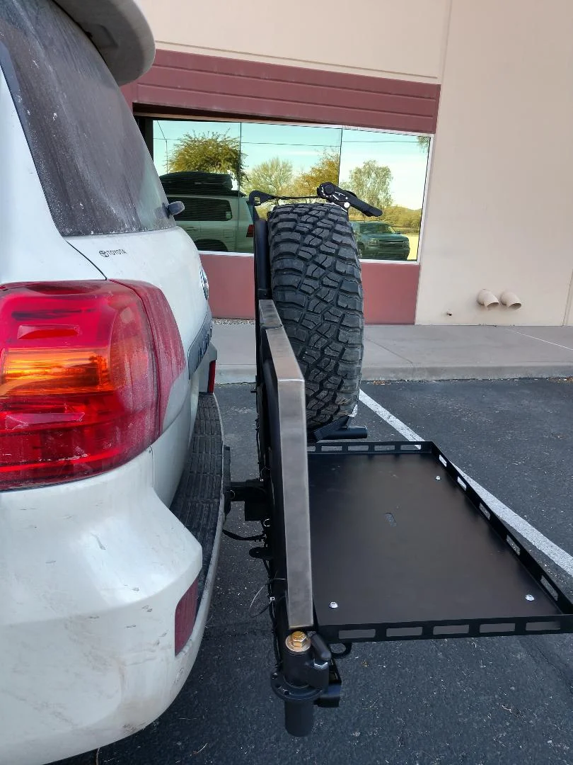

There is a built in fold down table that will be very handy while camping. The tray can fit four jerry cans or a large cooler or anything you can mount to it.
Since I have a 40 gallon aux fuel tank I don't need to carry extra fuel anymore but the tray will come in handy for carrying water.
I also looked at the Wlico Off Road tire carrier. The Wico has everything on one swing out arm. The cargo rack is mounted over the tire. That requires anything to be lifted over your head to get up there. Not very easy with a heavy cooler or cargo box. Also hard t get into without a step ladder.
The gas/water cans are also mounted high up.
The rear window is also blocked.
The Wescott carrier has a cradle the tire fits into. Due to the low height, it is easy to get the tire in the cradle. One method is to roll the tire over one of the support arms into the cradle.
This looks great. Any idea how much it weighs? how was the install? is it tricky to fit?
I was told it weighs 105 lbs. Installation is just sliding it in the receiver hitch.
Yeah, even with moderate trail use that thing would either get bent or depart the vehicle. Nice idea, and maybe if it had a 12" riser it could be useful but that would put it into the drop down gate. Also it looks like it's blocking the rear parking sensors.
There may be no hills in Texas.? Ive seen a fair share of paved driveways that would probably hit that.
I agree, even the simple sort of forest service roads would be sliding on that thing all day... which is probably fine. If its strong enough, just drag the SOB over things.

This looks sweet! I've been looking for a hitch carrier with table and cooler tray for cleaning and storing fish after spearfishing. I like the idea of keeping everything out of the cruiser. Do you have any lower side pics to show how low it sits from the hitch? My receiver is already pretty low, and from your shots it looks like the Wescott sits even lower. Thanks!
