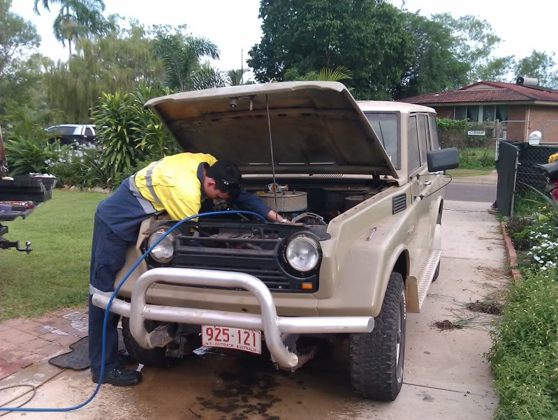

I had a flat bed pick him up as it wasn't registered & the previous owner said the motor got hot quickly.
This pic was taken 5 mins after i got it home, last night. My brother has started to flush the motor.

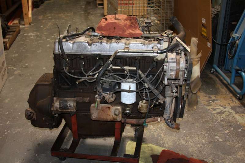

I was giving the little SBC a oil change today. I don't think its been done in about 4 years. I can't believe i had to pay $23 for a oil filter :mad:
Gave the motor a nice clean up with some aluminum cleaner
Not 100%, but will do for now

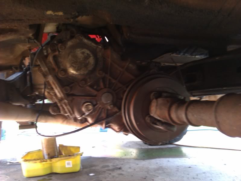

I also pressured cleaned some grease & grime from MR-PIG's underbelly and i noticed this :-
I know piggies have drum brake on the tail shaft but that gearbox looked familiar. So i crawled out, jumped in the cab & found i had a 5 speed cog box. Yippppppppeeeeeeeeeeeeeeeeeeeeeee

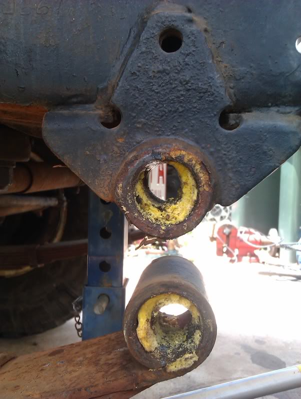

15 of the 24 genuine Toyota rubber spring bushes arrived yesterday so i started to fit them. Rather then leave the rest untouched, i temporary replaced the rest with some 2nd hand Hilux poly bushes. (5mm shorter)
This is photo of the old bushes.
