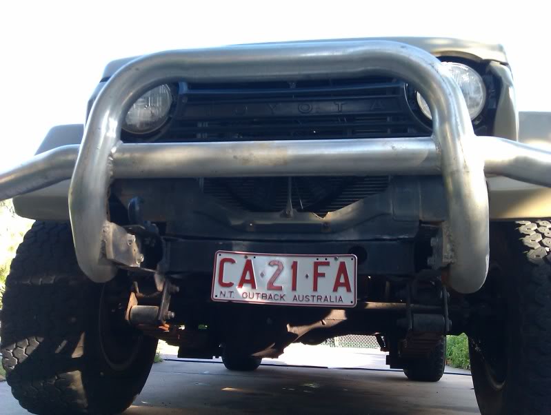

Is it just me or is that gearbox and transfer hanging down too low? Good to see you have it sorted, hardly see any 55s that aren't rusted totally away.
Herb the gearbox hangs a little, but nothing of concern to me @ this stage & intended purpose. (Highway cruiser/daily commuter). If i was to wheel it, yes it would need a bash plate.
I waiting on getting access to a parts pig. I'm keen to take lots of measurements on hand brake height from the ground. Tail shaft lengths & angles. Position of the motor in the engine bay. The list goes on :D
I un bolted the sill? panel this arvo. It was blocking 10cm of my radiator. Although im not having overheating problems, i still want more control :) Air conditioning is in the plans list.

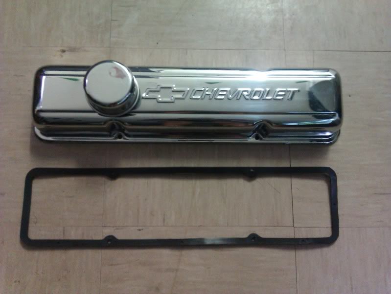

I got some replacement rocker covers to replace my rusty old ones.
I also brought some re-usable, steel insert gaskets to seal in the golden syrup.

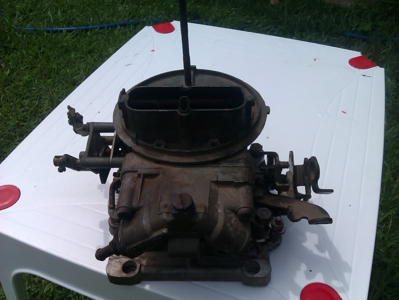

Last night i was given a 2 barrel 350 Holley & 4 barrel adapter. My mate saved it from going to the tip so he passed it on :D I blew the cobwebs out with compressed air & bolted it on. Before it started I noticed the needle & seat leaking so it got a new one. Then it started & idled like a dream wagon. Here is a pic of the dirty old sucker -

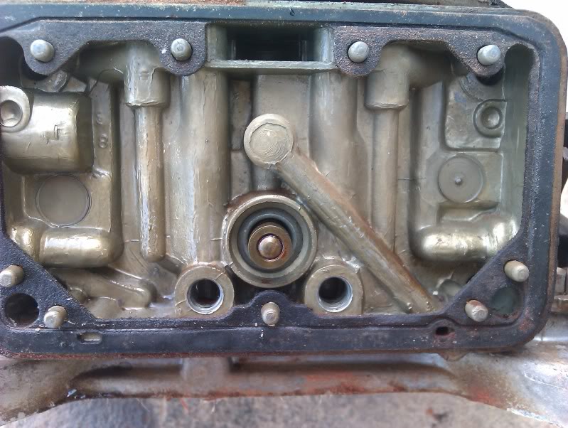

I then went to drive it & nothing but a massive cloud of black smoke out the exhaust. So off with the bowl & this is what i find. Some one stole the main jets :hhmm:
Stuck in some 65's as that was the smallest i had & test drove it. Very happy :)

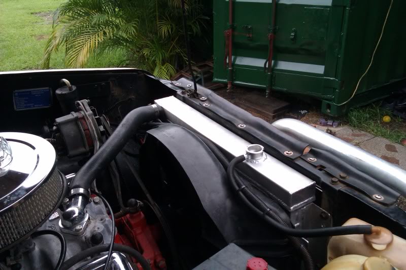

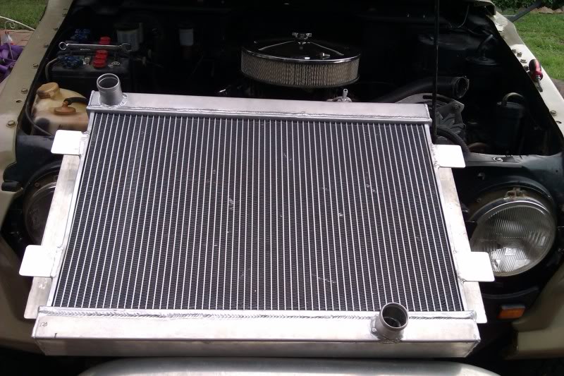

Today I installed MY new radiator. I got it off eBay for $150 inc shipping. I took it to the local aluminum fabrication workshop to have some right angle brackets welded on. This cost $210, not impressed at all at the price, ripped off I think.
Anyway here is a pic of it
http://i116.photobucket.com/albums/o33/v8slrtorana/IMAG0513.jpg
I installed a shroud this time
http://i116.photobucket.com/albums/o33/v8slrtorana/IMAG0514.jpg

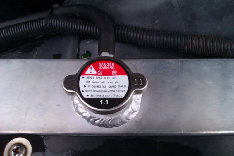

I like this Jap type radiator cap :D
http://i116.photobucket.com/albums/o33/v8slrtorana/IMAG0516.jpg

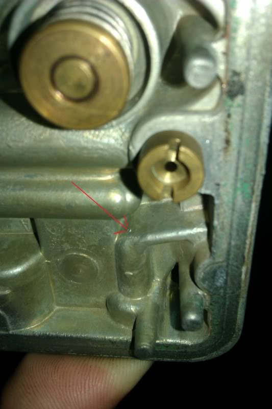

When i brought the pig it came with a 600 holley that was a royal pain in the :censor:
It stunk of fuel all the time.
It was very hard to start.
Fuel was dripping from the idle transfer slot when the engine was off.
+ a few other problems
Well today I found this. A pin prick in the metering plate that exposes all the fuel in the bowl to the idle transfer circuit.
Get some quick steel tomorrow & glue it up.

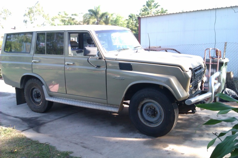

The pig has been away for a month or 2 at the panel beaters. He did a awesome job on my "caved in rear panel" . It is now arrow straight. Im not 100% happy with the paint colour match, but this NOT his fault. I had 2 lots of eye match tint made up and this has been the closest. For the moment is sealed up and brown.
Longer term plan is to take it to a paint supplier that has 1 of those cameras that can formulate the tint and then ill respray that panel myself.

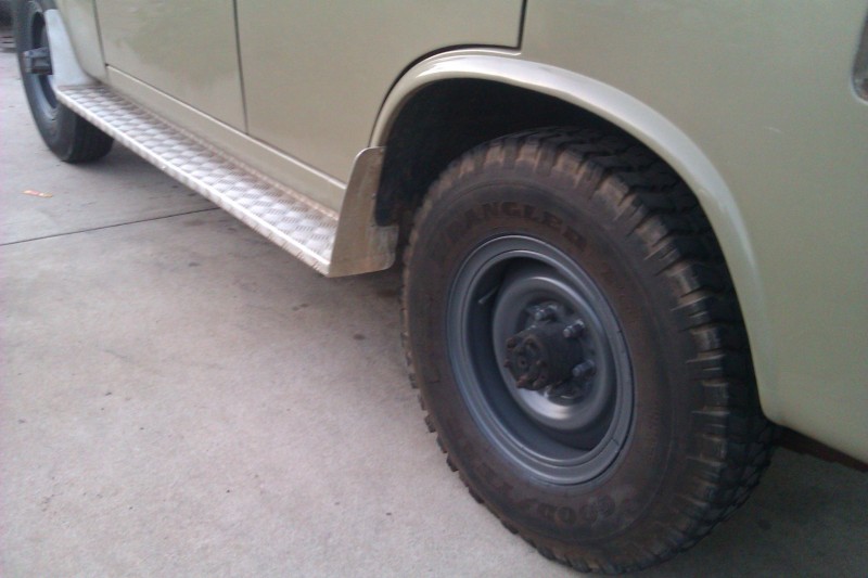

2 weeks ago I picked up 4 16" split rims for $50. Two front tires are Light Trucks that have only just had the hairs worn off and the rears are good tread trust old Goodyears. I don't really like the combo but ill get used to it.
On the positive side, it steers so much better, and the taller tires suit the gearing way better.
