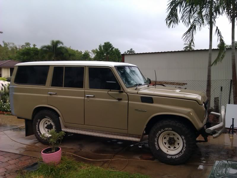

I decided to tint the windows. Considering the condition of the glass, & the fact I did it, I'm pretty happy. I may reconsider doing the passenger rear again. The window must not have been as clean as I thought it was.
Total cost. Less then $100
Even though I don't have AC yet :), the cabin is so much cooler. The back floor has gone from burning my feet to cool :clap:
FIY, tint is 5%

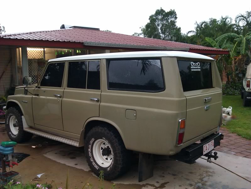

I'm not so clear on my AUDM pigs, but those tail lights look like pickup assemblies.
Is that a thing unique to the lands Down Under, a PO conversion, or a late model thing?
All the piggies running around here seem to have the small squares higher up on the band set into the rear corners.
Re Tail lights.
This is a 78 model. However my little knowledge of pigs makes me think that Aussie models have only the pickup lights.
See this Aussie 75 eBay Australia: Buy new & used fashion, electronics & home d�r
