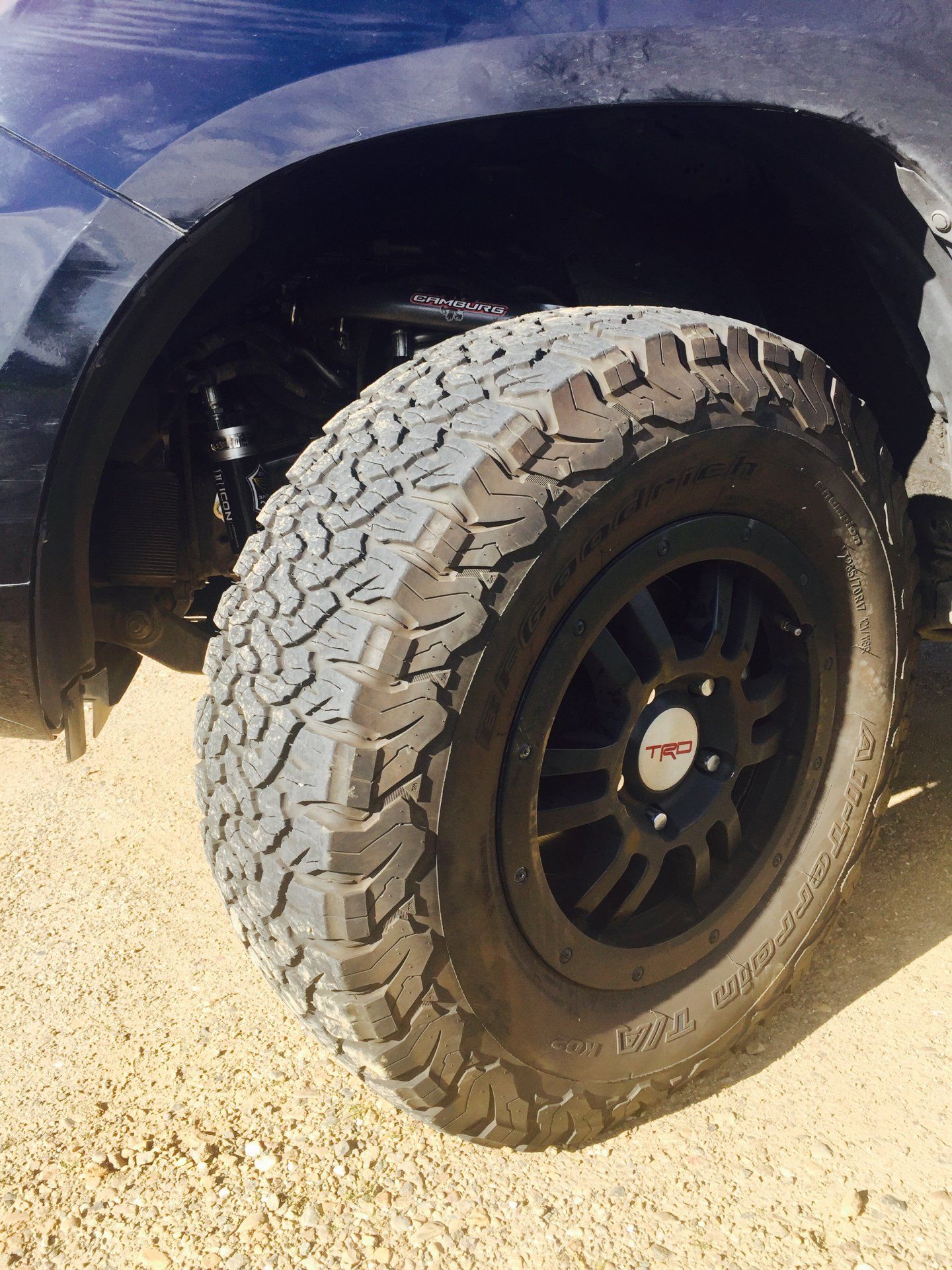

Front coilovers rebuilt and upgraded with resi/cdcv valve and 700# spring. Still waiting for rears and brake lines.

I got the front resi cans mounted and brake lines swaped with extended crown performance brake lines. Choosing the location for resi was bit of work. I contacted @Willy beamin and exchanged some text and finished installing them last night. Knob is facing upwards and mounted in the front side of coilover on both sides using Icon's LC200 brackets. Hose clear during full droop and full wheel lock. I will be moving to rear suspension work tonight. I hope to get the alignment done on Friday. 700# spring rate is giving the lift height without cranking down the coilovers. I did a short drive and spring rate seems to be work good with current weight of the rig with skids, sliders.

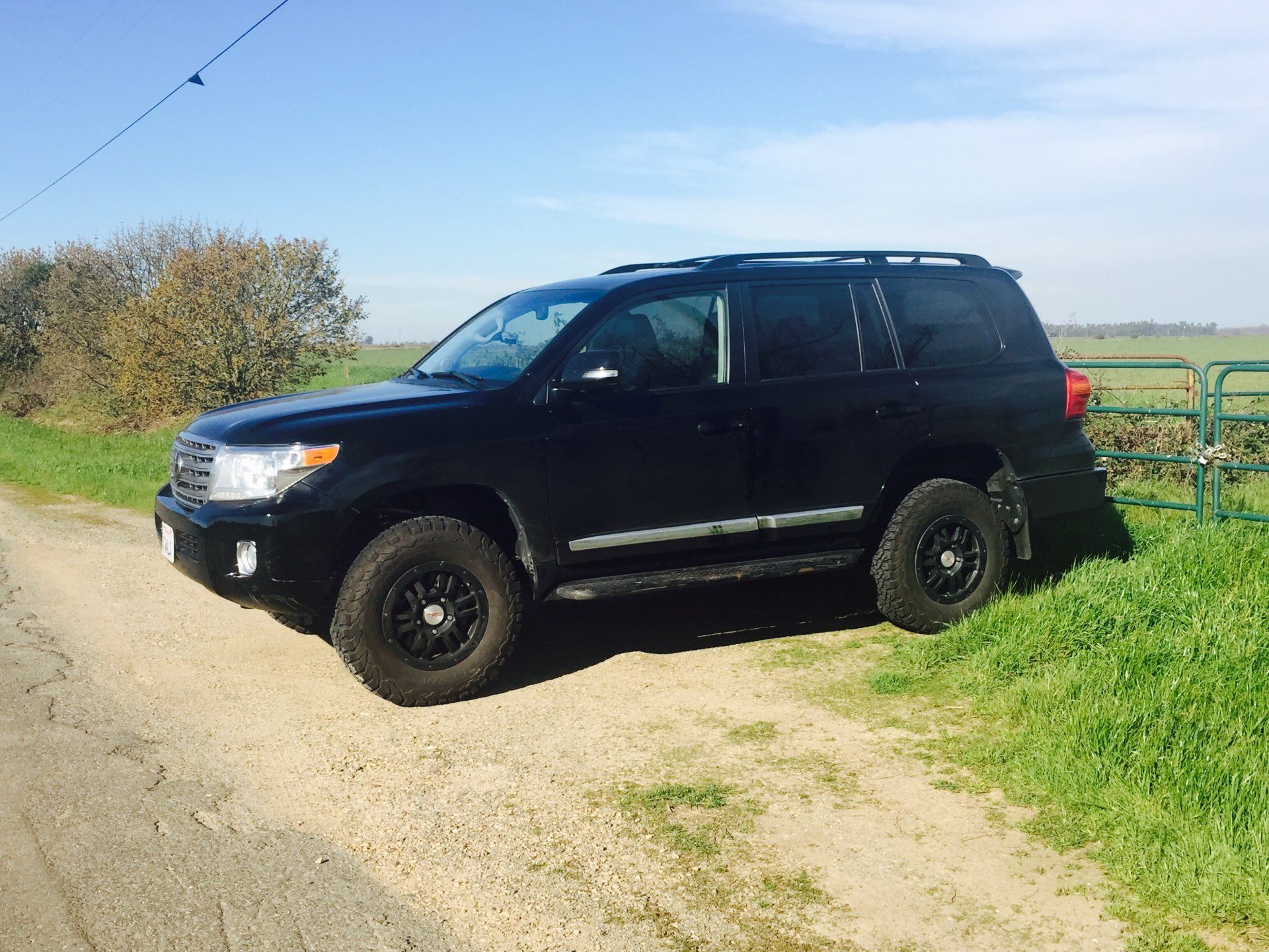

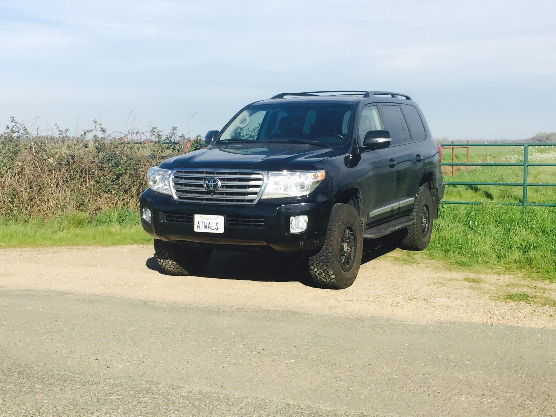

prelift measurements. Measured from the bottom of rim to the top of fender with wheels on the ground.
Nice work Kamal, looks great!
All done. Tuning in right knob setting for on road. Looks like #4 is sweet spot.
3 inch down travel in the front.
4 inch down travel in the rear.
32 inch front height to the fender measured from the bottom of the rim
33 inch rear height to the fender measured from the bottom of the rim
Initial suspension settings is two for all corners.
Front tire track width is 76 inches.
Rear tire track width is less than 74 inches.
Both front mud flaps are removed.
Pre-lift fender height for all corners was around 29 inches.
