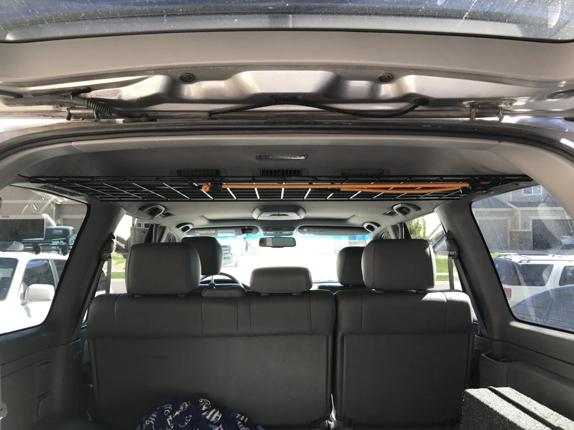

I just installed my attic rack after painting it gloss black. It's a very nice set up and fits perfectly. I was able to load my fishing poles and gear on it. Thx LCP!

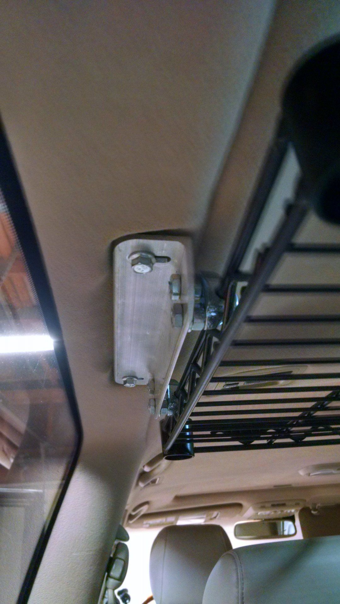

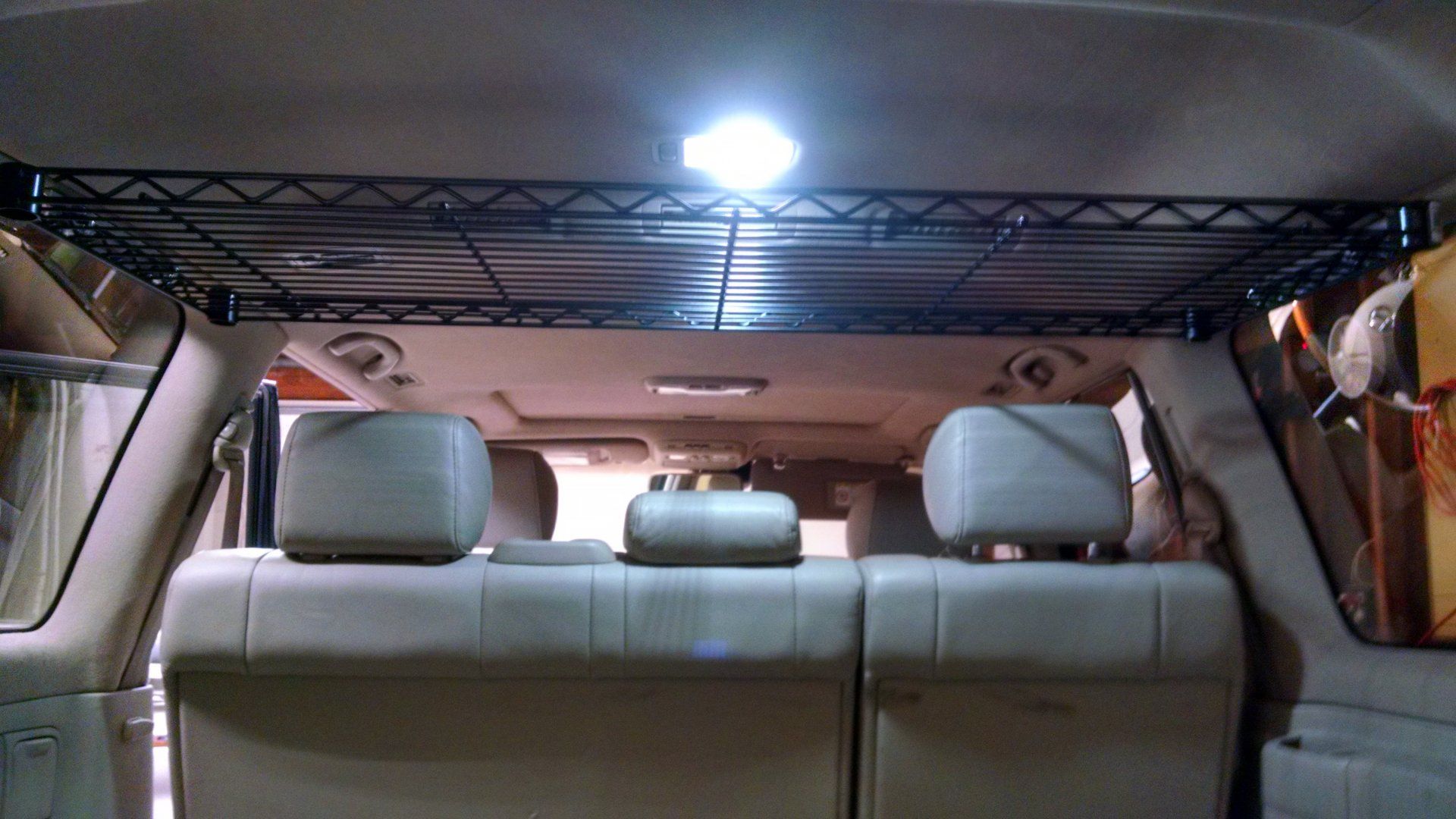

My attic storage is made with Container Store "InterMetro" brand shelving parts. Pic taken during install so shelf looks tilted.
It is mounted with 6061-T6 aluminum angle and two rope clips per side. There are standoff spacers above the angle to space the bracket down to prevent rubbing on the headliner.

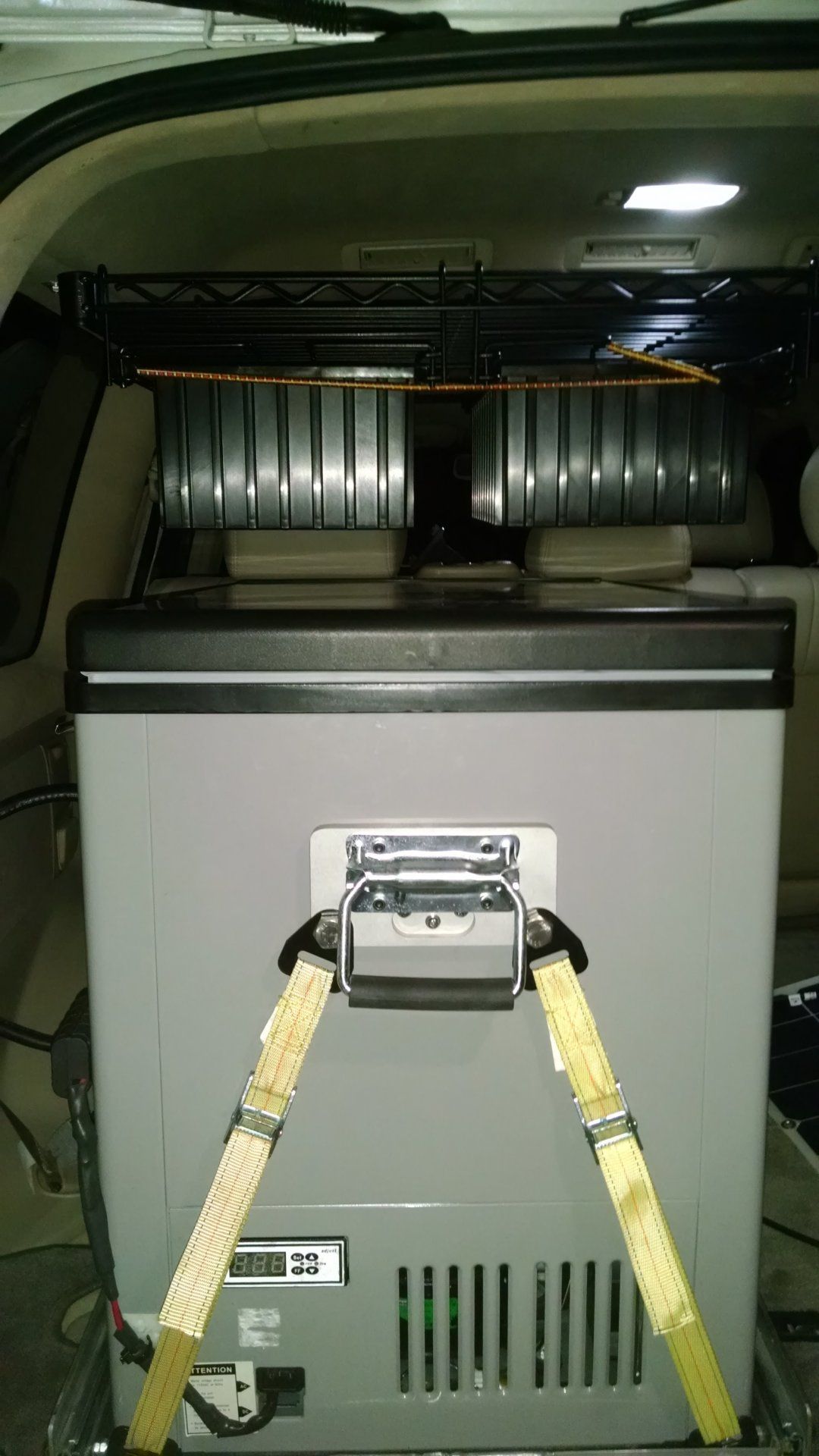

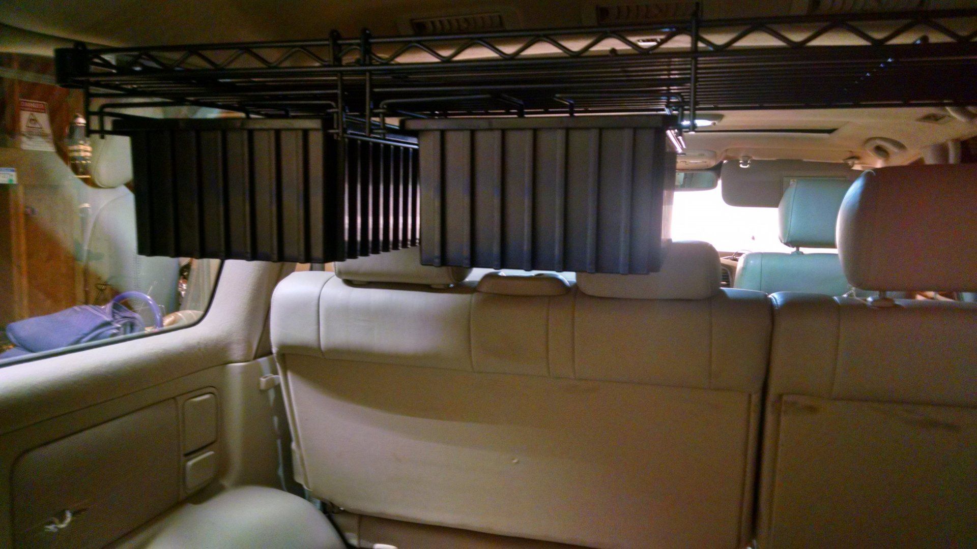

Drawers for dehydrated meals/fruits/snacks etc. They are made by Akro-Mils, very heavy duty. The drawers cannot slide forward in a hard stop.
It uses the dead space above the 80qt fridge quite efficiently.

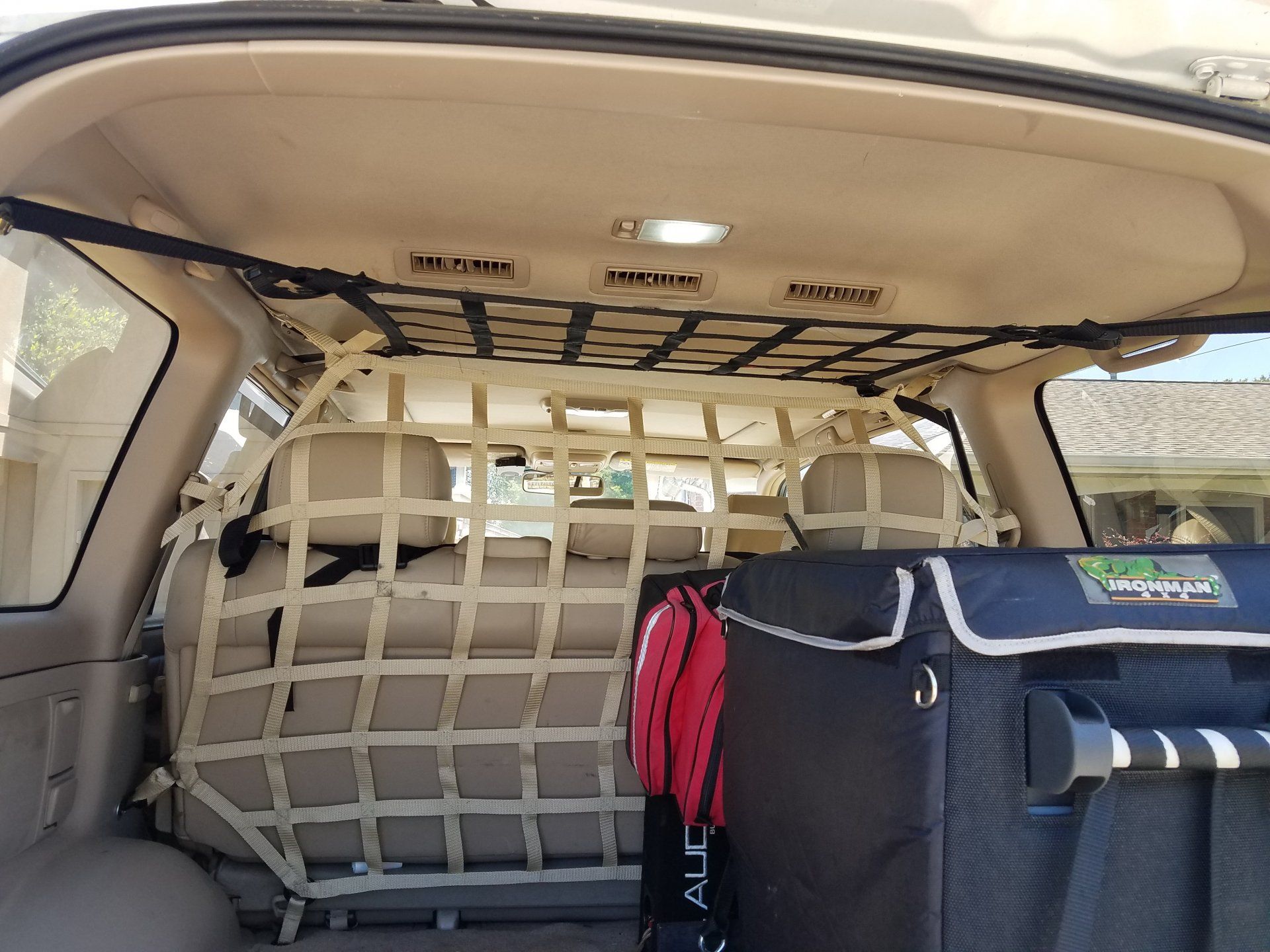

Raingler nets using rhe rear seatbelt bolts and 2nd row handles.

My attic storage is made with Container Store "InterMetro" brand shelving parts. Pic taken during install so shelf looks tilted. View attachment 1452102
