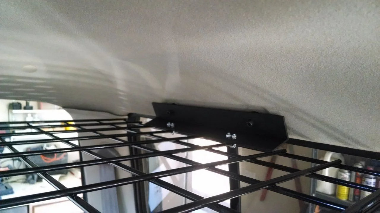

Home Depot closet wire shelf 4 ft x 16", bag of metal clips for wire shelf, 4ft 2in alum angle 1/16in thick, 2ft 2in wide 1/16 thick alum strip, some short #8 screws and nuts.
Cut 2in angle for two 16in end caps of shelf, use clips and drill and use screws and nuts to fasten to alum angle.
On side where handle faces down cut a piece of 2in angle to fit where handle was, drill to use handle bolts. Use 2in alum strip on other side handle to make shelf level, drill and fasten it all together.

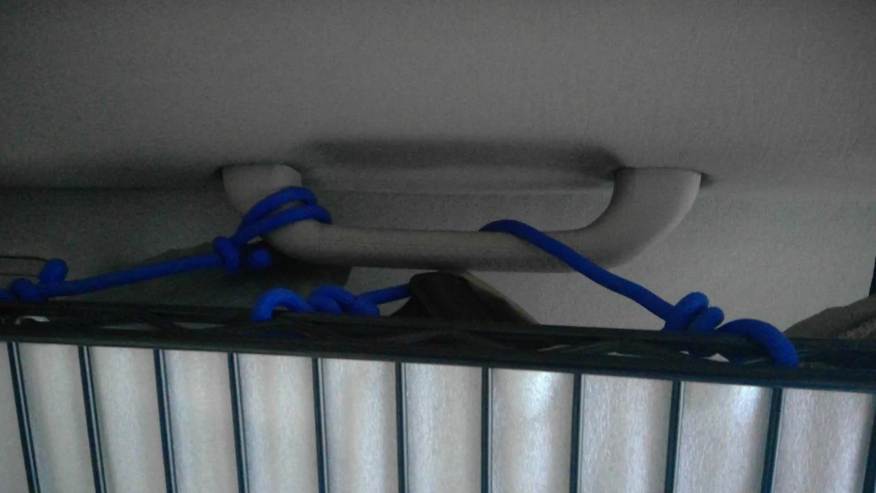

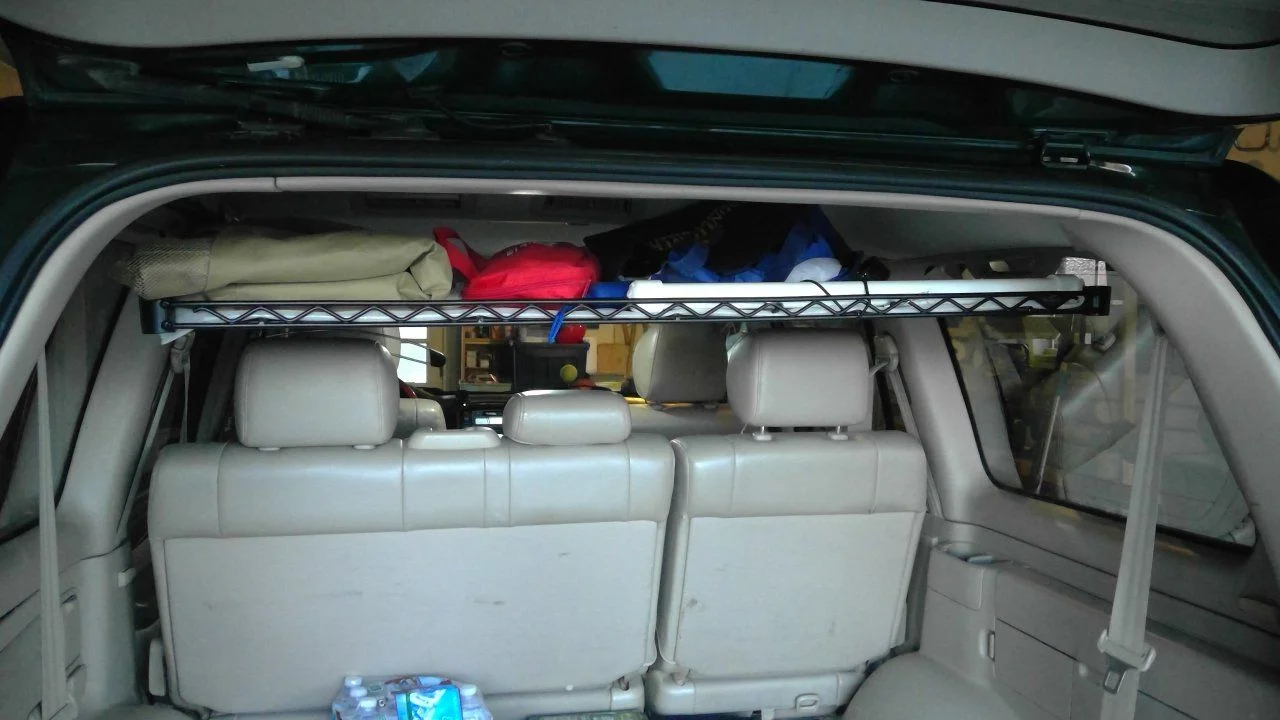

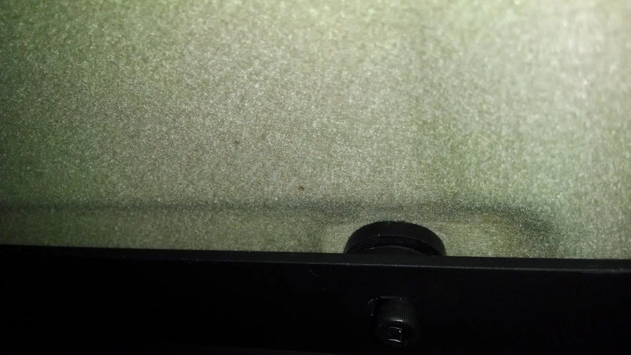

I picked mine up at a thrift store, $10. Here are a couple of pics from my 80. I will be making it fit into the 100 for our summer trip and HIH. Put the rubber bumper things as spacers to keep the bracket from making contact with the headliner, also believing it would be some sort of shock absorber.

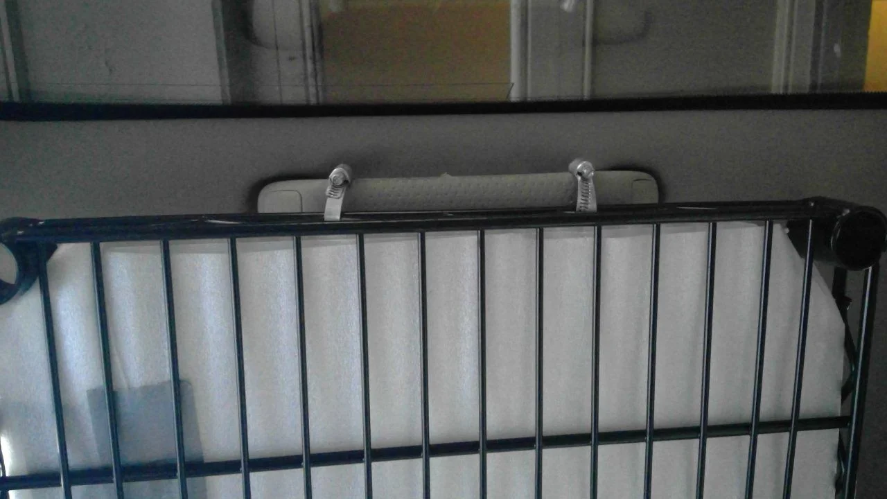

I picked up a shelf from the container store. Used hose clamps and a couple of twist locking things to secure. The rattles of items drove me nuts so I lined the bottom with some packing foam sheets.
