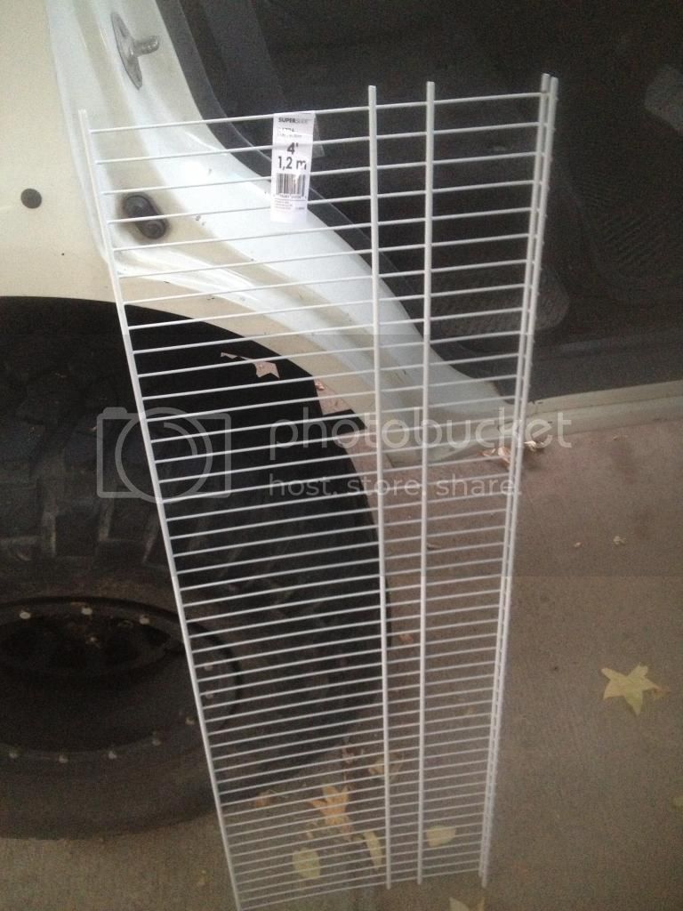

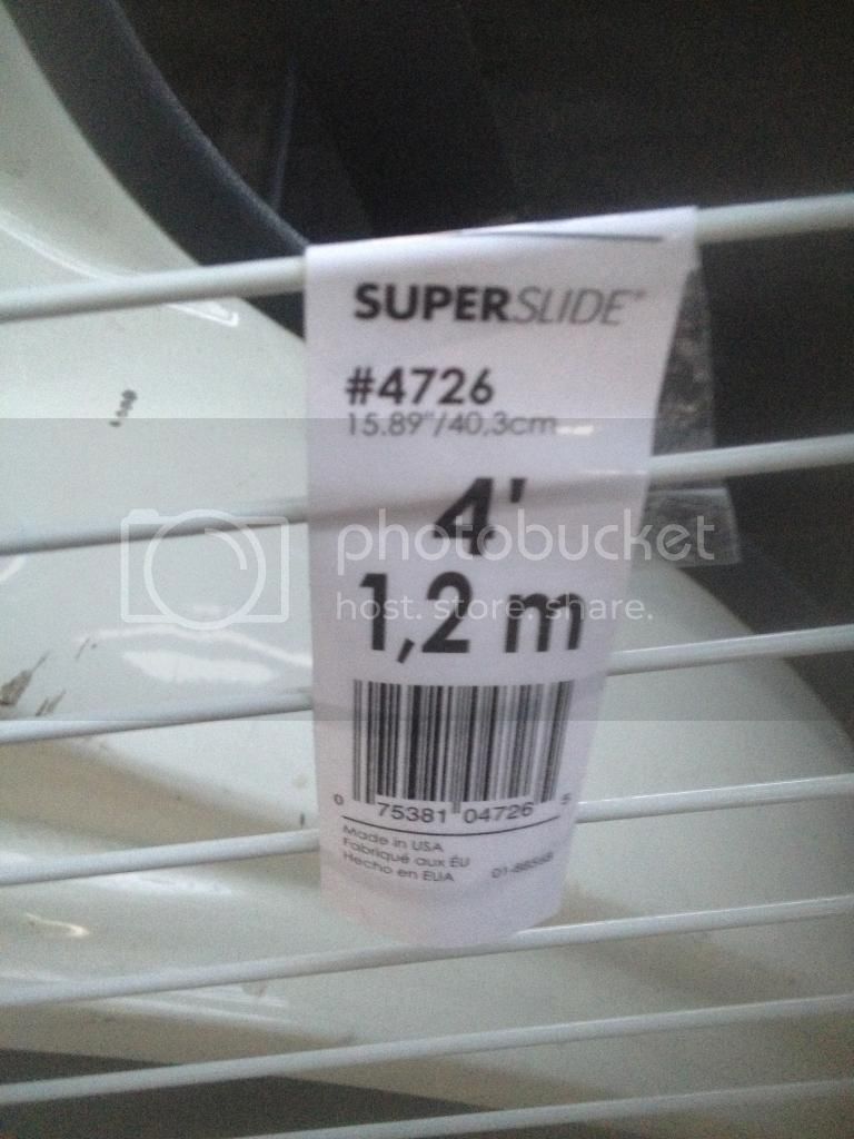

finished mine today, 10 bucks for the rack, it is beige so it matches the headliner, a couple bucks for some washers and 7 bucks for the brackets. I cut the brackets down a bit and bent them to fit. Used a few zip ties to attach to the speski barrier to avoid any vibrating.

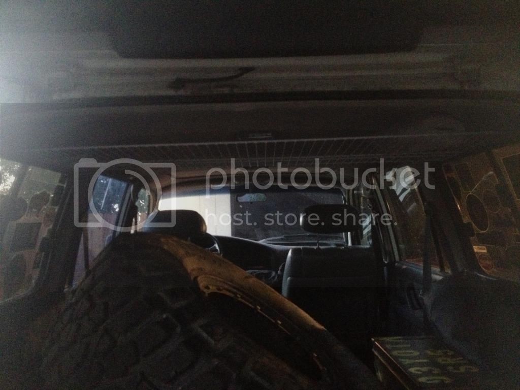

Here's my 6$ attic.
Bad pics I know. It was getting dark
I'll probably keep an eye out for a sturdier shelf and possibly will make some brackets.

finished mine today, 10 bucks for the rack, it is beige so it matches the headliner, a couple bucks for some washers and 7 bucks for the brackets. I cut the brackets down a bit and bent them to fit. Used a few zip ties to attach to the speski barrier to avoid any vibrating.View attachment 939312
1973Guppie, thanks for posting these photos. I had wondered if it was going to work with the Speski, a set of drawers, the Tembo Tusk & an ARB fridge. I was finally able to get out to the 80 today and it looks like it'll work. Where did you pickup your parts, Home Depot, Lowes, or other? Did they have any in grey?
got it all at Home Depot, I like the 16 inch "shorter" rack as it allows room for my dogs head towards the back hatch. I plan to build a wagonrack for the rear eventually. It will be tight with the 2 dogs but it should all work.
