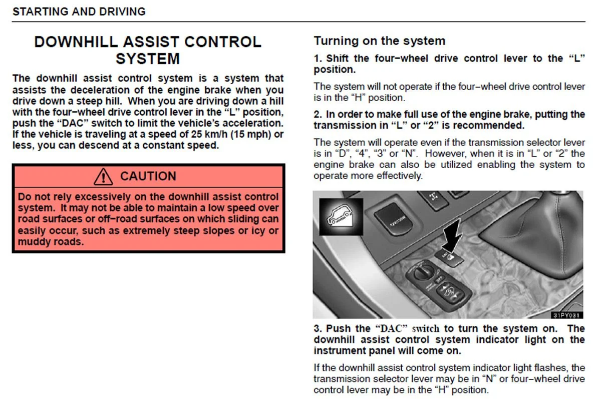

For those with a 2003-2009 GX470, are the brake noises in DAC similar to what I should be hearing with ATRAC? I've used DAC many times going down steep hills and I can hear the brakes loud and clear. Also, on starting the engine, I don't hear any weird noises for the ATRAC self check.
No DAC is the most obnoxious and maybe only worthwhile for an extreme emergency. And sounds horrible. Yesterday I was dropping down insaine vertical rocks on Fins & Things where you feel like you are standing up in the Drivers seat. And I still prefer to be in control with the brakes myself.

@Bluetribal I know what you mean with the DAC and trusting it. I’ve been playing with DAC as much as I can, but still prefer my own brakes. One problem for me is that “L” doesn’t stick unless I hold the lever in that position. Now I realize that is a reason by DAC felt a hair too fast on steep downhills. I will test again with the transmission in L.
