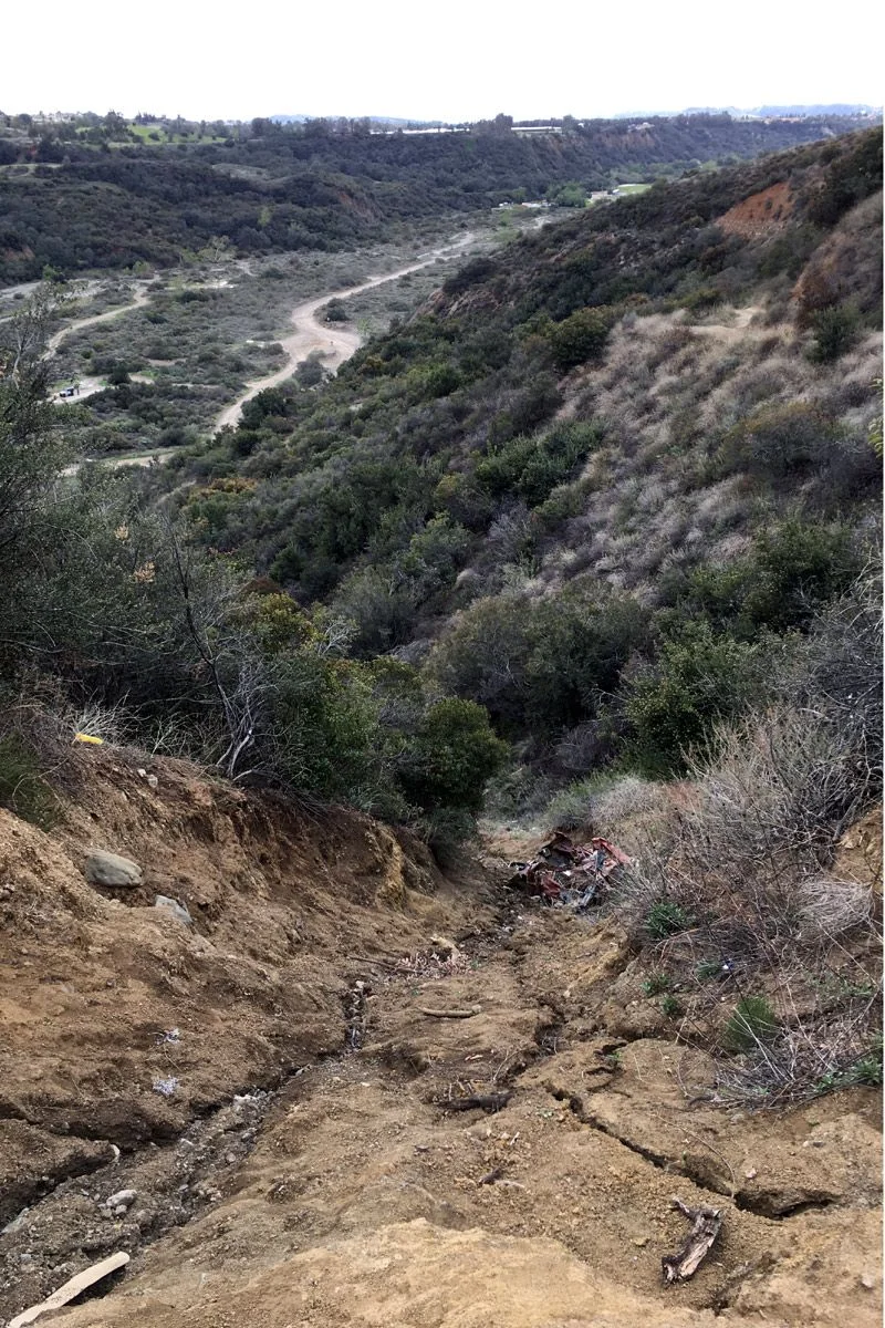

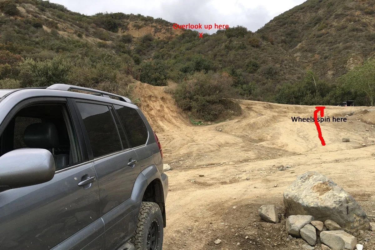

Yesterday in terrain that was heavily eroded and rutted by rain, I couldn’t make it up the start of Cadillac Trail in Trabuco Creek Road. My tires were spinning too much when I entered the uphill rutted area. I was in 4Lo, centered locked, and kept RPMs under 2000. I did not air down, but nobody else aired down. Yeah, I should have aired down but they were leaving me behind!
My friend on a 2005 LR3 has rear and center locks made it up no problem. His suspension is stock with 31” tires. I was following the same line that he took. He’s lifted by his air suspension by about 2”. I’m raised higher due to my larger tires 32.7 BFG KOs plus my 2.5” lift, so I have more clearance.
Another guy at the trail on a stock FJ Cruiser with just the front slightly raised by spacers, made it up no problem. He noted that we actually had the same wheels and tires. He had rear and center locks. Atrac too. His atrac works fine and asked me if I hear noises from atrac kicking in and i don’t recall.
I had to reverse and take a less rutted line, but I made it up twice that same starting point at the base of the hill. I just couldn’t take the same exact line that both the LR3 and FJC took due to wheel spinning. I had to go around.
We continued and made it 3/4 of the way up the hill on a rutted road to an overlook right before a locked gate, so we couldn’t get to the top of Cadillac Trail.
Anyways, my wheels spun several more times on this trail primarily because the trail was very rudded in some areas.
So, is it just the fact I didn’t air down? Or something else not preventing ATRAC?

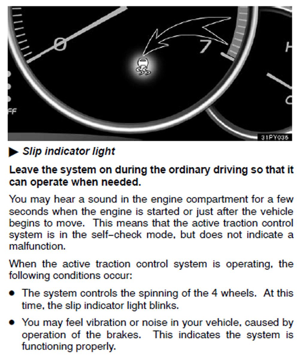

@co4wheel I found this in the owner's manual about the "slip indicator" light going on when ATRAC is working. I don't believe that I see that when my wheels are spinning while in 4Lo, center locked, stopped in an off-camber position and accelerating slowly up to 2000 RPMs. I only remember seeing the solid LEDs on the dash for VSC Off and center lock. I'm going to use my GoPro in Death Valley to record my dashboard if I get some wheel slip. I really want to see what's going on with the slip indicator.
