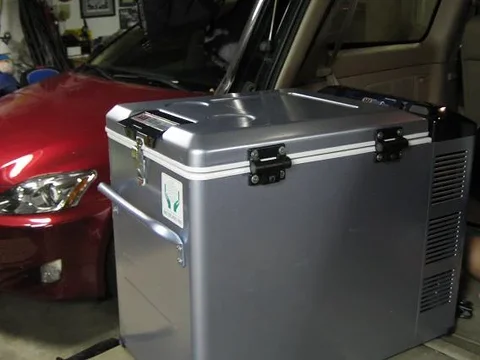

I just had a thought...would those hinges have enough power to keep the lid open as the cooler comes from OEM? Just curious!
I don't think so, they work ok for this but you have to open the lid about as far as it is in the photo for them to really grab. Plus, they would not fit in the stock position. I am sure there is one that would work, check mcmaster under "friction hinge" and see if there is anything that looks right.

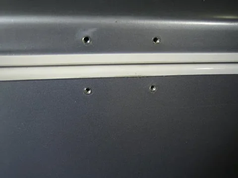

Ok, i installed the new friction hinges tonite and am very happy with the way they turned out.
First of all thanks kevin for breaking the ice on this :beer:
I did it quite similar to his except I used nut zerts for the hinge screws instead of just going into the case. I ended up using the old hinge screws and put some washers under them for strength, they also don't look too bad, I'd rather have the strength personally.
Also I bought the other latch but don't think I'm going to install it, at least not yet. Enjoy the pics and I love that I can now use the fridge one handed. :bounce:
Very nice mod and may be just what I need. My Engel will go in the back cargo area and this mod would make the fridge's interior more acessible from front or back. Right now the lid won't fully open as it hits the ceiling.
Are the nut zerts easy to install, special tools needed? Do you need to dismantle the casing to get those in?

You don't have to dismantle anything. Just be careful drilling the holes. It's mostly insulation behind the metal.
You do need a special to install the nutzerts. You can probably get one from mcmaster for pretty cheap though.
