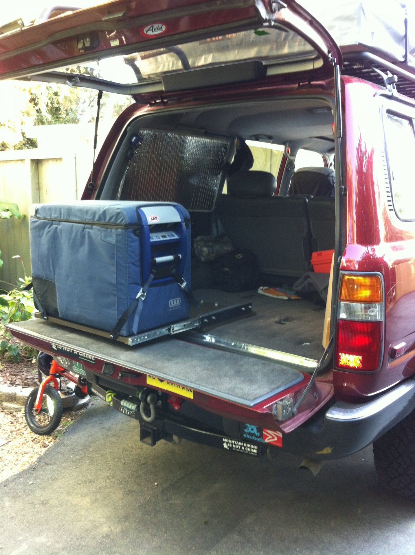

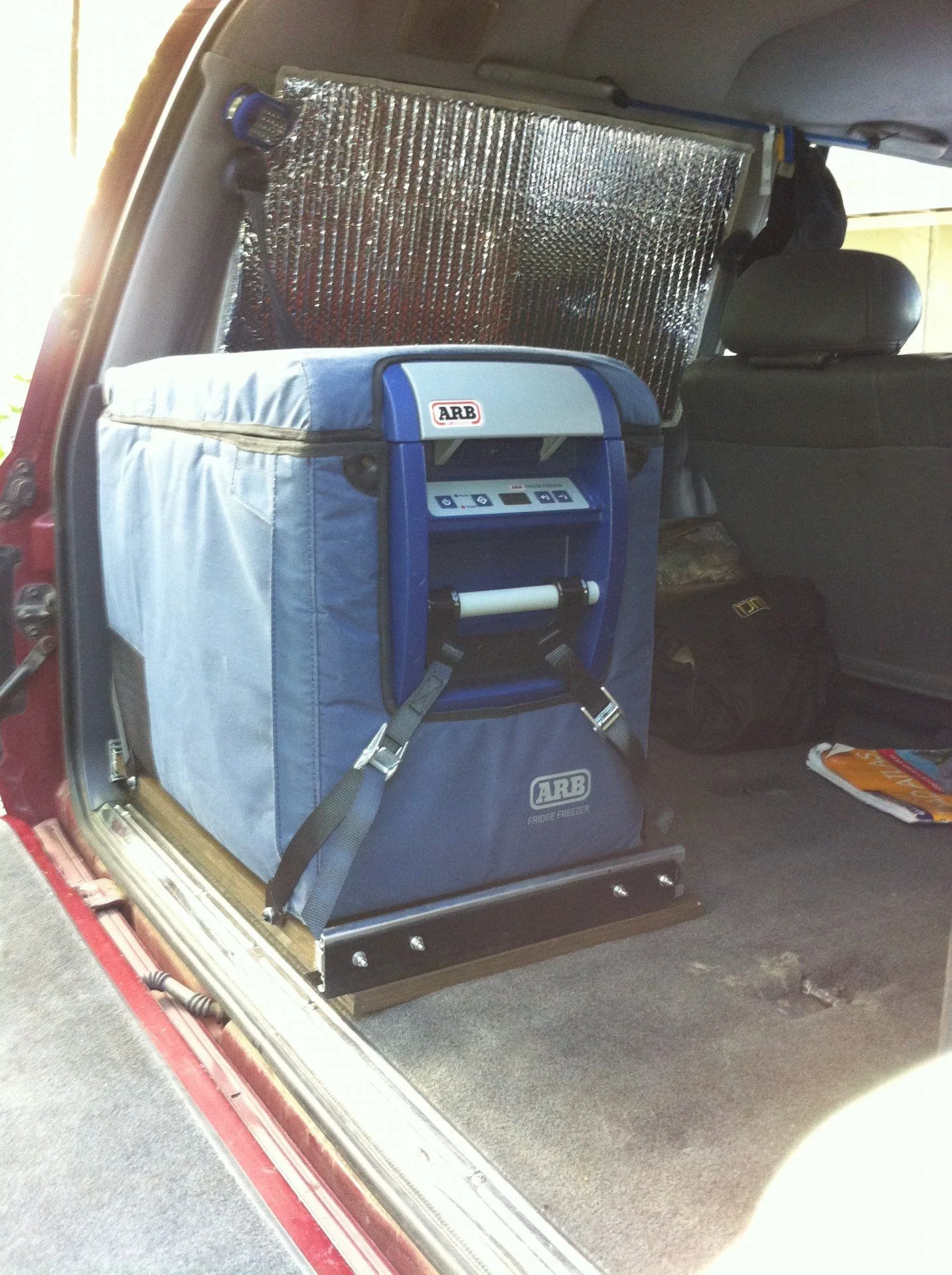

I used 3/4" ply, and some 200# slides. Worked great for 3 years now. I throw bikes in the back at times so I made it pretty modular. Couple minutes and it's out. Gonna actually build a new one with the fridge turned 90* and use locking slides this time.

I used 3/4" ply, and some 200# slides. Worked great for 3 years now. I throw bikes in the back at times so I made it pretty modular. Couple minutes and it's out. Gonna actually build a new one with the fridge turned 90* and use locking slides this time.View attachment 1505567 View attachment 1505565
I like this "sideways" style. That's how I like to keep a fridge in a truck without a slide, so that I can easily get full access inside. Nice job on the slide!!
