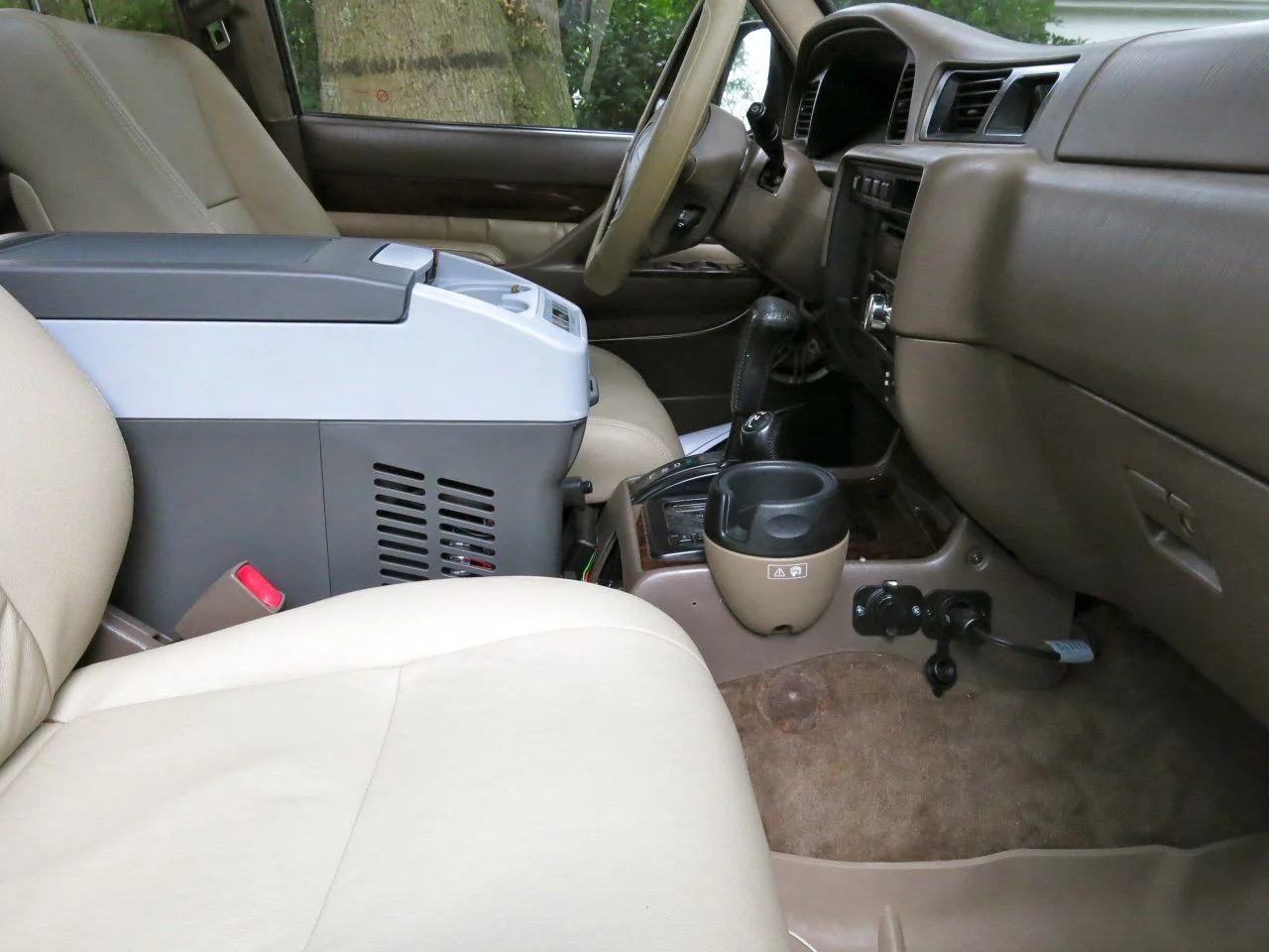

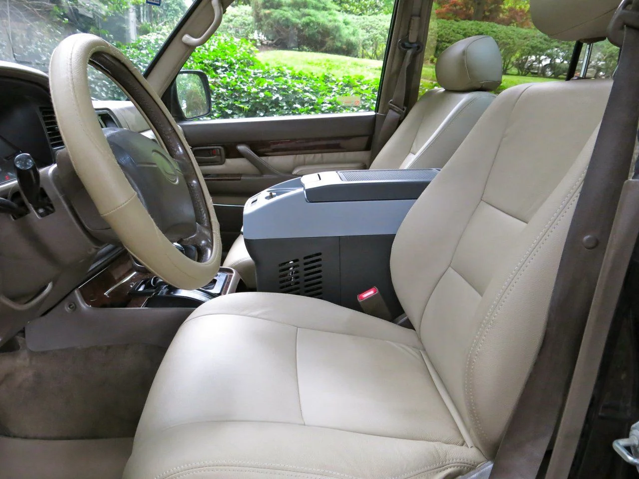

Agreed. I replaced my center console with this for our 2 month trip out West. We kept the 63qt ARB full of food, and used this Dometic as a freezer for ice cream and cocktails. It's awesome as a center console...actually provides a useable armrest and 2 cup holders! One of my favorite mods.
Pics would be nice if you could please
Here are a few pics that I took after installation. It was somewhat 'temporarily installed' for our trip, as I did not have time to fabricate anything fancy. However, it worked out awesome. It's not in the truck right now, as I am still figuring out a way to blend it in better with the shifter console, and look more stock. I painted it two-tone tan/beige to match the interior.
Nonetheless, it's an awesome mod. I have a fuse box under the passenger seat and ran dedicated wires to a 12 volt outlet in the center console as you can see in one of the pics.

Yes, it sits just above the door armrests. Their 'literature' states that it holds six 12oz cans.
The model I bought holds 22. My only bitch about this cooler is you think the R&D would make sure it is even cans, either one direction or another. It's off by about a 1/2"...so there's space between cans....a little too much.
Mine only holds bourbon, rum, and coke (the liquid kind)...so I've never tried to fill it with cans only.
And ice cream. We typically keep ice cream in there all summer...which is awesome to grab an ice cream sandwich at the stop light.
