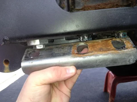

I got a set of 03 ARB bumpers (Sahara front) without instructions and a box of bolts and hardware. The instructions on the ARB website are for the Deluxe front bumper and must be for the 99-02 bumpers because my winch mount is not as pictured. I can't figure out the right bolts, washers, nuts etc on this and could use some help.
I reused the bolts that held my tow point and tie down brackets but the bolts are too short to keep the tie down brackets. The result is pictured here with almost an inch of space between the bottom of the winch mount and the frame.
After I installed those all the way around I noticed a bracket that looks like it needs to be involved somehow:
I do not have any 10mm bolts that will fit through the chassis mount and frame horizontally but did see some long bolts that fit vertically from top to bottom but don't quite seem right. You can see it below, it's the long bolt that starts at the top of the frame rail and goes through, sticking out the bottom, just in front of the tow hook.
Any help would be appreciated.
Just looked at mine. I agree it fills the space between the bumper and frame but mine is installed as oriented in the 2nd photo above, not flipped at TM indicated.
