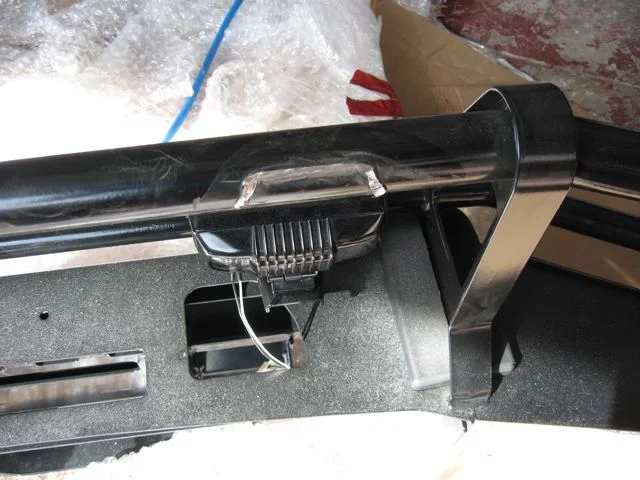

Can someone post a pic of what needs to be cut?
Thanks!
For the TLC or the LX?
For the LX its just cutting the two light tabs on the upper bar of the bumper.
For the LC its the little at the end of the frame. Im gonna guess that not many people are gonna be able to show you that pic considering most everyones bumper is already installed. Unless they can find the directions, i think there was a pic in them.
Very simple cutting either way. Just buy it and youll figure it out! ;)
I have a 01 LC. I am in the process of buying a use one. So I might not have the instruction. Anyhow, it sounds like a simple cutting job. I will take a pic when I finally get the bumper.

For LX, this shows tab cut off already... (grind smooth and paint too). Don't have pic of the tab on though.
attachment.php

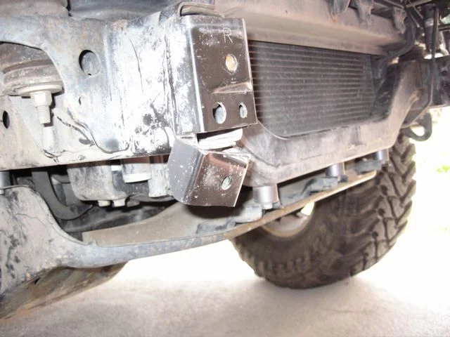

For all LX/LC's, cut... (with cut-off air tool or hacksaw)
attachment.php
Hoser,
Thanks for the pics! That really helps. Now I know exactly what needs to be cut.

Are you referring to the tips of the frame horns? You'd have to do that no matter what year (though I heard the very latest versions, or maybe it was for the 200 Series, did not require this anymore). Anyway, if you have a bumper that requires the cuts, you'd have to make them no matter what year truck you put it on.
IIRC the early 03 combo bar did not require the tabs to be cut off, it came with big heavy U tube spacers that slid in behind the plate that you cut off on the later ones. Not sure about pre O3 bars though. I don't think the bar I am referring to is still made, just a point for someone if they pick up a second hand bar.
