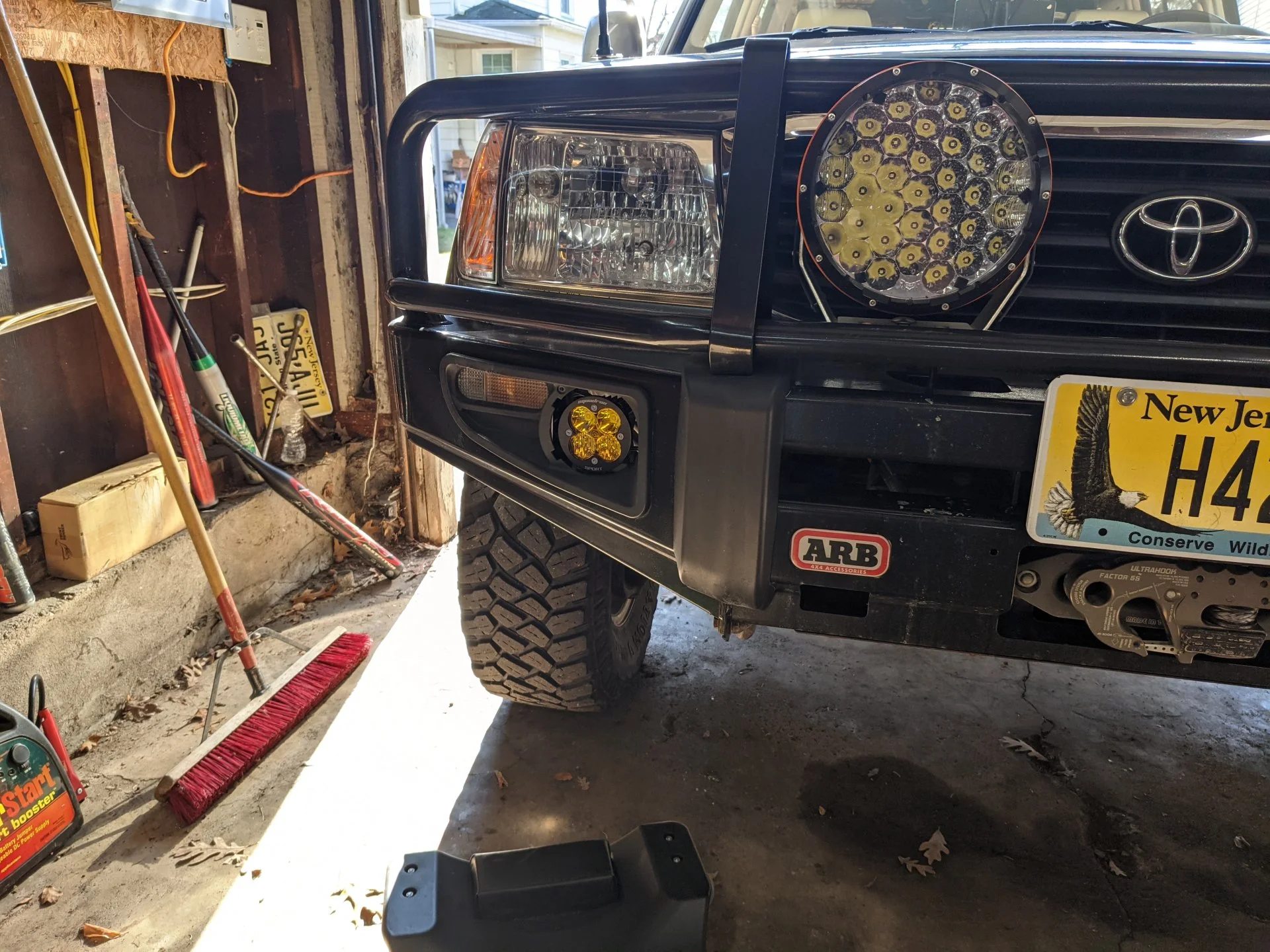

Looking to supplement my non-highbeam lights, I looked at brackets from Slee (known quality) and Paranoid Fabrications (unknown quality to me). As the Paranoid brackets were $30, I rolled the dice. They're perfect for what they are, which is a couple pieces of bent aluminum that bolt onto the ARB insert and hold either Baja or Diode lights. Other lights my also fit.
Being a Baja fanboy, I was hoping that their Squadrons would fit the bill, but DD S3 has a better SAE fog that's ultimately a bit cheaper. The cutoff is good and the lenses are changeable, just like Bajas. Baja is still king otherwise. :flipoff2:
The DD S3's come in white or yellow. Their whites come at 6500k (which sucks). Yellows from the factory come with the yellow lens and a 4000K LED (per DD). I bought the yellow, plus white replacement SAE fog lenses, netting at 4000K light (theoretically). I have run the yellows in dense fog and to supplement my low beams and they were really good. I haven't fully tested the white lenses yet.
In my state it is legal to run white or yellow fogs in addition to low beams at any time. The fogs are wired into my factory lighting and activated from the stalk. Any vehicle inspection would find that they are of the proper type, output, configuration and activation to qualify as fog lights, i.e., I'm legal to run them anytime. Your state may vary.

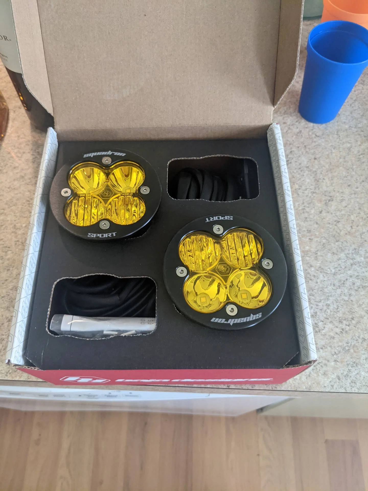

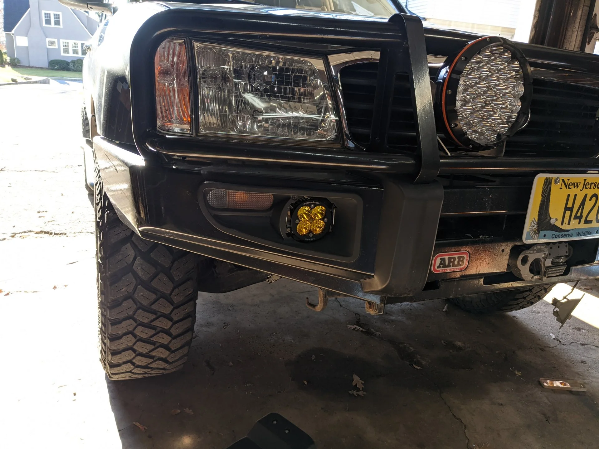

I haven't seen it mentioned yet ,but paranoid fab makes brackets to hold baja designs or diode dynamic fog lights. I bought a set of Baja design squadron sports and have been very happy with them.
Thanks for sharing. I may give those a try.
What driving / fog lights are you running on the bull bar? Are they 9” ? They’re huge!
Yeah, big lights to compensate for the small... mpg's. Those are stedi 9" driving lights, they throw an incredible amount of light, and they don't look as obnoxious with the covers on.

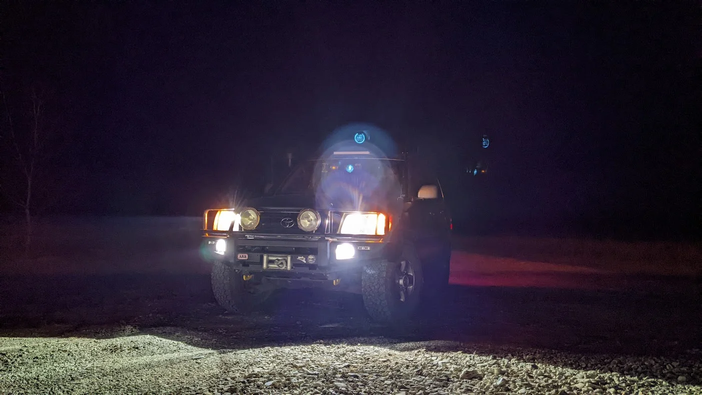

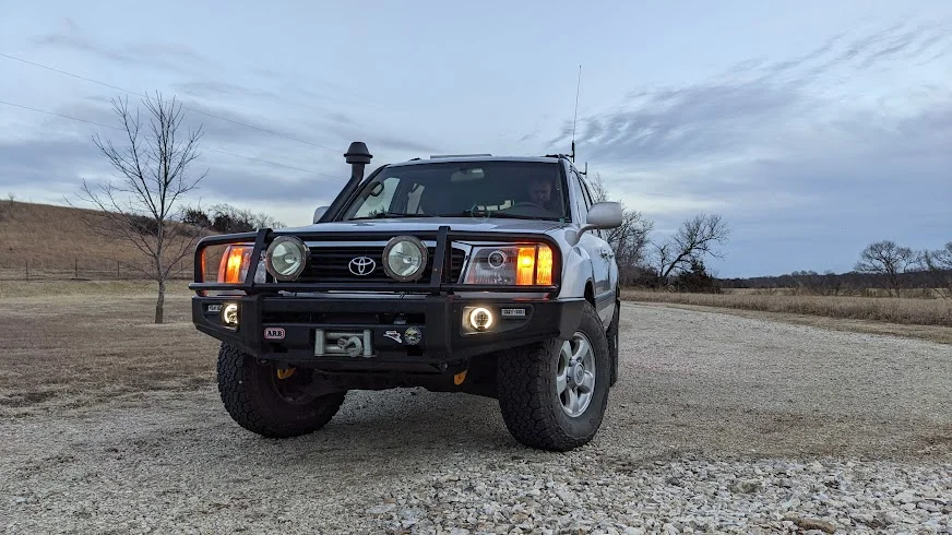

After almost 4 years my amber Xprite fog lights filled with moisture and started blowing the fog light fuse. I ordered the Stedi fog lights designed for the ARB deluxe bumper as a replacement. I added some 9006 plugs to the Stedi harness so they would plug into the factory LC fog light harness. They installed quickly and easily.
The Stedi replacements might be too bright to use as actual fog lights. Their light cut off isn't sharp, but they do concentrate the light down low and shouldn't blind oncoming traffic. The light color is also more blue than I'd prefer, maybe around 6,500k color temperature. They are brighter than the Xprite fog lights I previously had.
The DRL halo is kind of cheesy but I hooked it up to the parking light circuit.
I look forward to trying these things out in snow/fog/rain. I'll report back with my experience.
