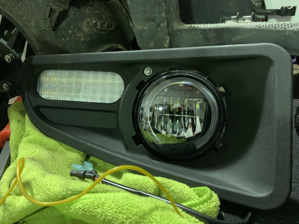

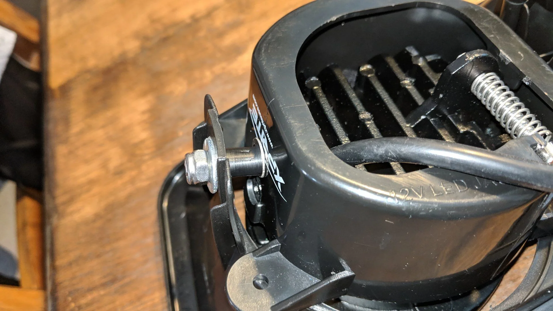

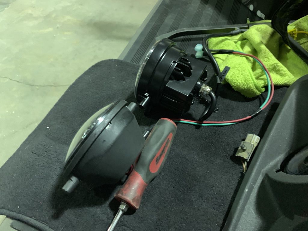

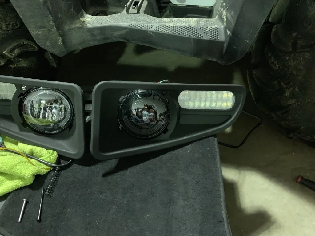

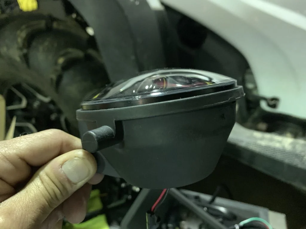

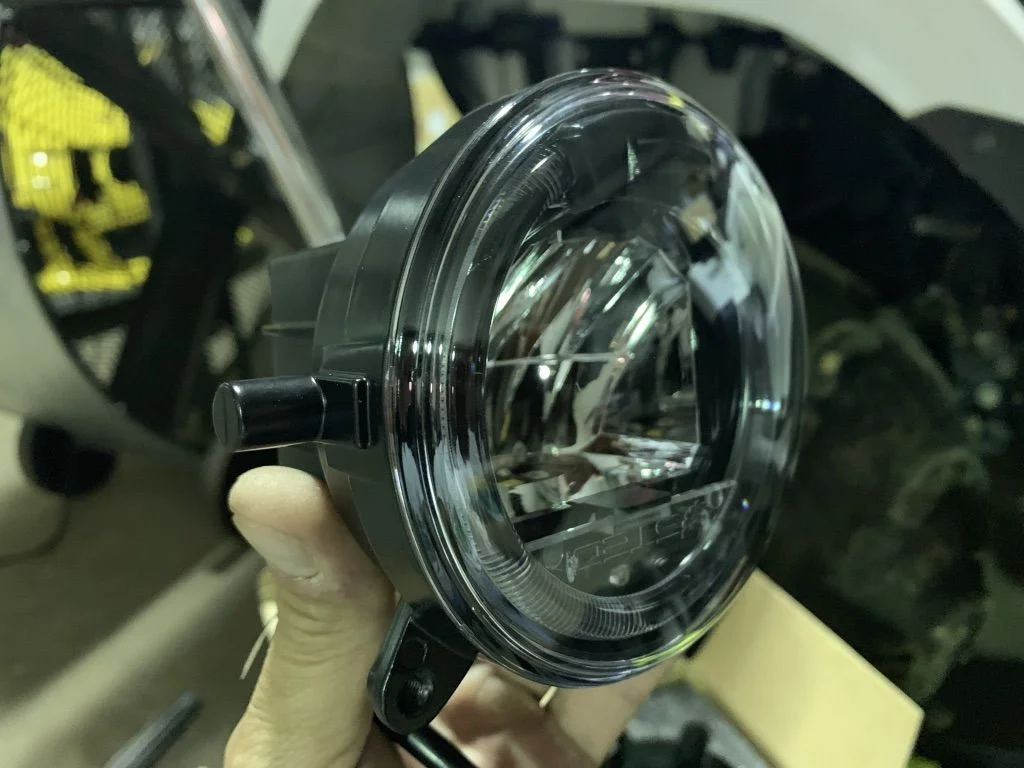

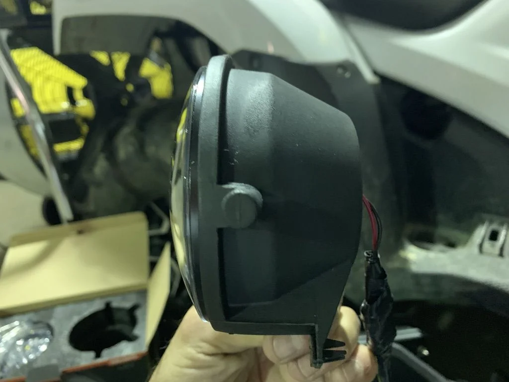

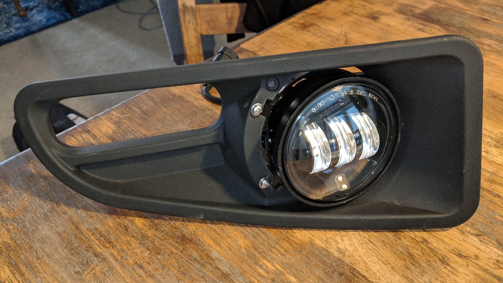

I did the Jeep JK LED fogs on my ARB. I had to trim the LED housing mount a little and drill a couple of small holes into the ARB insert. No adhesives required and the lights are still adjustable.

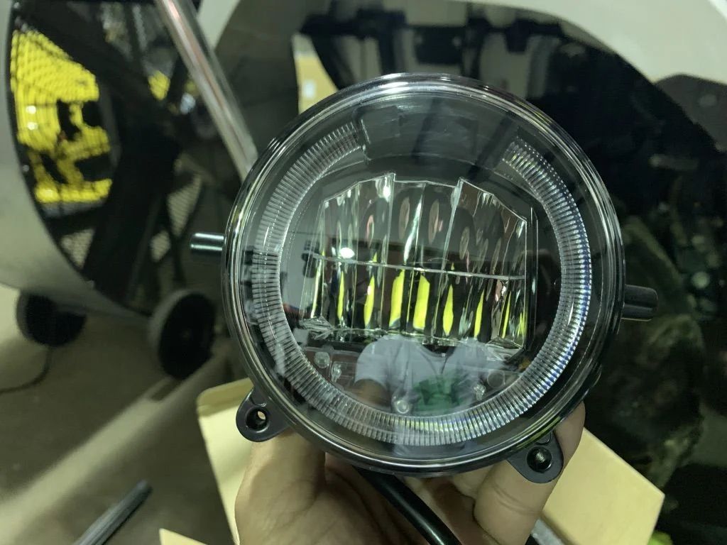

*The lens on my Xprite light was installed upside-down.

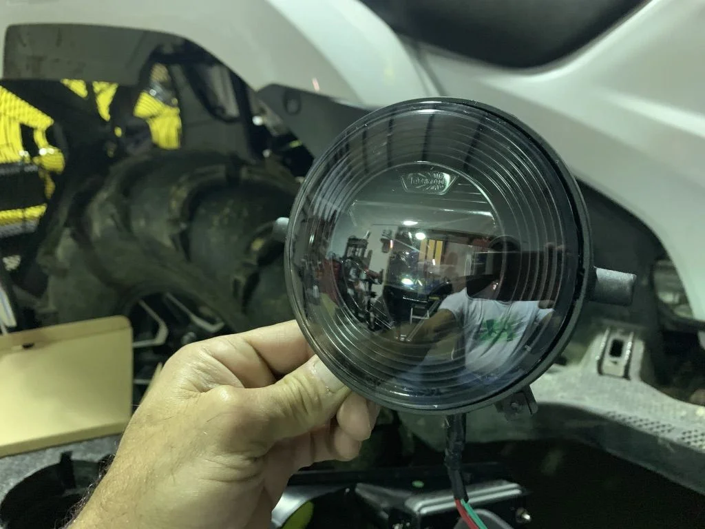

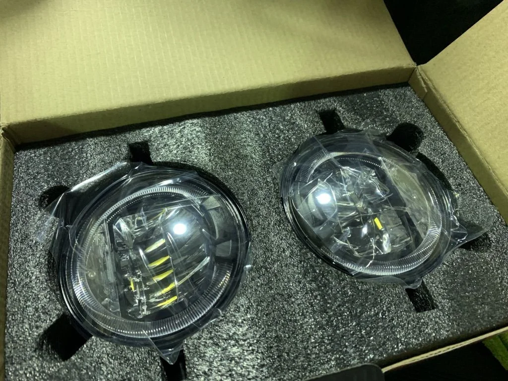

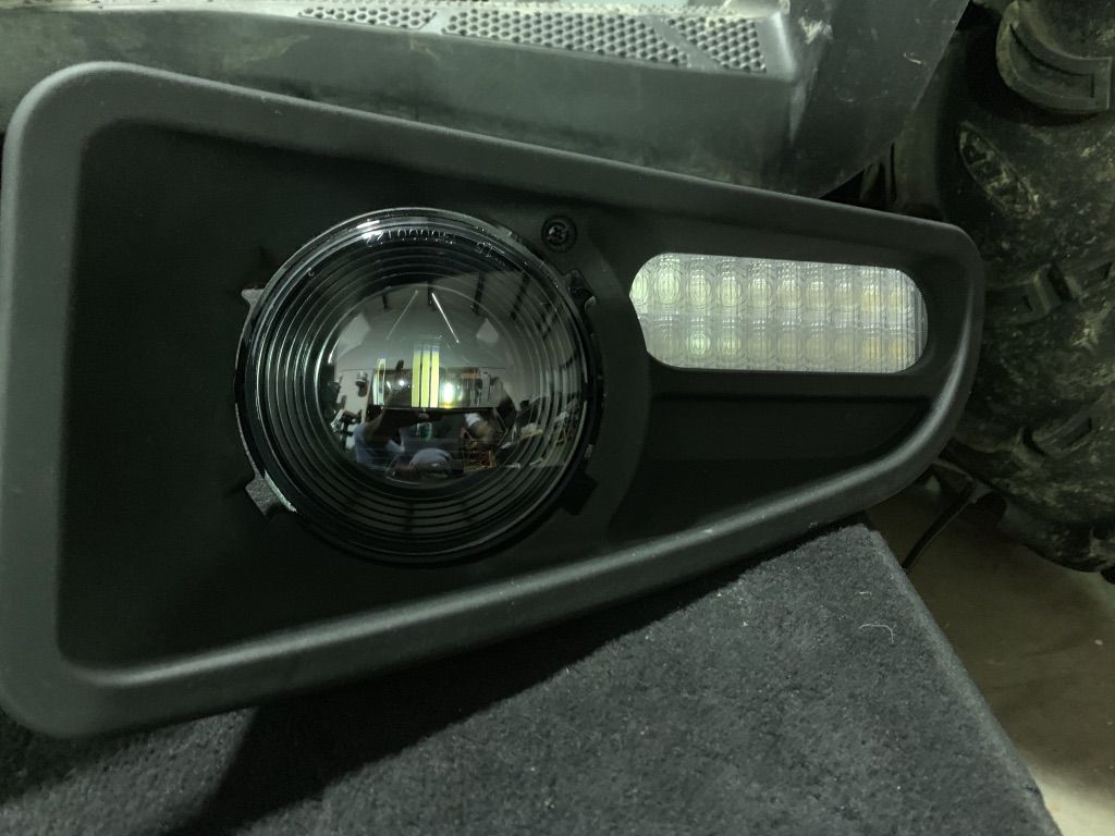

For those of you that want to see what the Stedi's look like, here are some pics.

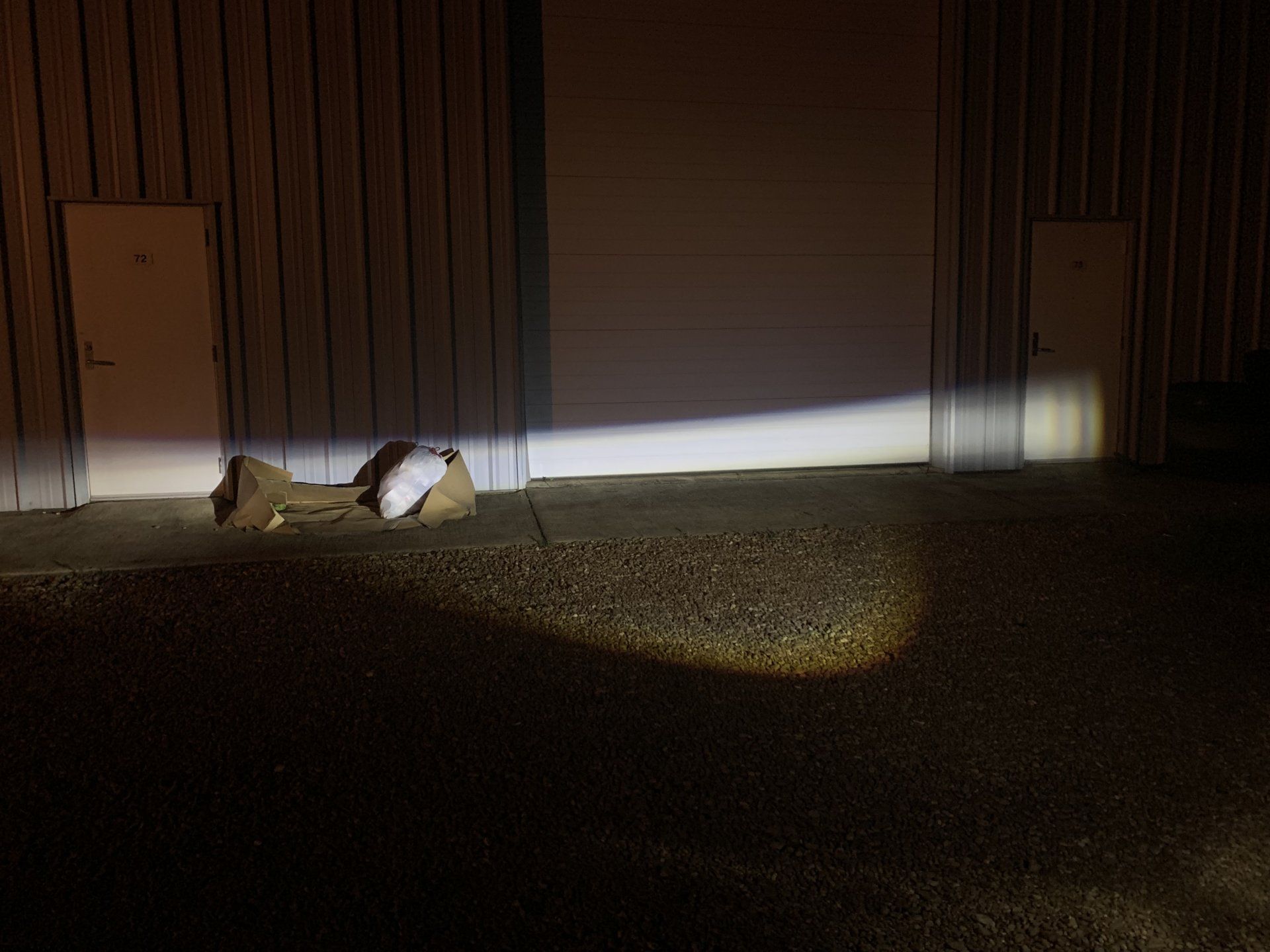

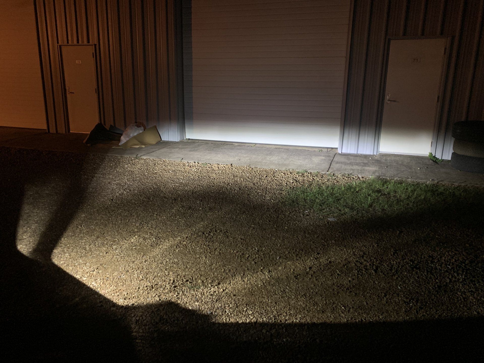

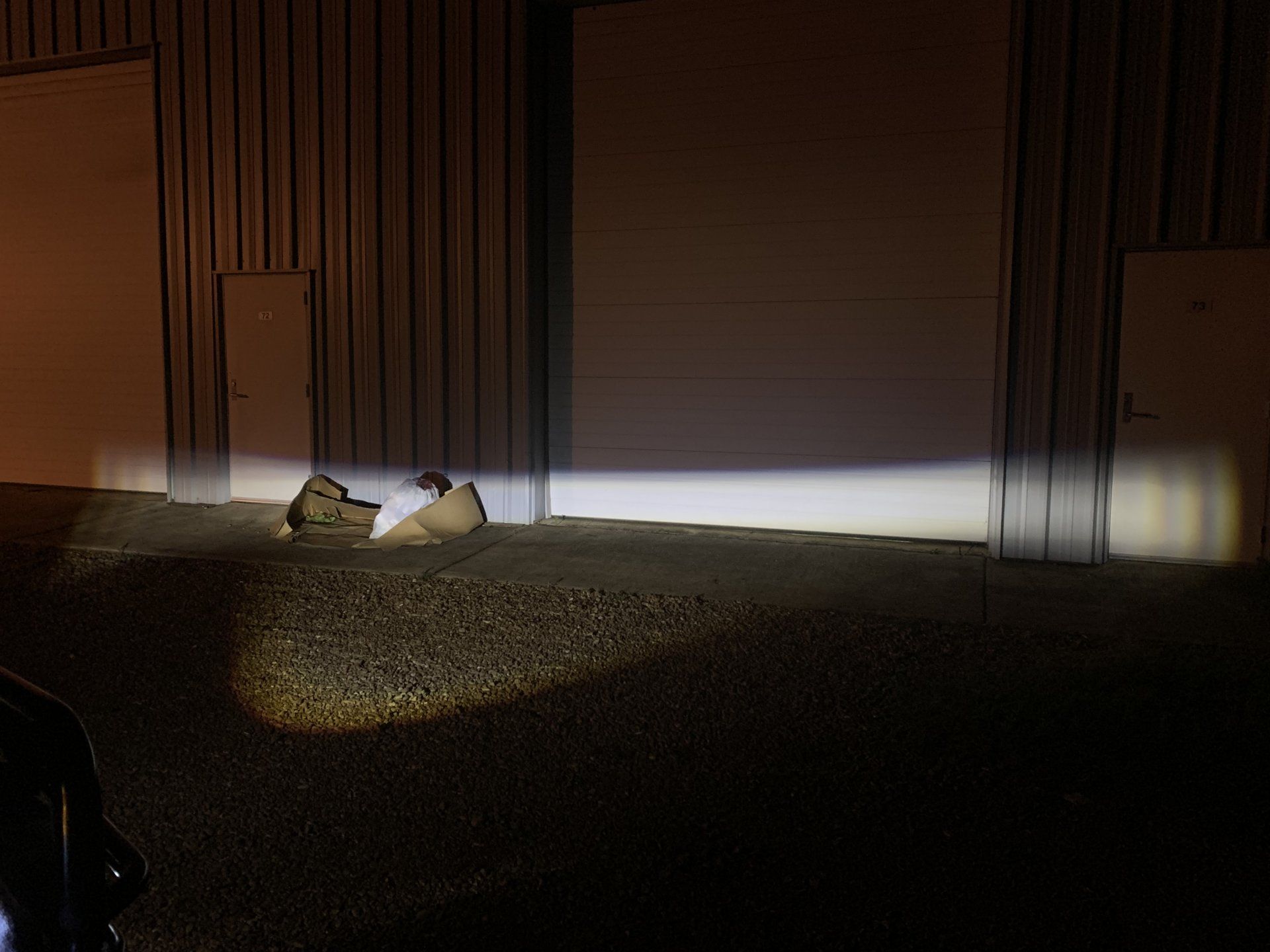

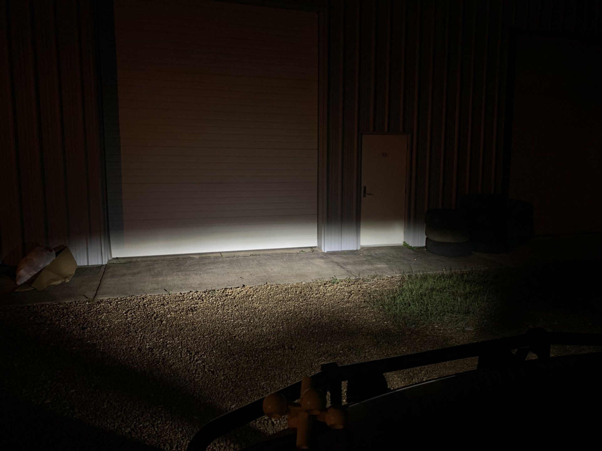

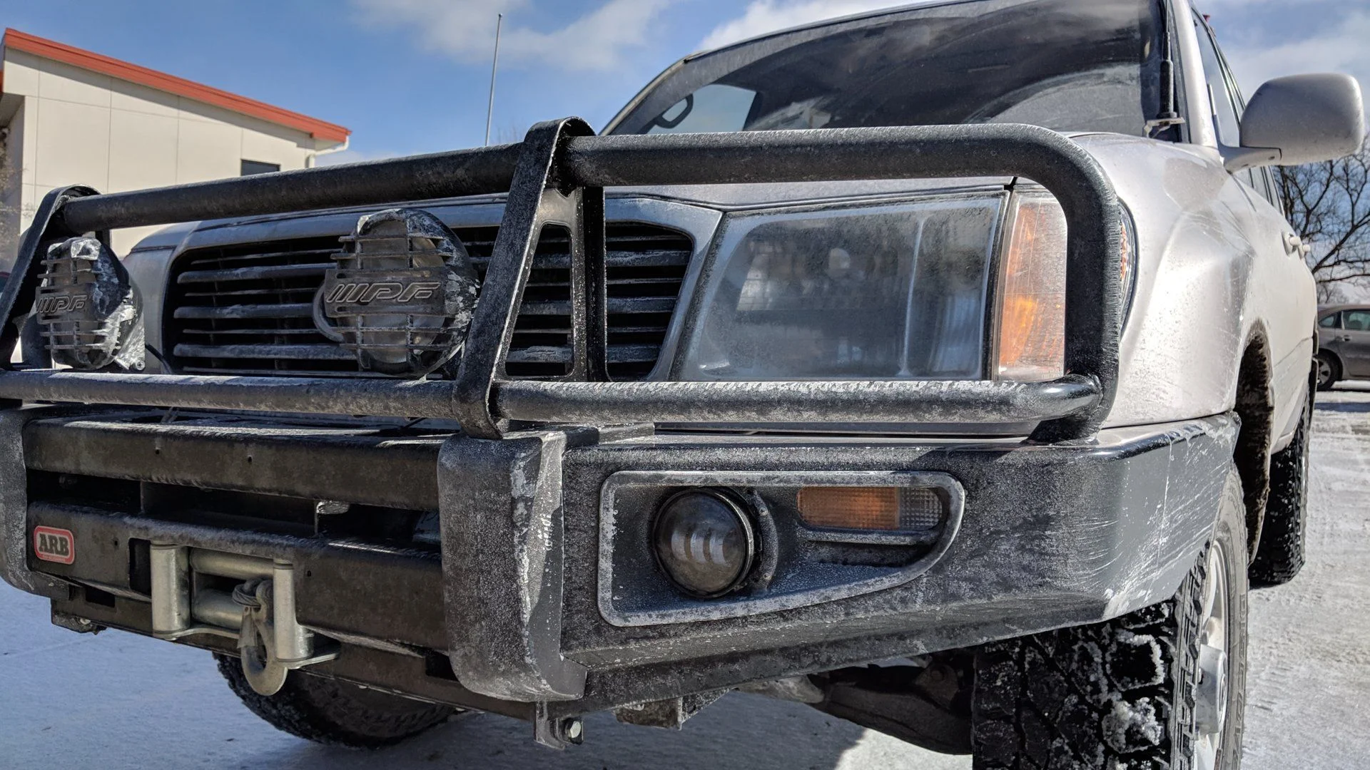

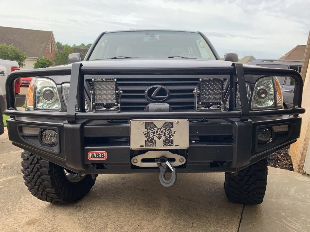

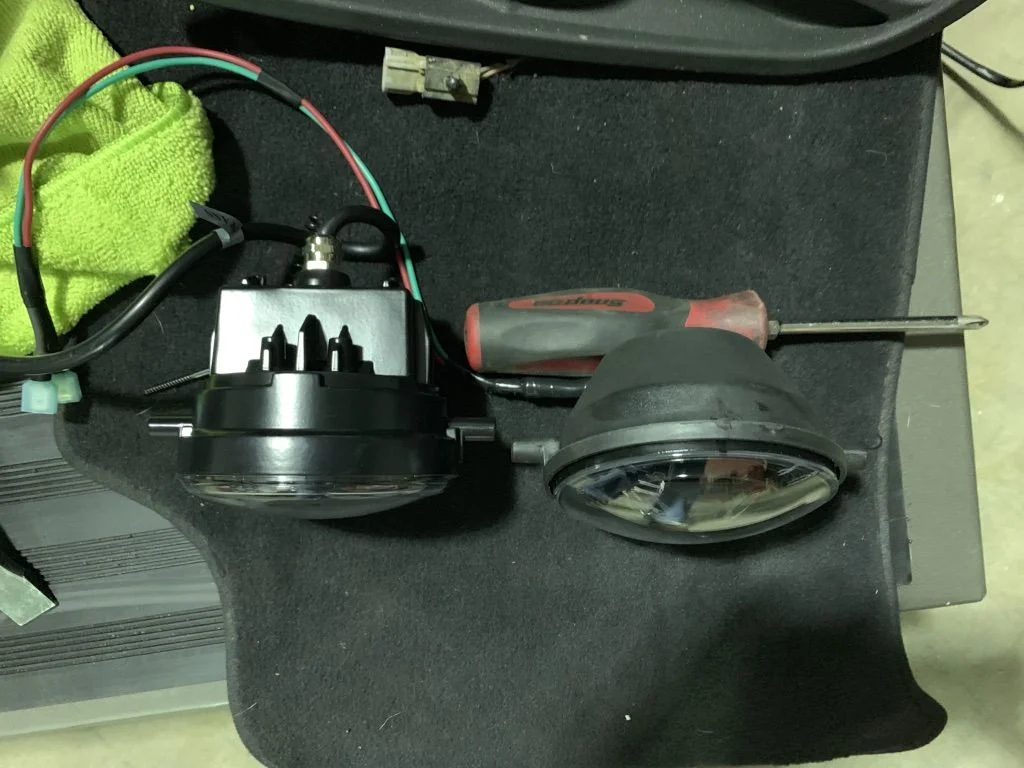

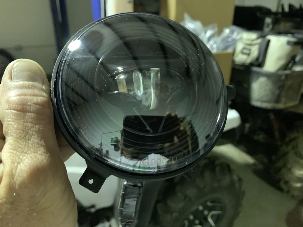

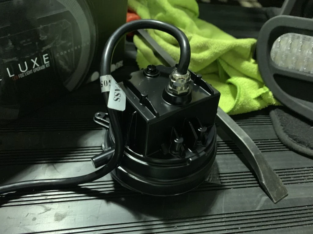

Before I ordered the Stedi's, and knew nothing about them, I modified my existing ARB fog lights to fit Morimoto 4" LED fog lights. They go in clean and function exactly like the factory ARB lights. The one thing I like about the Morimoto's is that they are black and blend in with the bumper better. However, the one that has the best light output will stay on my LX. Following are some pics of the two - light output will follow soon.

Did you determine which light has the better output?
Many projects going on...will try to do a comparison in the next couple of weeks.
View attachment 1956349View attachment 1956351

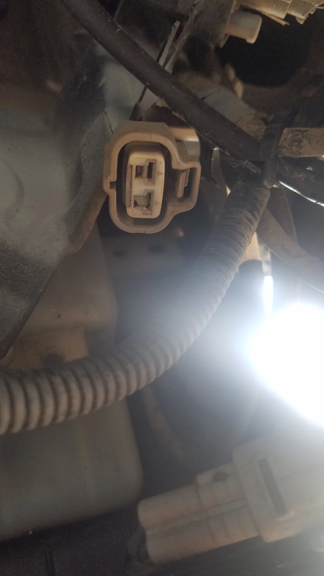

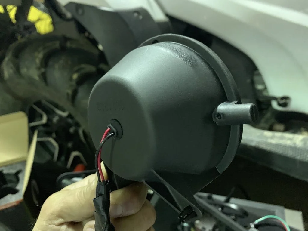

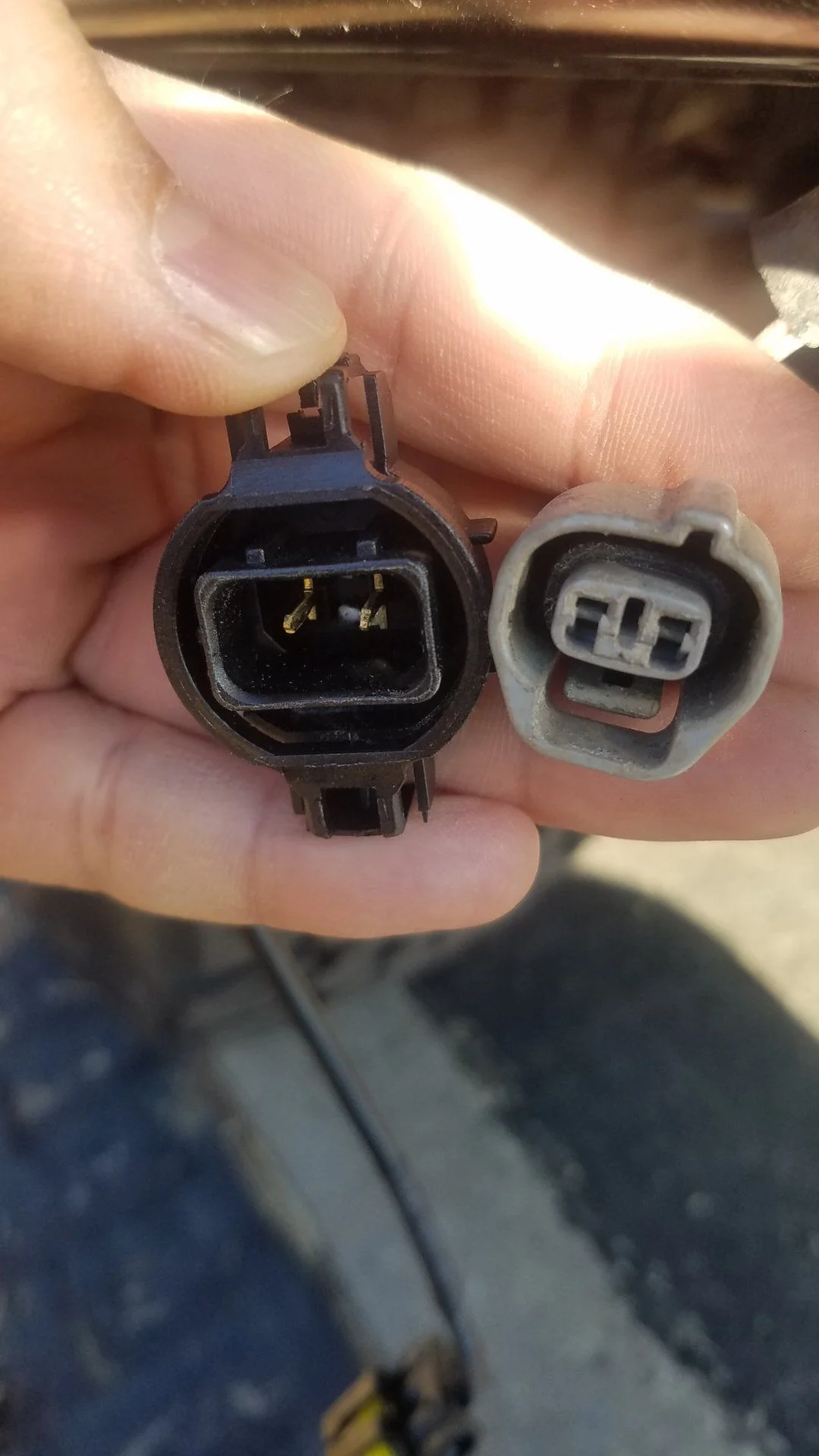

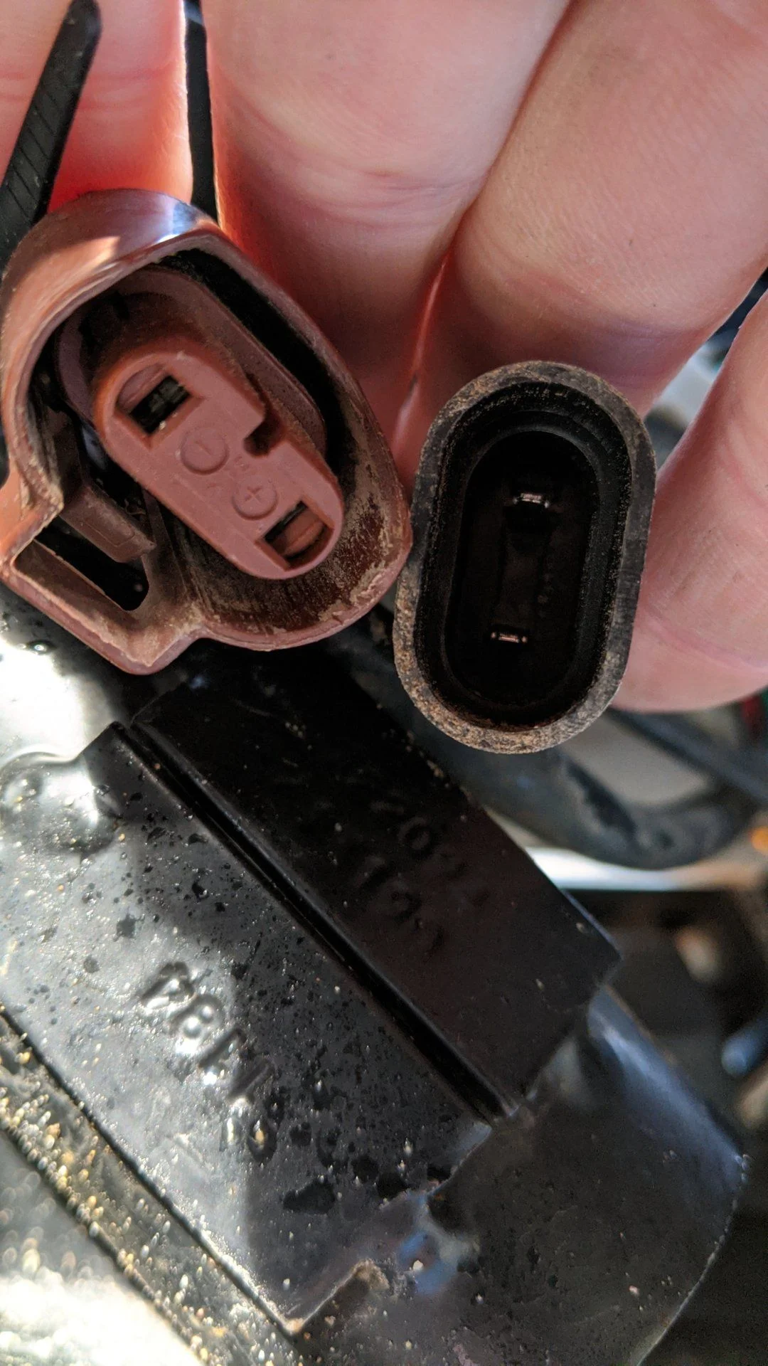

How are you guys wiring these up? My factory harness (on the right) doesn't match up with the Xprite plug. I thought I would ask before I cut off the factory plug.
They plugged right into the factory fog light plugs on my '99 LC. Mine also came with what I assume was an adapter to connect to the JK harness.
You could get some 9006 connectors (assuming the LX and LC share the same fog light) to plug into the factory harness and chop the plug off of the Xprite.

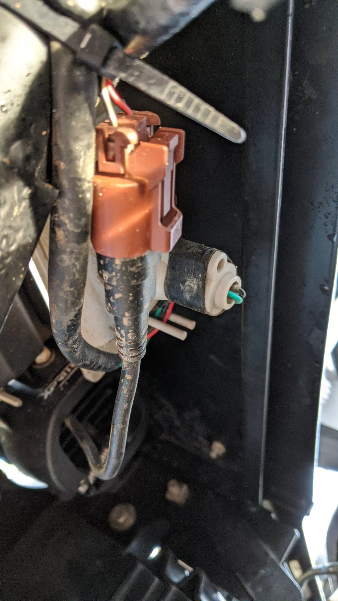

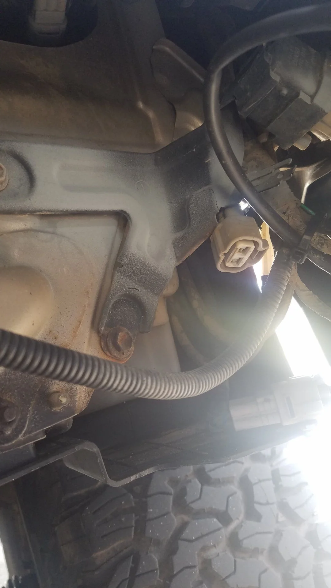

Oh bummer, looks like LX ones are very different than LC. Time to go chopping!
I also found an unused plug tucked in that area that looks a lot like your LC fog light plug.
