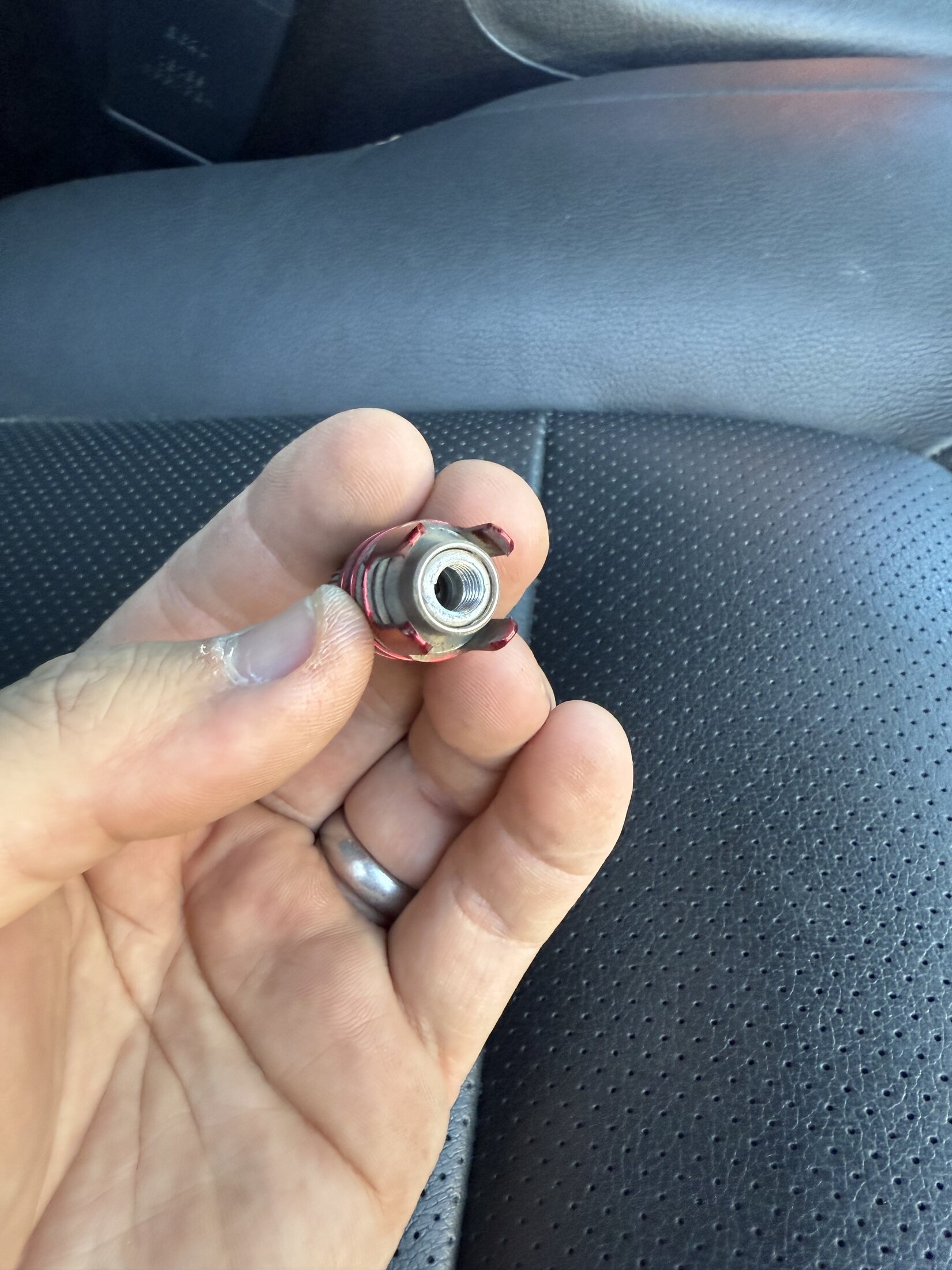

Well I figured it was only a matter of time, but I did think I’d make it more than 6 months. Snapped an RCV clean off on a trail today. Knowing that Schrader TPMS exists to work with Apex RPVs properly without the janky chain bracket mean I’ll be swapping back once more to the RPVs—glad I held on to them
