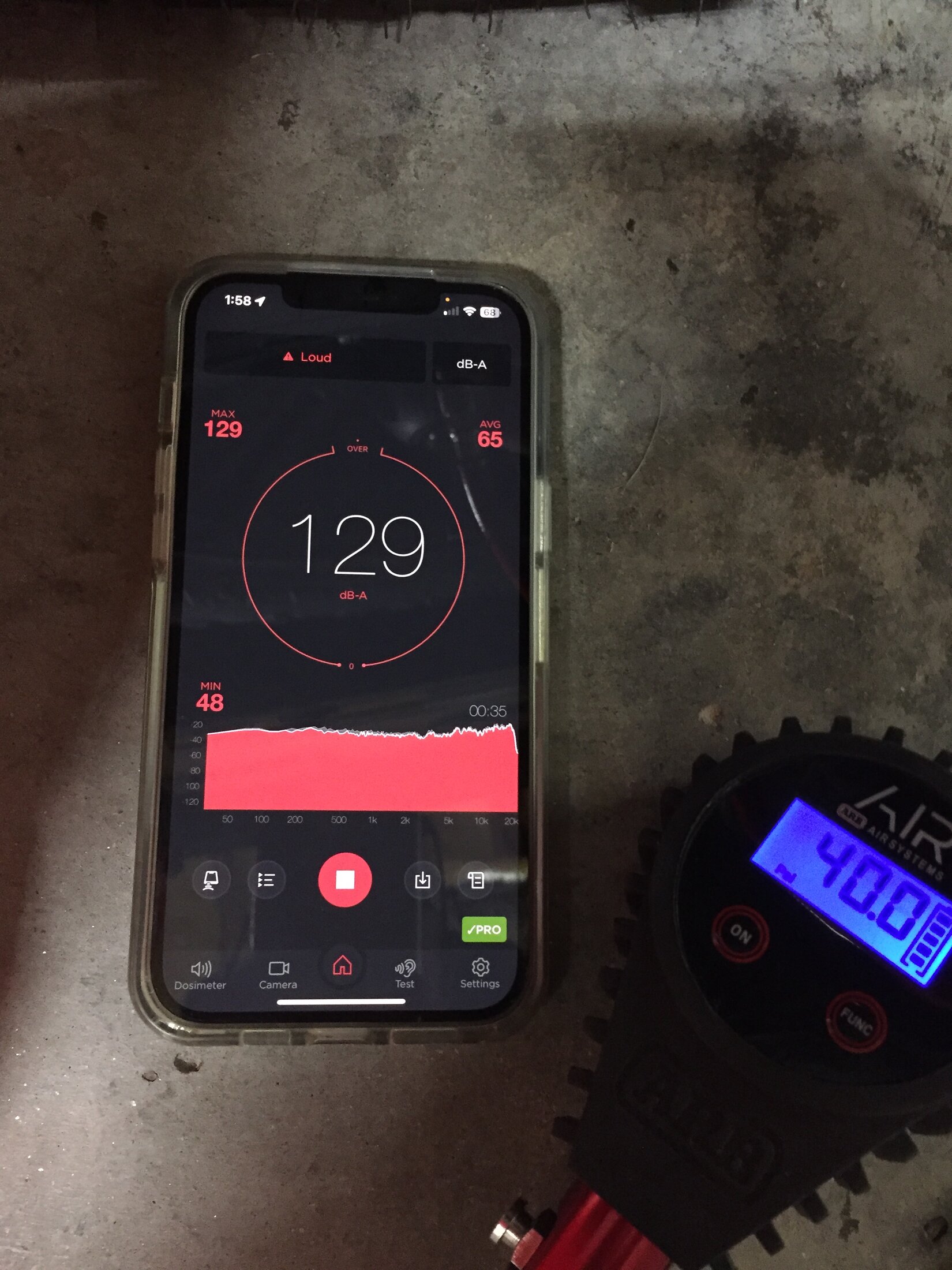

I now have the RPV’s installed on my camper wheels and I did a timed deflate, they are quick and hella loud. See picture below for decibels. Tire size is 285/75R16.

They are loud for sure. Just wait to pull the valve when your wife is about to criticize something you're doing. 😂 Not that she would ever do that. I've loved them so far. I think my 200 with 34s deflates from 38 to 18 in about 13 seconds. The staun deflators are cool but were always getting out of adjustment so the tires were all over the place. Just grabbed a second set of RPVs for my 80.

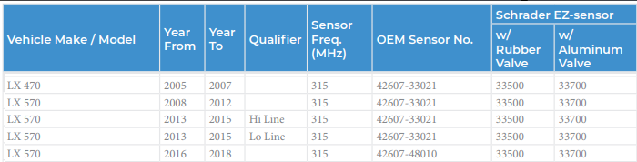

Dropped by Discount Tires with the RCV valve stems today. They don't carry a compatible TPMS sensor. All of them are pre-integrated with a valve stem.
They're still willing to install and clone a TPMS, provided I can find a compatible TPMS.
So got to do some leg work to find one unless someone has a lead? I'll also try contacting Apex to see if they have any recommendations.
@TeCKis300 - Apex recommended these to me:

When I took mine in I had some ARB internal TPMS that they installed on mine. They are Schrader TPMS, just like the @residualboulders link, but were programmed for my Linx. They attached no problem.
Editing to add: as I type through this I keep kicking around buying the Schrader programmer and some sensors. The old “if you want something done right” adage seems to always be popping up.

Looks like I'll want to order 33500 for my 2009 LX.
