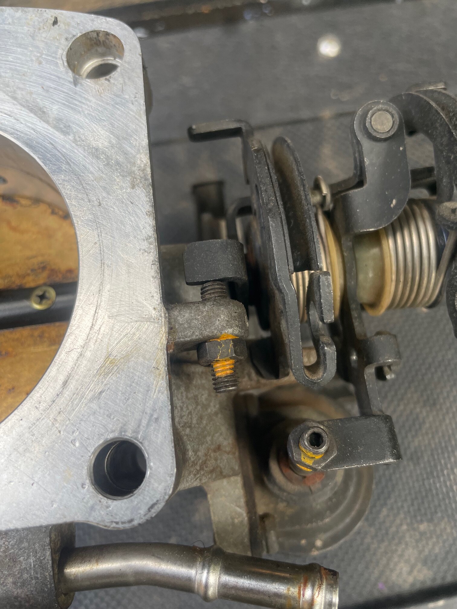

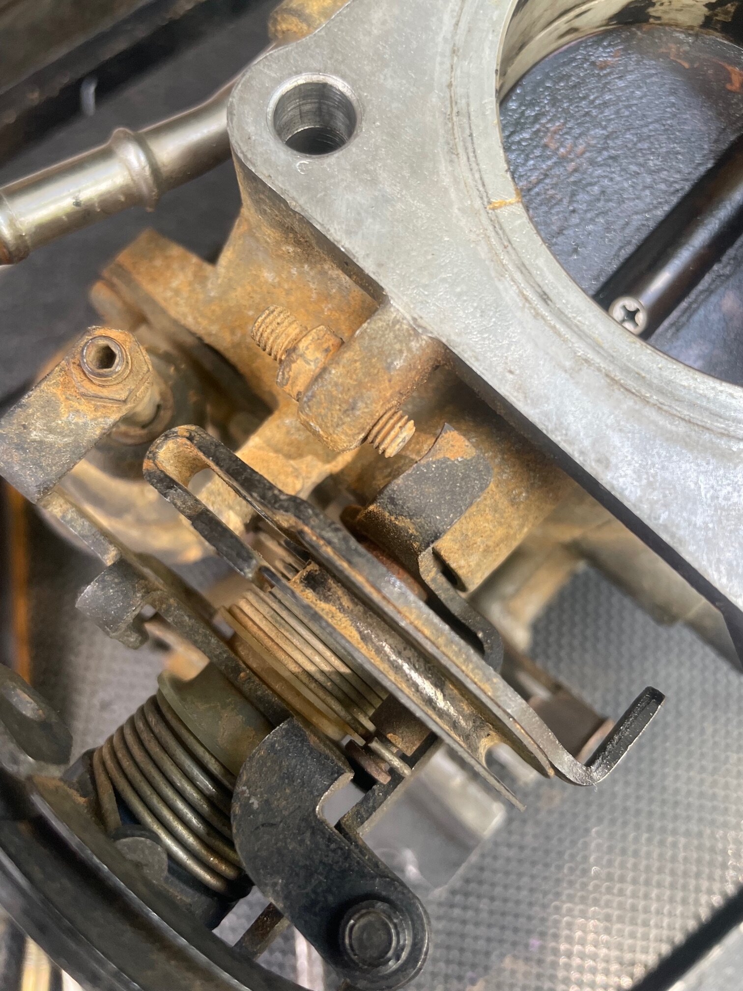

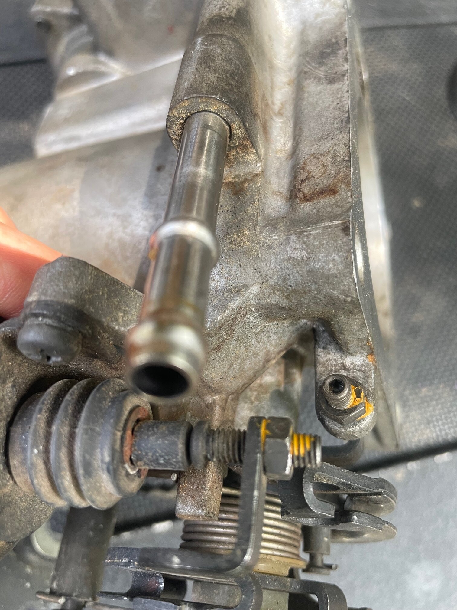

Finally have sorted out the poor running and idling issues with the Black Beast.

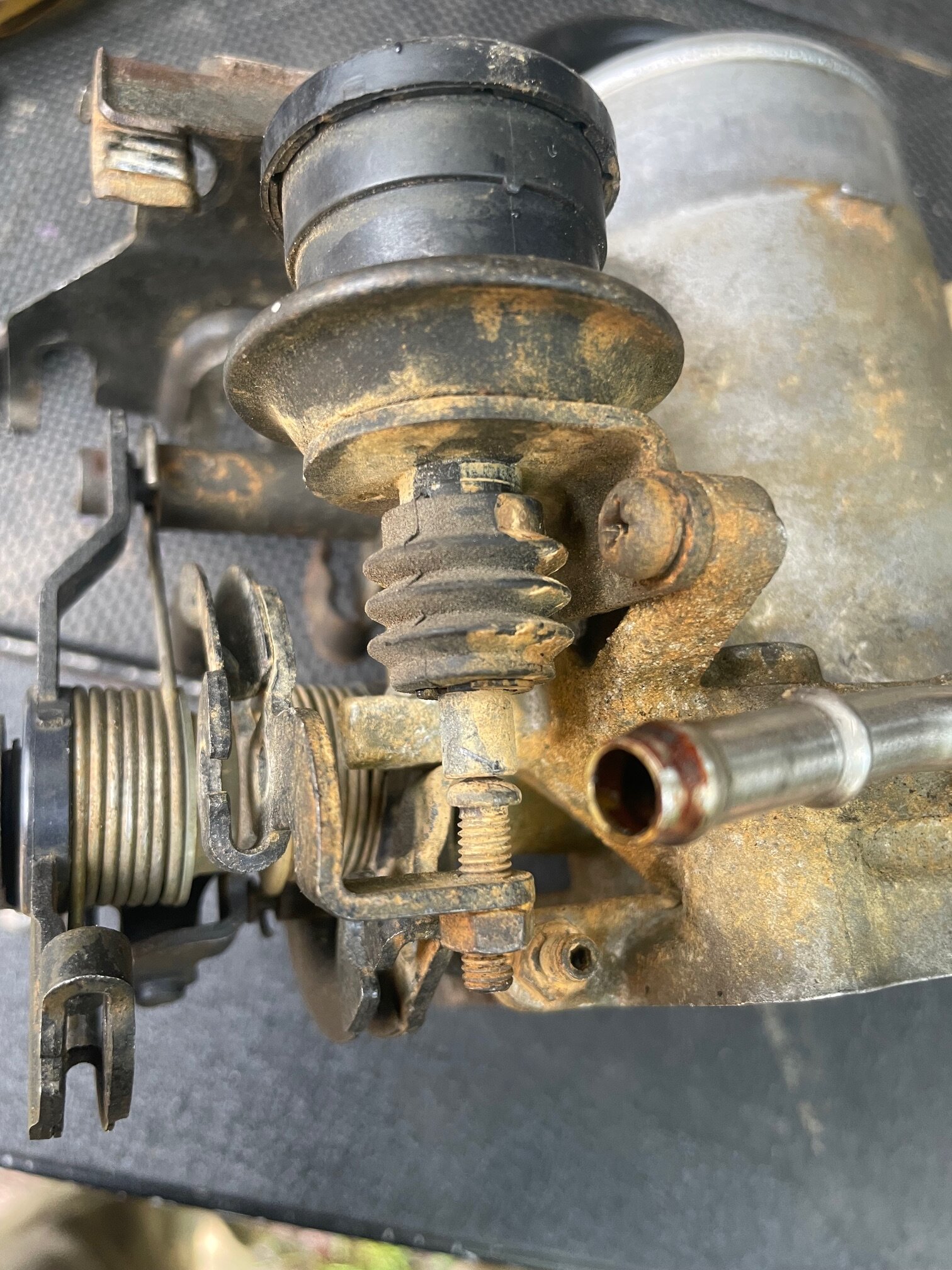

On this throttle body note that the adjustable screws have paint marks from the factory. I removed this TB from our other 80 when I did an engine swap and the adjustments on these screws should be the factory settings.
The TB on this LX450 had one screw that I think had been jacked with and was adversely affecting the idle and preventing the idle stop from fully seating as needed.

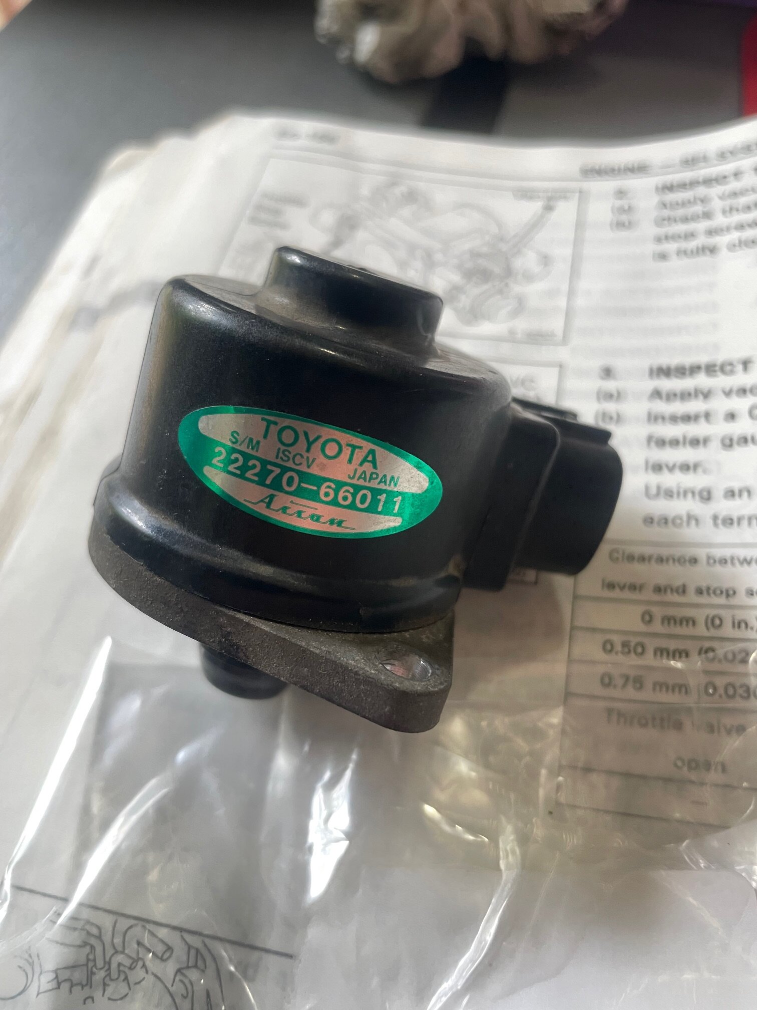

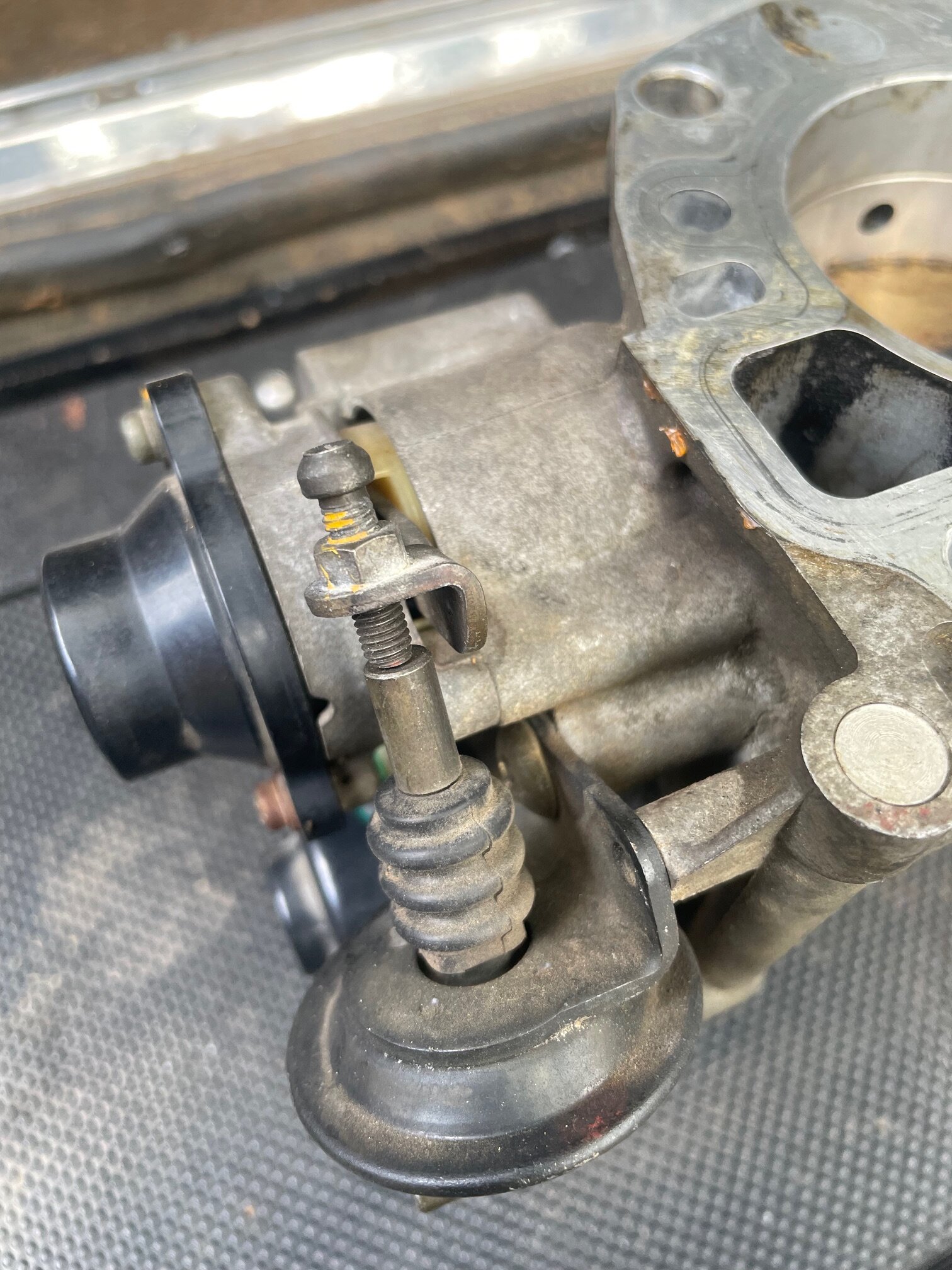

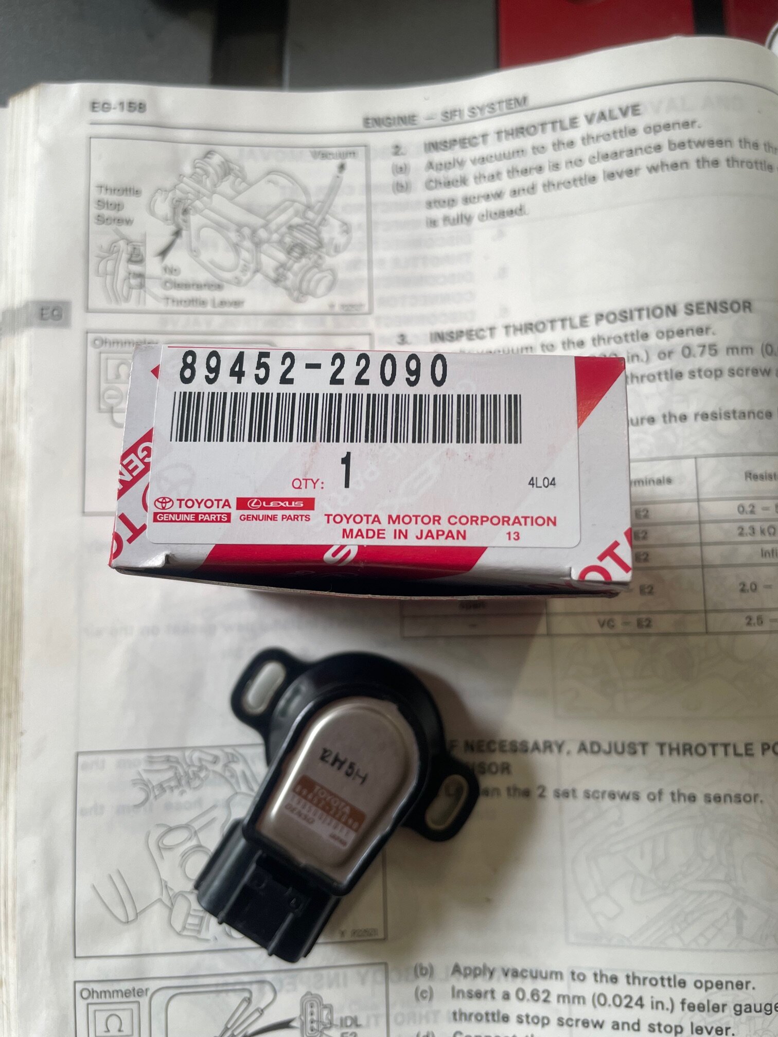

Today I installed a new TPS to FSM spec in the factory set TB and also cleaned the ISC and reinstalled with a new o-ring.
I then drove it on level ground and a nice hill. It was still a dog. Idle issues were corrected but it had low power, like less than 2F power, pulling the hill. I checked the timing and it was severely retarded so I reset. I was aiming for 7* but from a gauge the reading was 9*. Anyway the 1FZ now runs much better, good acceleration and can pull the hill.
View attachment 3952581View attachment 3952582

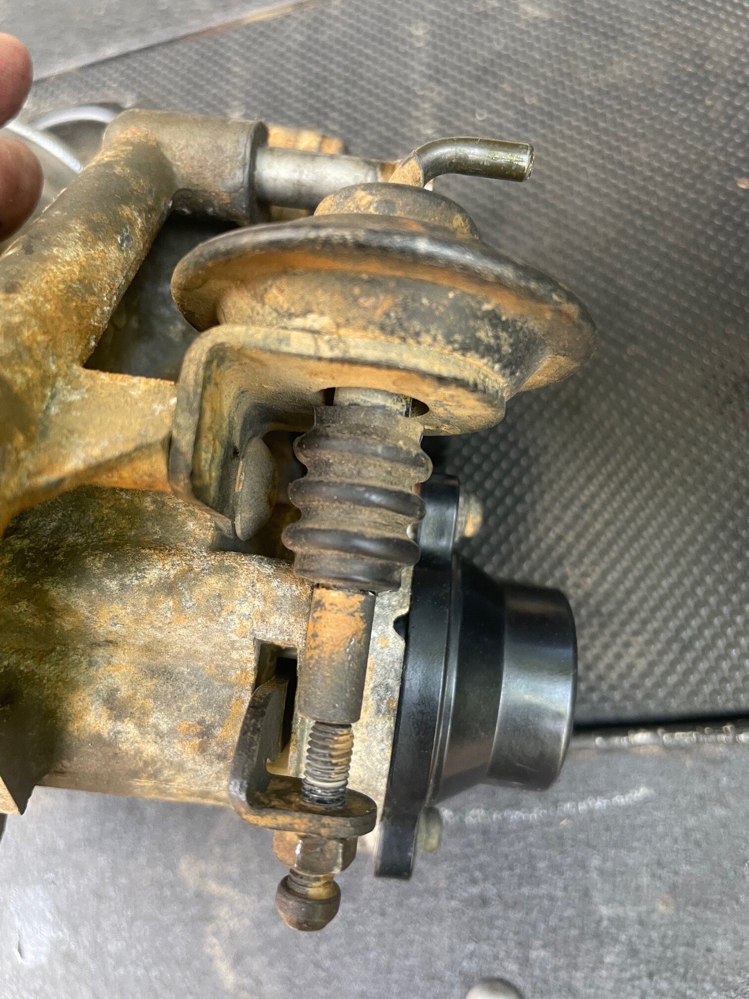

The TB on this LX450 had one screw that I think had been jacked with and was adversely affecting the idle and preventing the idle stop from fully seating as needed. View attachment 3952588

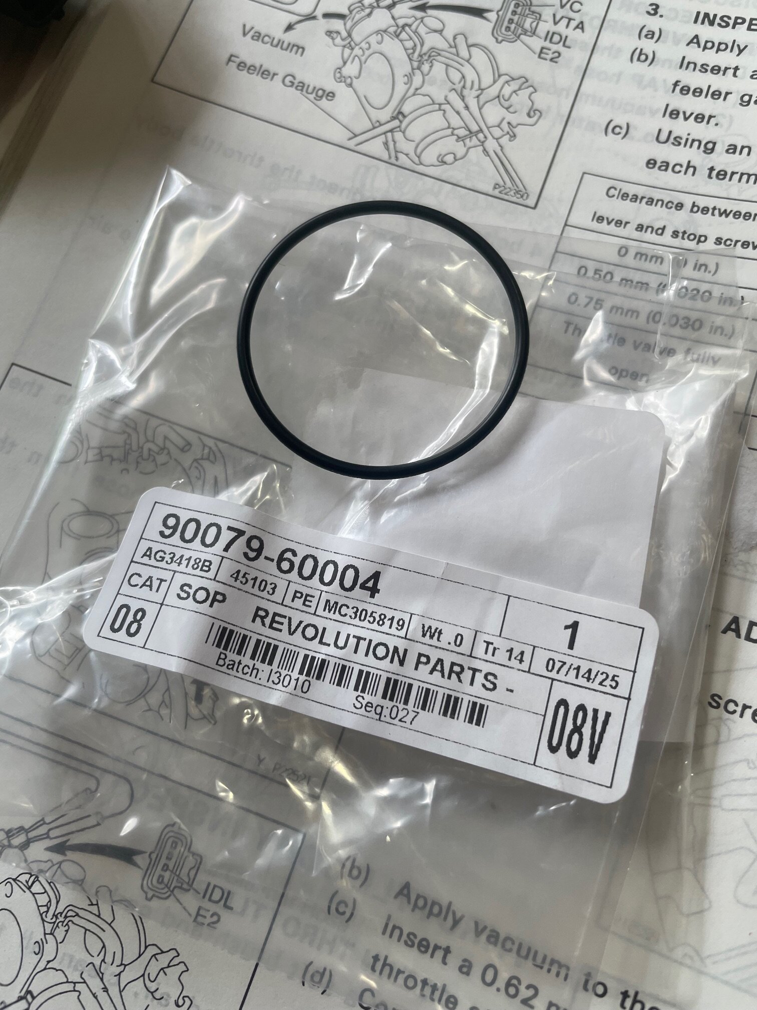

View attachment 3952584View attachment 3952583
