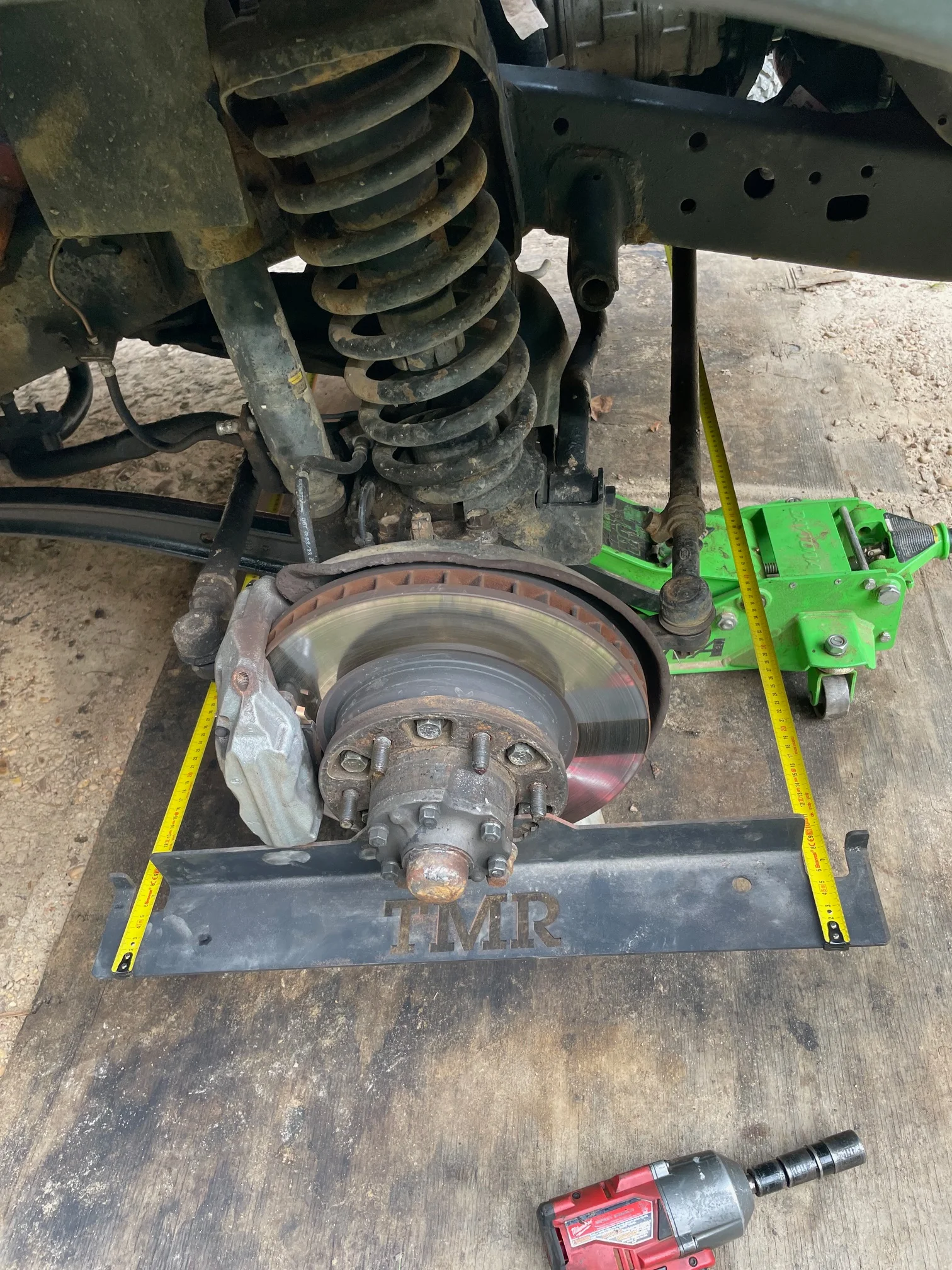

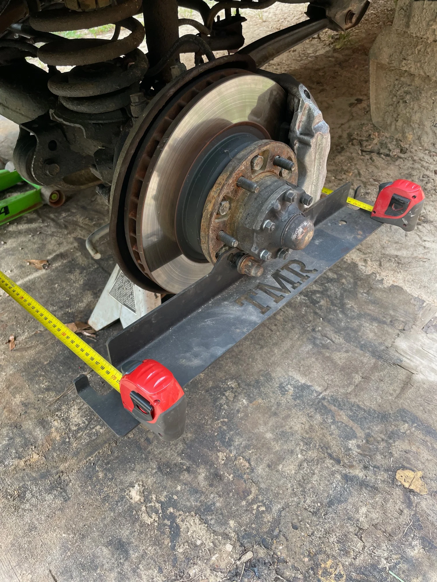

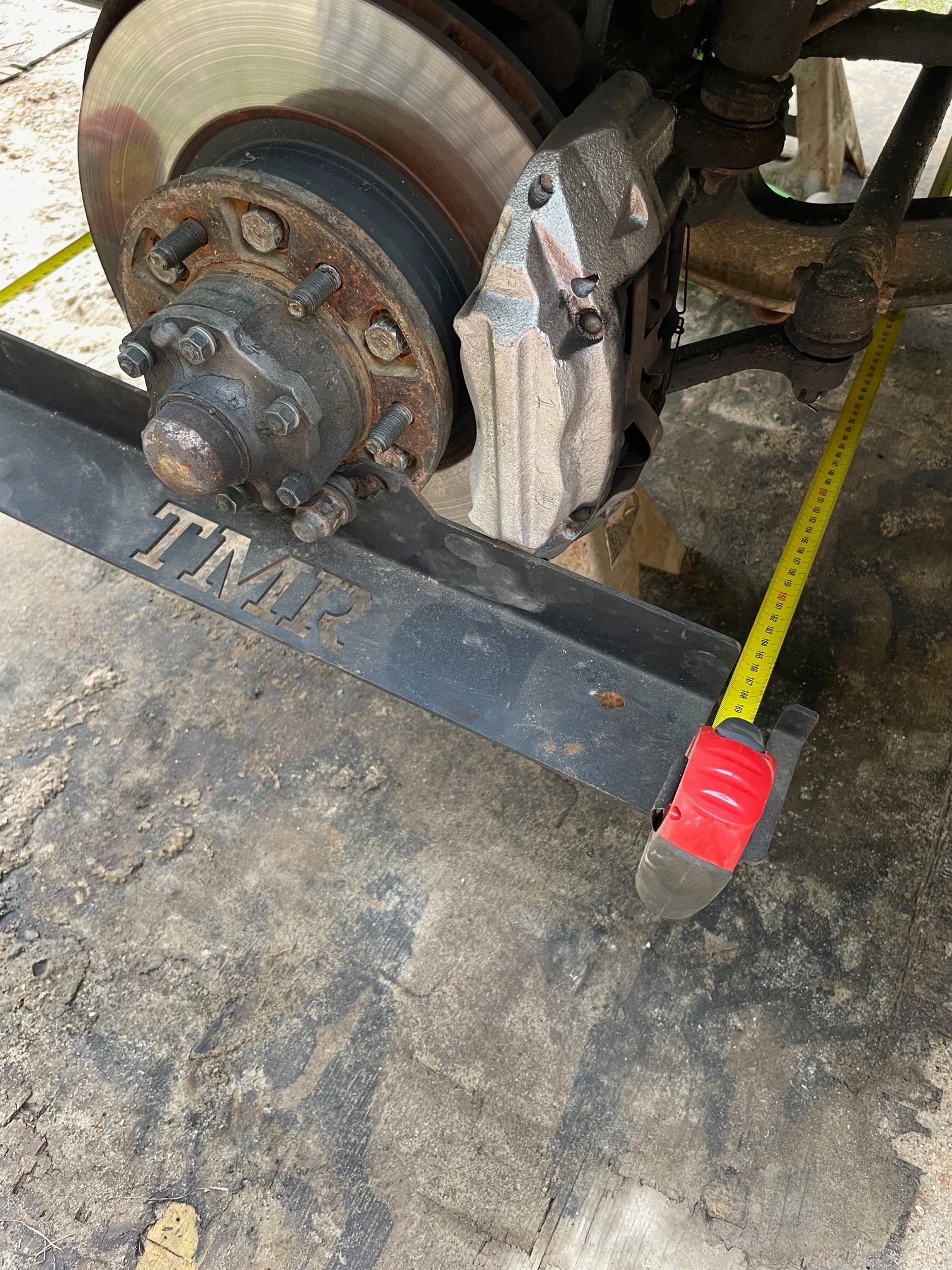

Finally checked the front end alignment, after purchasing new tires I decided that checking the alignment was a good idea. I'm using a set of the TMR alignment plates and a pair of metric tape measures. Front measurement was 1710 mm and rear 1713. Minor toe-in, close enough that I don't want to change it, plus I don't know how frozen the tie rod ends in the tube may be.

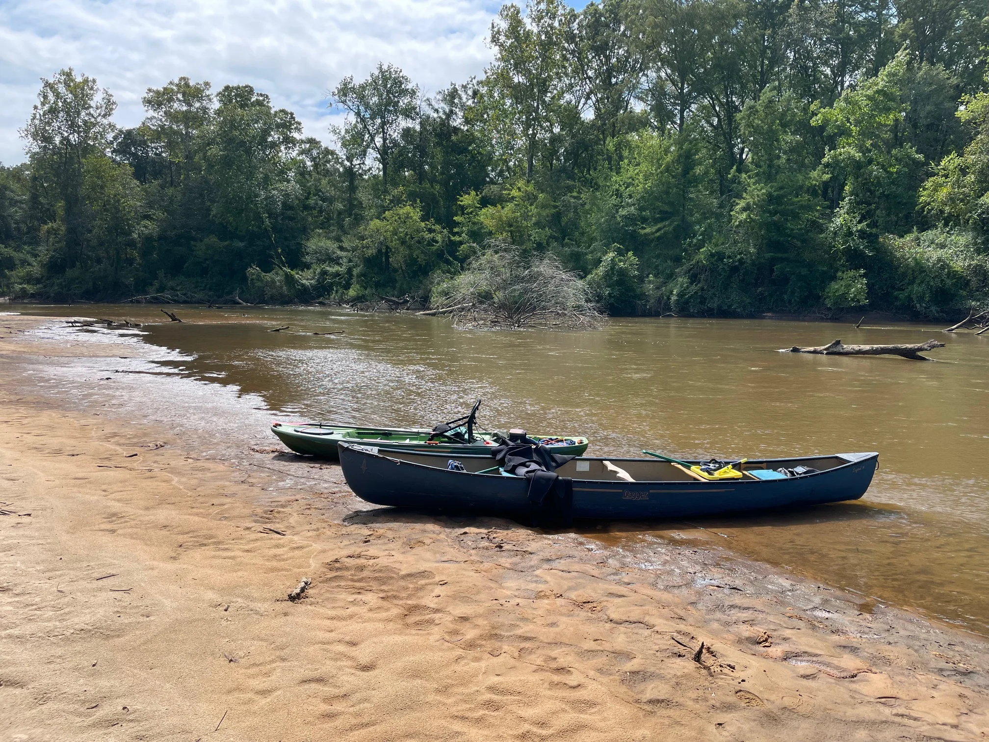

Field work this week was 8 miles on the Choctawhatchee River and 12 on the Pea River for turtle research. Water level was too low to launch and run a jon boat so we hit the river with a canoe and kayak. Pictured is the put-in on the Pea River at AL Hwy 87 with a 16' Dagger Legend loaded on the roof of the 80. The Yakima bars I run are wide enough to carry two boats if needed. Mileage was minimally affected but I also wasn't blasting down the interstate at 65-70, just running secondary and back roads (the best kind).

Metric tape measures!?
How'd you smuggle those through customs?
