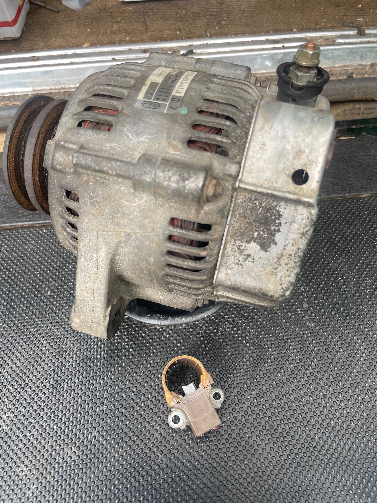

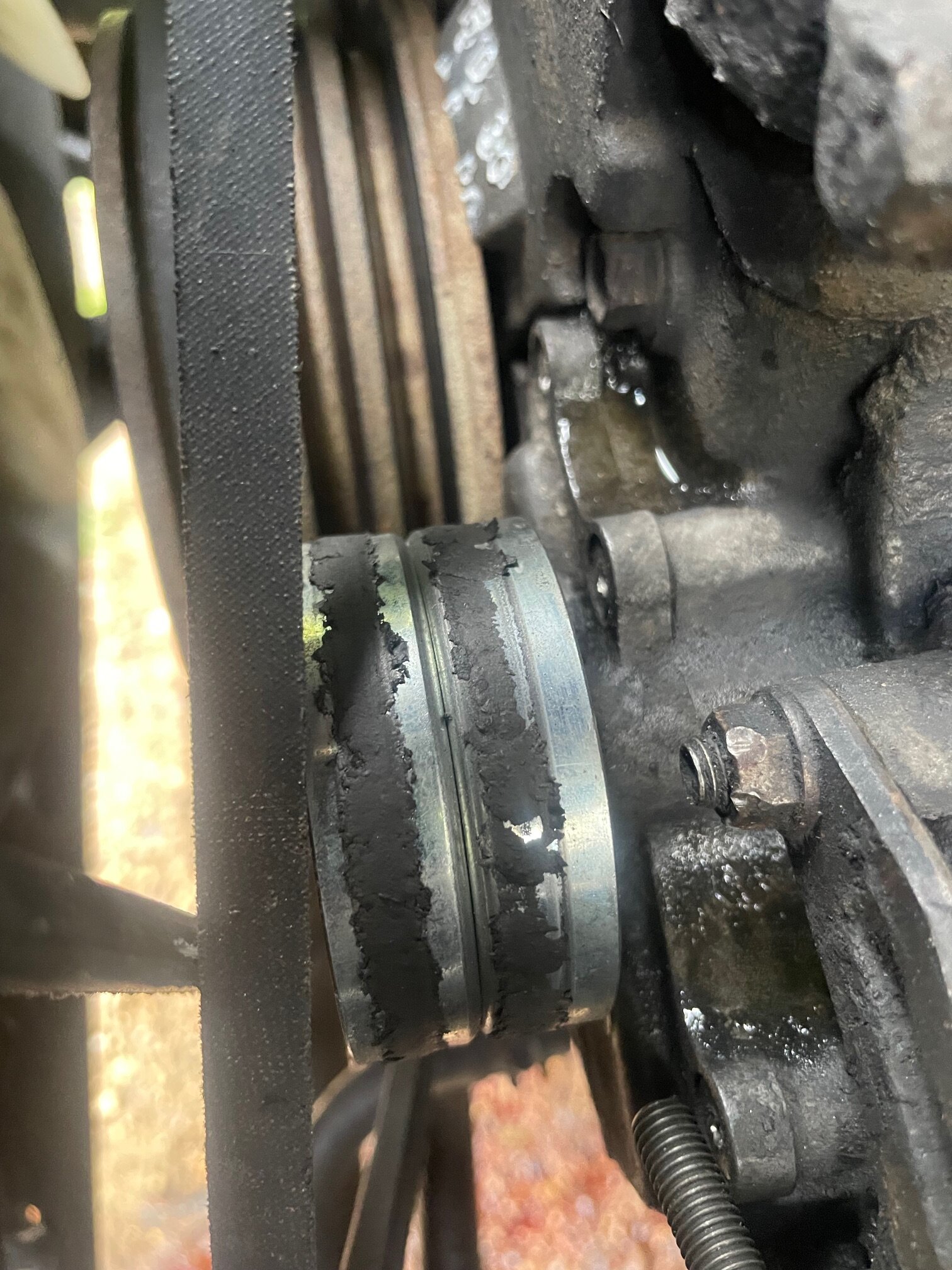

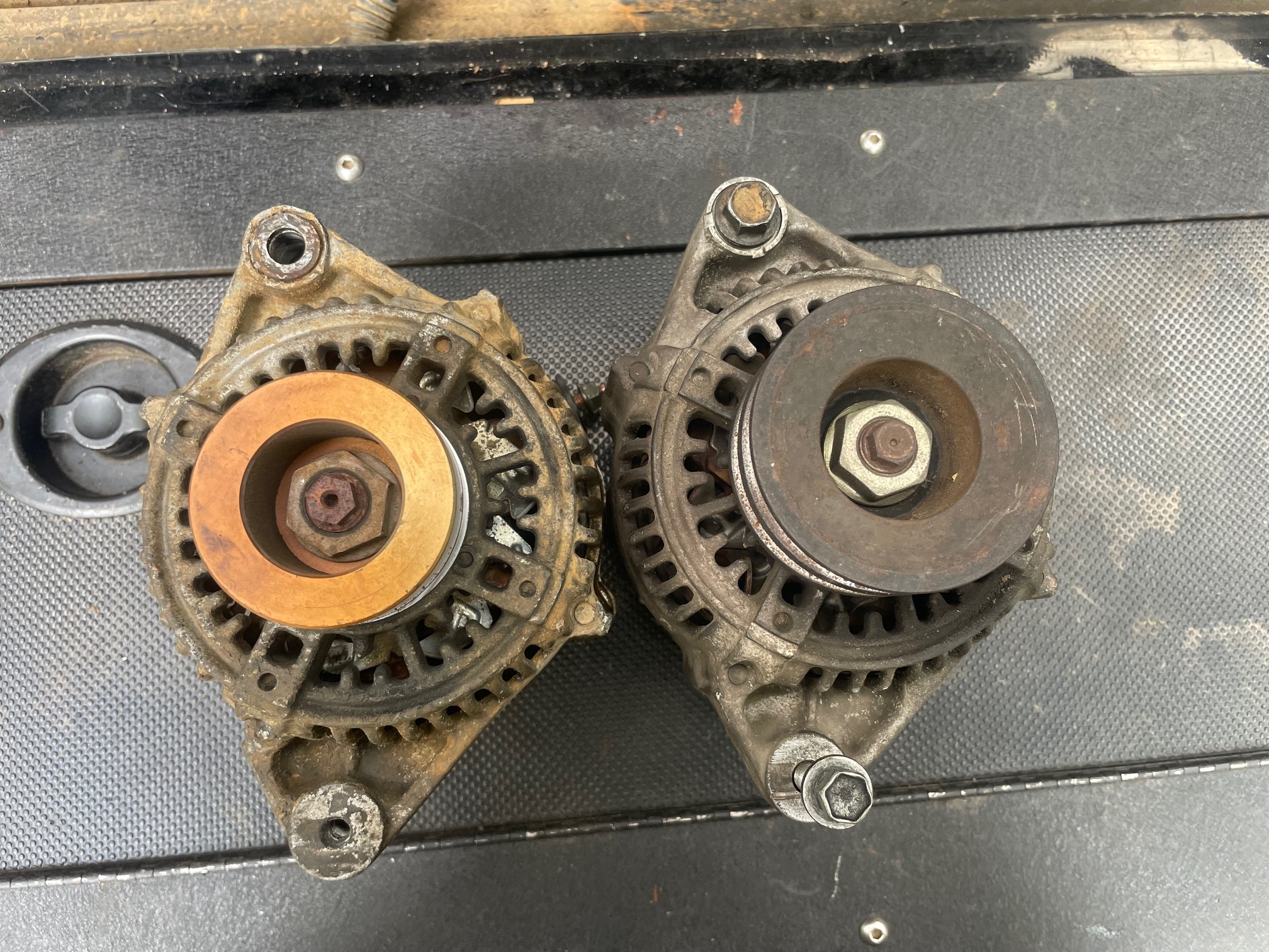

I decided to swap out the alternator since it was not charging. I had a spare and a new set of brushes. Installed the new brush set in the Denso alternator and began pulling the old one. One thing I noticed was rubber on the idler pulley. What's up with that??? Removed the old alternator and discovered it was seized. That would also explain the burning odor noticed on the few short runs of the 1FZ. After pulling the old alternator I compared them side by side and the old has an undersized pulley.

Someone swapped that alternator pulley to try to increase the output of the alternator (particularly at low speed) to make it turn faster.
There was someone here that used to sell those pulleys as a modification.
Someone may want to buy that pulley.
Yeah, on the smaller pulley. This fits with mass of electrical mods I've eviscerated from this 80. ARB compressor, dual battery setup, 12v inverter, uncounted USB ports, remnants of a sound system.
I'll remove the pulley and post in classifieds. I think if you have a stubby impact you could swap out pulleys without removing the alternator.

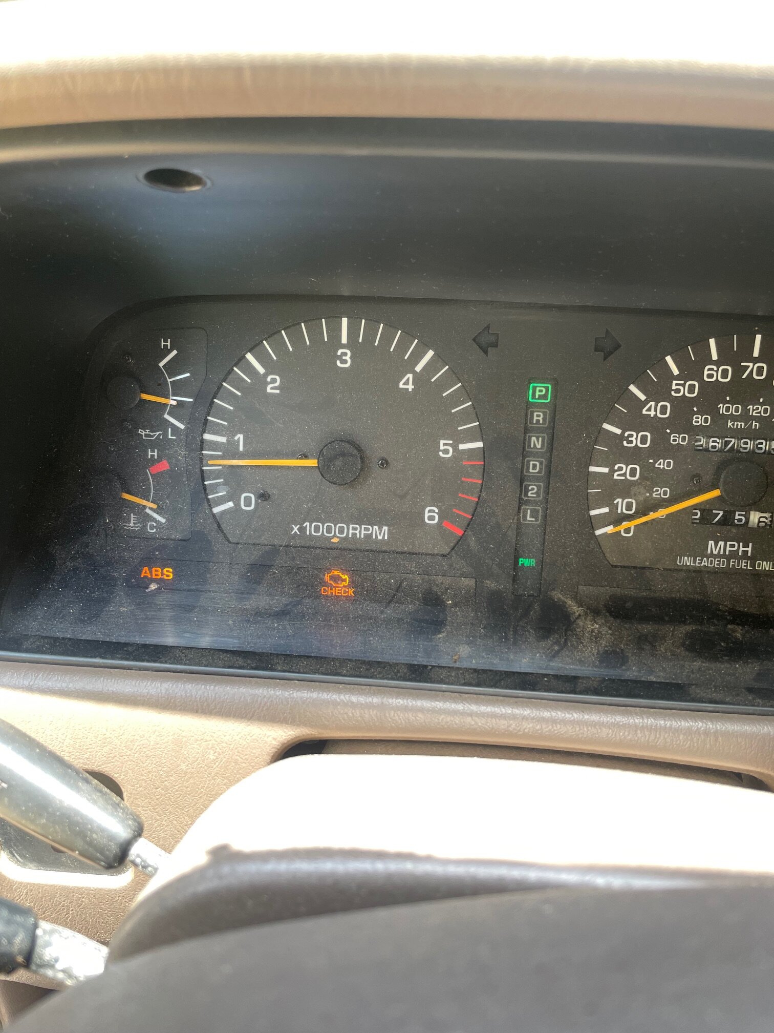

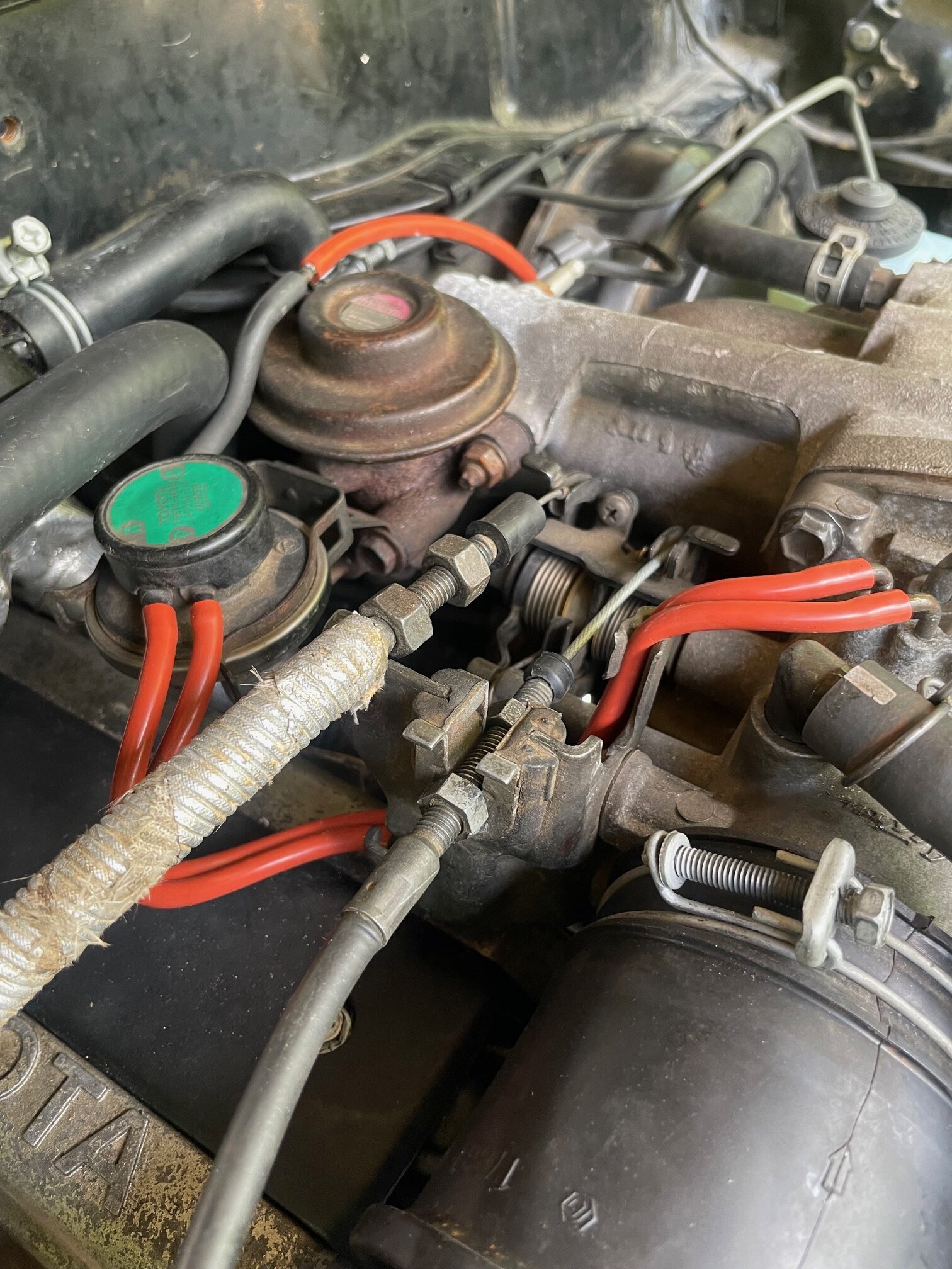

High idle issue resolved but not until swapping out throttle bodies several times. The root cause was an over adjusted throttle, I thought. Swapped out the other throttle body after having checked, and re-re-checked that the TPS and ISC were properly adjusted and functional. Installed the TB and the high idle remained. ?????? Swapped the other TB in, again with multiple sensor checks and careful TPS adjustment. This time I left the cables loose. Cranked up with proper idle. I then completed the hookup of the throttle cable. All good. Then the transmission kick down cable but excess tension on the cable would not allow full closure of the TB plate, nor could I gain enough slack in the cable to hook it completely up without that tension. For now I'm leaving it loose.
Codes are for both knock sensors. I'll deal with those this week.
Doing a search and saw a photo of the cables. I may have the kick down cable routed wrong.

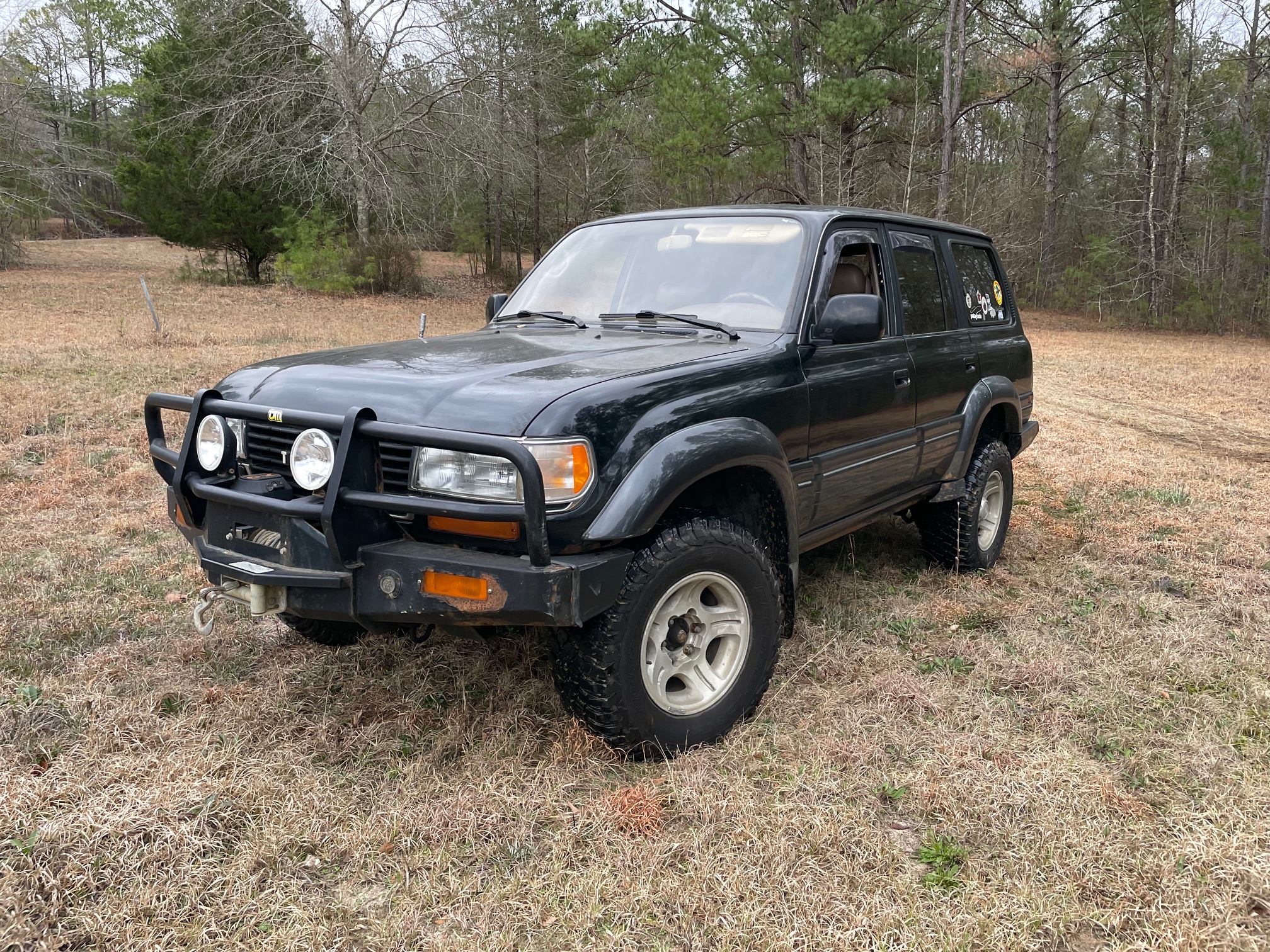

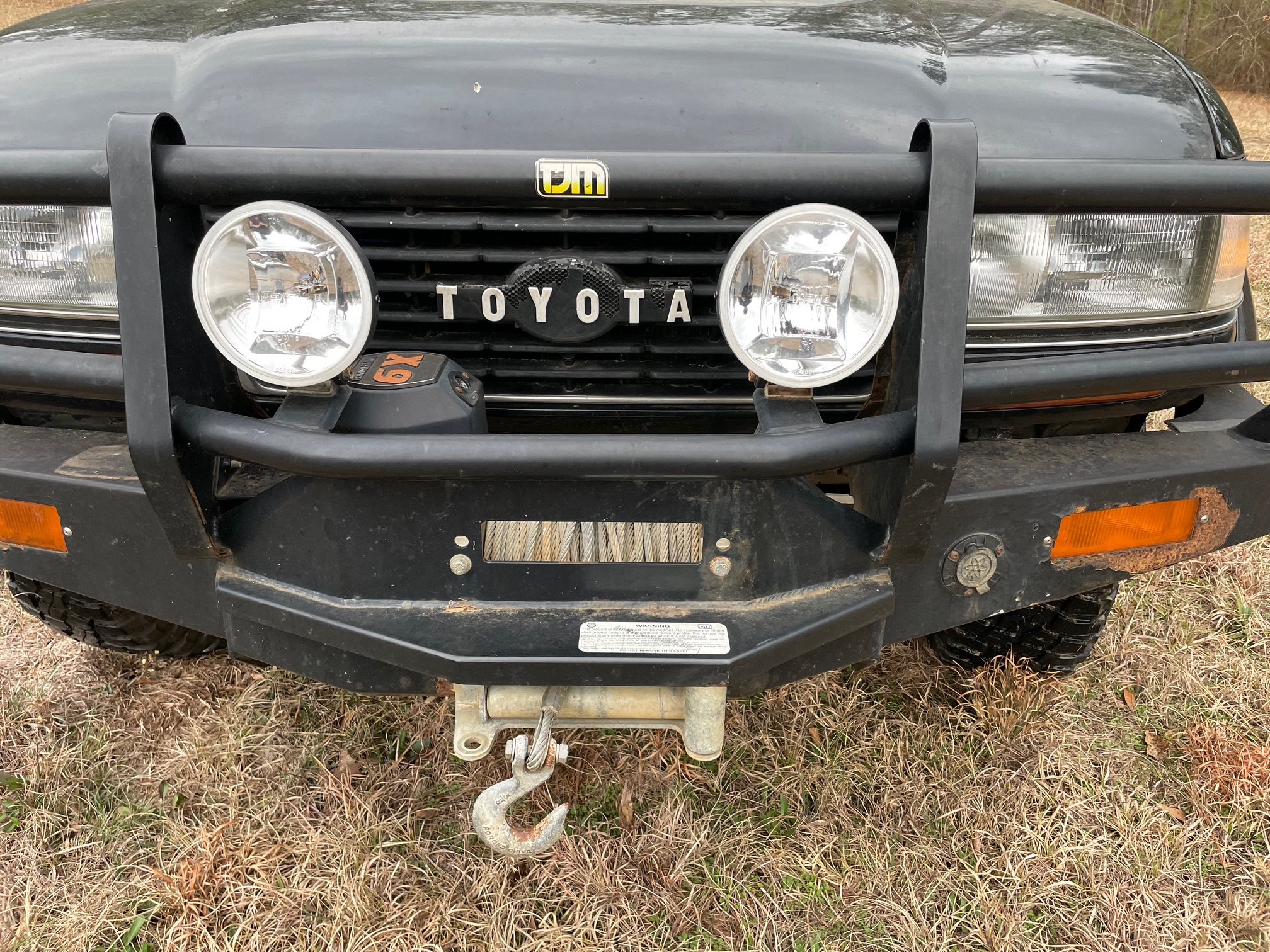

As the title states, does anyone recognize this 80 and have any history on it? 1997 Lexus 450 with TJM front bumper, Superwinch X9, IPF lights, Slee (?) rear bumper, Wagongear tailgate storage, pipe rail under rocker panels, dual batteries, ARB compressor in rear, metric butt load of USB ports, Iron Man lift.

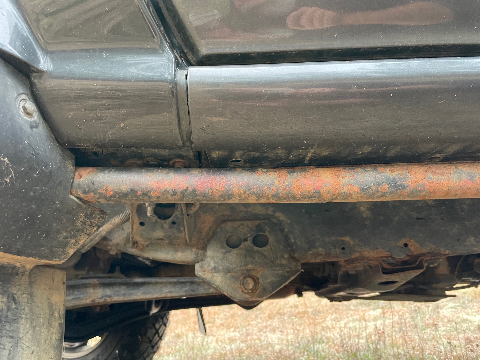

It has some quarter panel and front inner fender rust but nothing significant otherwise.

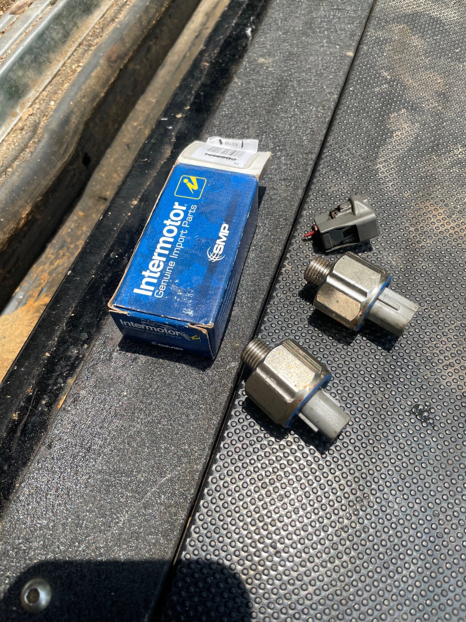

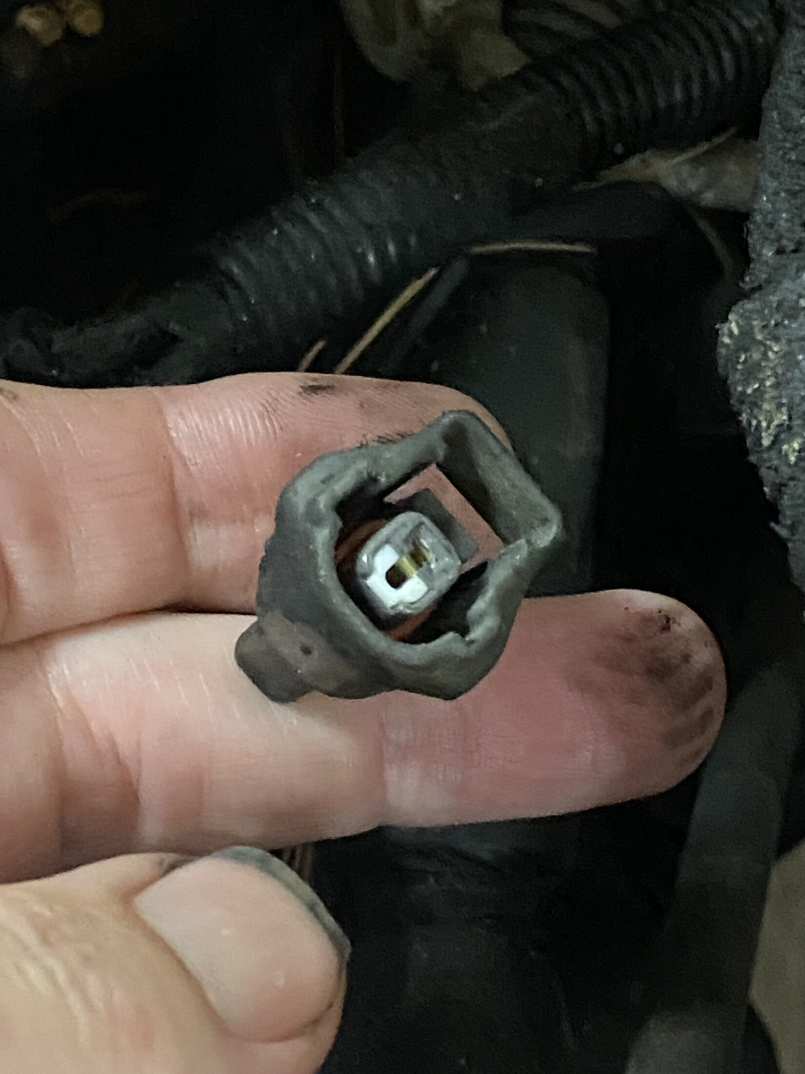

Dealing with knock sensors. The rear knock sensor was sporadically throwing a code, which then became consistent. After installing the intake manifold and going through throttle body purgatory the front sensor began throwing a code. I bought a pair of Intermotor knock senors from Rock Auto and installed today. The old ones have no identification marks or codes on them, must be really cheap ones (the ones in the photo). Front sensor code may or may not be due to bad sensor, it's definitely due to a broken wire. That'll be fun to fix.
Replacement connectors with pigtails are available from Ballenger Motorsports for a few bucks. Probably less than $10ea
That is a real bummer to read. I’m working in that area on a parts truck right now. Absolute pain in the rear.

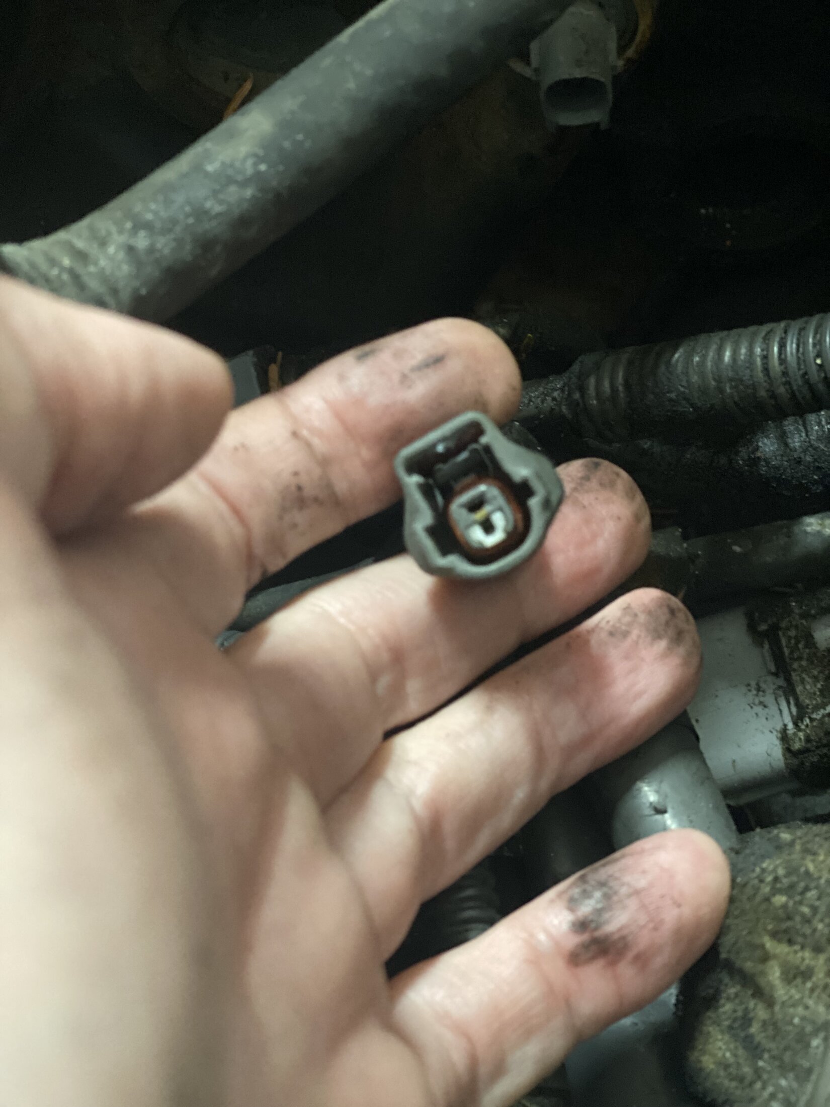

Front and rear knock sensor connectors.
The link that you posted looks like the correct connector to me.
I'll order a couple of plugs with pigtails from Ballenger.
Snapped pics of these two as well, just in case.
I haven’t been able to pull the sensor that is located on the DS front end of the engine yet.,, too covered in oil. Tomorrow. If you need pics of that connectors, just let me know.
