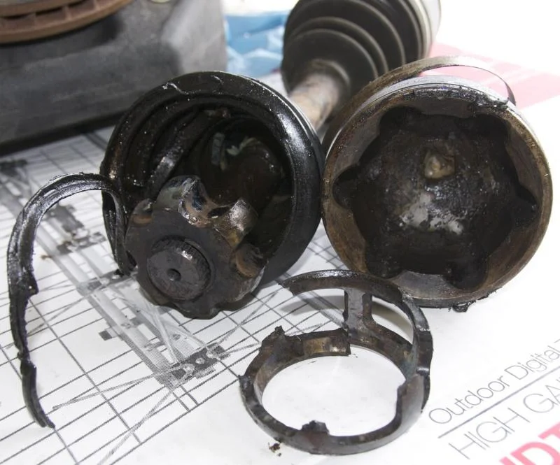

I had a CV grenade on me yesterday. It literally exploded with the balls, circlips and other metal ejected out over NV Hwy 359. Those spline-less hub flanges I've been carrying around finally paid off :rolleyes:
It effed up our weekend though; but special thanks to Locrwln for assisting in the repair!

We had just gotten off a relatively mundane trail...turned back at 10,000' due to snow. Apart of the turn around, made all the more interesting because we were on a narrow shelf trail and I had the KK in tow, I had to jack-knife and crank to the steering stop to get turned around. But fully knowing this puts a CV/birf at its weakest point, I just basically idled through it. But because of the nose down fully cranked position the upper control arm adjuster popped; first time for this but I've been with a 4R friend that had it happen so maybe not all that uncommon? So when we got back down to the main gravel road I immediately noticed it pulling to the right.
Got out and inspected it and noticed the DS outer band had come off and was puking. I've, like many, have run these things this way for a couple hundred or more miles so I didn't think too much about it. Down the gravel to the highway and after about 10-minutes at 55-60mph I felt the vibration and then saw the parts blowing across the opposite lane :rolleyes:
I was pissed I didn't have my spare CV...otherwise I'd be reporting this on Monday and would have spent the weekend with the homies camping and exploring.

The 'exploded' view ;)
The pics show a very dry and corroded CV?
When I rebooted mine everything was nice and shiny.
I understand the angle and forces when it broke but it looks like it may have been well worn or flogged with low grease and contamination before it broke.
attachment.php
Yeah...I can't really figure it out. It wasn't leaking before Friday afternoon on the trail (can't tell you how many hours I've spent under this truck the past couple months!) and it spewed a fair amount of lube when the boot tore/band let go (can't tell which came first). I had to drive it about 20-miles or so I'd guess on dirt then another 150-200 highway miles with it open...doesn't really make sense in any case.
And like you when I've rebooted them they've been nice and shiny...once I cleaned all the goopy lube out!
Yep strange, looks like the corrosion/contamination has been there for a while, how long ago did you reboot?
Rebooted 2-1/2 years and 45,000 miles ago.
Hey Dan,
Have a really good look at the tear marks on the cage, are any of them old, that is, can you see if some of the tear/crack was here some time ago before it let go this time?
