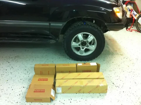

I'm anxiously waiting on a quote from Mr. Onur this moment. I decided to go OEM, It's gonna hurt but not as much as a blown NAPA/EMPI axel in the middle of nowhere with babies on board.
Anyone have the part number for the OEM toyota boot kit? (min is an LX, does it matter?)
Part # 04427-60120, should be the same for the LX. I ordered mine from Jacque at TRDParts4u for about $30. Still have not done the rebuild...:meh:

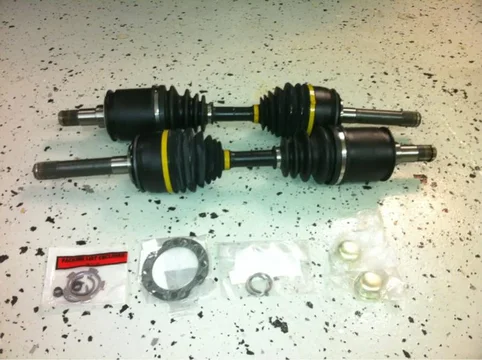

Tonight and tomorrow's fun project.
Jon, Make sure you have the seals that go in between the axles and the front diff. It takes some force to get those axles seated back in the diff and I think I might have damaged the seal I am talking about while shoving my passenger-side axle in. I think it is labeled a "must replace" part in the FSM for this job.
I'd also get some hose clamps. My new axles lasted about a month or two before the yellow bands started to loosen.
Thanks Paul.
Fortunately it's not my first parade with the CVs. I had to pull them twice while installing and reinstalling the center diff for the ARBs. The process is becoming routine for better or worse. The drivers side CV is in ok condition so it will be the new spare. I'm making sure I have a list of tools so I can do this on the trail next time.
I have a set of the McMaster's waiting. I'll be hawk eyeing them until they are needed. Got just about everything pulled tonight. Should be cake tomorrow to finish up.
