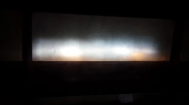

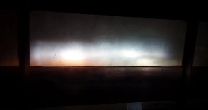

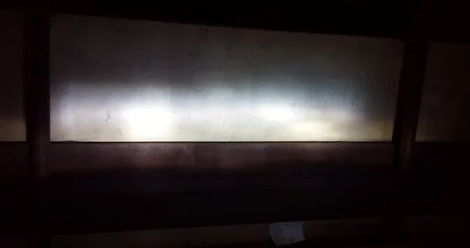

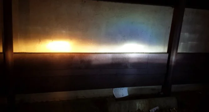

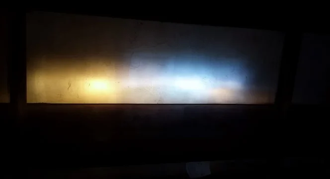

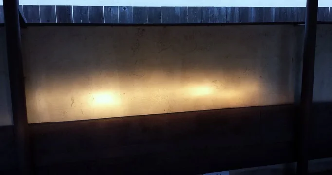

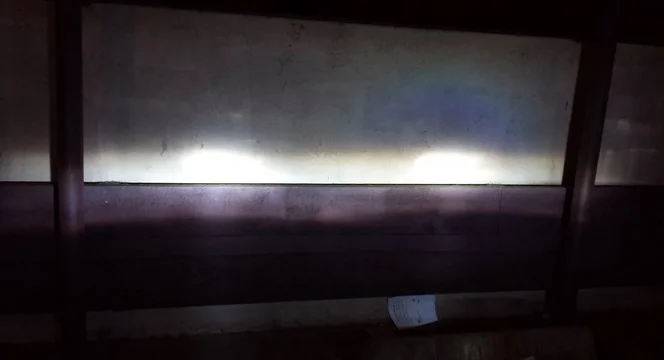

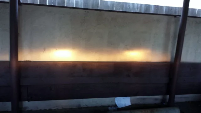

I bought HID high and low systems for the factory housings before reading on MUD all the posts saving that would blind oncoming traffic. I've had them for nearly 18 months, and had approaching traffic flash their lights at me zero times. It's possible that I am surrounded by tolerant drivers. It's also possible your lights can be adjusted such that it isn't an issue. I took pictures of the pattern on a wall (too close for adjusting the lights ...just catching the pattern).
20140929_181359 stock low.webp stock low 20140929_181417 stock high.webp stock high 20140929_191201 one HID high.webp one HID high
20140929_192320 two HID high.webp both HID high 20140929_193840 right HID low left stock.webp one low beam bulb HID and one stock low
20140929_193908 right both HID left HID high low stock.webp Stock low left, and the rest HID
20140929_195109 both low HID.webp Low HID
20140929_195143 both high and low all HID.webp Four HID
You can see plenty of wash outside the ideal pattern on both the HID and stock bulbs. It is brighter and much whiter with the HID. I have stood in front of my truck, and faced the lights. They are brighter than I'd like to have approaching me. When I crouch down to the height of a very low car's driver, they are annoyingly bright. On the other hand, OEM HID lights in new BMWs (etc.) are also annoyingly bright.
