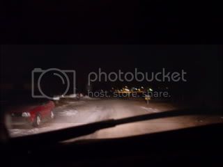

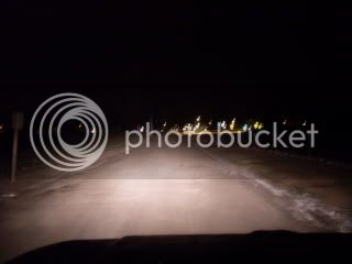

Bad picture. But you get the idea of the AutoPal lights. They have significantly more range than the stock headlights. They look a bit yellow in the pictures because a)my camera was making it look yellow, and b) they are the cheap h4 bulbs from ebay. I'll probably upgrade the lights on of these days. They are brighter and more crisp than the volvo DD you see in the photo.
Old pic:
and pictures of the headlights in the new truck

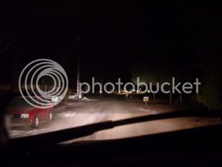

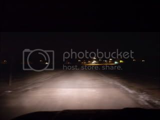

i think if your lights are not either stock style replacements or HELLA H4's they are cheesey. and not the good cheesy like cheeseburgers.
i run the HELLA H4's.
Its hard to tell in these pics, but the light beam looks like its cut out. there is no blarrff light all over not doing anything. it looks crisp and clean cut.
they have the road legal bulb. i think its 45/55W
now in these shots i leave on my lows when i turn on my highs. i have them wired to run independently of any other circuit.
this is lows
here is the low and high. that second mailbox on the right is about 65 yards away.
