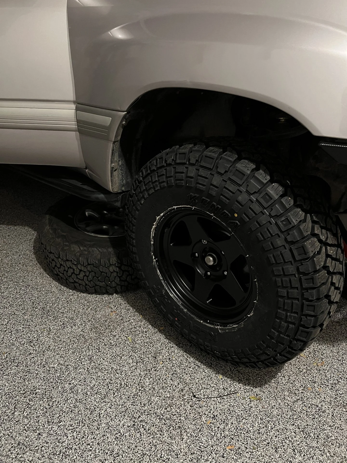

You'll need to trim the pinch weld inside the fender at the minimum. I trimmed the actual sheet metal to cleanly clear my 35x12.5s.
Lots of (long) threads about fitting 35s on these.
Thanks for the response. Are you on AHC still? I did the trimming and cutting on the GX to fit them so I'm not too worried about that. Im more so wondering if id have to full on remove AHC because I really like it and wouldn't be worth the trade off for me.
You can definitely keep the AHC in place. A sensor lift like you mentioned would work just fine. Depending on how high you want it be in your new normal mode, you may consider some springs for the rear and tweaking your torsion bars a bit. I'm no longer on AHC so I'm not an expert, but there's also a ton of info here about keeping the system up to snuff.

@bernz Wheel offset also plays a pretty significant factor in the equation
What were you planing on running?
Good point, I did read about higher positive offsets being ideal.
I’m not really set on which wheels. Biggest factor for me is to keep weight down. It seems like 26-27LBS is the lightest I can find in a 17 inch. I think the Fuel Hype 17x8.5 is a +10mm offset.
I’m willing to choose a wheel with higher offset if it will make all the difference.
