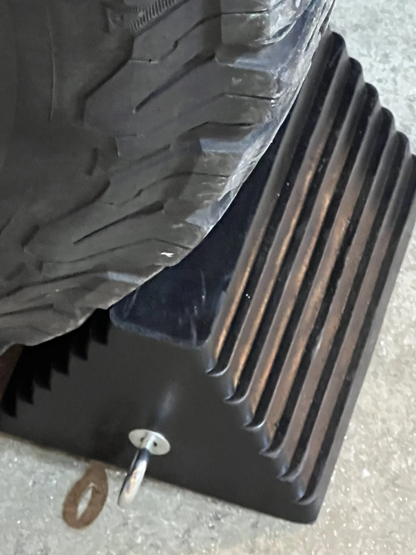

Thank you. Wheels are chocked.
no worries, it may be obvious but sometimes you dont remember till the truck starts rolling away. had that happen when i pulled a rear driveshaft and didnt have the truck in 4wd
One thing Harbor Freight can't get too wrong. :)
I have four of them. One behind each of the rear wheels and one in front of each of the front wheels.
It is a very good reminder! I could see being in a rush and forgetting.
