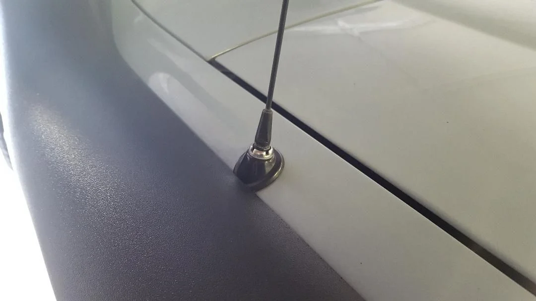

I used a fixed Tacoma whip antenna on my 80 for a while, but the fit/finish wasn't 100%. The mount leaned in toward the center of the vehicle and never looked right to me. I now have a manual telescopic antenna from a non-US model 80. It's OEM Toyota, and made for an 80. Fit is perfect. I never even pull it up.

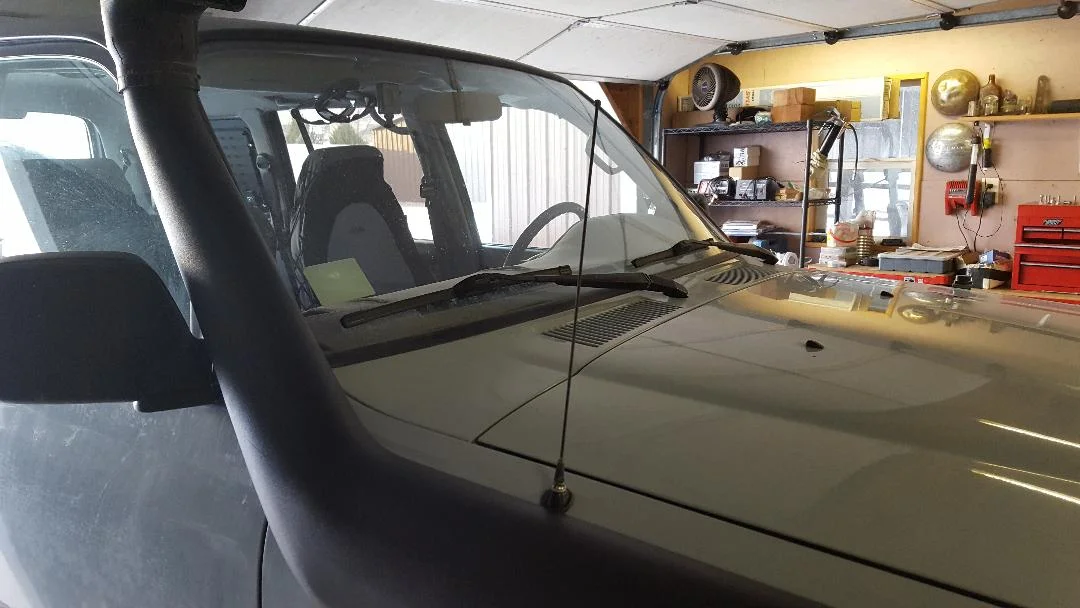

Here is the OEM Tacoma (1st gen) antenna base and trim with an ebay stubby mast. The OEM mast got better reception, but the longer mast accentuated the lean. It really didn't look bad when installed, and nobody noticed the lean of the antenna unless I pointed it out. I'm just stupid picky. I do still have the black OEM mast for this antenna too.
The pic angle is weird here - it makes the lean look worse than it really was.
This is the only pic I have of the OEM manual retract/telescope antenna installed. Obviously it's retracted here. It never moves from this position.
That's not bad... but I can't stand a leaning antenna, and with three others on my rig it would seriously amplify the lean of one

I understand, which is why I went with this one:
