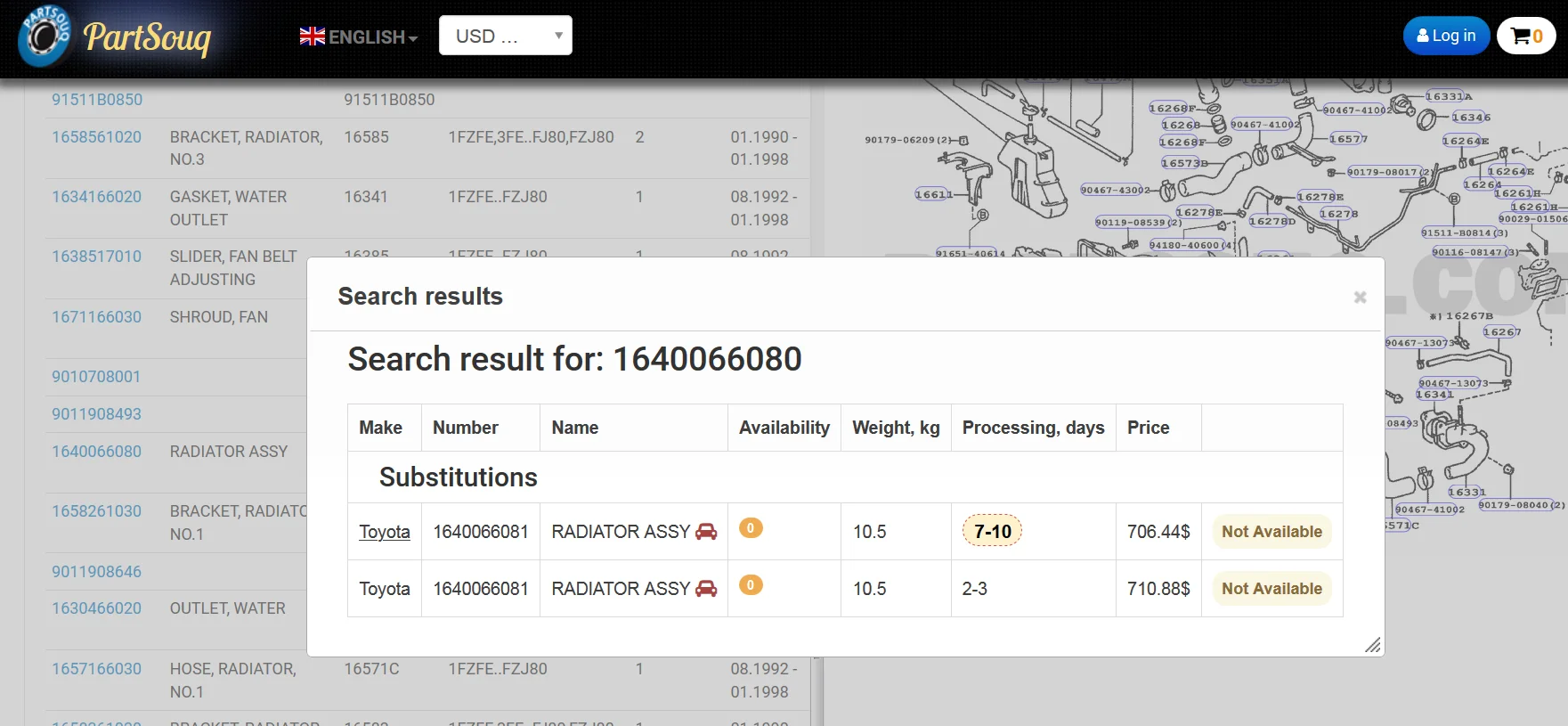

None of these inventories are "live". They only show what they can get from their depot and what is still alive in the Toyota system (even that is suspect most of the time) and what they are willing to sell and ship.
These parts are not in stock at these dealers. Currently 0 dealers have the -66081 or the -66040 in stock. They would all need to be ordered.
That’s not live inventory.
It’s readily available.
They are merely not allowing it to be sold.

Thanks, Onur. I assumed the parts would ship from a depot, as very few dealers keep much on their own shelves. But, it's disappointing to know the inventories are not up to date.
Parts will never ship from a depot. They always go to the selling dealer first. There is no dropship program within Toyota parts procurement at the service part level.
