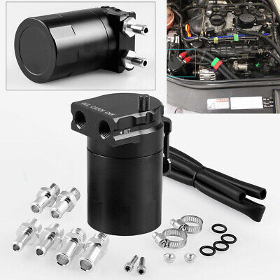

I picked it up on eBay, it is one of the cheap off-brand ones, but it is solid aluminum construction and the machine work is pretty good.
Interested to hear how well that works.
Same. I have yet to install it, but will report back when I do. My only concern is that in cold weather it might freeze up; during a cold snap this winter (-20ºF) the straight hose I had on there froze solid and the crankcase pressure forced oil out all over the place. I'm going to try and mount it somewhere it will get some heat from the engine.
An old airplane trick, cut a slit maybe a inch long on the top side of the hose near where it is attached to the valve cover. Then if it freezes downstream the pressure will exit at the slit.
That's a fantastic idea, I'll have to implement that when I install the catch can.
