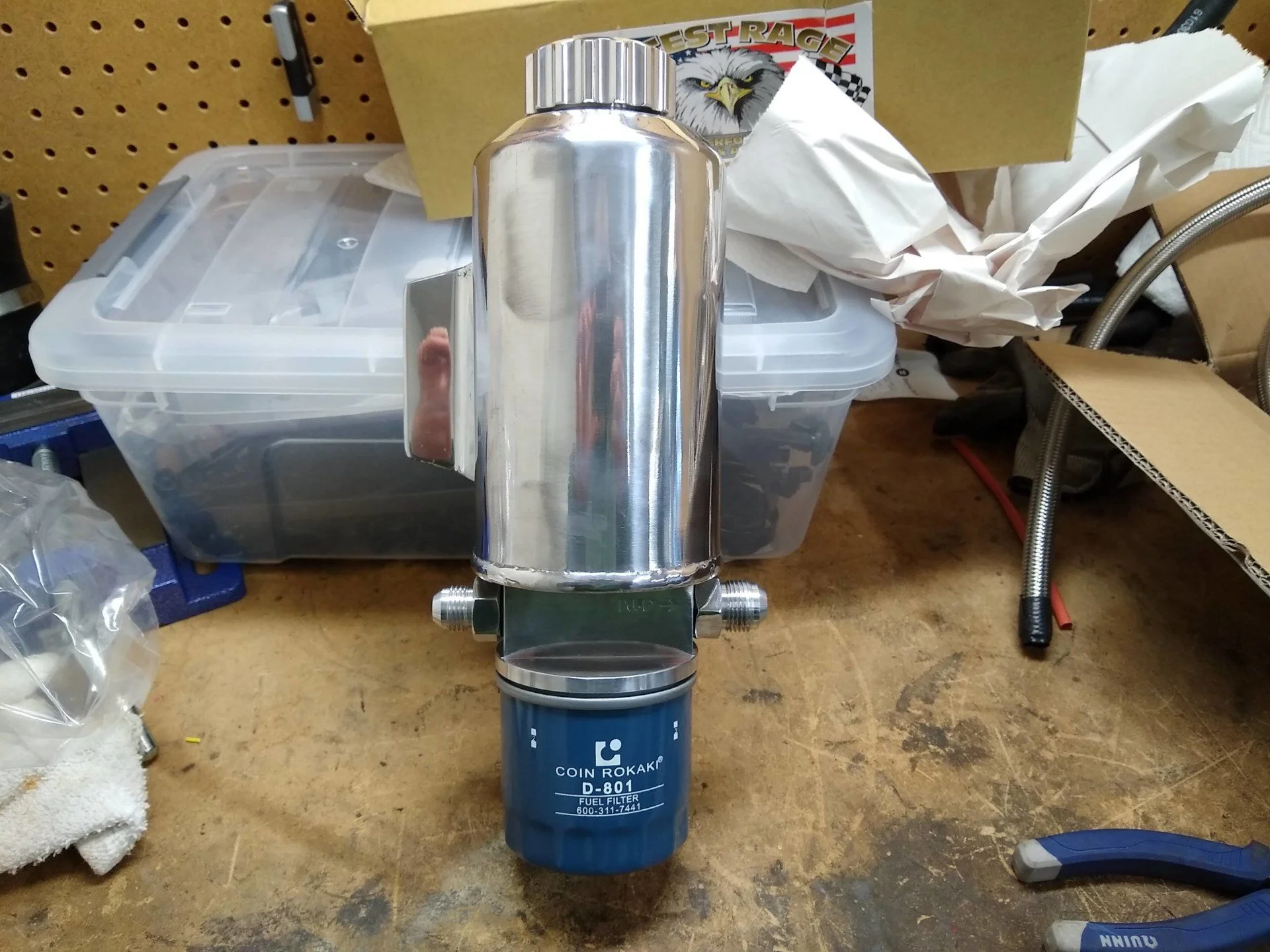

I do need to tap the masses for info on coolant hoses and engine oil coolers.
I am not a fan of the corrugated universal coolant hoses, and have seen where others have found bends that work and spliced them together. Open to all suggestions though.
I am looking at a few stacked plate engine oil coolers, and will be using -10AN fittings with -10 stainless braided PTFE line for supply and return. There is limited space on the machine right side of the cooling package up front, and I would like to mount it there to make use of the fan drawing air. I am less concerned with losing a degree of AC performance than I am with keeping the 6.0 cool in the Arizona heat.

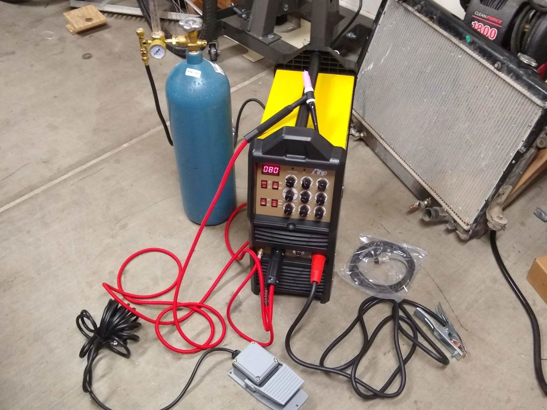

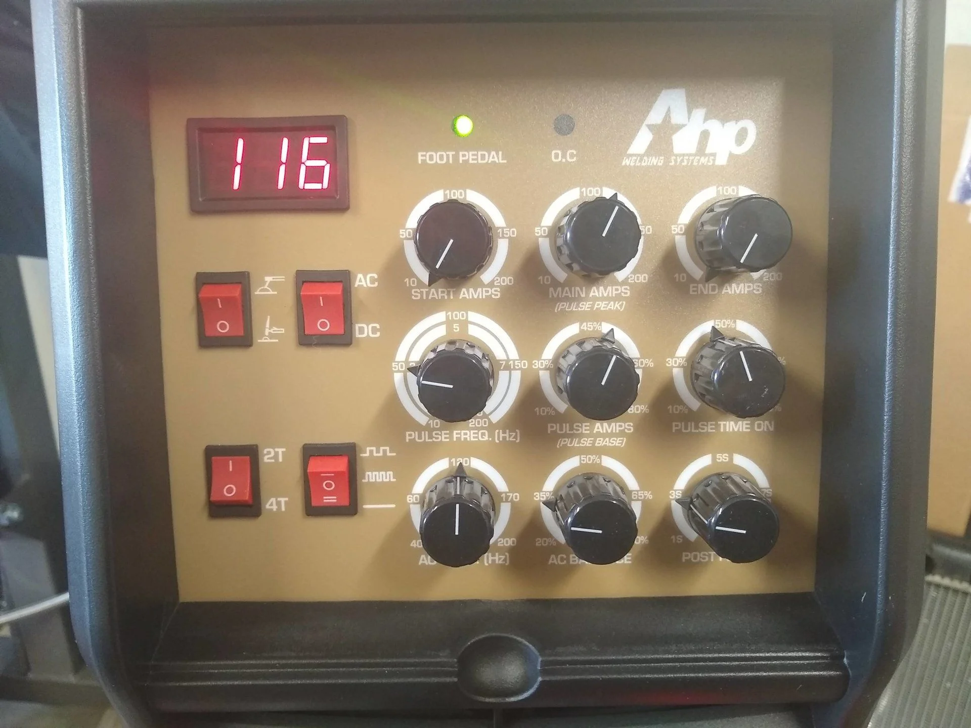

When I last reported, I was working on the radiator shroud, and decided a TIG welder was in the cards for me. I call it a birthday present, and after a few weeks of research, I landed on the AHP AlphaTig 201. It is not a high end welder like Blue or Red, but it was no where near the cost of Blue or Red with a great value package. I haven't TIG'd aluminum in about 8 years and it shows. I'll need more practice before laying an arc to finish my shroud.

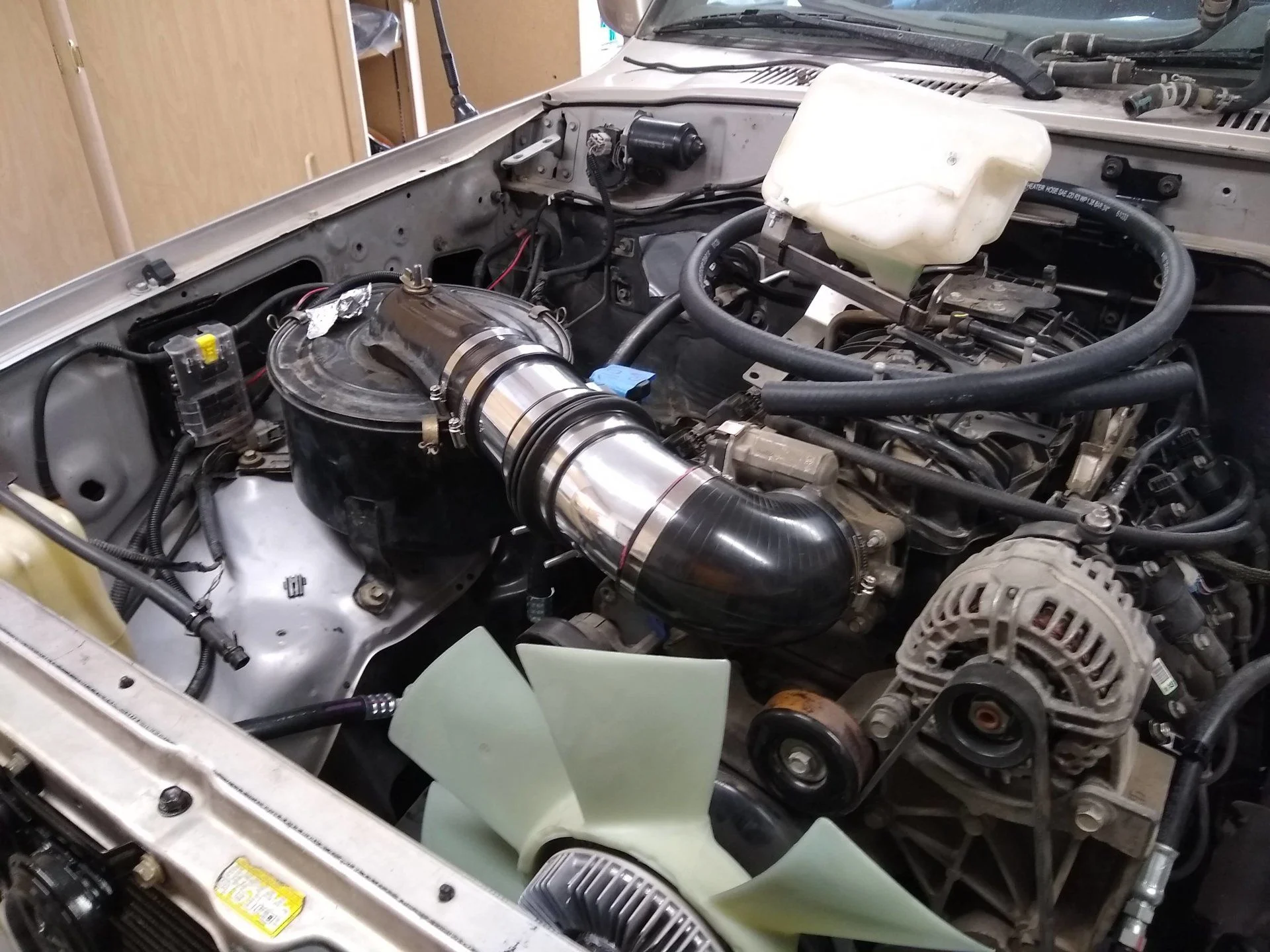

A couple more items checked off the list, I go the intake installed. It is all Spectre Performance items. They have an Amazon store, so I went to their website, got the part numbers and then got then all on Prime shipping.
The next item on the list is to fab the brackets to mount the engine oil cooler. I obsessed over the cooler for about 2 weeks. Do I run one, do I not? If so, how big? Blah blah blah. In the end, I figured too much was better than too little. I want this rig to stay cool in the Arizona heat, so if it cools too much, I can add a thremostat manifold in place of the open one I am using now. I also researched the debate of tube and fin versus stacked plate. Stacked plate won out despite the higher cost. There is a HUGE range of prices on coolers with near $1000 prices possible. I got this one off Amazon and I am really impressed with the quality. It is a 25 row stacked plate design and I am anticipating 1.5 quarts of additional oil to be needed to keep the whole system full and the oil pan level on target. Not yet sure how I will check the oil level as some will drain back when the engine is off. I'll figure it out in time. Until then, I'll work on nesting it in on the right side of the cooling package.

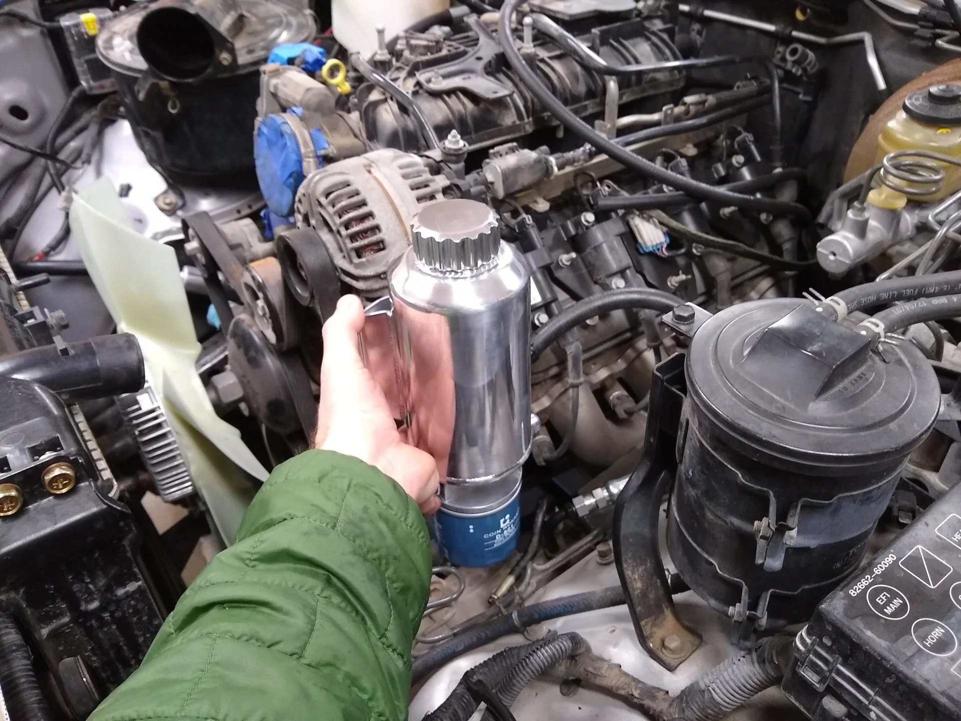

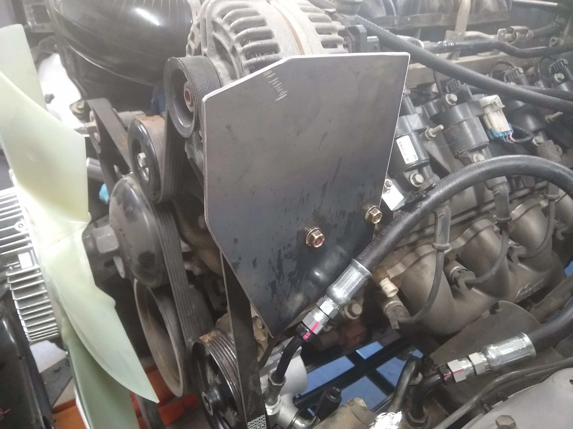

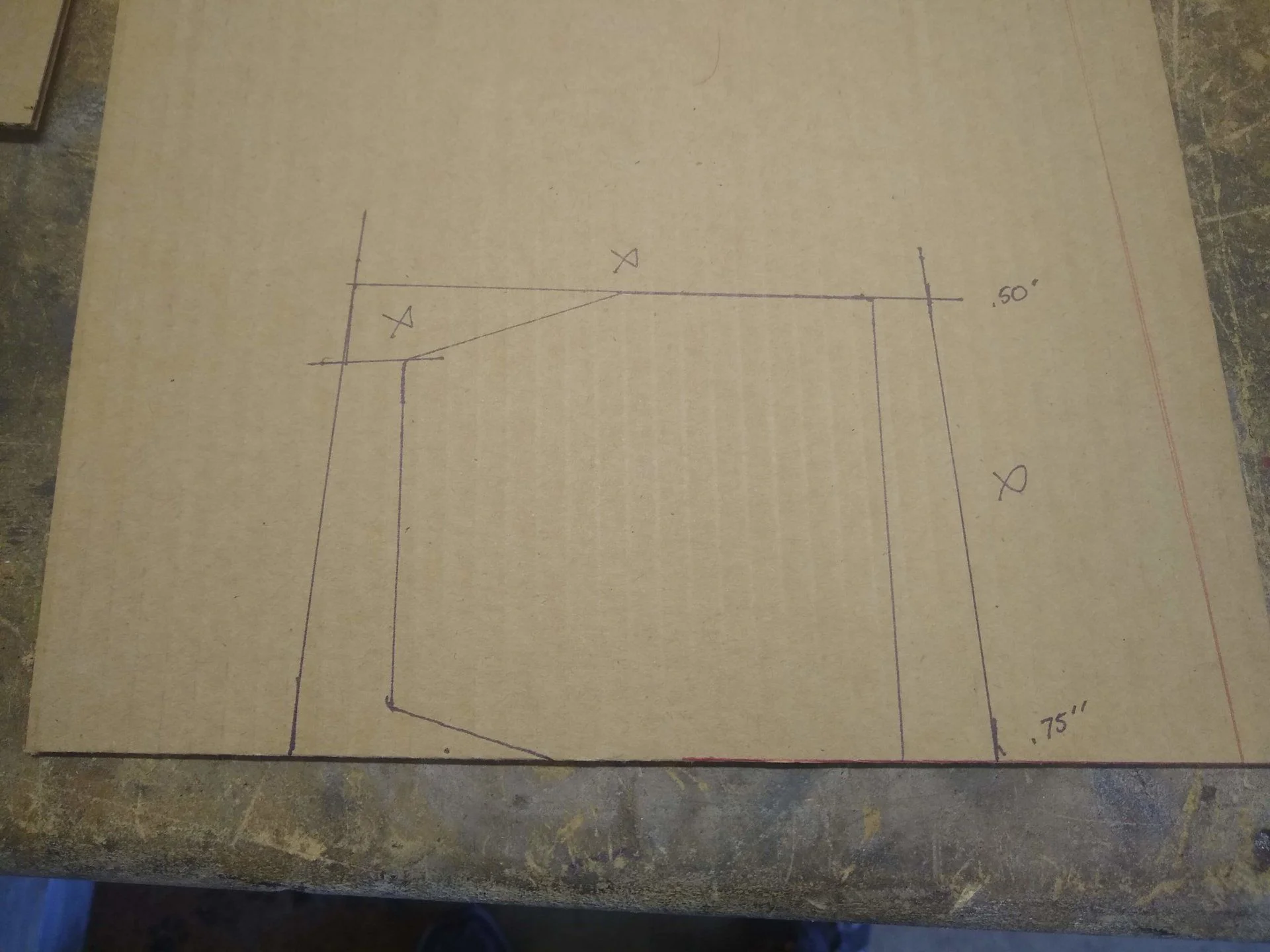

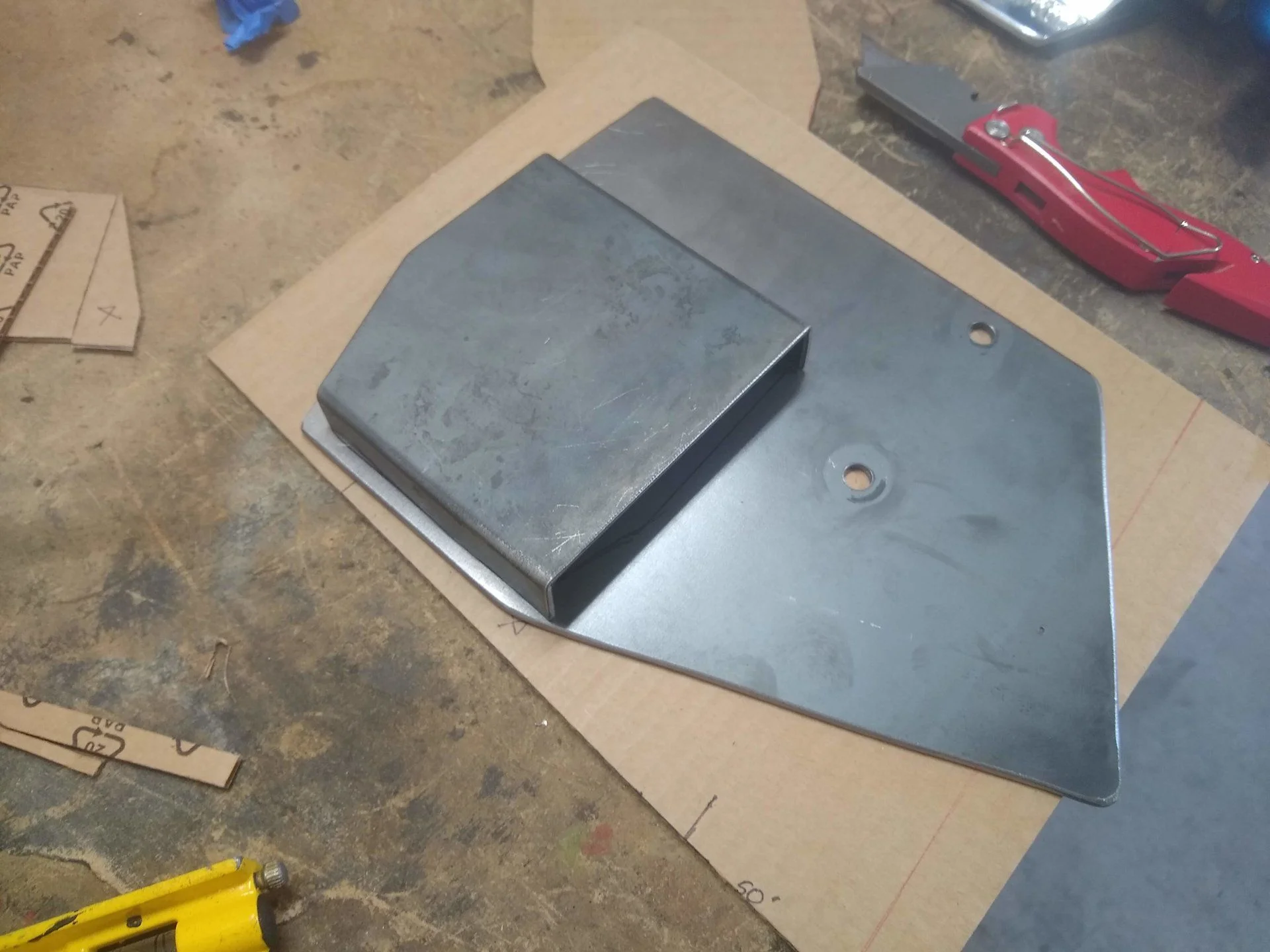

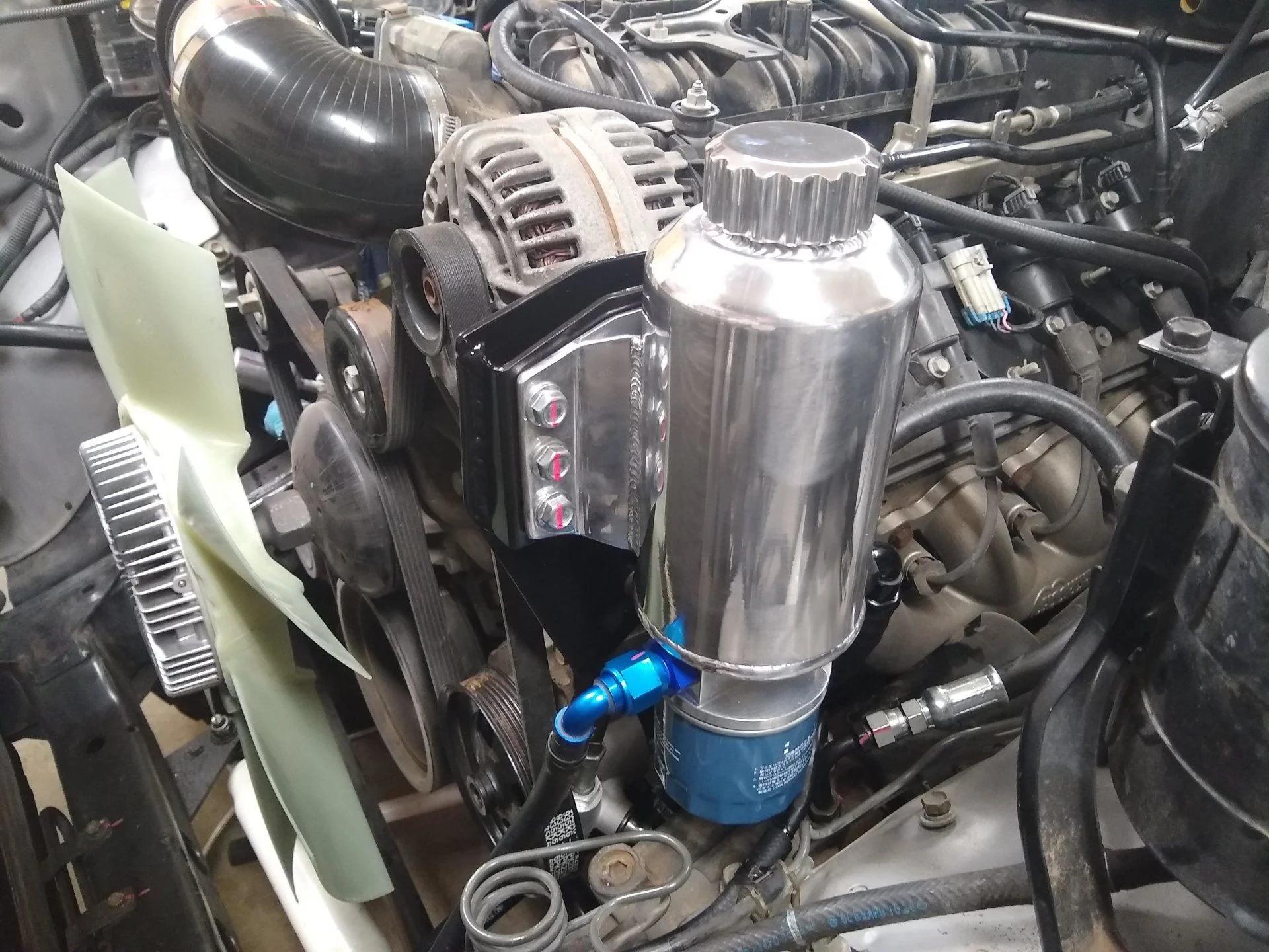

Long weekend and a bit more progress. I keep thinking of this in terms of eating an elephant. Solve one problem at a time and then another, and another. Eventually, you run out of problems. I still have problems, but two less than before. I was able to get the PS reservoir mounted and plumbed. Work started with a CAD template. I sketched out the shape and kept whittling it down until it fit the space and left a little real estate for some future items if needed. I transferred that to some 3mm plate and cut it out. A little deburring, and it was ready for the bolt pattern to be transferred and drilled.

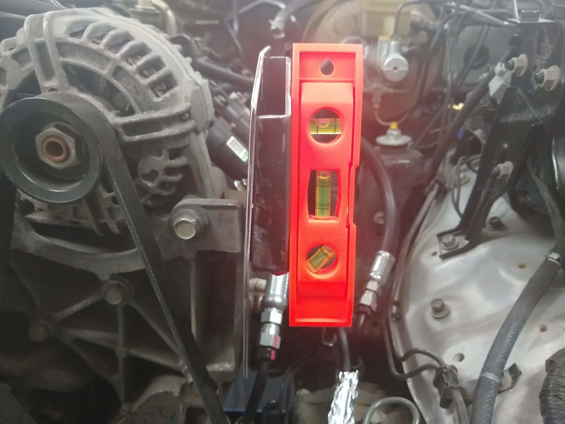

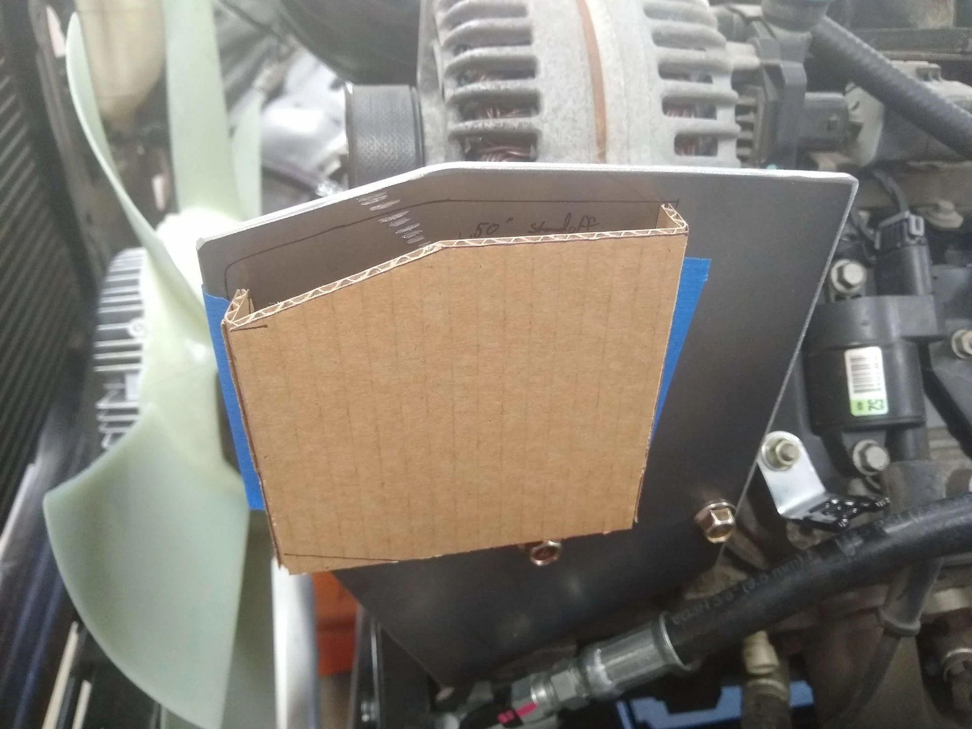

I mounted the bracket base and began another CAD template to make up the distance and angle needed to mount the reservoir plumb and on a plane to clear the tubes below. This was a bit tricky to hold the reservoir in place and take all the measurements, but I folded some shop rags to send it on to get it to the right position to find the angle and mark the template.

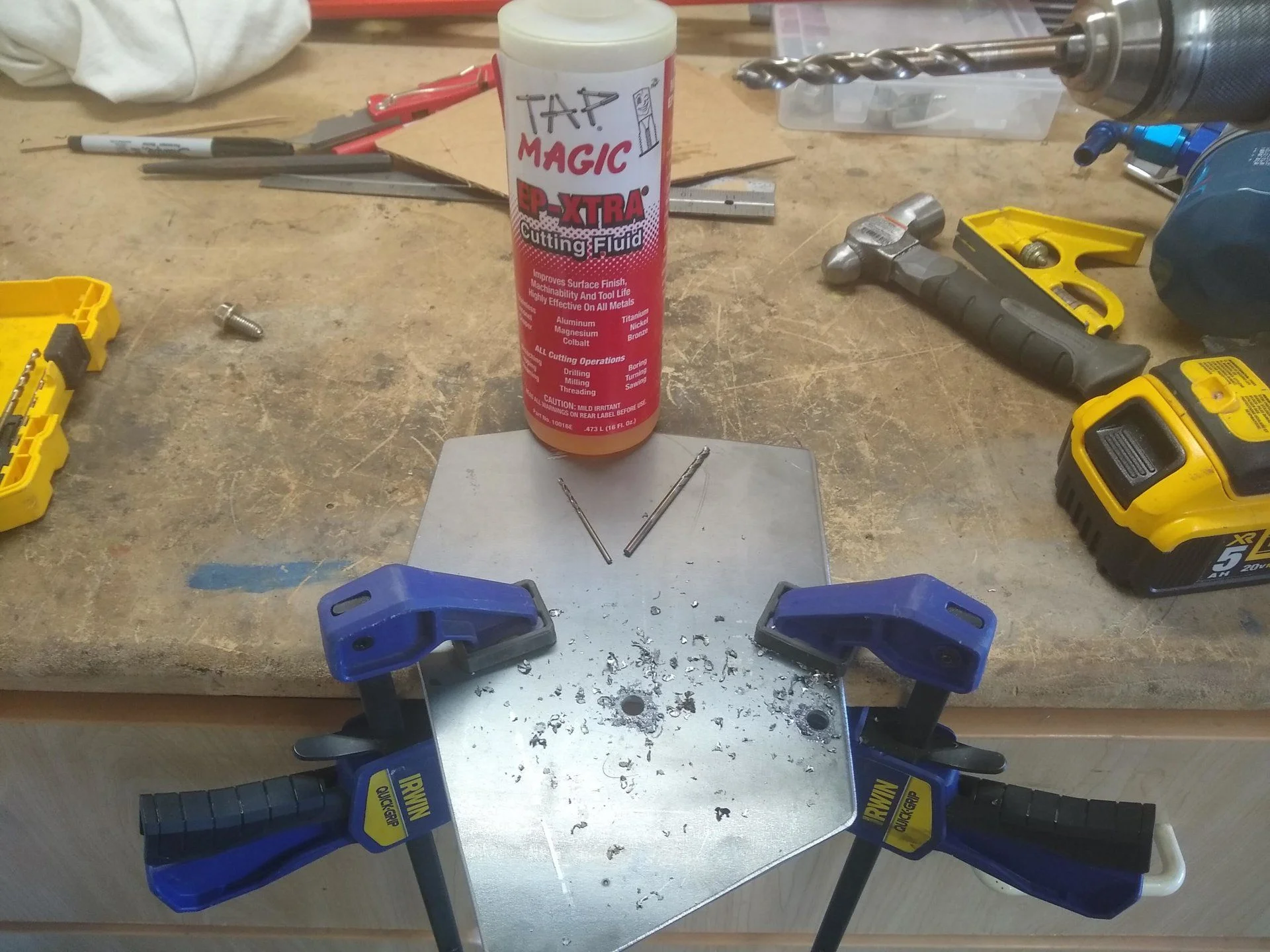

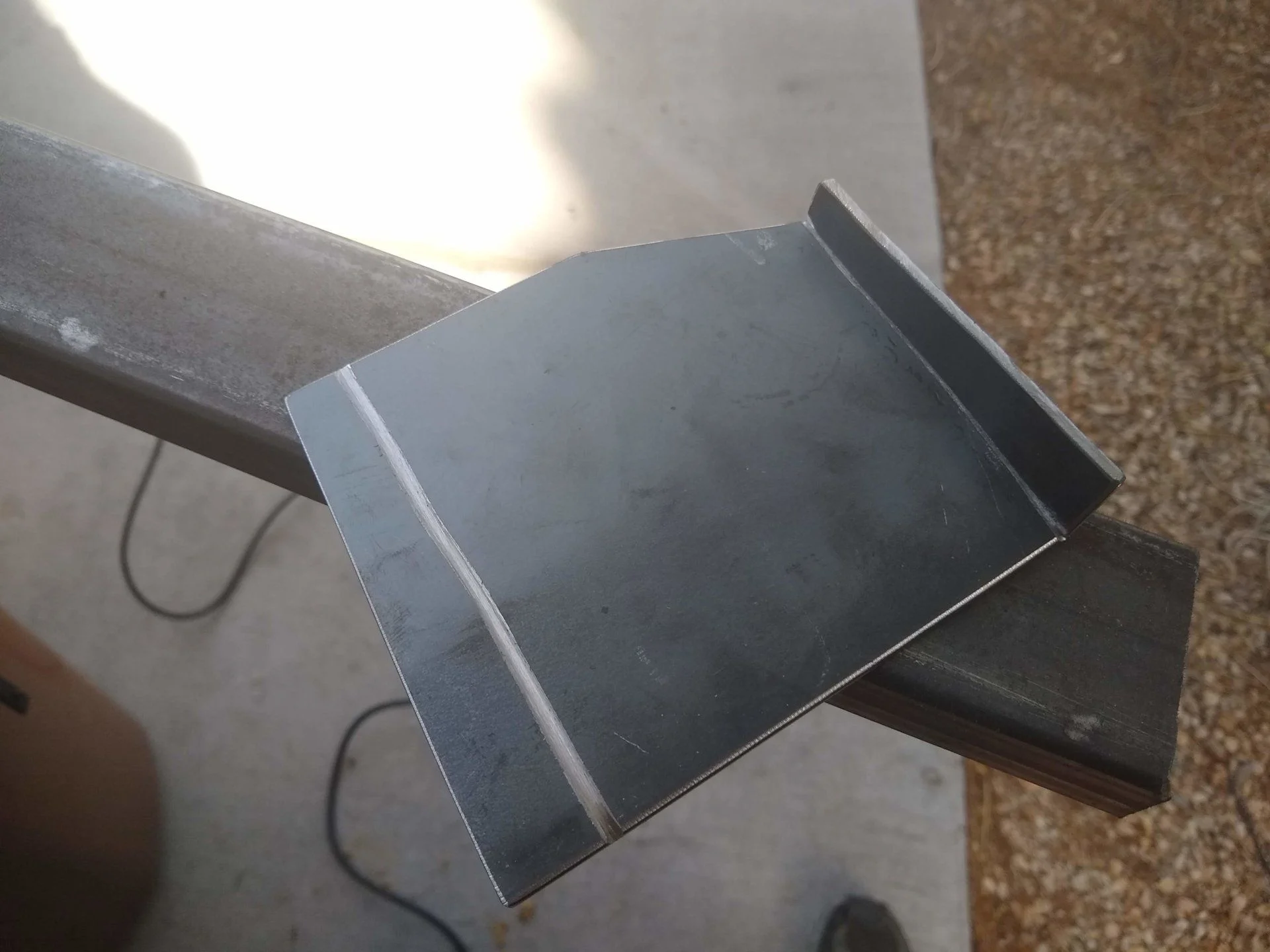

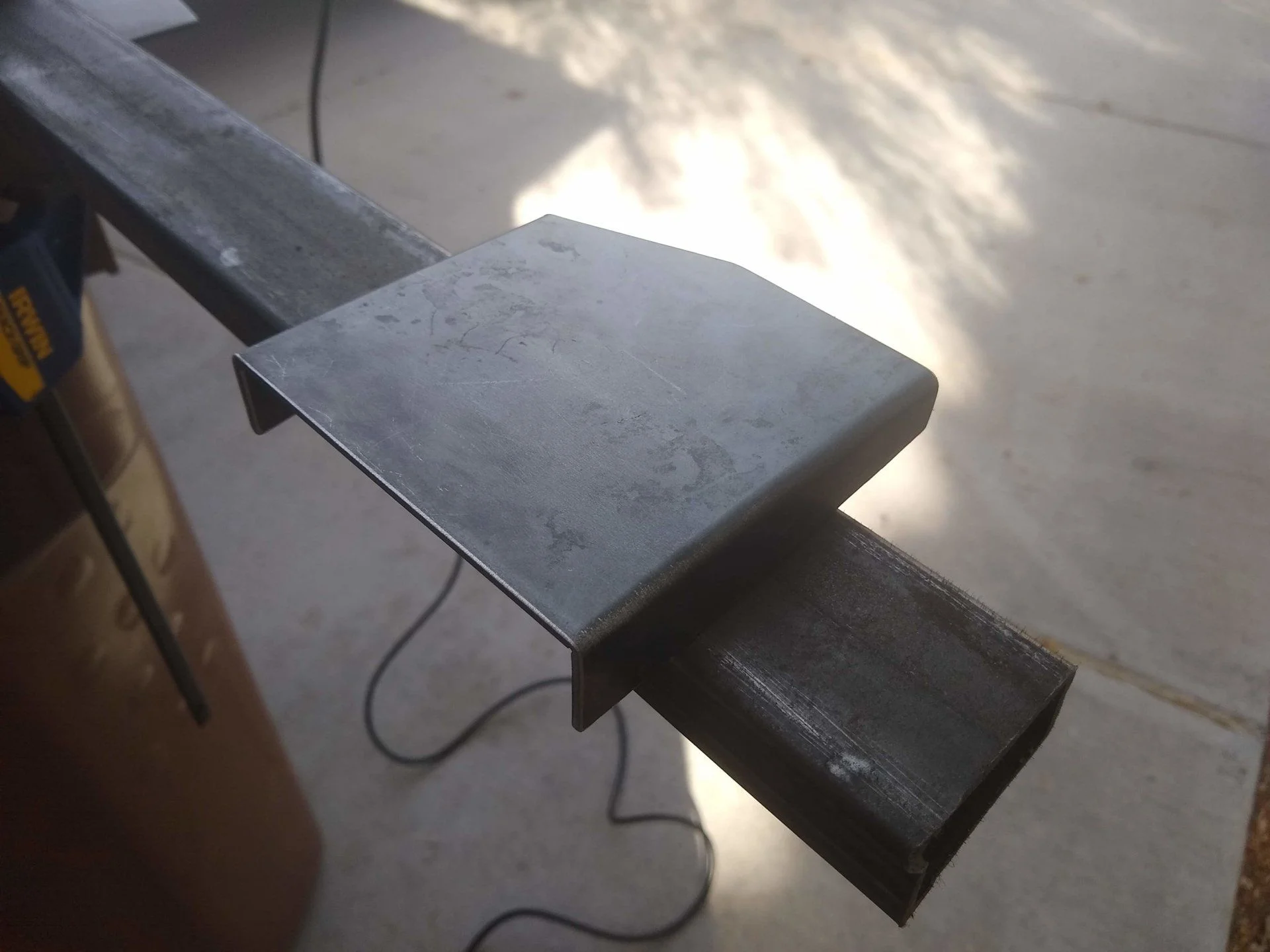

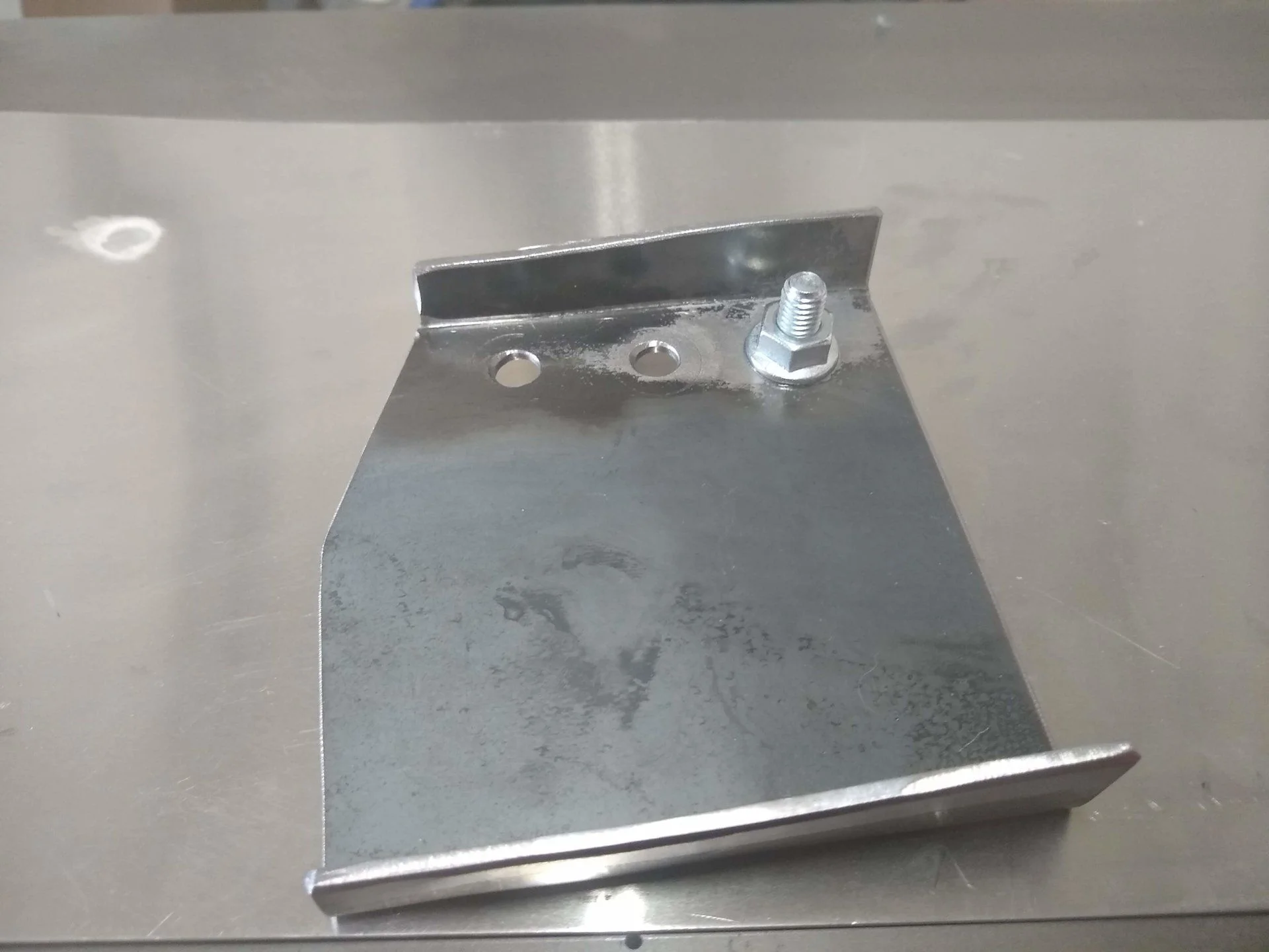

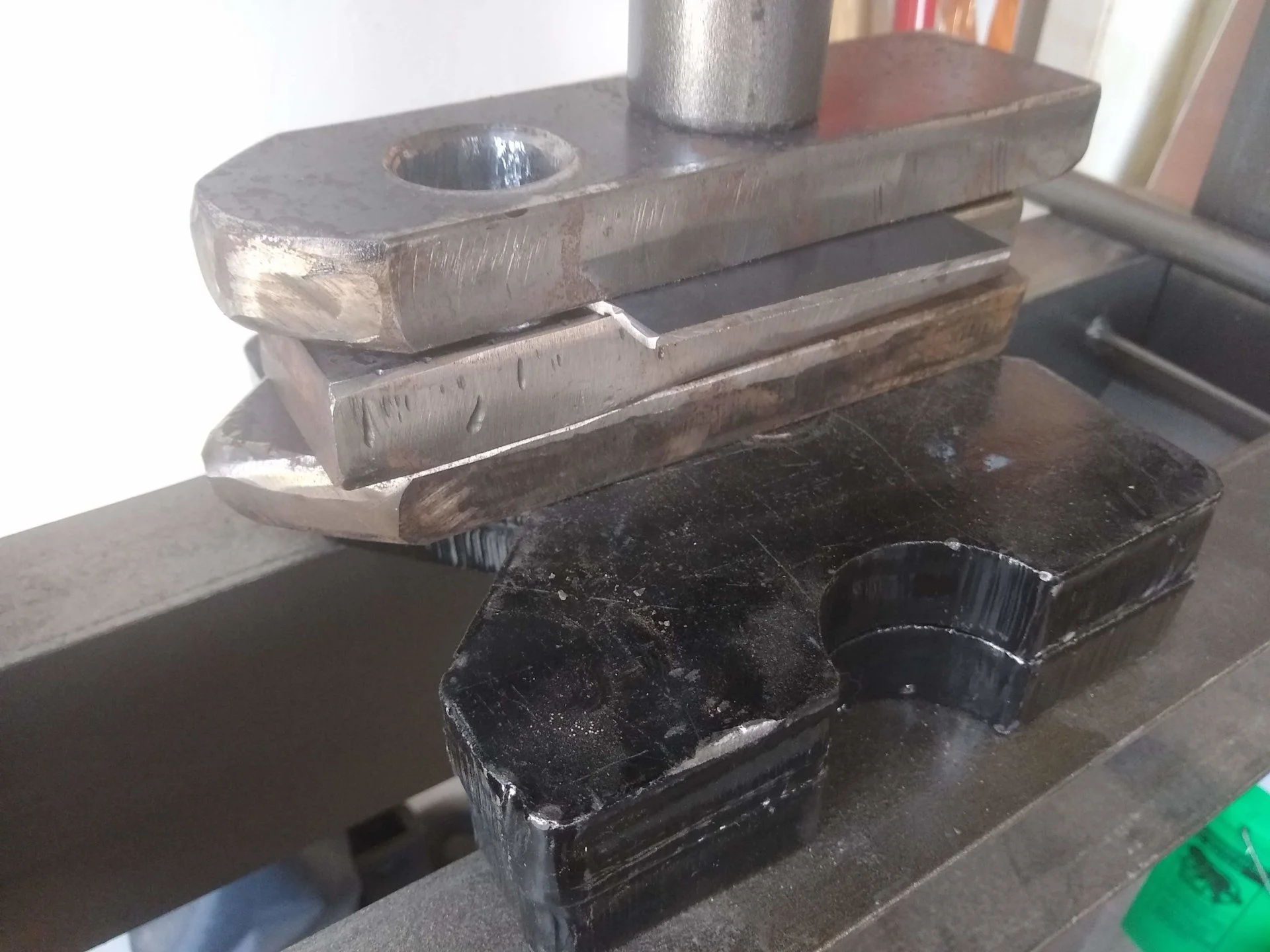

I have had to figure out how to get things done with out the ideal tool. I plan on adding a finger press kit to my press, but that will come later. In the meantime, I make due with clamping the plate between a few pieces of scrap and using a hammer to gently brake the plate along a shallow groove ground into the underside. The groove is just deep enough to ensure the bend occurs there, but not any deeper. Another check on the base plate, showed the need for some grinder touch ups to get the surface plumb.
Next up was the drilling of the three holes for the fasteners, and to tack in some captive nuts. I am a big fan of captive nuts. Anyone who has dealt with trying to hold a nut in place and thread a bolt, all the while leaning and reaching across an engine bay, will understand. Next I tacked the standoff to the base plate. 1 amp per thou of steel, and away with my ugly TIG welds.

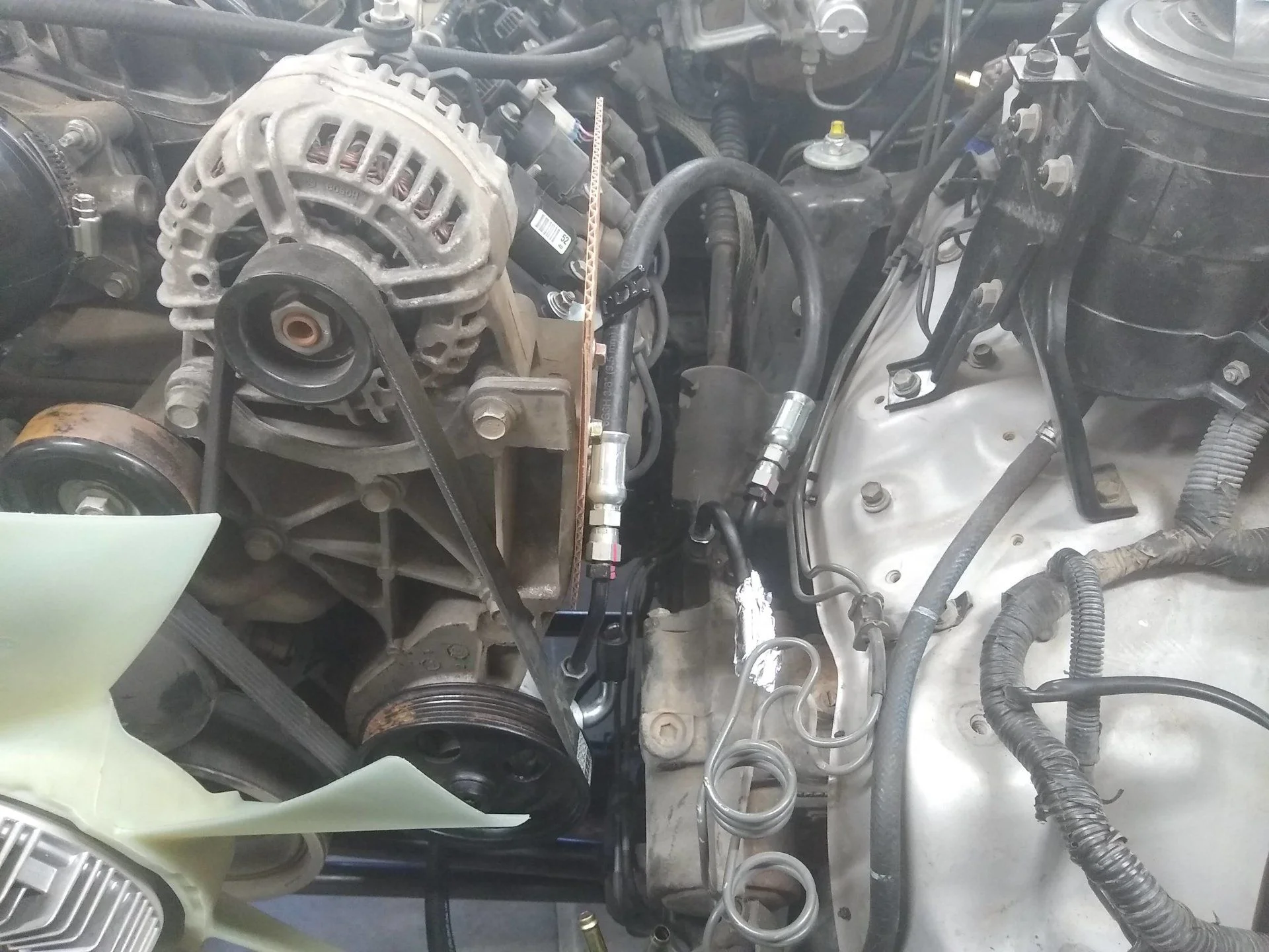

Install it all and cut some hoses to plumb it all in, and this small project draws to a close. I used three fasteners each on the bracket and the reservoir. I drilled and tapped a third hole on the alternator bracket to react the forces developed by having the reservoir stood off the bracket, and on the reservoir, because I thought it looked more pleasing to the eye. Truth be told, if I had it to do over again. I would not have used a reservoir this size. I like the added volume and I really like the that it has a filter, but it is at the limit of space available for it. Its done, it fits, and it will be fine.

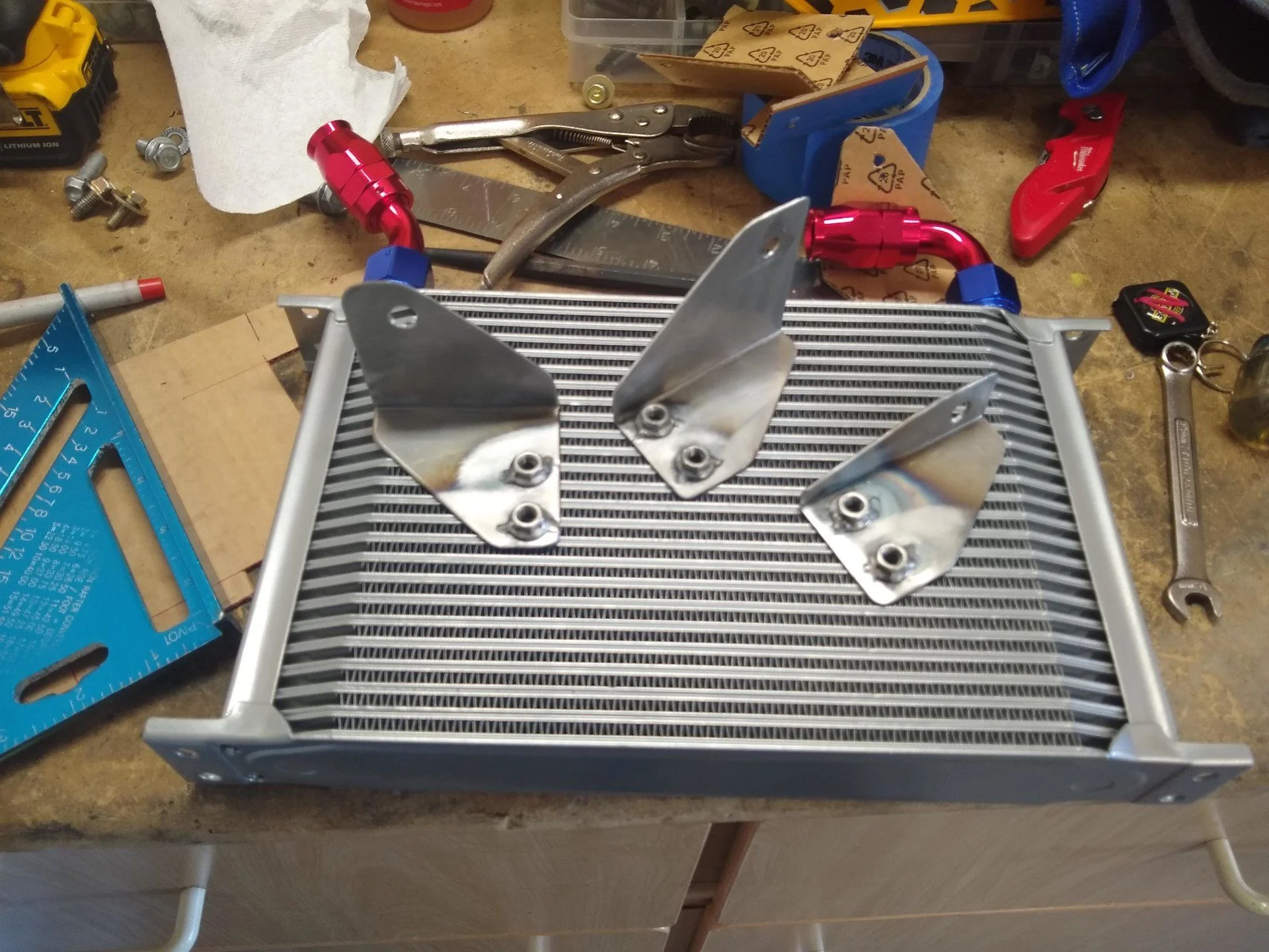

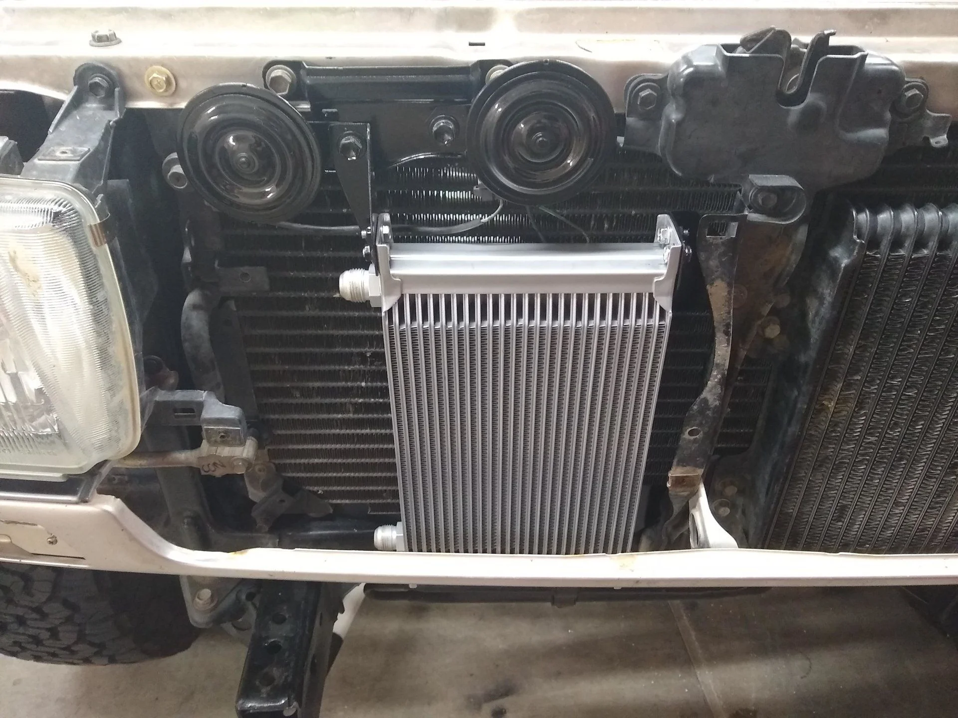

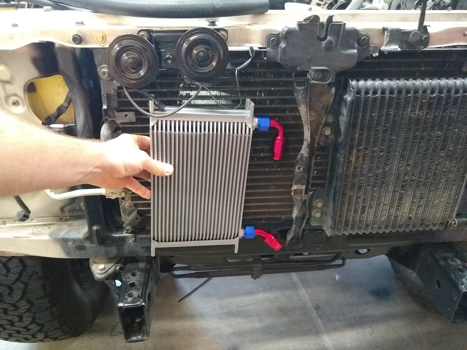

Next task was to mount the engine oil cooler that I mentioned a few posts back. This is a 25 row stacked plate design and it may be a bit overkill, but I want to build this rig to function in the Arizona heat with zero issues. Yet another few CAD templates, and I had a plan. I will save you the long winded explanation, and just say that I made them much the same as the PS bracket. CAD, transfer, cut, grind, bend, drill, tack, fit, paint, install. Done. I am happy with the result. It turned out to be much more securely mounted than I expected. The weekend draws to a close, so plumbing the -10 line will be another day.
Nice bends!
You might want to rig up something like this for bending:
Photo by Thomas Martin
Great find there Steve, way simpler than what I sketched up. Thanks.
I have always wanted to weld up a set of these but there never seems to be enough time during a project.
I end up beating a fold with a hammer just like you did. Heavy stuff I heat with the torch first.
