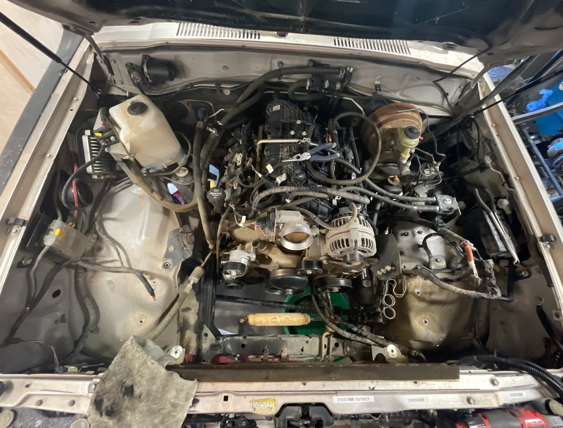

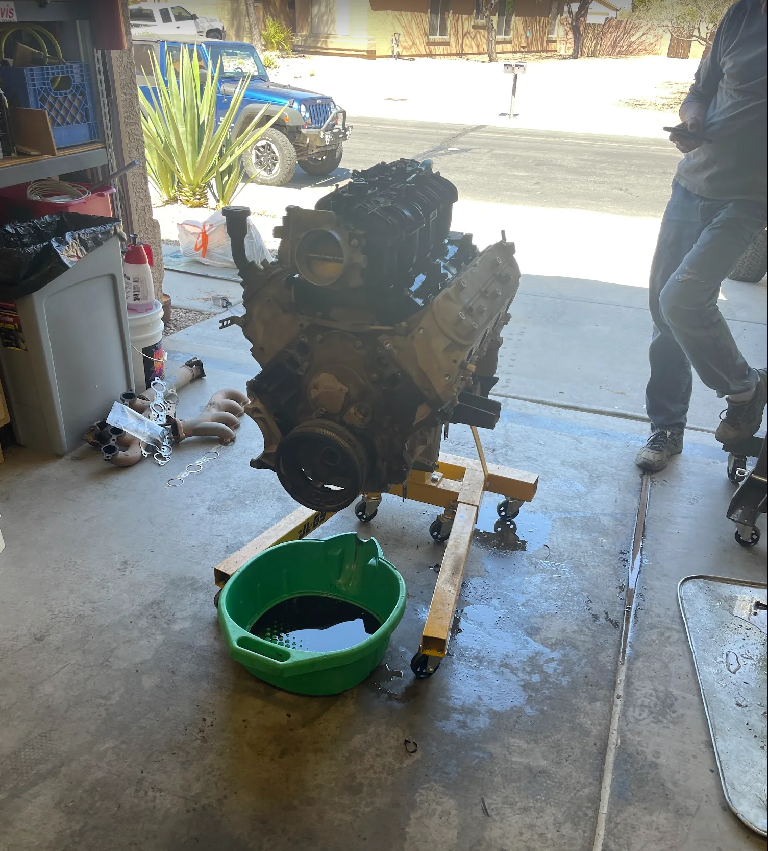

Let's catch up on the clean up! I posted pics of the mud and sludge I had to clean out of the interior, so now I can show you a bit of the details of the heart surgery. Once I discovered that there was nastiness inside the engine, I took one look at the spindly little Danas on the JKs and thought better than to try to tow my ~6000lb LX450 out over that terrain ahead. I knew the motor was coming out and apart regardless, and I have been wishing I had upgraded a few things the first time around, sooooo.......I was not terribly worried about wear of the internals. I did however drive out with the windows down, radio off, with a tuned ear on the sounds of the engine. I listened for signs of a bearing spinning, or of anything trying to seize. I made it about 6 miles out from the overnight spot to highway 177. She was definitely NOT happy with the task, but she did it and was shut down before any big bang. The weekend after the deep dive, I had some help lined up and we got the 6.0 pulled out. The week leading up to this, I spent a little time here and there get the peripherals put of the way, and most importantly, my precious Ron Davis radiator. That thing works amazingly well and cost WAY too much to risk any unintended contact, so out it came.
Extracting that thing was quite the effort, as I said above. It was made more difficult by the fact that I wanted to pull only the engine, not the whole powertrain. It was further complicated by my decision to leave the exhaust in place. That resulted in it hanging up the motor and making the final pull a big PITA. I couple big monkey jumps and some destroyed exhaust seals later, she came popping out.
We broke for lunch at In-N-Out, and then headed back to get into tearing down the motor. I wanted to carry the momentum due to the risk of any remaining moisture causing corrosion inside the block. This turned out to be a non-issue because engines get hoy enough to cook off water given time, and there were no sign of rust inside. There was however about a half inch of silt, dirt, and complete nastiness in the sump. This was to be expected. It is also part of the reason the sump is there(ish). Great news is the top end looks great. Less great is that the cylinder walls are not perfect. Less less great is that the cam and crank is most likely toast.
I had to stop when I got to the harmonic balancer because despite having 3 different pullers, none of them fit. Easy fix, Amazon to the rescue. I ordered one with next day Prime, and got off my barking dogs. I was one worn out hombre. It was all I could do to strip off my filthy shop clothes, shower, and crawl in bed after a quick bite to eat. (but I love it!) Next day, the puller was delivered and I got the balancer pulled in very short order. I could then remove the timing cover, VVT drive, and timing chain. Rear cover and next up was the main caps and piston/rod assemblies. They all showed signs of wear and contamination, but not one showed any sign of heat. Very surprising. If I had no need to salvage this engine, it would have been interesting to have continued flushing it and see how long it would run. Clearances are loose now, but I bet it would have gone a long time.

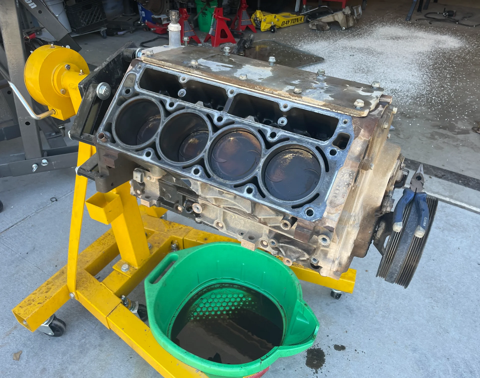

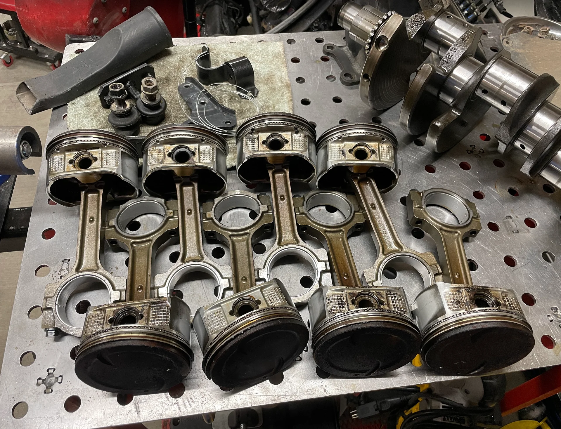

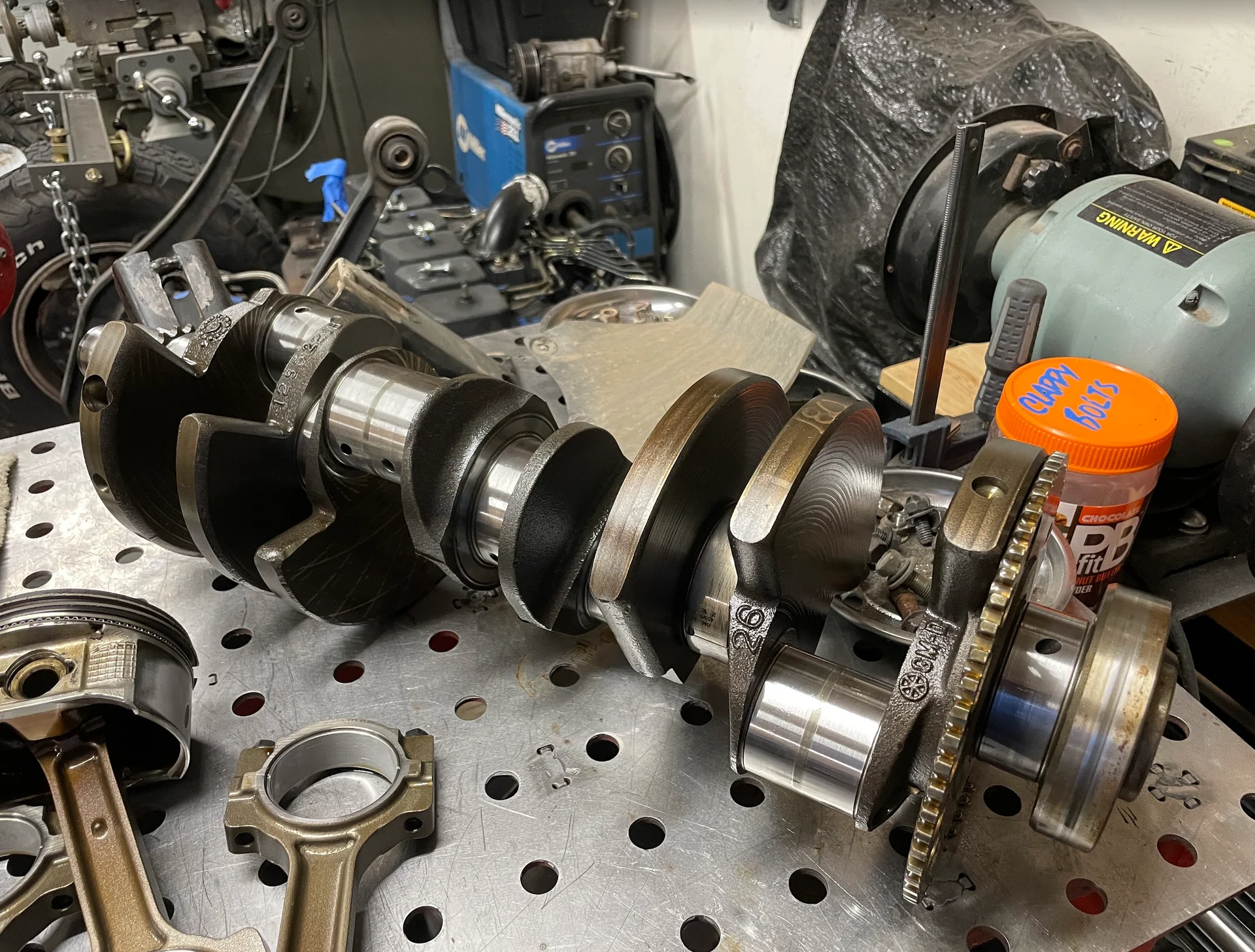

That aside, you can see what river silt does to an engine. The pistons are scuffed on the outboard side of the skirt, the crank journals are worn to grooves, the cam lobes are scuffed and marred, and the cylinders look to match the pistons. Essentially, by most all standards, as well as mine, the internals will soon be useful only for scrap or art.
The whole thing is now torn down to just the block, valley cover, and a few vagrant sensors. The #8 cylinder is the worst of the lot, but even that one can be saved. The block is 100% worth saving and will be either a hone or .010" over bore away from being ready for new pistons. From here, I will decide what direction to go. Well, to be more correct, the machine shop's assessment of everything will tell me what direction to row. On the low end is a crank grind and oversized bearings with all the new bits above it to complete the equation. On the high end is a 408 stroker kit and a shotgun blast of parts from the Summit Racing catalogue. I will drop it off for measurement Friday at Baker Machine, and will be waiting for a report when I return from next weeks travels. Stay tuned.

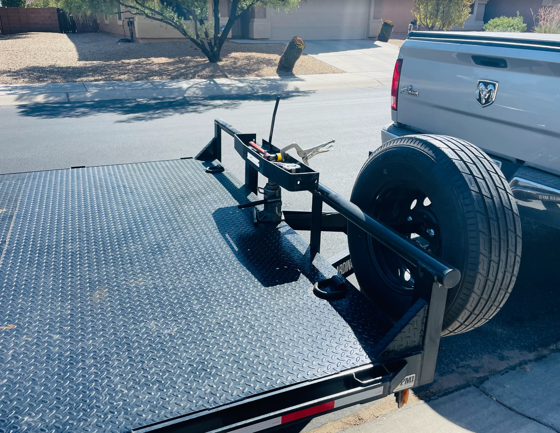

Sunday, August 27th, and still no engine... I guess the above stated crank debacle is dragging out. Hopefully this week I will have it. From there, I will dive in and try to get 1 of 3 active projects back on the road. Been working on my car hauler this weekend to install a Badlands 9500 winch. Hand cranking a come-along to load a dead 80 Series so for the birds. The mount and parts are fabricated and painted, just have to do final assembly and wiring today. Will be nice having done for function, but also to get that dang trailer off my truck. I don't have a secure storage spot at my house and it is a 20 minute drive to my buddy's place where I keep it. I'll post up some pics of the finished product.
Well, less than an hour in the 104 degree humidity that results after you have a great nighttime monsoon storm, and I am flat done. I had my full brimmed hat on to shade my dome, but I was sweating so much that it would pool above the sweat band and rush out anytime I lifted the hat. All I could manage was a coat of paint on the mount and installation of the winch. Wiring will have to wait, so I'll just update you on the work thus far.
I added this car hauler to my fleet this past June. Before that, I had been borrowing a buddy's rig each time I needed to haul a rig, but I hate borrowing stuff as I tend to perpetually be Murphy's Bit@@. Without going into detail, I wanted one that was capable of easily transporting a 1 ton LWB rig with ease, so along came this one. It is a 22' 12,000lb capacity unit made by Cardinal Trailers, a now defunct manufacturer. It was also a repo which made the price right. I got it for less than I could buy a new 7000lb unit to give you an idea. It was a bare canvas otherwise, so I needed to add the requisite items for normal duties like a tongue box and winch. Harbor Freight supplied me with a coupon for the Badlands 9500 and Amazon supplied the rest.

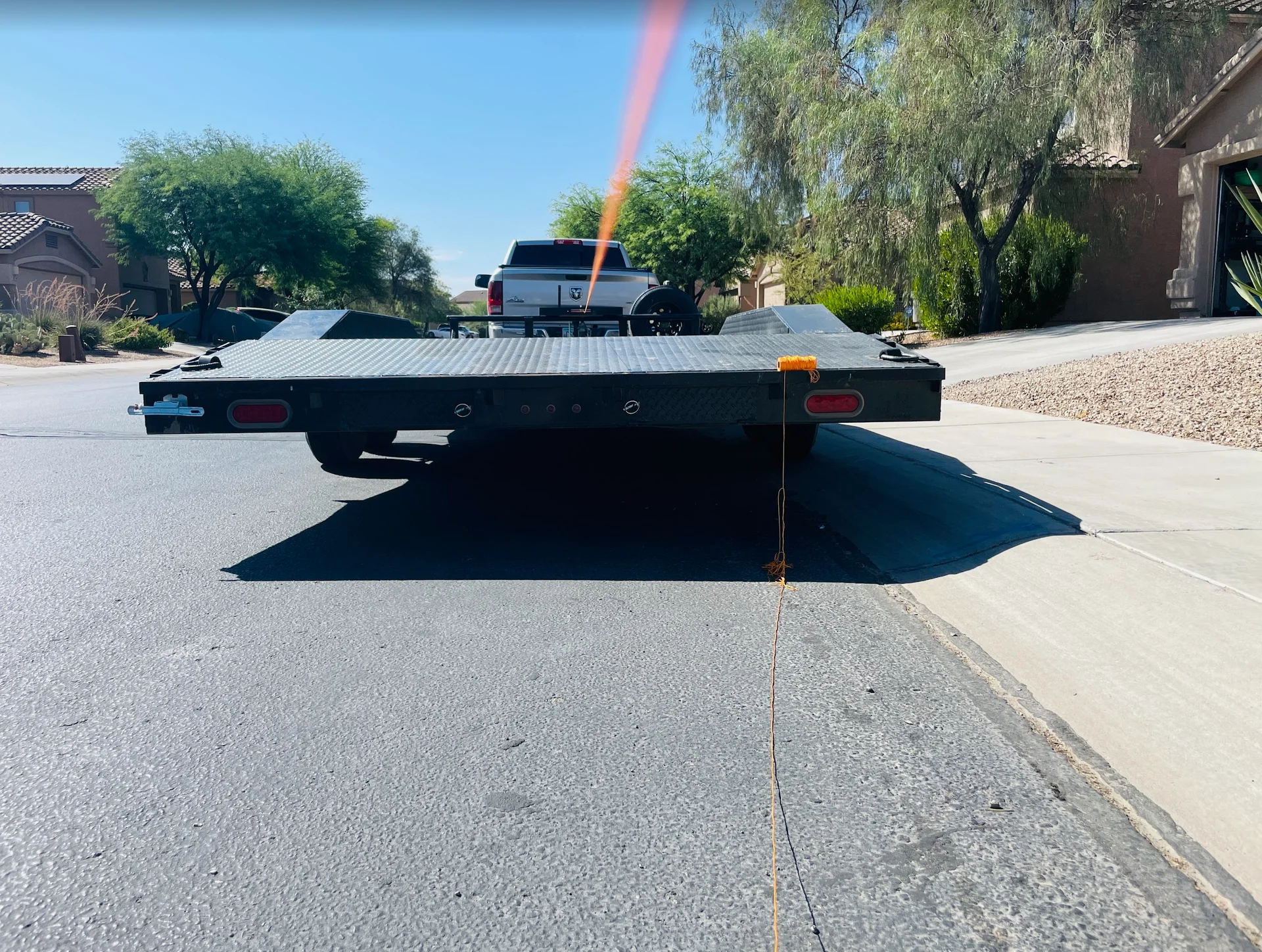

The effort started with an exploration of what was possible. I had on hand a winch cradle from a Jeep JK winch bumper, and being made of 1/4" plate, I felt it more than up to the task. Its overkill in fact... Anyway, my pack rat nature really helps me out sometimes, and I saved on the cost and effort of fabbing/buying one. I did a rough fit up to see where the angles would lied and was happy to see that it located really well on the stop tube at the front of the trailer. I really wanted to be able to drag a dead rig on to the deck without the cable contacting or rubbing on the dovetail, because OCD and all. I was happy to see that I was going to realize that ultimately non-essential detail in the proposed location.
With a lay out string stretched reasonable tight, I had about three inches of clearance between the "winch line" and the dovetail transition based upon a hook height of a stock 80 Series recovery point. That is taken at the point the tires would begin rolling up the ramps.
