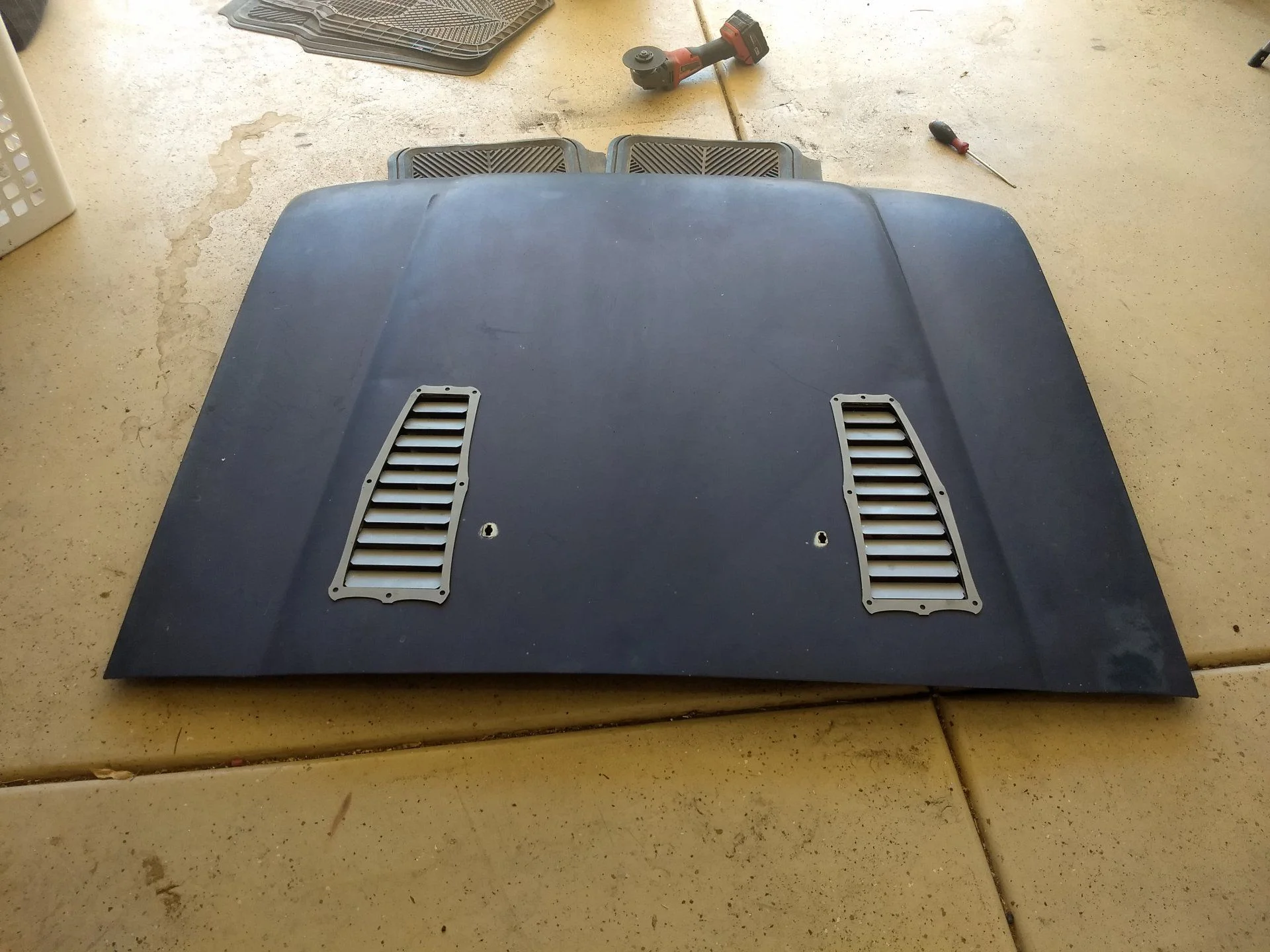

My 80 does that, I definitely need to replace the charcoal canister. Adding hood vents helped a lot, but don't solve the problem of a non-functional evap system.
After about 20mph, my hood vents start pulling air in due to being so close to the cowl. Everything cools off nicely on the highway, iat's are 15-20 degrees cooler.

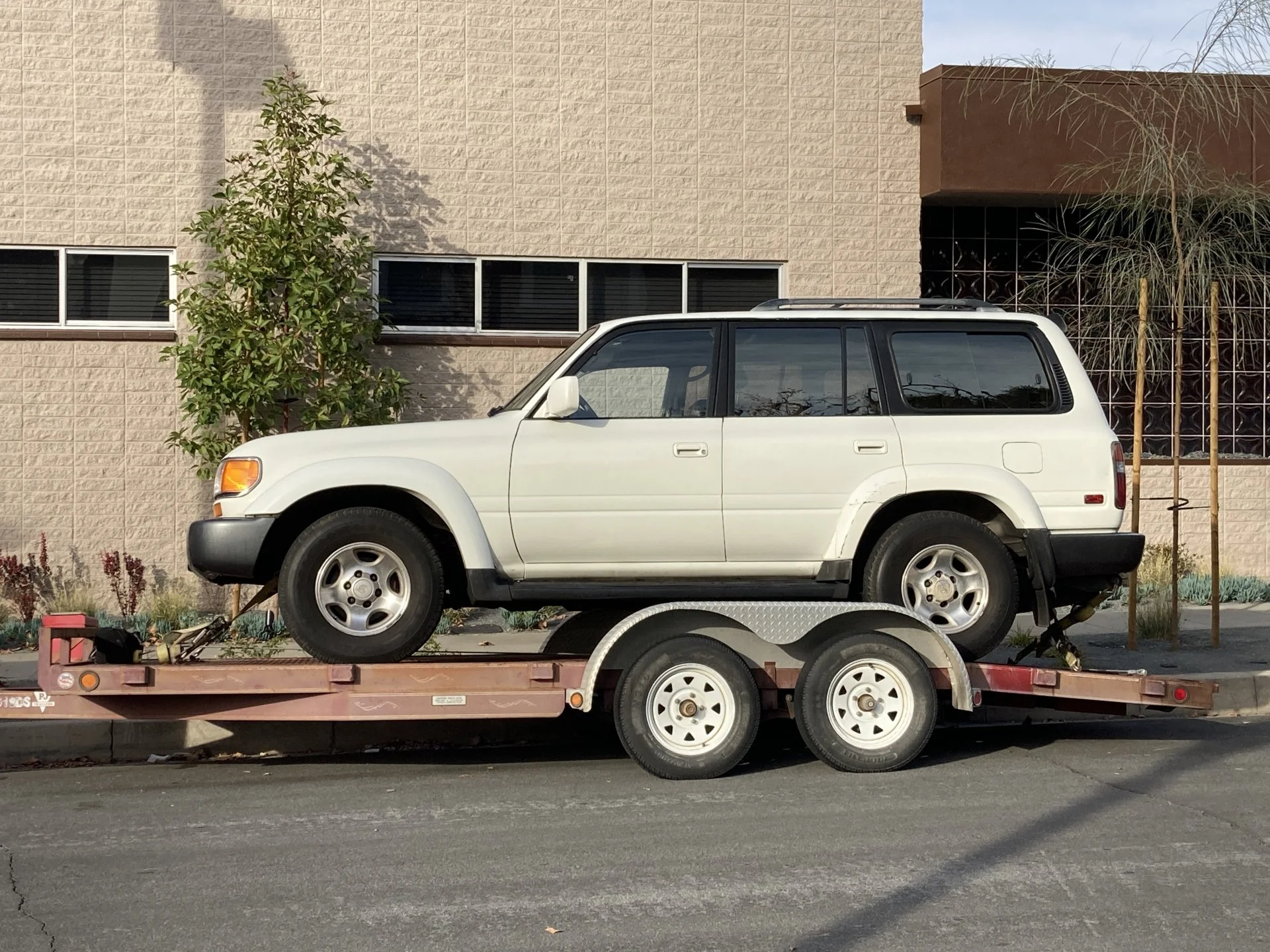

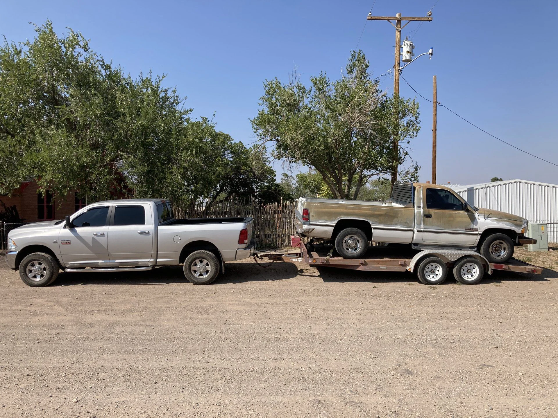

While I have lacked the motivation as of late to get the last 5% of the LS build complete, I did go on a vehicle buying spree for a bit. I picked up the donor Ram 2500 shown above, and the 1996 80 series shown here. Meet Rufus. Rufus came from San Dimas, CA (name the reference if you get it). Rufus was a one owner(with a quick flip between them and me). He has done 334,000 miles and has dealer records for the maintenance along the way. Blew me away that it was so well taken care of. He has been in CA all his life and has some expected wear and tear. The amazing thing is the paint. You can tell it is getting thin on the edges from buffing, but is in great shape. He is bone stock and also has the K294 option. The good one. I had never driven a stock 80 before, and I gotta say it is pretty zippy. The oil pump leaks like a stuck pig, and the AC system has a leak, so he wont be much for the AZ summers, but I plan to go body off with this build so new AC bits are being budgeted.

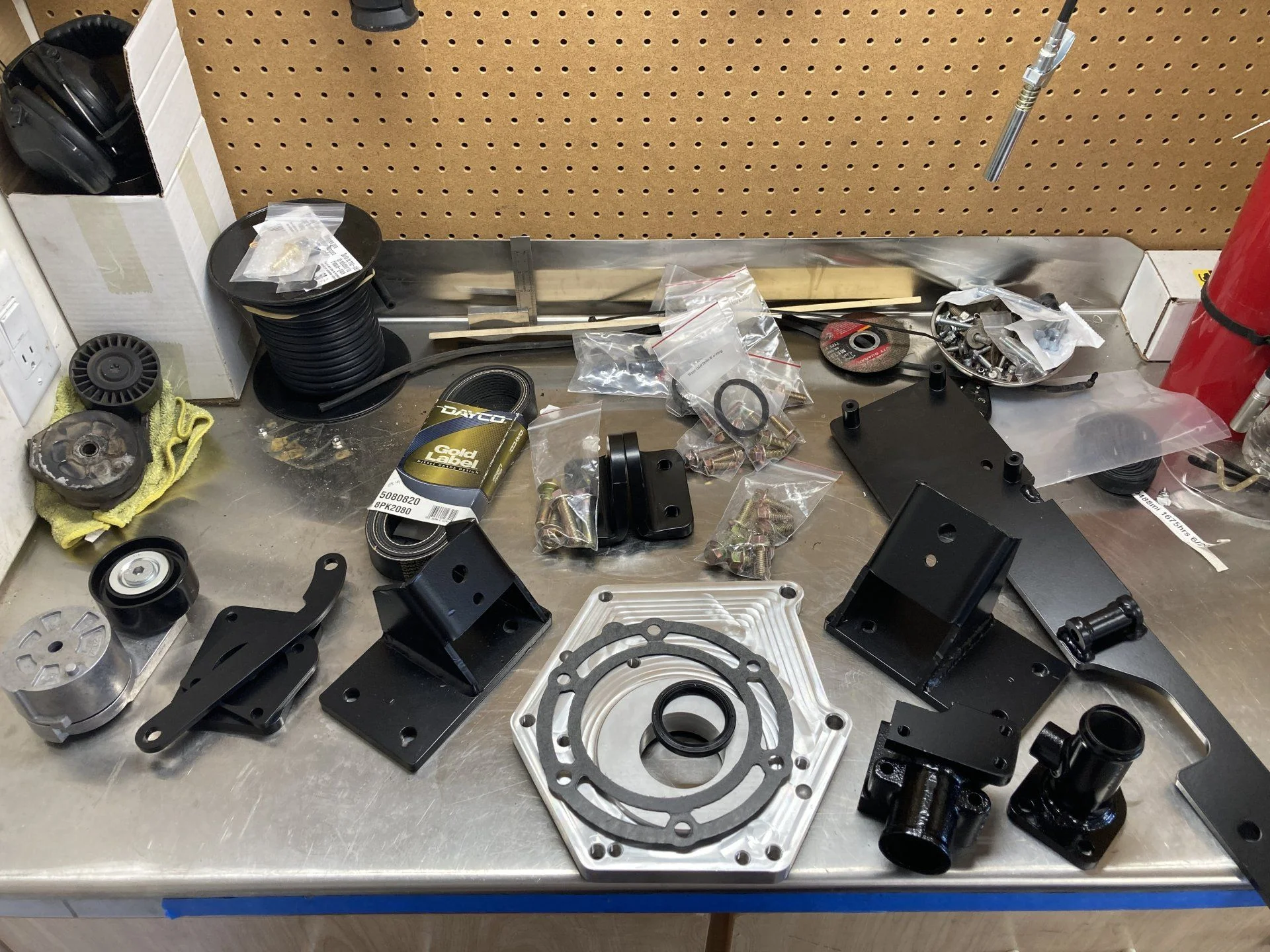

I had planned to start this build in my "new" place built on 2 acres in Picture Rocks, but the land purchase fell through and construction materials shot through the roof. So, here I reside in the same house that I said I would never undertake another full scale build in contemplating when I will start. I have been amassing an alarming pile of parts for the build, and will have to start on the donor tear down at some point. The rough plan is to pull the 12 valve and NV4500 from the Ram, and get that end done first. The Cummins will get the 425hp/750lbft treatment along with all new guts and fueling. The NV4500 will get a refresh, 5th gear fix, and swapped output shaft to mate to the HF2A Tcase. Rufus will stay AWD to better handle the torque of the Cummins, and the t-case will get 3:1 low range gears and 10% overdrive high range gears. Diffs will stay at 4.10, but the axles will get a full refresh and locker rebuild. Meats will be 315s on stock wheels, and lift will be 2.5" Heavy front, 2.5 medium rear with airbag assist, and the body will elevate 1" to aid in clearing all the new bit underneath. NW Adventure Vehicles will be supporting me along the way with Q&A and parts(not sponsored, still a paying customer). New console will be the Delta system in the LHD Manual config, and all the other bits will be sourced from Toyota as much as I can possibly find. TJM light weight front bumper and Avid Off-road Dual Swing rear. The Rhino Rack, 270 awning, and accessories will transfer from Lexi Jo to Rufus, and the drawer/cargo area is yet to be determined. In all, my goal is to build the most bush-proof touring rig I can based on my experience in Australia last year. A new thread will be started in tandem with the start of the donor teardown. Stay tuned.
