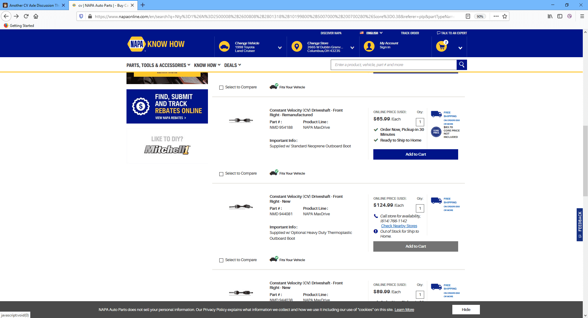

Interestingly enough I was looking on the NAPA website and came across this!!
"An extra day this February means an extra day of savings. From now through 2/29 you save 20% on buy online ship to home purchases. Use code: LEAP20 at checkout to save."
Rockauto shows $175 for pair of them delivered to my door. Doubt NAPA will beat that even with 20% (still sales tax?)
